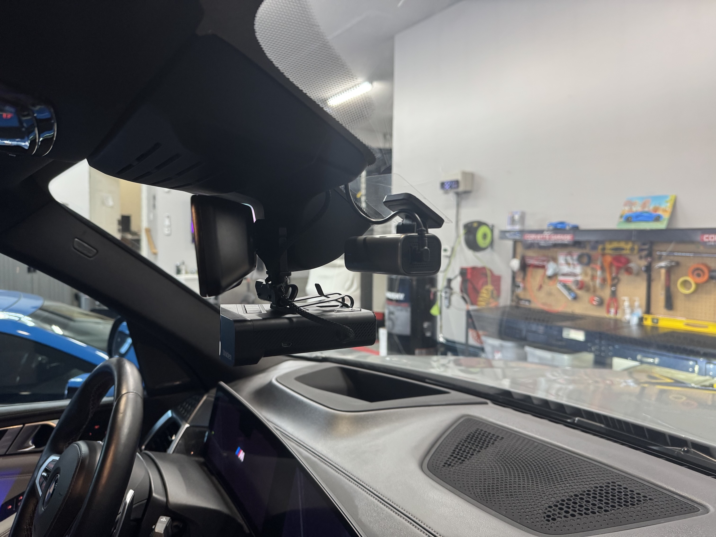

radmjk wroteCan you kindly post any pictures or video on how to pop the housing/clips off and what power cord you used to tap the power please? Thank you so much.I completed the mirror tap install on my 2024 X5, was same setup as my 2020. I attached some photos but again same process as before so can refer back to earlier posts if needed.

KSpider wroteAwesome... any chance you took some step by step pics? Or anybody have this please?Completed this install only 2024 X5 today - my only 2 cents: seperating the two side plastic covers takes a lot more force Than I was comfortable with at first. After reading a couple other comments about it I decided F it, and just pulled super hard and then they shot apart, nothing broken.
