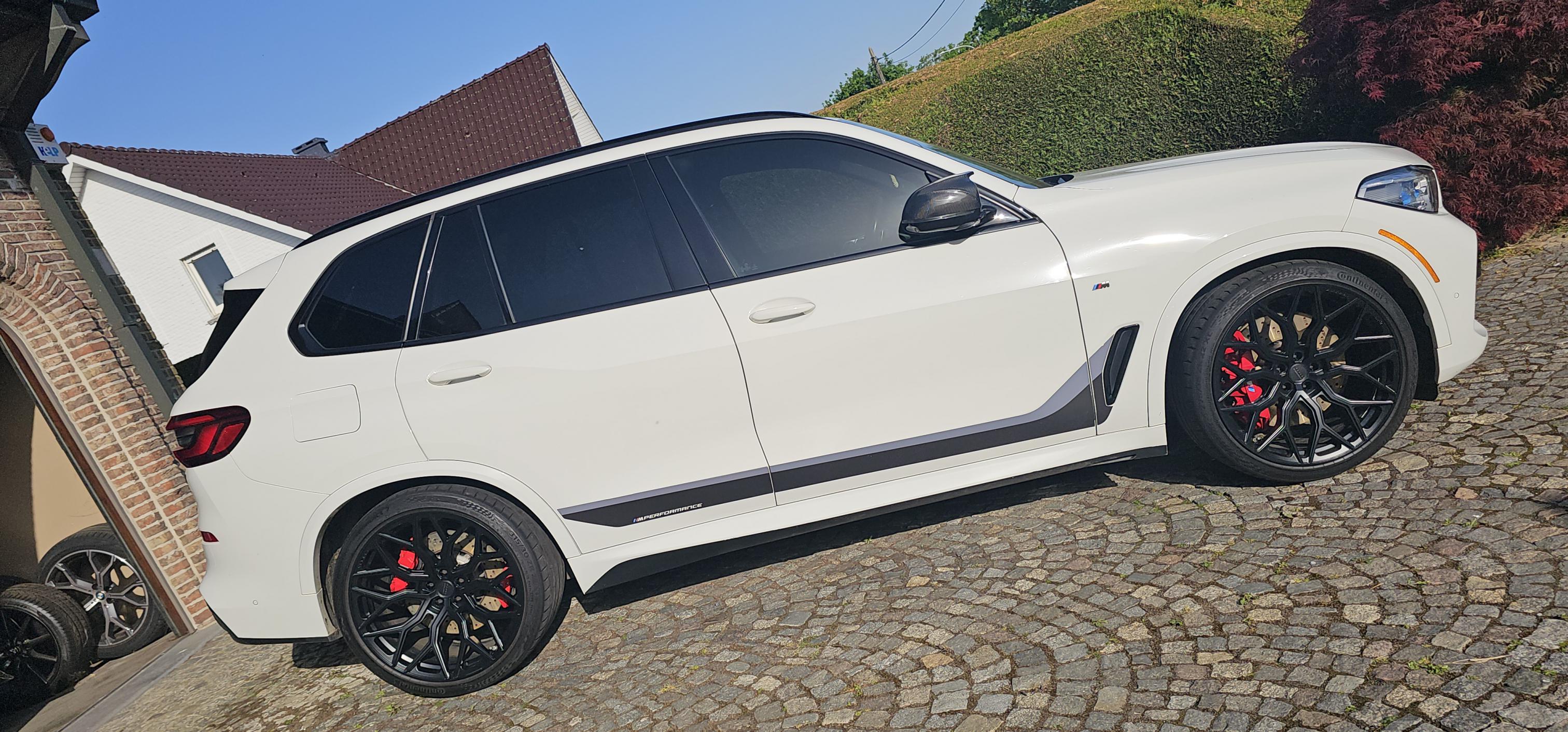

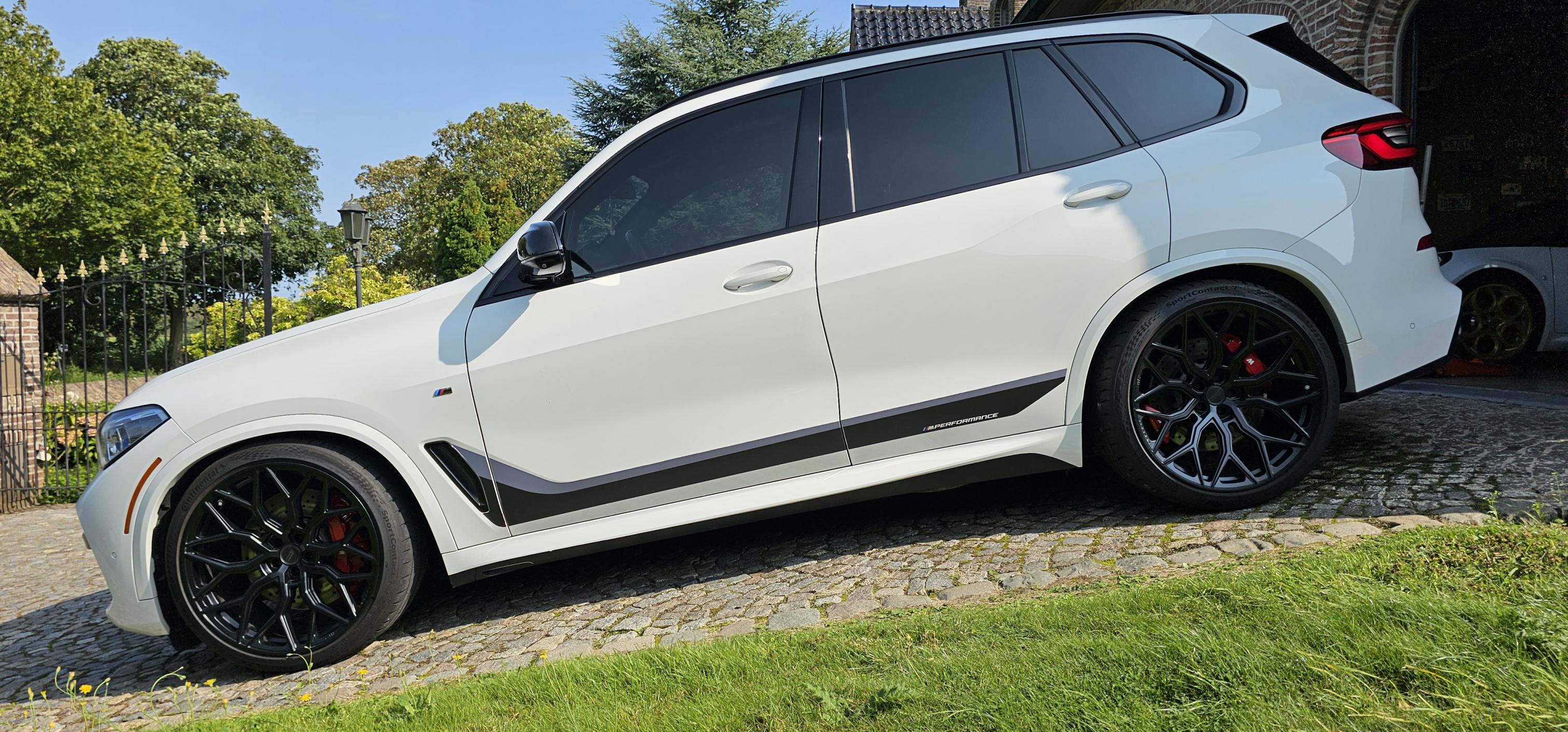

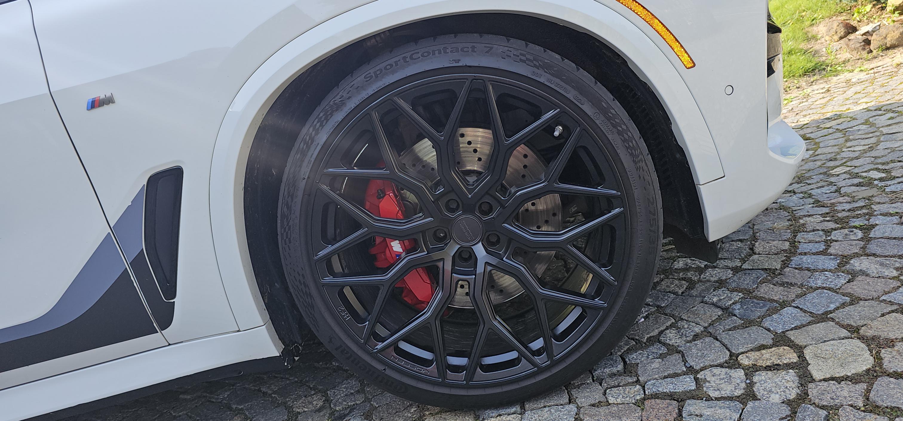

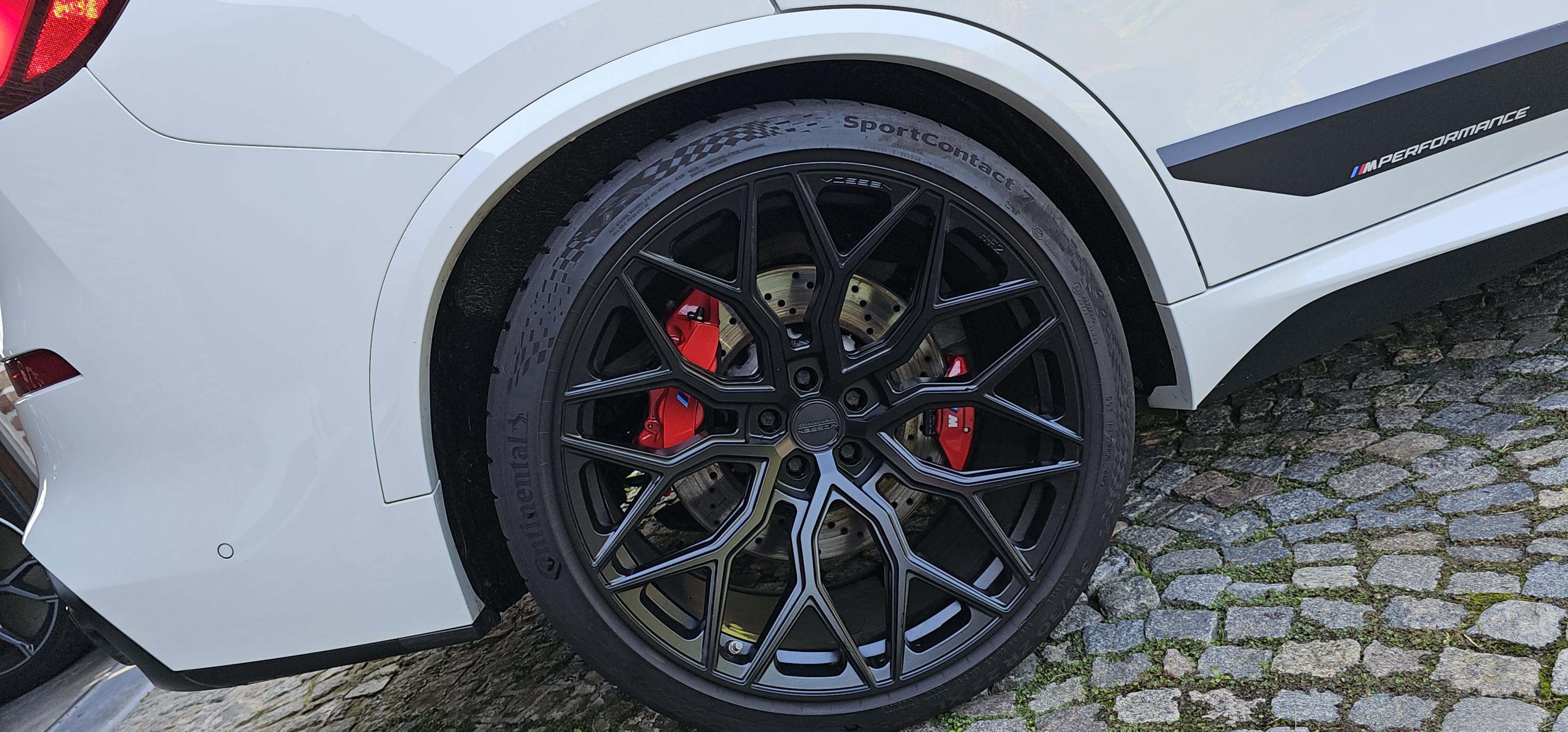

Hi, I'm planning on getting custom wheels.
I'm currently using the stock 22" 742M wheels with the stock Continental PremiumContact 6 summer tires.
275/35 R22
315/30 R22
I also have 12mm spacers in the front and 15mm spacers in the back.
What is the widest wheels I can get to be fitted with my stock tires in the front and rear so I wouldn't have to use spacers anymore?
Thanks.
06-05-2025
275/35 R22
315/30 R22
Thanks.
You can use the same size/offset as I did:
22x10.5 front ET 19 "deep" profile
22x12 rear ET 20 "super deep" profile
.... but you have to find the widest tires available.... because most "normal" OEM sizes will look "stretched".
Or.. just go with the same dimensions as OEM.... but with a lower offset. That way you can run any brand tire you want.
I've run shorter (low profile) tires.... and I kept denting rims.
I've run taller tires... and the rubbed the inside of the fenders.
OEM sized tires are best.... but I had to research the tire with the widest treadpatch (Continental Conti Sport 7).... and they work well, but they are often hard to come by.
If I had to do it all again, I would have gone with stock width wheels, but with a lower offset, so tires would be easy to come by.
