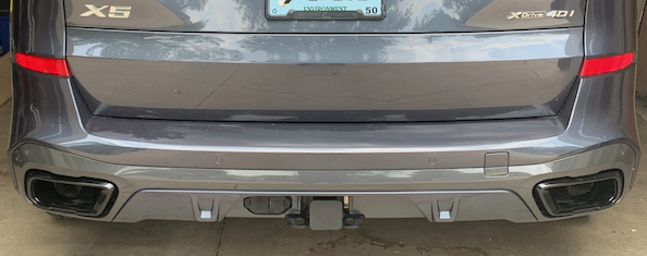

Here was the xDrive40i right after I did them:
-Rayo

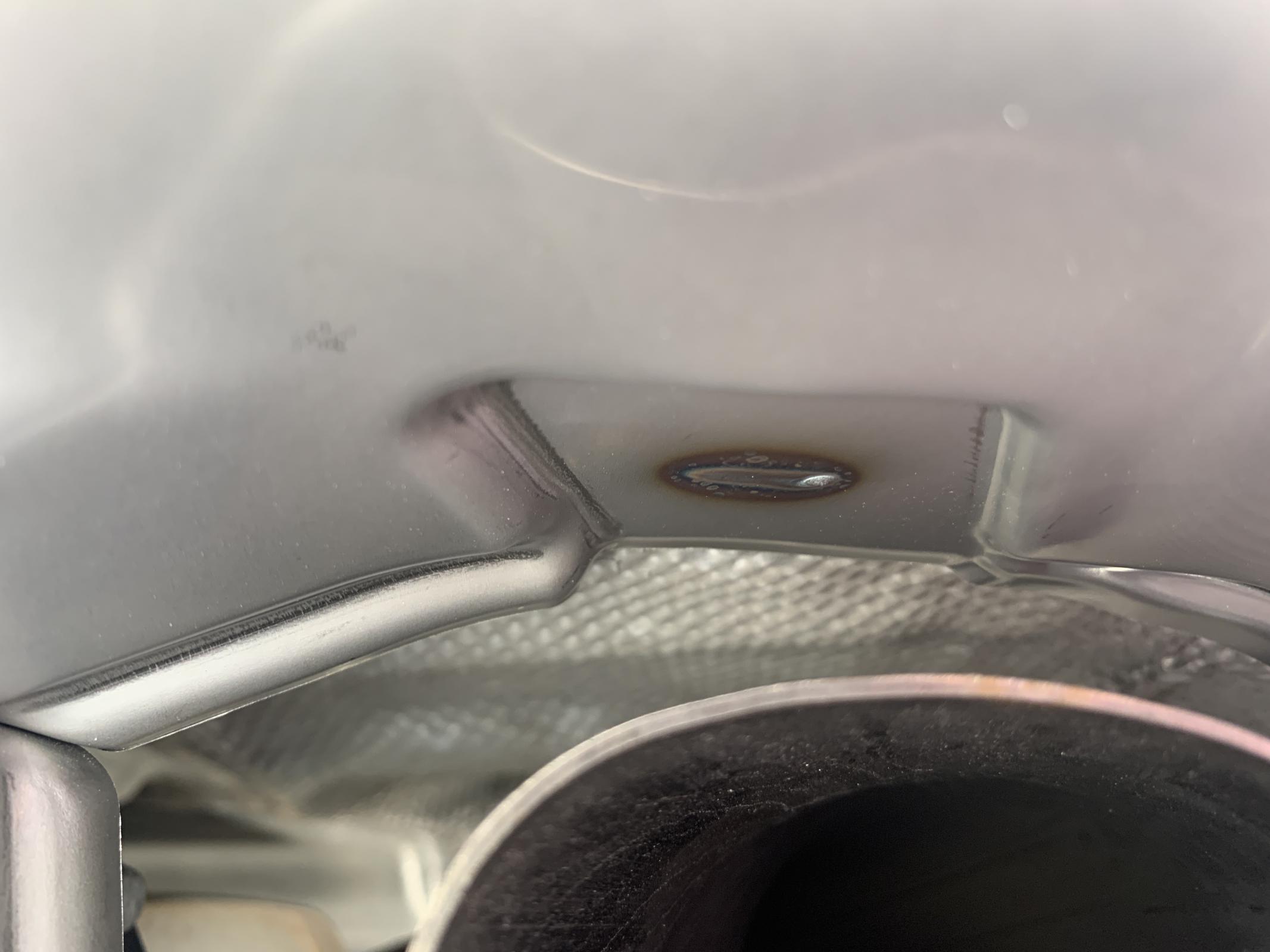

I did the replacement today, I make it sure before going to the dealer that the replacement part was black but after taking back the car the inside of the tips were gray /stainless, not black! I'm very disappointed and even the new parts doesn't seems to be new..it like they sand it without replacing it! And I'm wondering why the welding point is not painted?

Roch M4's user avatarRoch M4 yeah that does not look brand new - such a shame they don’t paint them black anymore!

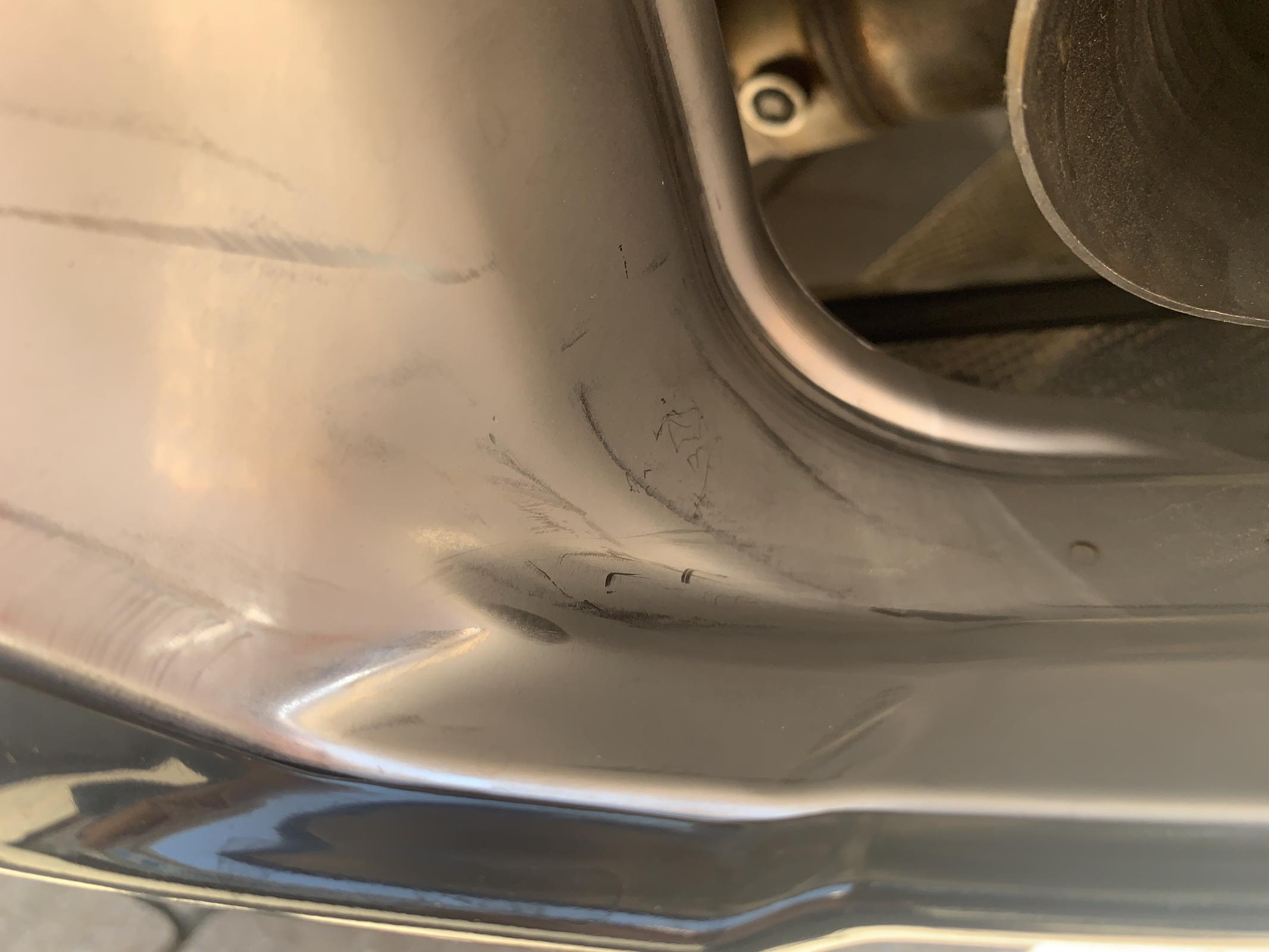

Yes. I just got a '22 X5 xDrive40i M Sport. Had the completely black exhaust tip/frames but one was peeling. My friend at the BMW store next to my dealership had them replaced under warranty. HOWEVER. The tips were black on the outer bit, and like silver/chrome on the inside.. I tried ordering two different sets now on my own, and both have come either wrong size or still with the chrome inserts on the inside rather than smoked all the way through. I spoke with the BMW parts department and they said " BMW has discontinued the full painted tips due to the paint failing so often". So I am not sure where else if anywhere, you can find them unless you have them painted yourself.
