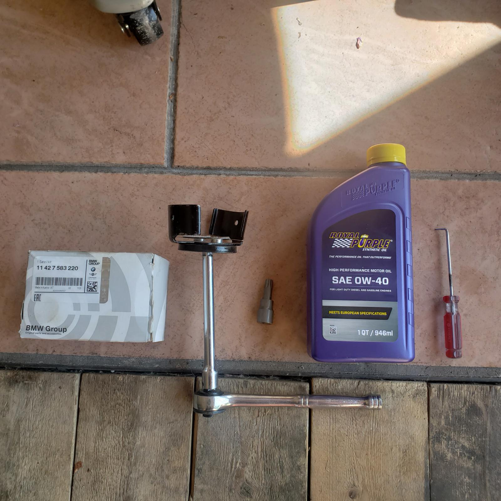

Step 1b; Gather tools needed;

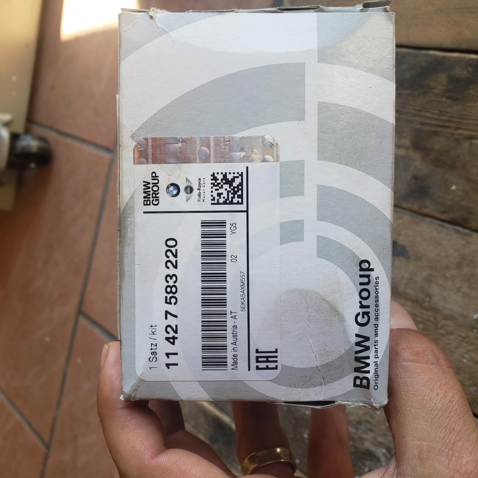

1. BMW filter kit (part # 11 42 7 583 220)
2. Standard 3/8 ratchet
3. Standard 3/8 extention (4-6 inches)
4. Filter removal tool
5. 50mm torx socket (or allen equivilent)
6. Oil (My car took exactly 10 quarts)
7. Small pik/screwdriver (to remove filter housing o ring)

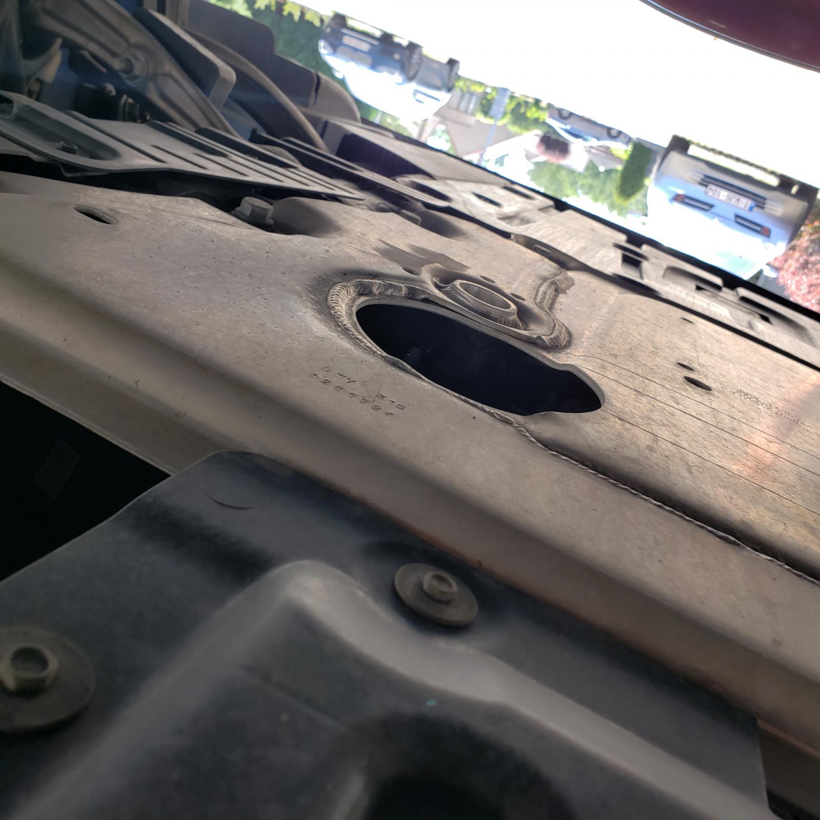

Step 2: Locate the oil drain plug (passenger side) access hole..... as well as the filter housing access hole (driver side)

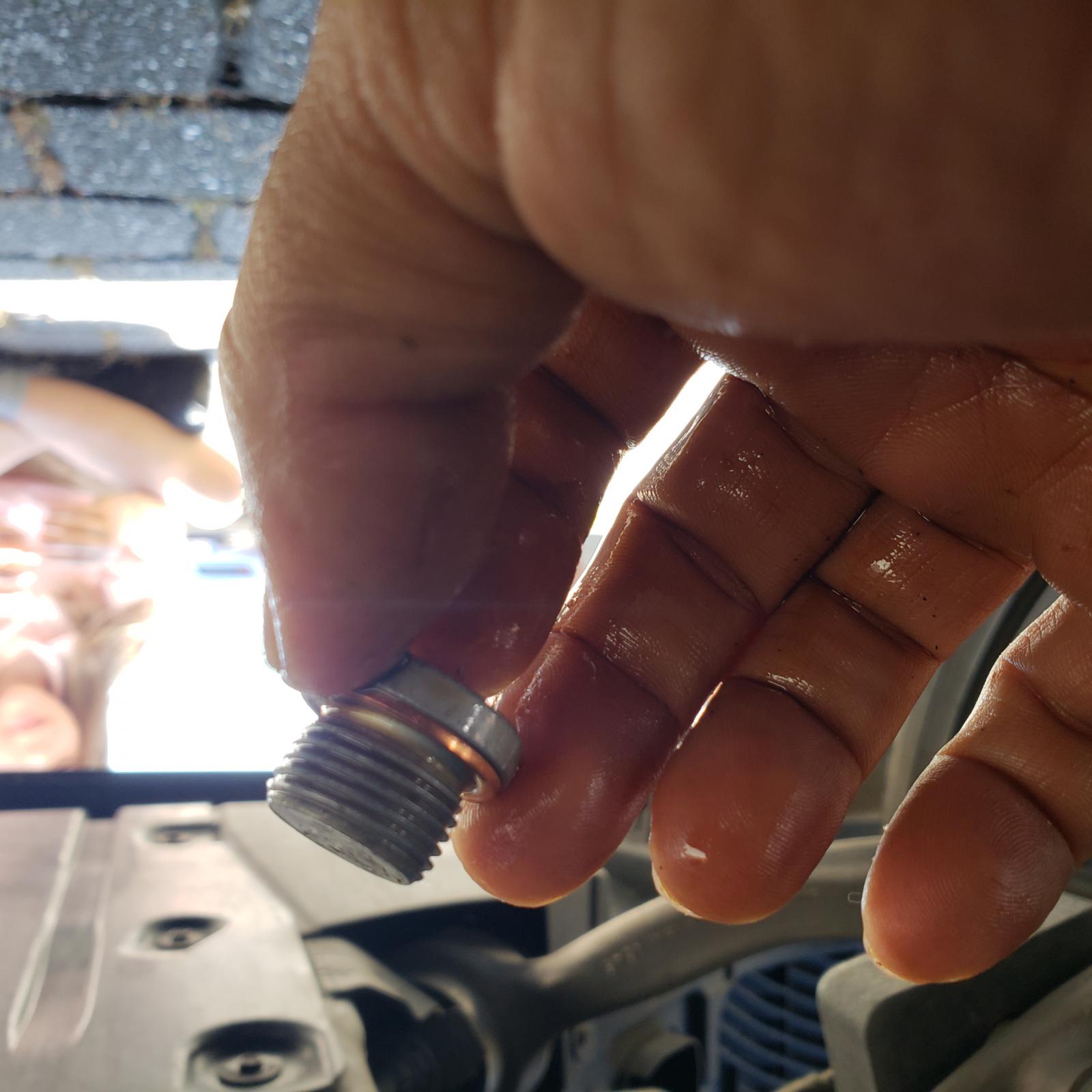

Step 3: (with your oil pan under the car.... duhhhh).... remove the oil drain plug using a 50mm torx bit (a similar sized allen head socket would work just as well)
Step 4; Let all the oil drain out.
Step 5; replace the copper crush washer (my car actually didnt have one from the factory.... so don't freak out). It has one now though

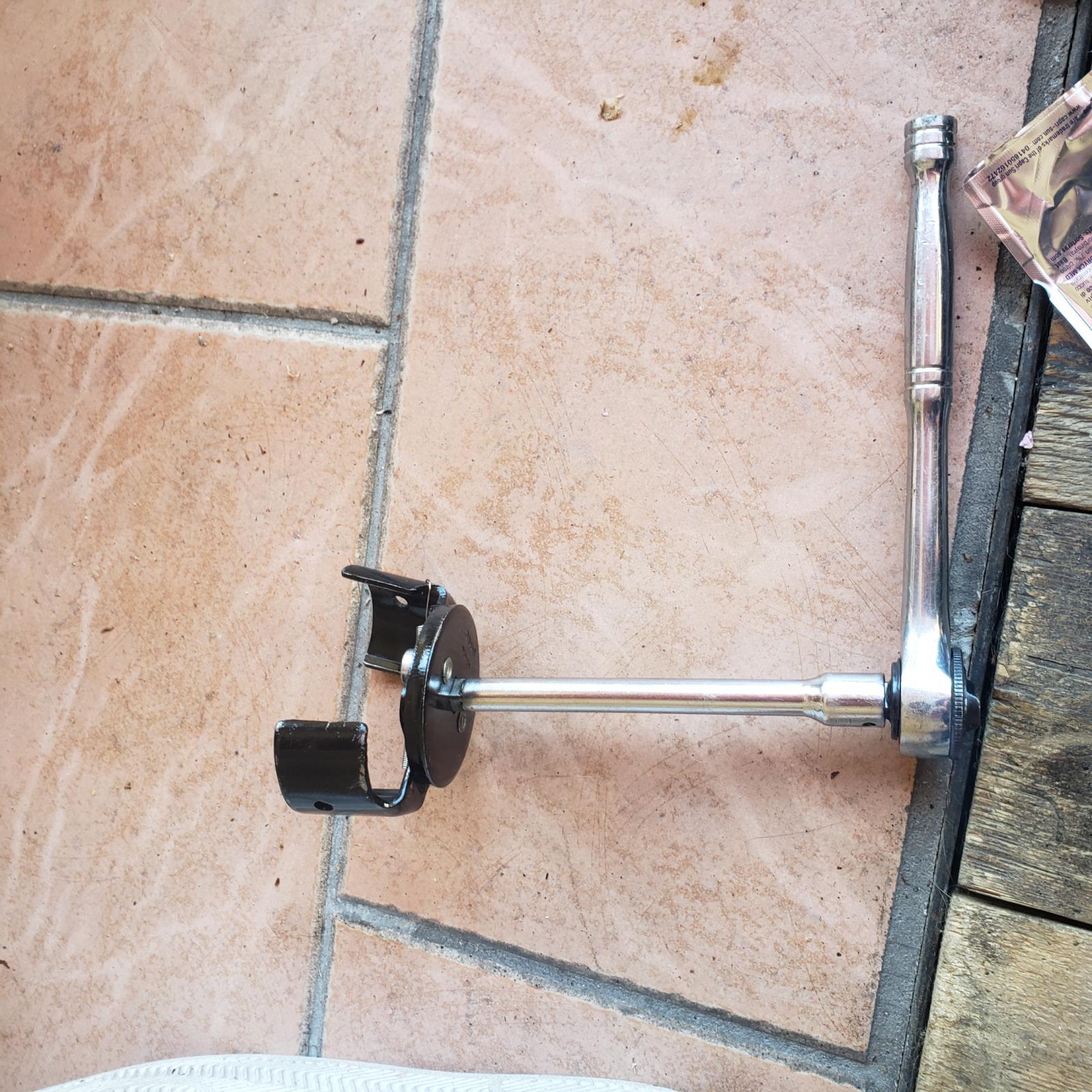

Step 6: Using a filter housing tool you've had since the early 90s..... or a BMW approved one :)..... remove the filter housing and filter assembly.
Note: whatever you use, it needs to be a "top mount" style oil filter wrench. There is no access to turn from the side.

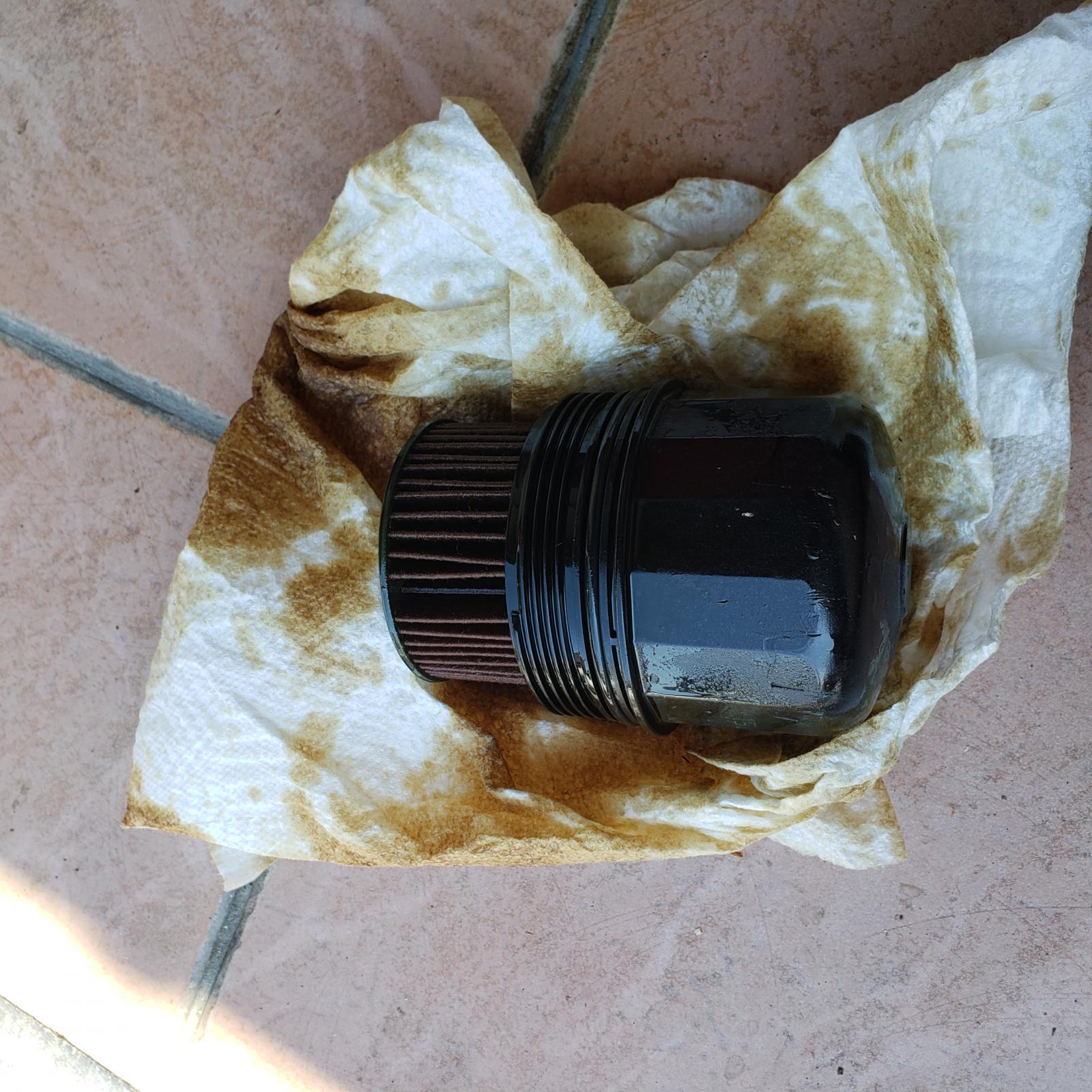

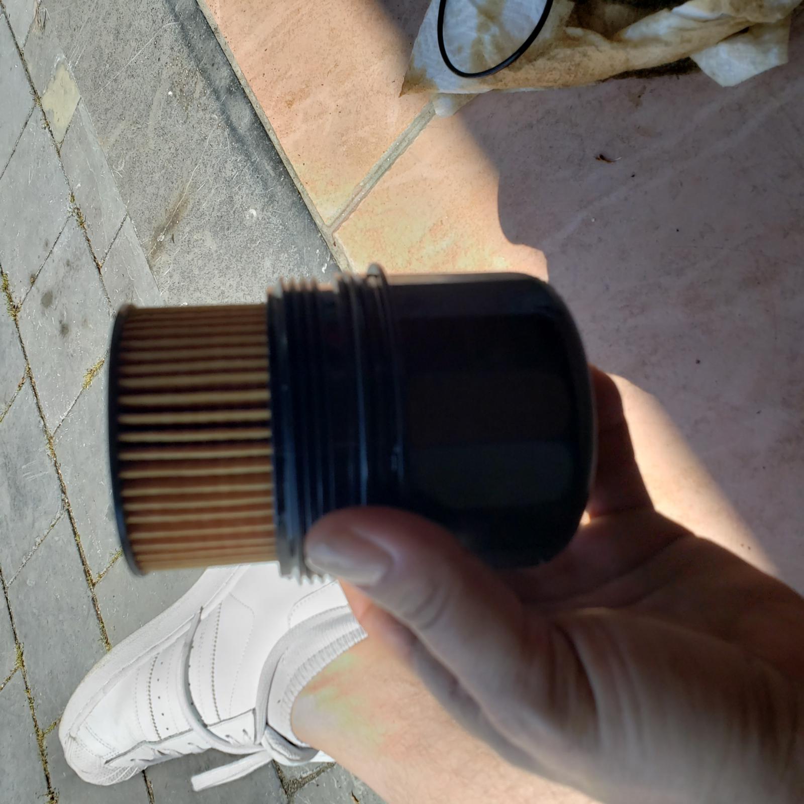

Step 7: pop the old filter out (just pull up with a little force).
Step 8; replace filter in the exact same orientation (filter label down inside the housing).... push firmly until it snaps in.
Note; small rubber O-ring is not used.

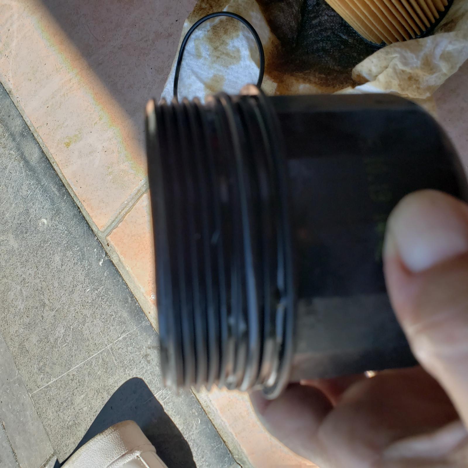

Step 9; replace large rubber o-ring around the outside of the filter housing
Step 10; Replace filter housing and filter assembly in the exact same orientation as removed

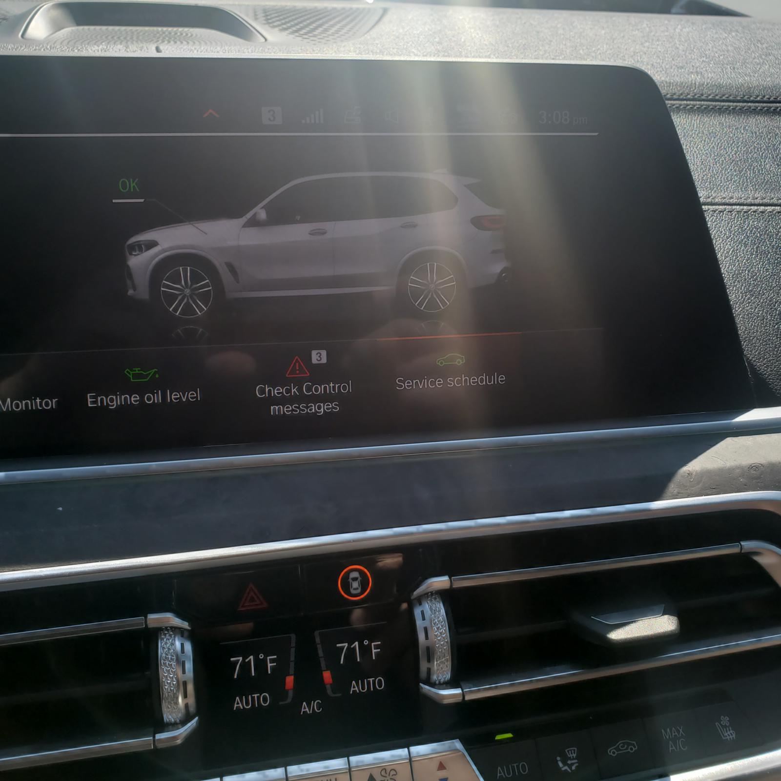

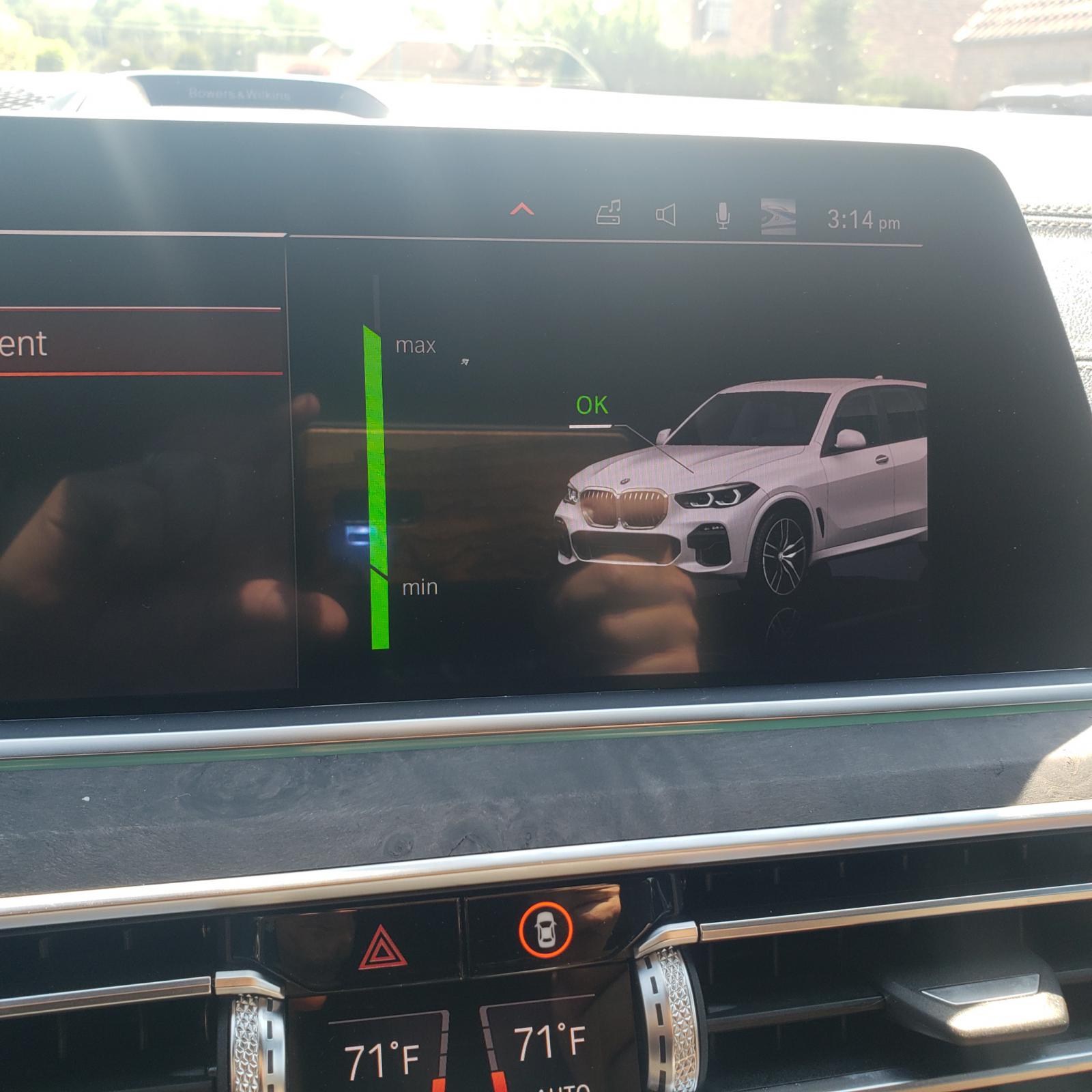

Step 14; Start your car normally, allow it to warm up (it will only measure after the car is at full operating temp) and check the oil level in the following steps on Idrive;
