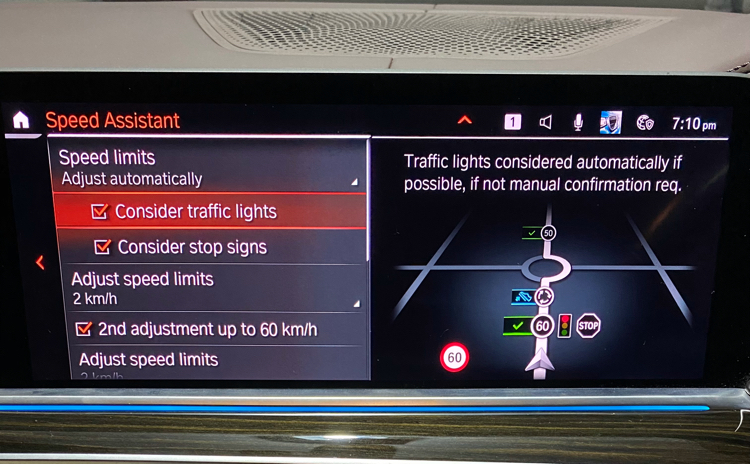

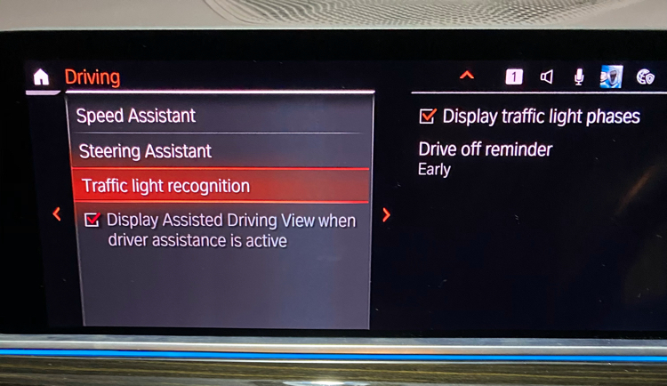

I have been working on TLA/TLR since the last two weeks and have made some progress. I was wondering if someone is willing to work jointly on this and we identify the missing piece of the puzzle.
Checked the blocking options codes 8LK & 8LR not present on my Aussie car.
I have so far discovered all the relevant codes from BDC_BODY and HU_MGU.
Traffic Light Assistant
1.Consider Traffic lights (visible and enabled)
2.Consider Stop signs (visible and enabled)
3.Resume at green Traffic Light
Traffic Light recognition
Display traffic light phases (visible and enabled)

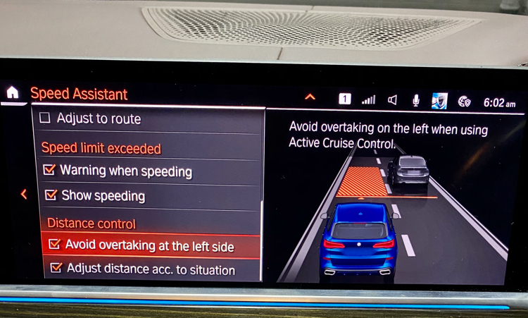

Distance Control
1. Avoid overtaking at the left side
2. Adjust distance acc. to situation

I have updated the first post the link for the codes and also included codes for Distance Control

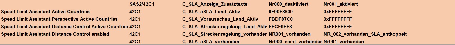

I have made some progress and found codes in SAS3, these are definitely required for TLA/TLR requires UCC (Urban Cruise Control). Also the same codes are in DSC_VIP but I am not able to code anything in the ECU getting error. Have to wait for update from Esysx.
As soon as I enable the codes I get "Function not available in this Country"
It will give the same message for all the countries as below, it is blocked by Salapa condtions. China, Gulf, Japan, Korea, Australia, India, Brazil, Turkey, HK, Mexico,
Singapore, Taiwan and Russia.
Someone from Europe or UK can you please try and advise if it works?

Hi Rex,
It won't work, it even checks the VO code and few more codes on other ECU's. Even if you change the VO code it still won't work.
