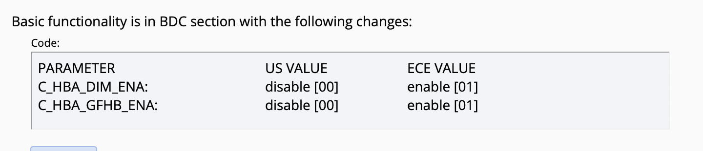

You can't fully implement anti dazzle using Bimmercode since it does not have access to all of the ECUs required. If you aren't going to get it done again by a coder using E-Sys you can implement a faux version using Bimmercode. I did that on my X5 and M340i and have not had any issues as it seems to work pretty well.

I updated the code using TB's code provided on the 1st page of this thread through BC - I will report back in a few days after I have tried out the Anti Dazzle at night.

I finally got an opportunity to try out the anti dazzle and the lights worked perfectly. I couldn’t discern any difference from when the lights were previously coded remotely. No one flashed. Lights went to high beams on dark roads and stayed on hi beams both when following and with on coming traffic. Good to go :)

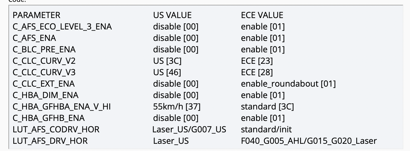

Alright. I have Laser Lights on my 2021 X5 and at times do long trips. My high beams turn on automatically and temporarily turn off with on coming traffic. I have done a bunch of Bimmer Coding.
It would be cool to code the Anti-Dazzle on.
All I need to do is follow TurtleBoy’s instructions?
You may want to try G05_Laser_ECE for LUT_AFS_DRV_HOR since the code below is from someone coding the G20. Obviously you want to use the ECE values and not the US.

Correct. In BC expert mode find entries from left column (easier to use keyword search from inside expert mode. They should be defaulted to middle column (US), chenge the selection to right column (Euro). For the last line, select G05 laser. Go slow to ensure you are changing the correct code because many lines appear similar at first look. Good luck.
So using expert mode in bimmercode will allow the full anti-dazzle feature?

Not full like the Euro cars. Per Turtle, it is pretty close for us in America.

No, not at all as you can't access all of the ECUs. You can enable a faux version that works very well.
