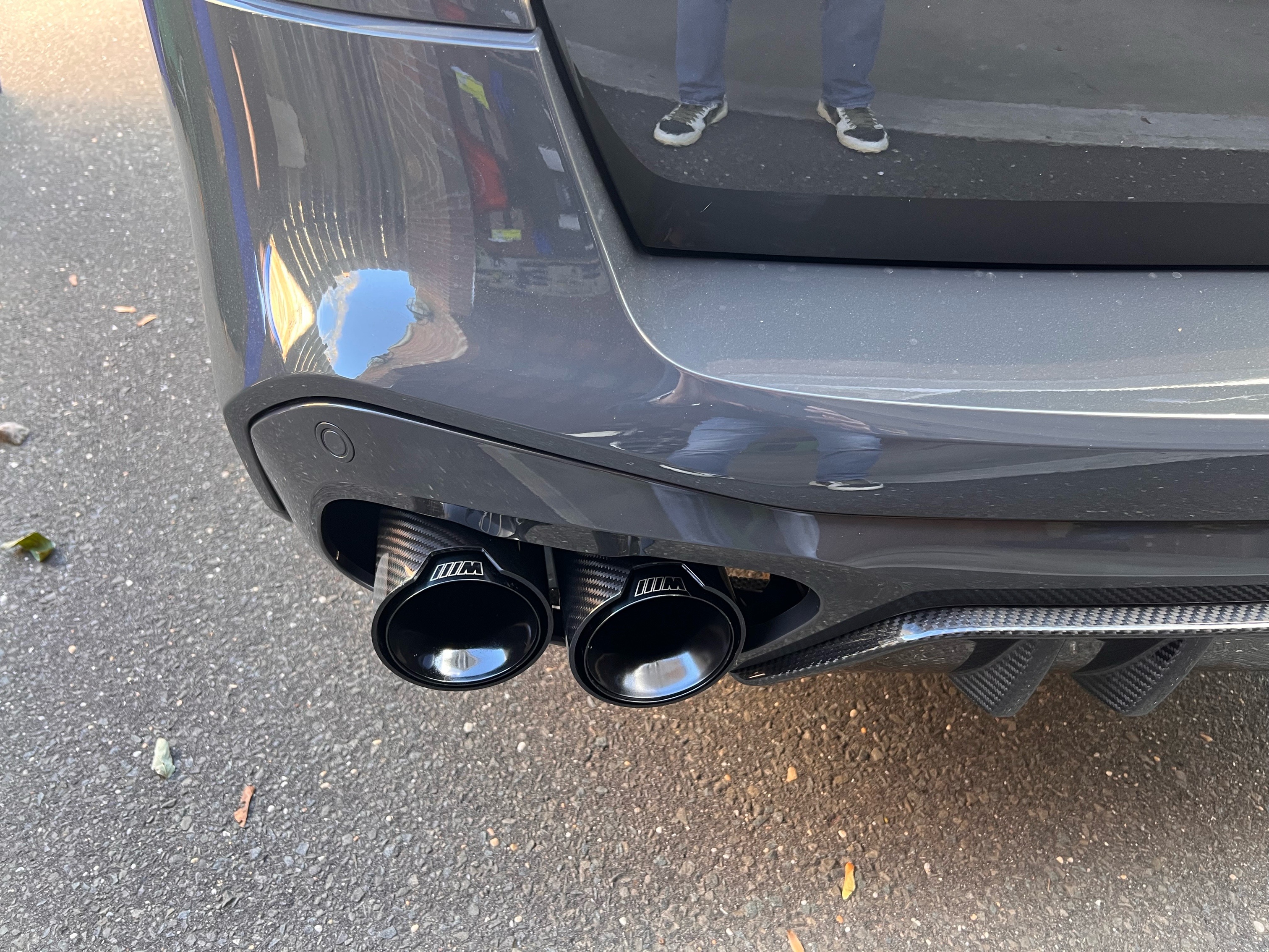

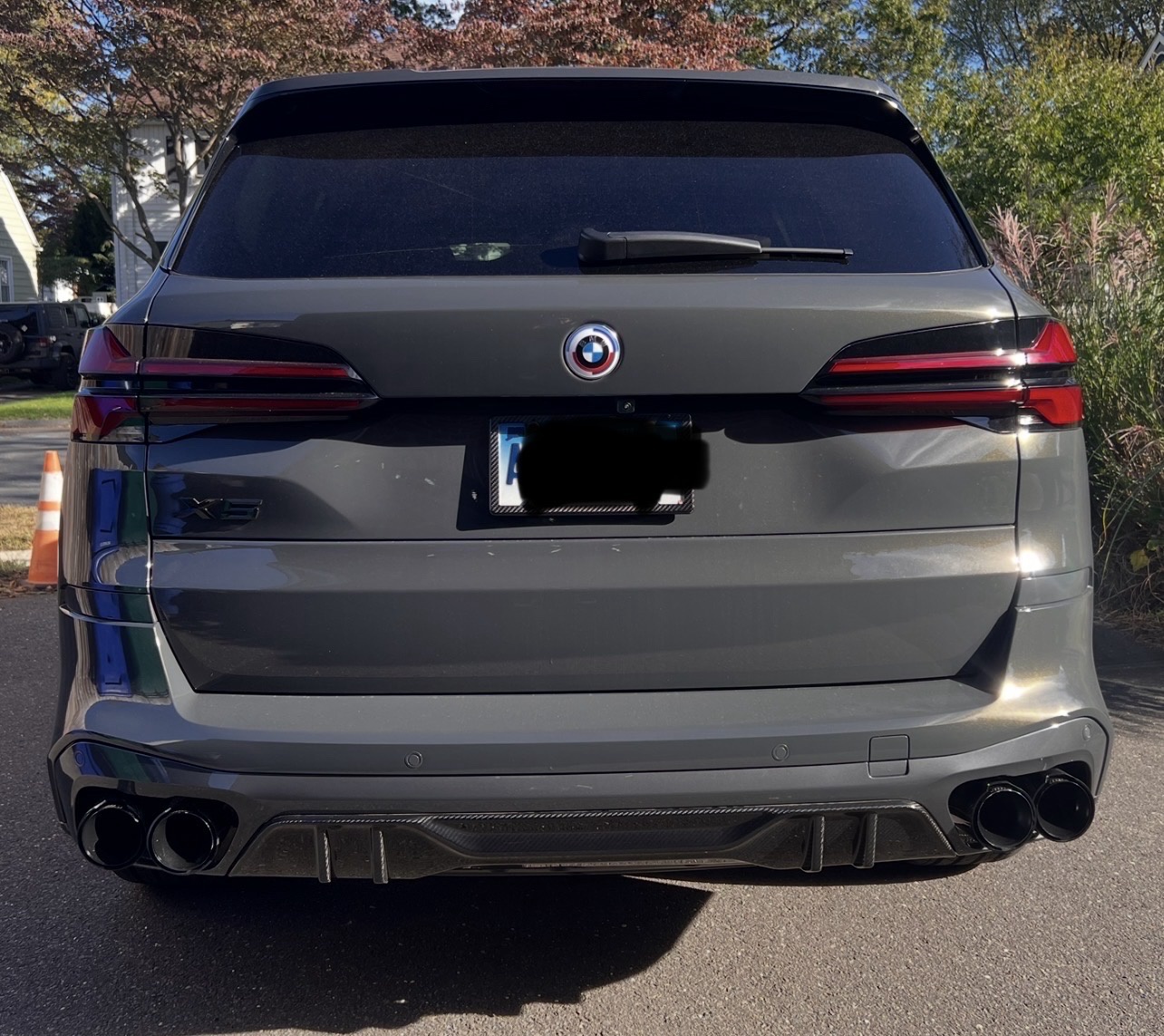

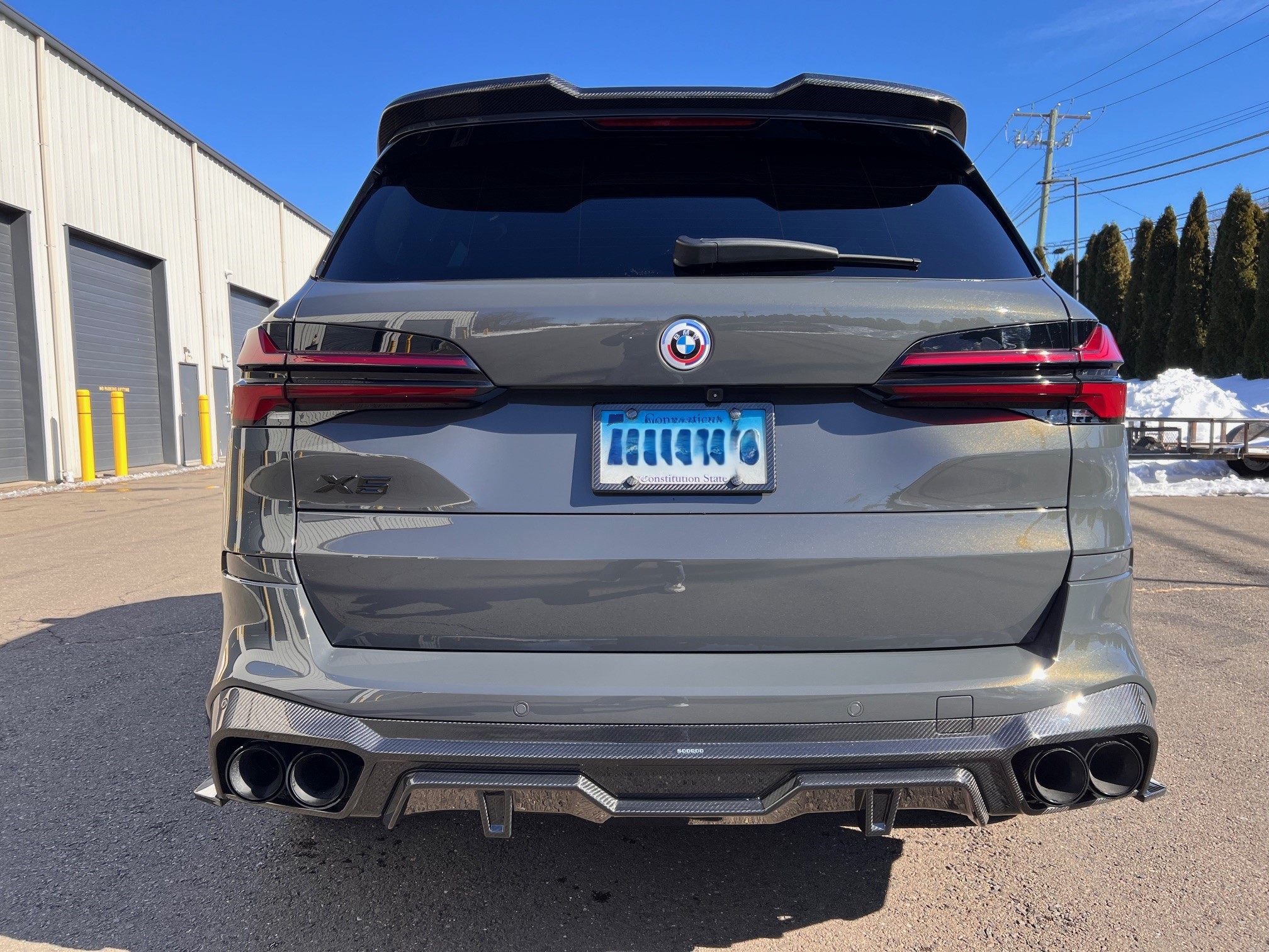

I've installed these on my 2025 LCI 40i M Sport. They were literally plug and play, no cutting, no soldering, no removing any piece from the rear bumper was necessary.

Looks great but not an easy install. A few things the indy shop did:
1. Removed the rectangular trim (matte black) which i just got recently as part of the m performance exhaust install done by bmw.
2. Cut about an inch from the m performance exhaust so the tips won’t stick out too much (just enough to show the m logo on the tips).
3. Removed an inner plastic trim which screws portion of the heat shield. But heat shield is very secure and not going anywhere (we’ll see and find out, lol).

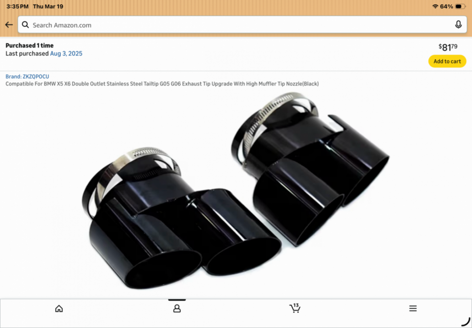

ingmalopez wrotehttps://monacoms.com/2019-2023-bmw-x5-x6-x7-40i-g05-g06-g07-m-performance-quad-exhaust-tips-carbon-fiber-stainless-steel-silver-gloss-black/yeah, it look sick they really stand out, can you share where did you purchase it. I see a lot of like but these are the one to go with. Thank you for sharing
AlexGT wroteHow are these tips holding up? Wondering the same no idea how to get a wrench in there for tightening themSure, here it is:
Quad Exhaust Tip Compatible For BMW G05 X5 G06 X6 G07 X7 2019+ 30i 40i Muffler Tip Exhaust Tip Nozzle(Black B) https://a.co/d/cg2eni9
And sorry, but I didn’t install them myself, a shop did the job and it took them like 20 minutes to do so.

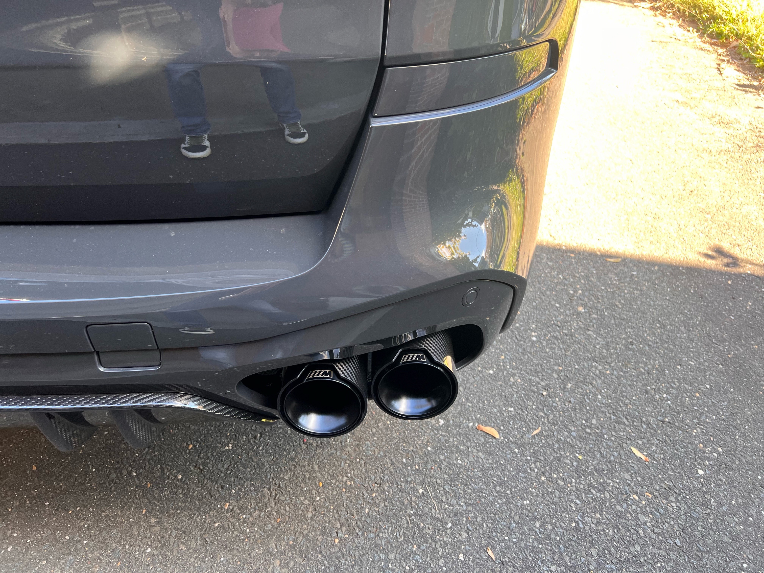

Had to remove the inner trim because the tips won't fit.

Mr. Stiver wroteLooks good! Do you have a link for the product? What was required on the install?I went with the Chinese ones from Amazon. Super easy to install.
