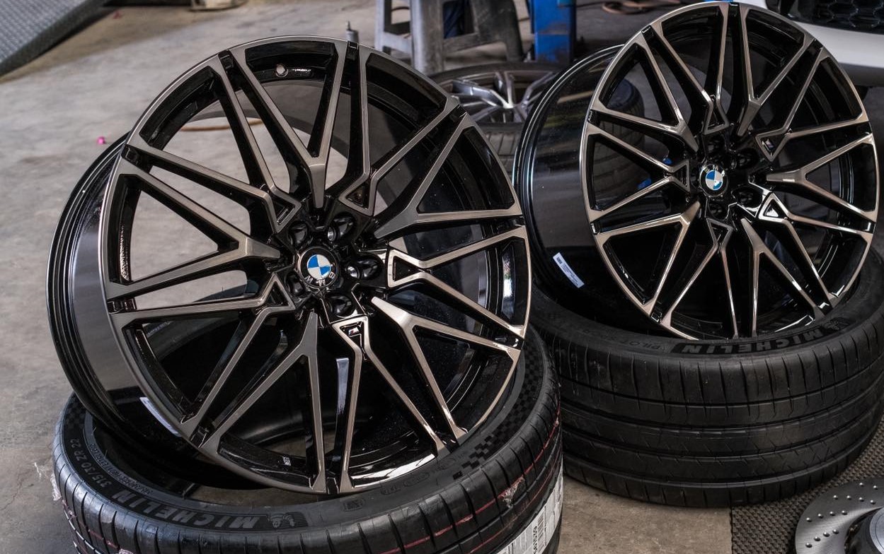

05-06-2024
BMW F96 X6M 818M wheels on!
05-06-2024
Those puppies look good.

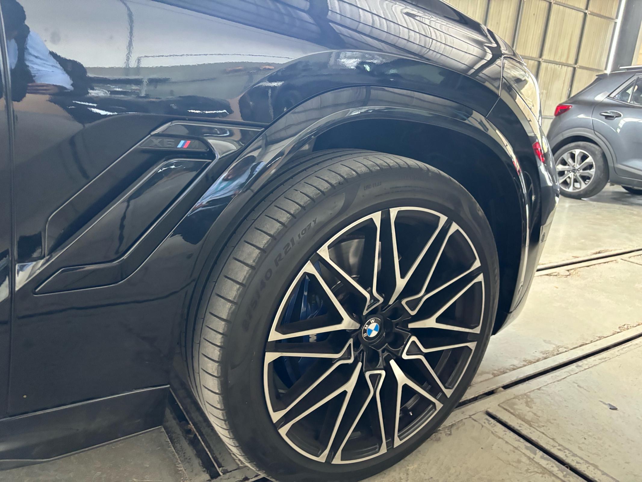

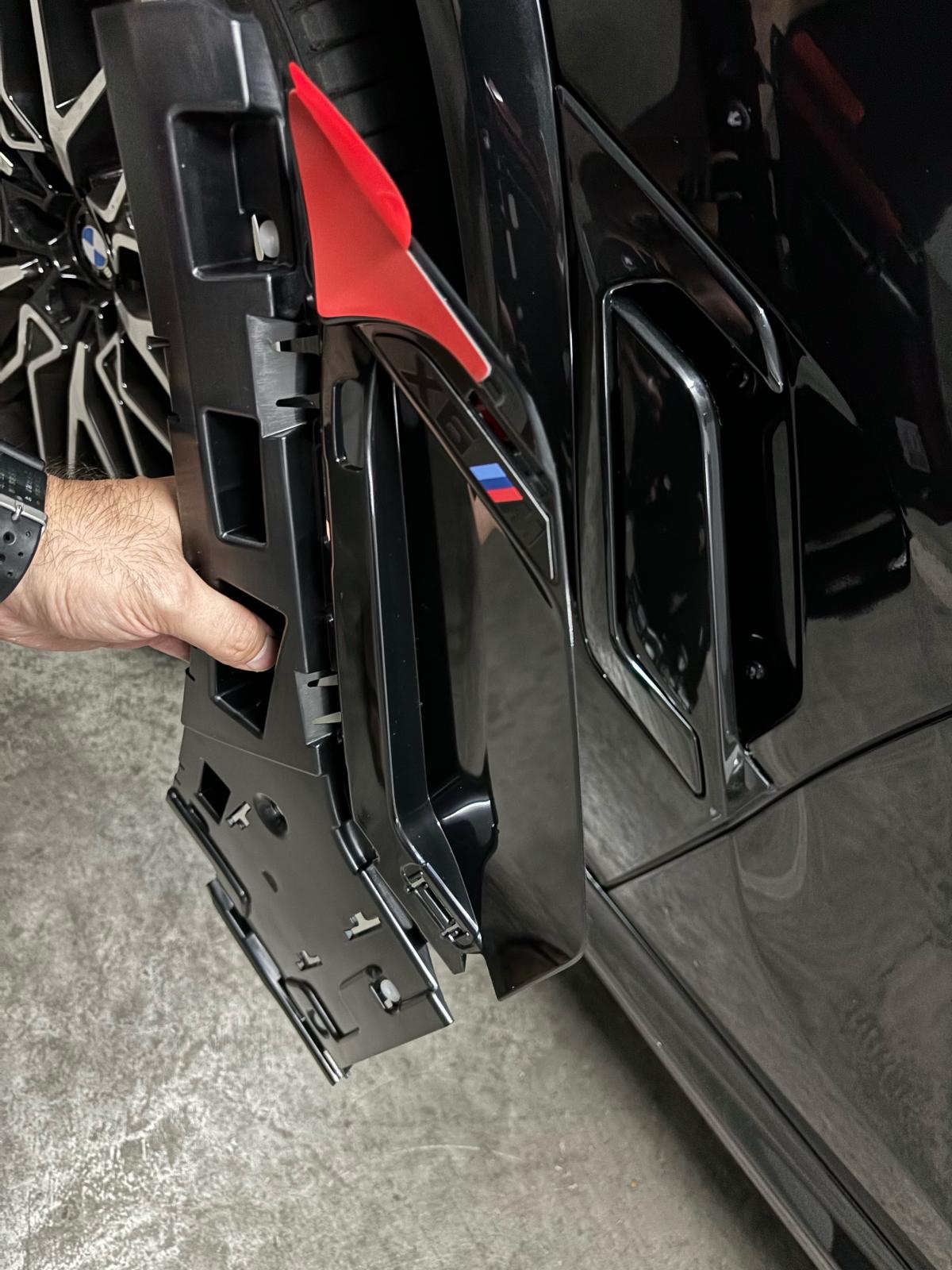

07-01-2024
Update.
Genuine X6M F96 fender inserts installed

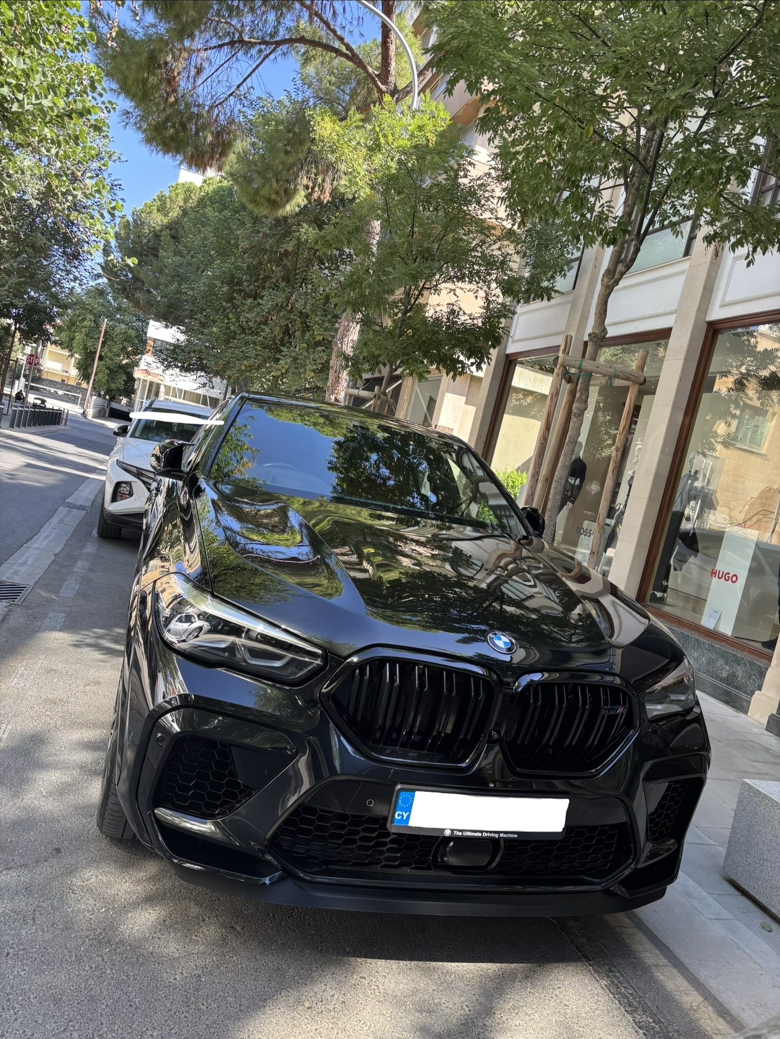

07-19-2025
Update ***
OEM BMW F96 X6M grille installed on G06.
1. Due to the presence of active shutters on non M models the grille has more depth and cannot be fitted so it must be trimmed on the back side of the slats. Clips are exactly the same and fits perfectly if trimmed.
2. Iconic Glow LED had to be removed as there are no screws for it on the M grille. Wire was taped and no warning on cluster is given for faulty lights as it is decorative.
Other than that it changes the front of the car and makes it much more aggressive. Has nothing to do with aftermarket grilles.

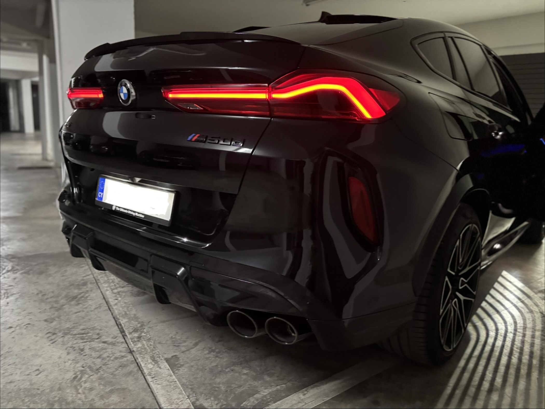

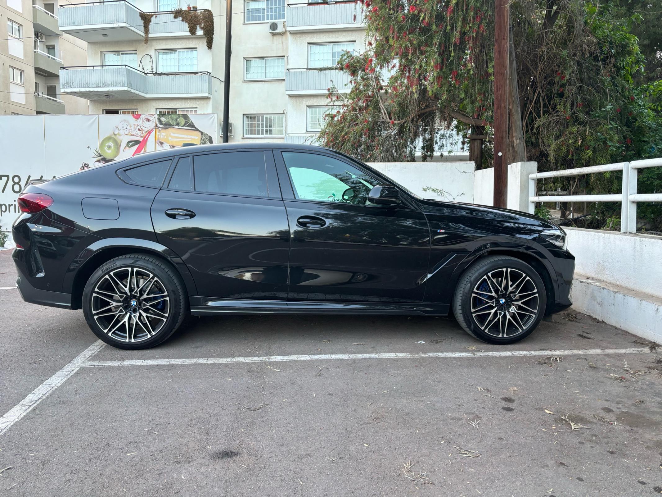

01-22-2026
ฮ™ wanted the stock X6M F96 Competition look as almost anything aftermarket i have seen so far for the X6 makes it look cheap and overkill...
So i bought a full conversion kit along with some OEM parts.
Changed the rear logos for OEM blacked out ones.
Car looks killer in Sapphire Black with the contrasting Tartufo Merino individual leather interior and 818M wheels.
