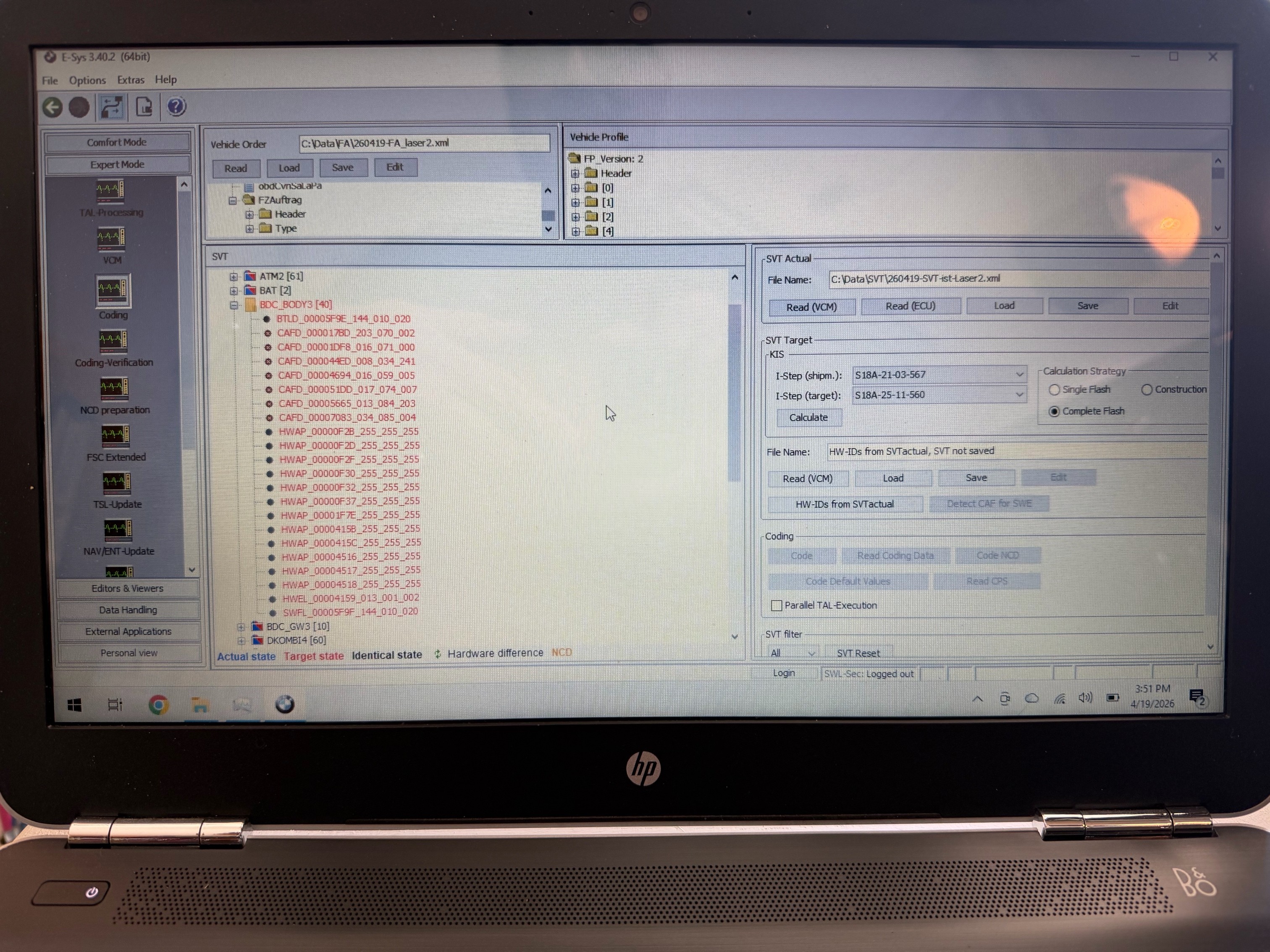

Hey guys....
I ran into an issue that I hope you know how to address...
I retrofitted Laser lights, with the correct modules (5CFF hardware). At least one of them had outdated software, so I needed to flash to the correct firmware, which I was able to do successfully (I think, because they now work as they should).
The car is currently at I-Step 23-11-350, shipment I-Step is 21-03-567, so I used I-Step target 25-11-560 to calculate SVT target because that is the oldest, closest to the I-step of the rest of the car that is in the psdzdata I have. I did the calc for the complete car, but only flashed the two FLM ECUs , nothing else.
Now, I am trying to do anti-dazzle coding in BDC_BODY3, but I now notice that it doesn't show up in the SVT I read from the car, only BDC_GW3 shows up. I redid a SVT Target calc and I see BDC_BODY3 as all red, like it is completely new. Old vs. new number of ECU's is 28 vs. 29, so it shows it detected an additional ECU.
The TAL matrix in Processing shows a hwInstall for BDC_BODY3 and a hwDeinstall plus hwInstall for BDC_GW3, followed by blFlash, swDeploy, cdDeploy for both. BDC_GW3 then also has a checkmark by GatewayTableD....
Do you know how to get this straightened out again?
Really appreciate your help!
04-19-2026
Forgot to write that I did the FA update to remove LED lights and insert the Lasers, 5AP was already removed from the FA. I encountered the issue when trying to VO code the BDC_BODY3.

Understood, but first I need to be able to even get to my BDB_BODY3 ECU, which I currently cannot. I am reinstalling ISTA+ but I am less familiar with that one than E-Sys. I'll try what you suggested with the diagnosing and test plan.
If anybody has any other input as to why the BDC_BODY3 doesn't show up anymore in the SVT list or how to fix it, I would welcome any further suggestions.

Can you share a print screen" of your missing ECUs in E-Sys?
04-20-2026
Here is the screenshot that shows the BDC_BODY3 is completely missing and needs to be added (red).
When trying to “read ECUs” from the VCM screen instead of the Coding screen I got an error for Ethernet to ECU 10 which is the BDC_GW3. Not sure why that error is present all of the sudden.

Figured it out finally! For everyone else's benefit, the actual solution was something simple. I got ISTA+ working finally and it pointed me to voltage low on the BDC ECU when I was coding before in NOV and now, this past weekend.
The actual fault was no ethernet connection to the BDC, but if you dig further into it with ISTA it showed three instances where the voltage dropped low on that unit and all three were when I was coding it. Measuring voltage and amps at the main battery when the car is in PAD mode revealed that my charger that I hooked up to the battery is not keeping pace with usage, resulting in a few amps of discharge from the battery even when the charger is connected. So that is what caused it I believe.
Now, to fix it, I had read elsewhere about someone with the same problem (BDC_BODY3 not showing up) that he resolved it with a simple restart of the ECUs by disconnecting the battery. I disconnected mine and charged it while it was disconnected. I had to wait more than 5 mins for the interior lights and the head unit to die. I was starting to wonder where the power was coming from, but then it did die. I left it 15mins to make sure then reconnected the battery. After about 5 mins, I turned on PAD mode again, hooked up E-Sys and BDC_BODY3 was there again!
I read FA, ECUs (SVT-ist) and then did a calc for SVT-soll and everything is black again.
I then finally finished off with the FDL coding for anti-dazzle.
