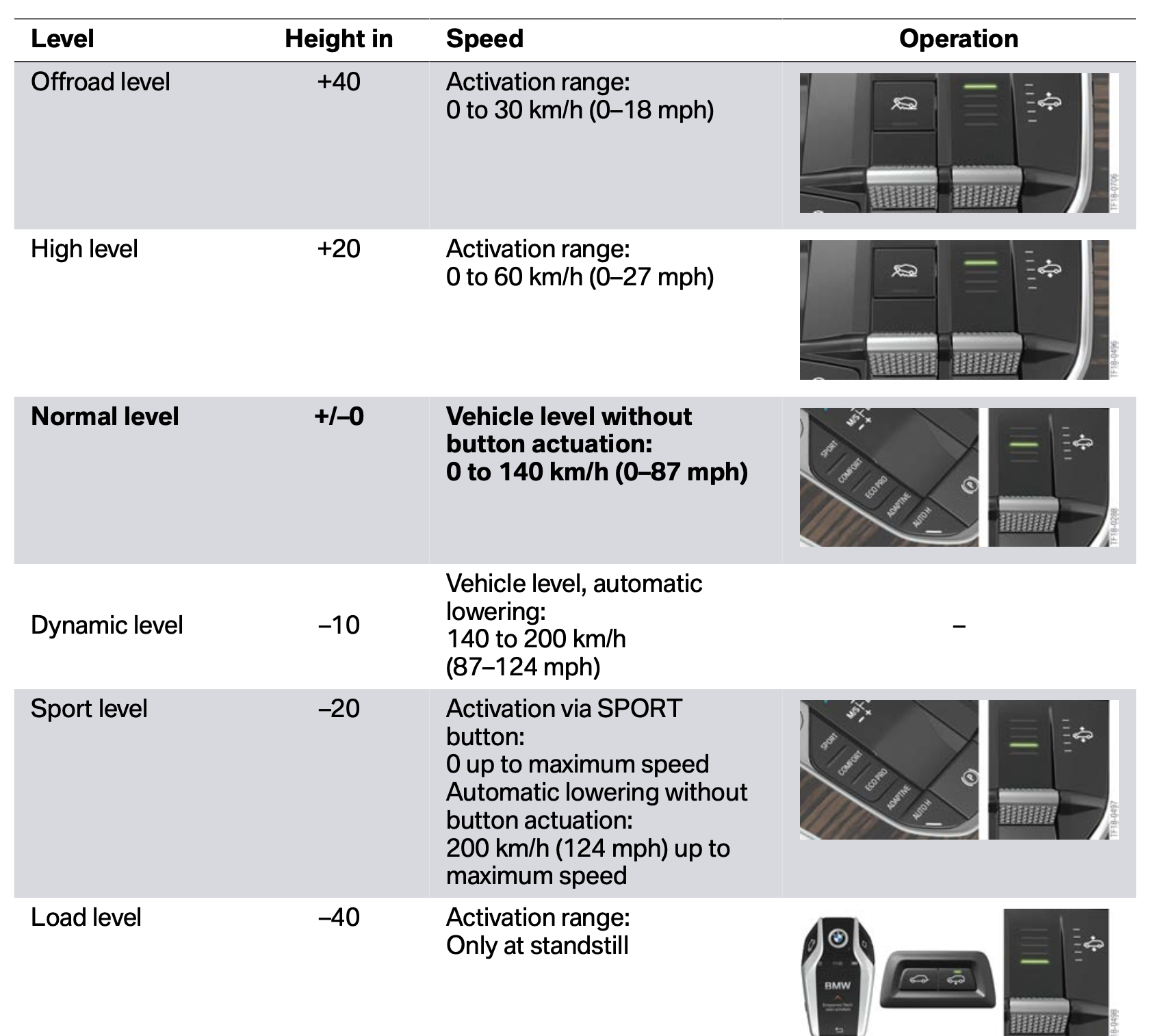

Is 20 mm the total range of height adjustment? I’m wondering how much it can be lowered for entry and exit. Some of us who aren’t 18 any more would appreciate not having to climb up into the car. And since we can’t get wagons in the US any more….

Timmer-Bimmer wrote
4 inches is the range of height adjustment. But the base driving height is in the middle, so you can go two inches lower for ease of entry, and two inches higher for bumpy terrain. Also, sport mode puts it 1 inch lower.
Note: 4 inches = 101.6mm, so you can go down 50mm and up 50mm. And down 25mm for sport mode.
The range is 80mm. You can lower it a total of 40mm which is 1.5 inches.

Luckily, the normal height is about ideal for me, but I do lower it when I've got a load to add or remove from the rear...that just makes the lifting a little easier.
And, no, there's no way to force the thing to the lowest level automatically when you shut it off. You have to do it manually each time, and then, if you open a door prior to it reaching that low point, it stops.

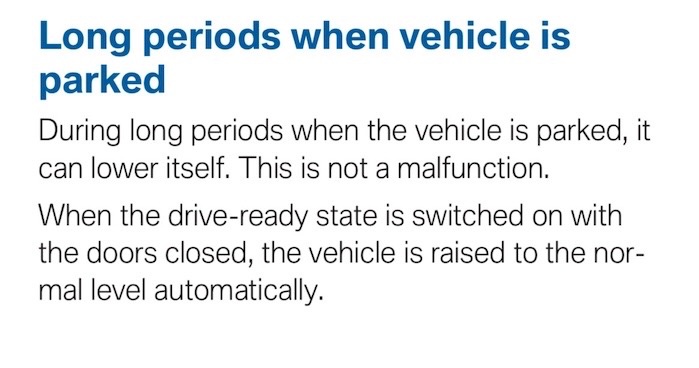

I'm a new X5 owner with air suspension and am just starting to figure out how everything works. I have noticed that mine does lower itself when I power it off. Is there a setting that does this?
As far as I can tell the user has no control over the suspension when off.
I'd *love* a "kneel" mode when in park, or for the car to remember it is in Sport suspension setting. There's no reason BMW can't provide this like other manufacturers do.
As to the original question, the air suspension is pretty good but biased toward comfort. The regular steel spring suspension is also pretty darn good.

Not that I'm aware of, but I suppose for 2026, they may have changed things. Note that if the vehicle was heavily loaded, and everyone gets out, it would rise, just like any spring...but, the air spring control logic would then return the vehicle to its 'normal' height. As being a normally single occupant, the weight change isn't enough for me to notice, but if it was fully loaded, I suppose you would or at least could.

omasou wrote
Good stuff, thanks for sharing. I guess I should RTFM, my bad. LOL
