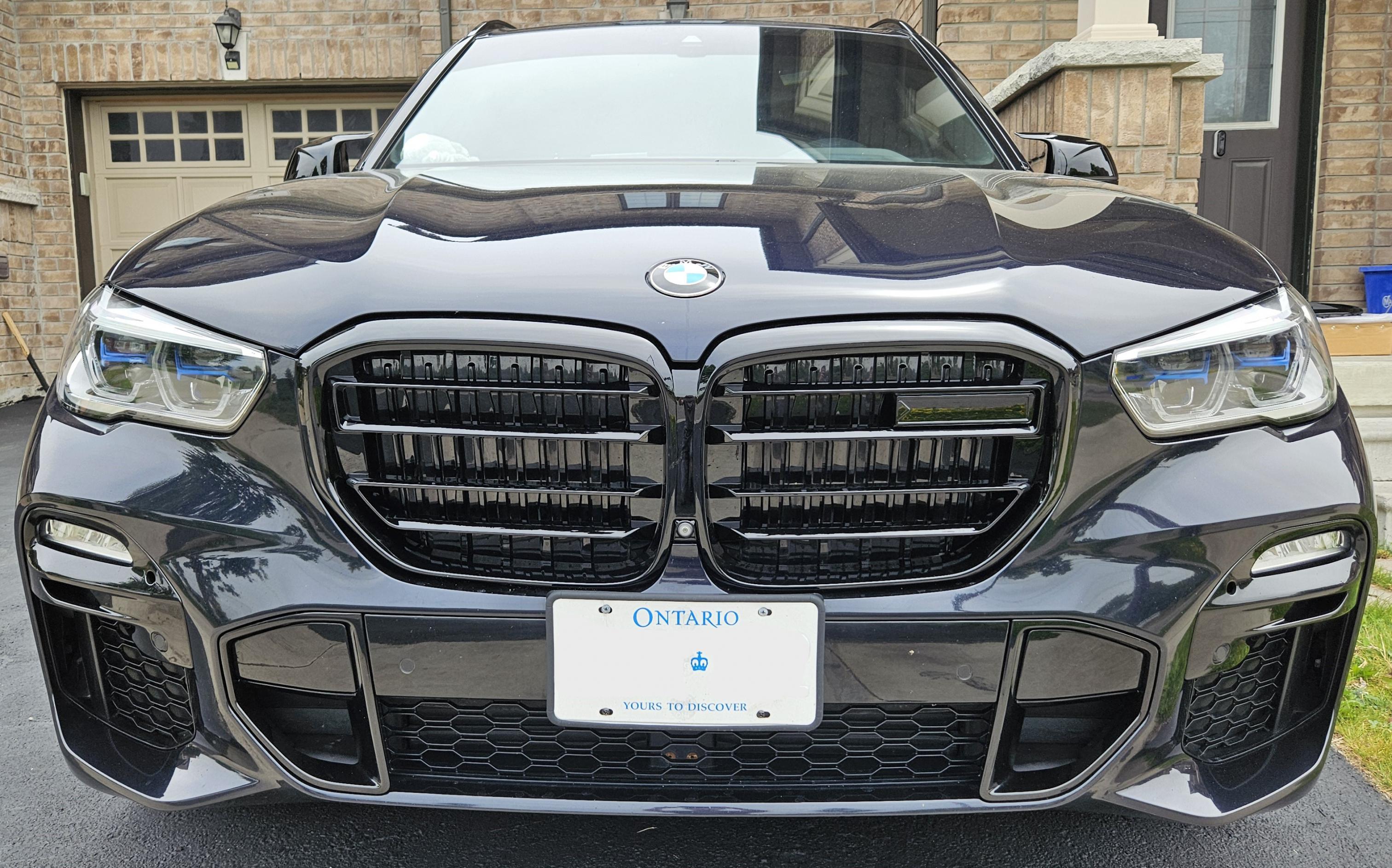

I broke another pair of slats on the grille for the second time in 5 months - I'm suspecting it's the carwash:mad0259:, but anyway - and it's frustrating to drop $400+ every time this happens. I did order a replacement grille and when I was examining it prior to install, it appeared that screws and clips were holding the different pieces together.
Having a broken piece that I would have thrown out anyway, I figured I had nothing to lose and tried to disassemble it. My hope was that if it was possible, I could use the "good" kidneys from the two broken grilles and make an unbroken part. Much to my surprise, and to the detriment of my finger tips, I was able to take it all apart, splice the pieces together to form a complete grille and install it on the car. :thumsup:
If anyone needs to try doing this, I finally learned that after taking out the bracket that provides rigidity by removing the three screws that hold it on, starting at the bottom center of the whole grille (where the camera housing is located) and working around each kidney to the top of the piece will allow it to come apart. The two halves making up the kidneys simply hook into one another at the center.
