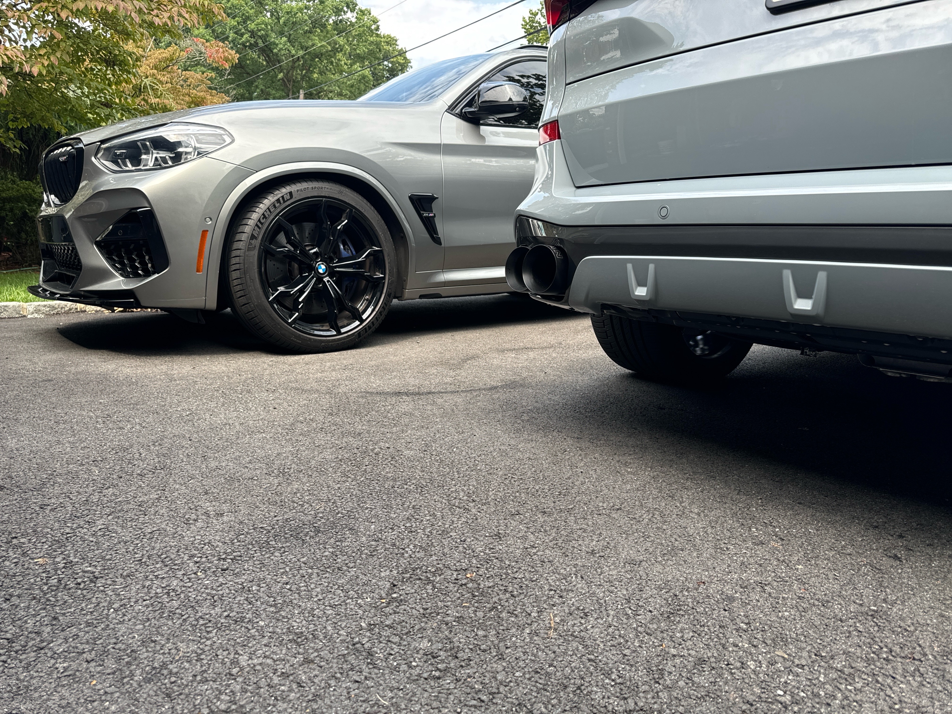

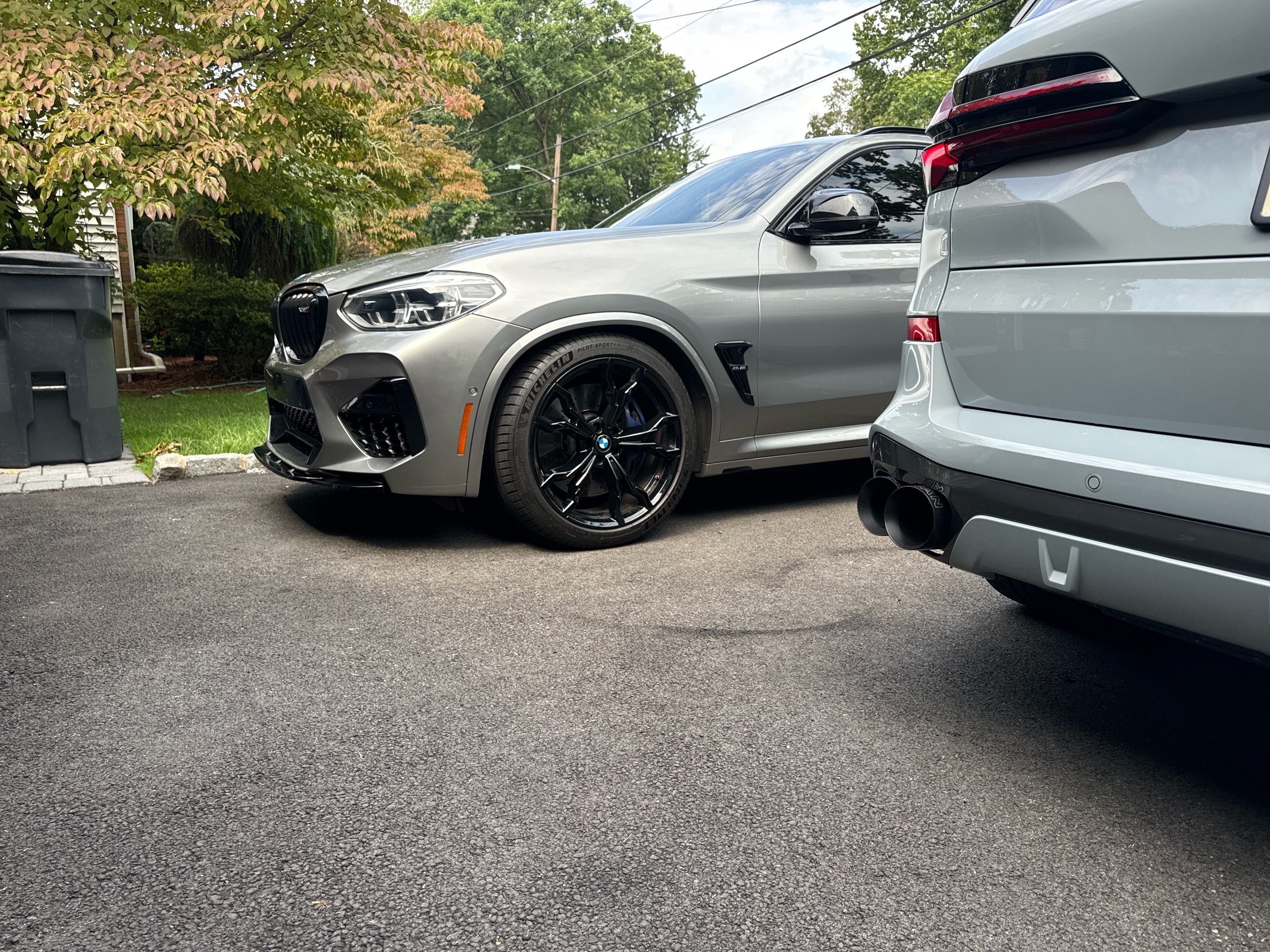

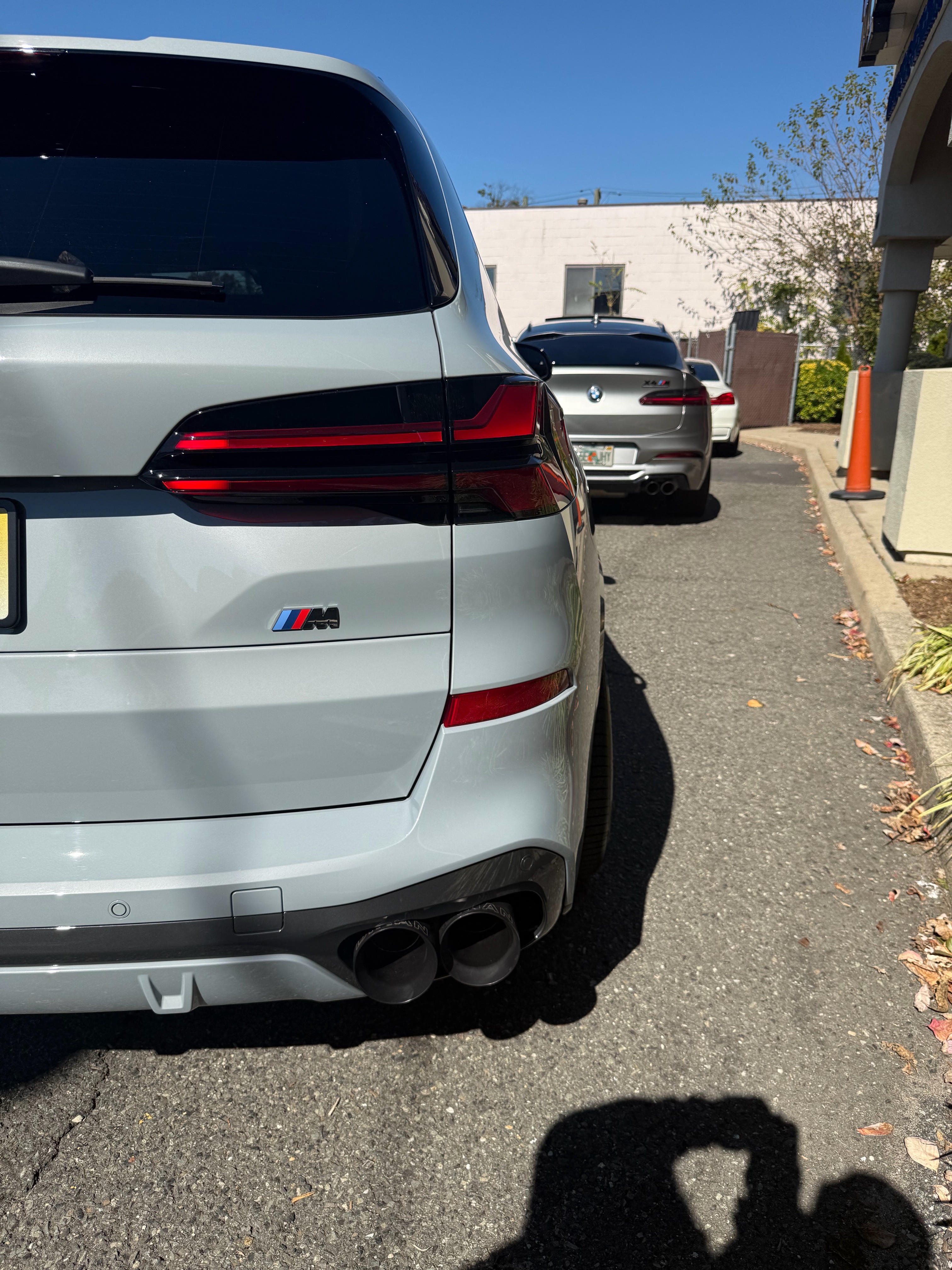

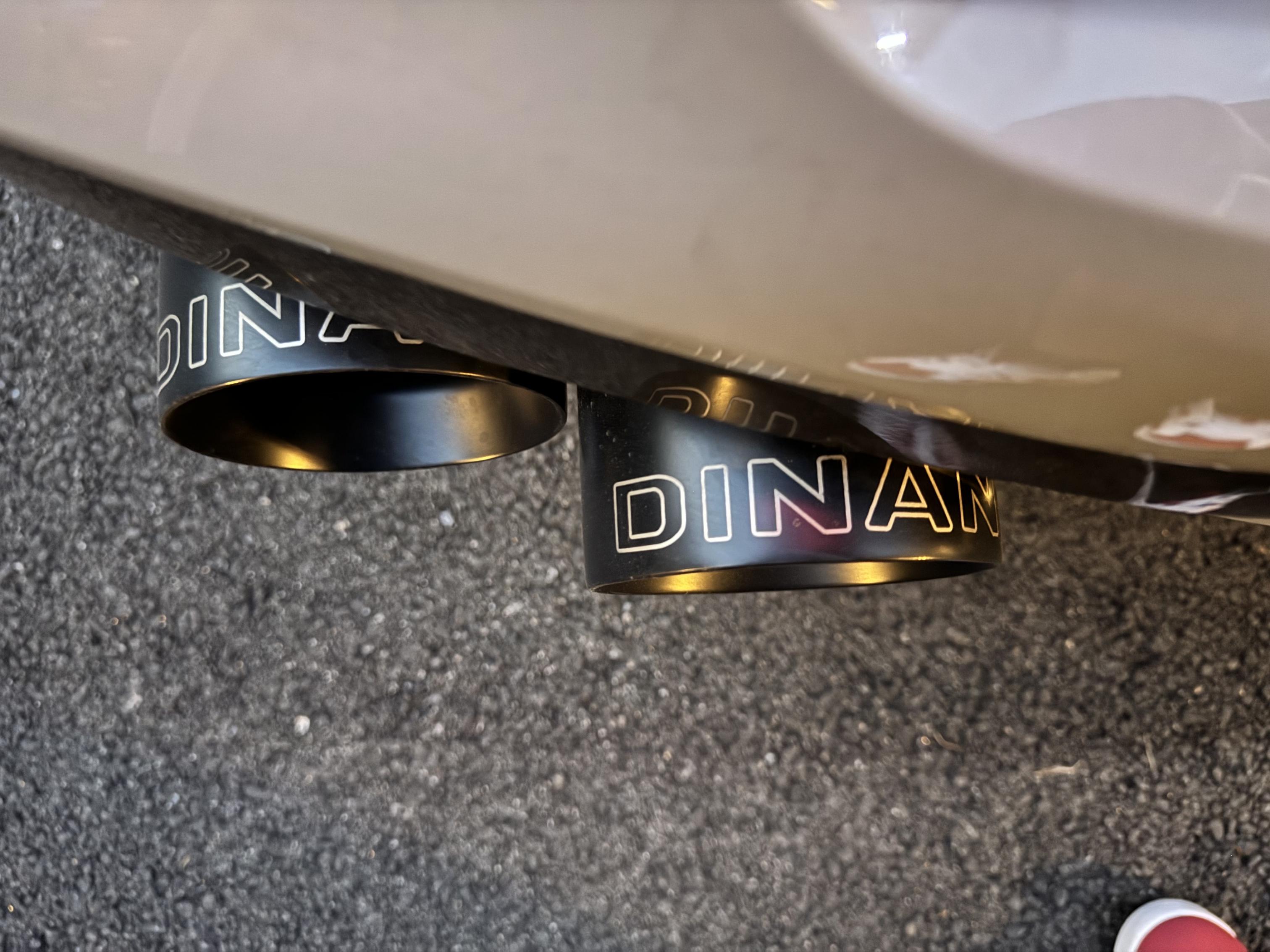

I did the Dinan Axle-Back this past weekend. Minor tweaks needed but sounds good!

Any pics?
08-19-2024
I need to get under an re-adjust the tips and get new actuators since the valves that come from Dinan are not from this model I had to leave it open for now.

How much adjusting to get this to fit? Any sound clips?

Is that the exhaust for the X5M? Is that why the fitment issues? Did U resolve the issues? Looks good.

I used Dinan for Axle Back and Mid pipe. And yes I needed to order as if it was F95 “X5M”. If you look up G05 you instead of F95 you will not find anything. But it is the same S68 V8 and Chasis. Just about everything fits. Only added step was the rear exhaust “Difuser” on the G05 (Plastic and metal divider) needed to be removed. Just 2-3 bolts. The F95 exhaust is exposed from the bottom of the rear bumper as the G05 has some plastic design. The Project Gamma cold air intake is direct bolt on also. Only thing that is you need a custom bracket for the engine cover for a complete secure fitment.
Over all w/ JB4 the car sounds AMAZING and runs great. About 3.2 or 3.3 I believe on 0-60

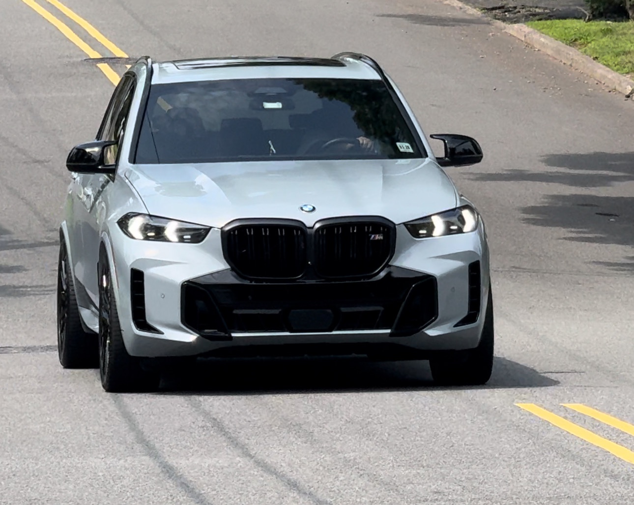

Dinan Axle-Back, valves opened. I will send a new one with the Dinan Mid-Pipe which has cleaner more aggressive tones! [img][/img]
If it doesn’t populate just go to my YouTube and search Mejia809. It is my only post lol. I will get a few more up tho

Sounds good! How's the drone in cabin?
The Dinan midpipe is a brilliant choice for the M60i opposed to a res delete. I'm not sold on the axleback as the tips stick out too far for my liking, but the setup sounds proper for this car. Not raspy, just a deep V8 rumble. I bet if you added secondary downpipes to your setup, it'd get even better.
