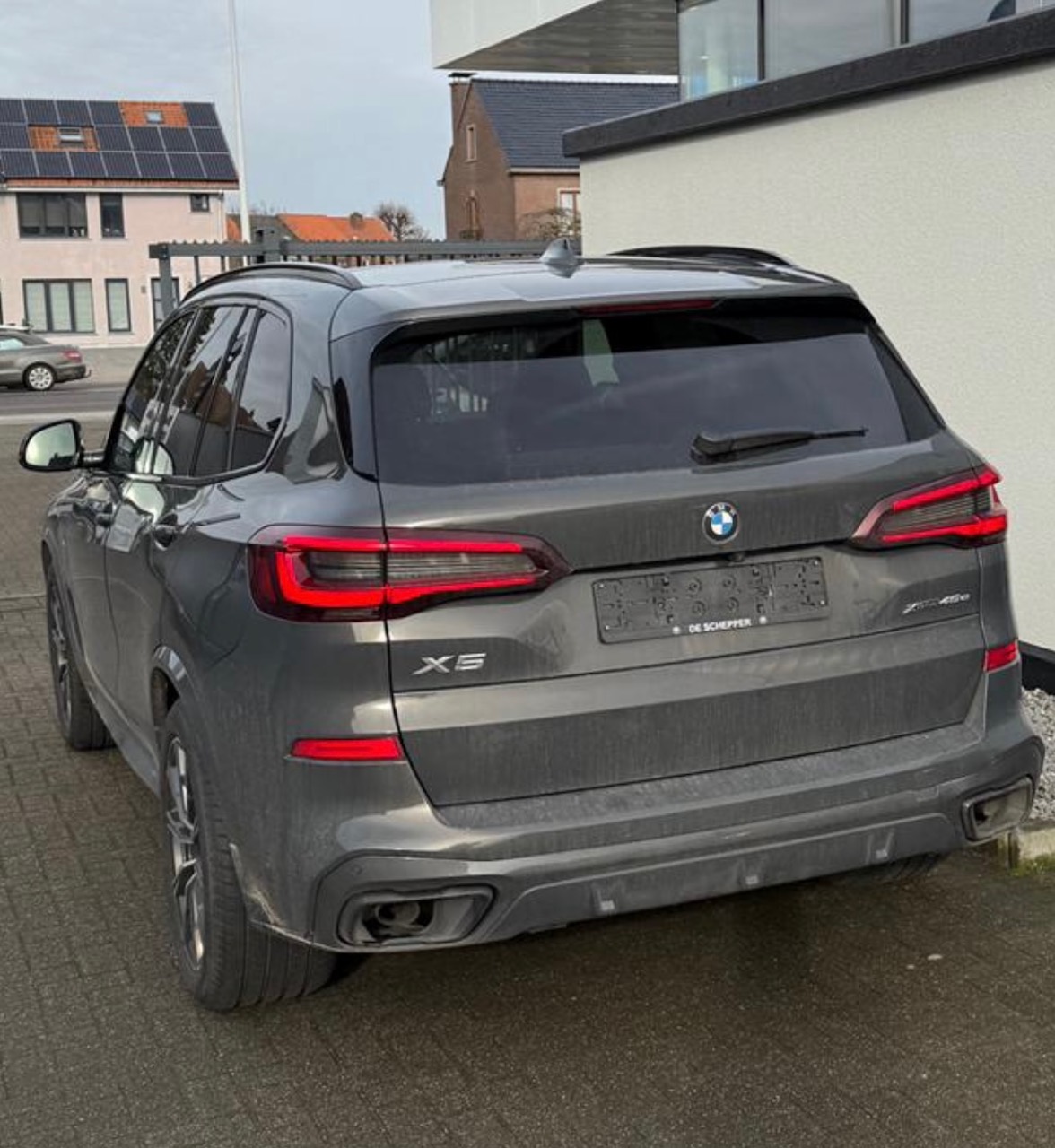

After my accident in june last year where somebody drove me of the road and the car was total loss (BMW F15 40E) I finally found a new one i got end of february (BMW G05 45E) had a great deal car is from end 2021 has 33000 km, not all the options i wanted but a lot, colour als made the desicion.

Meantime i allready did some changes, removed the badges. Since the car has allround shadowline i put a shadowline blaxk X5 badge

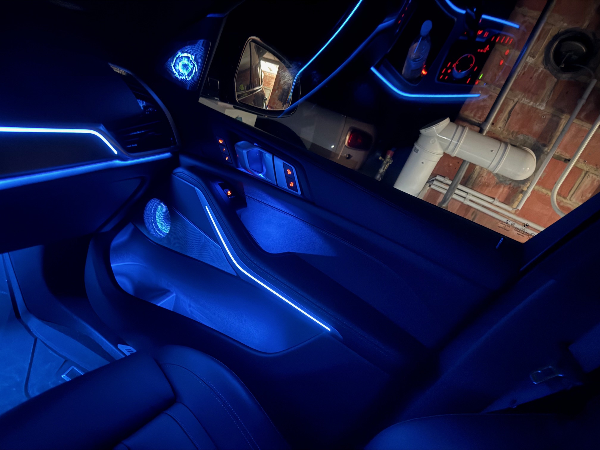

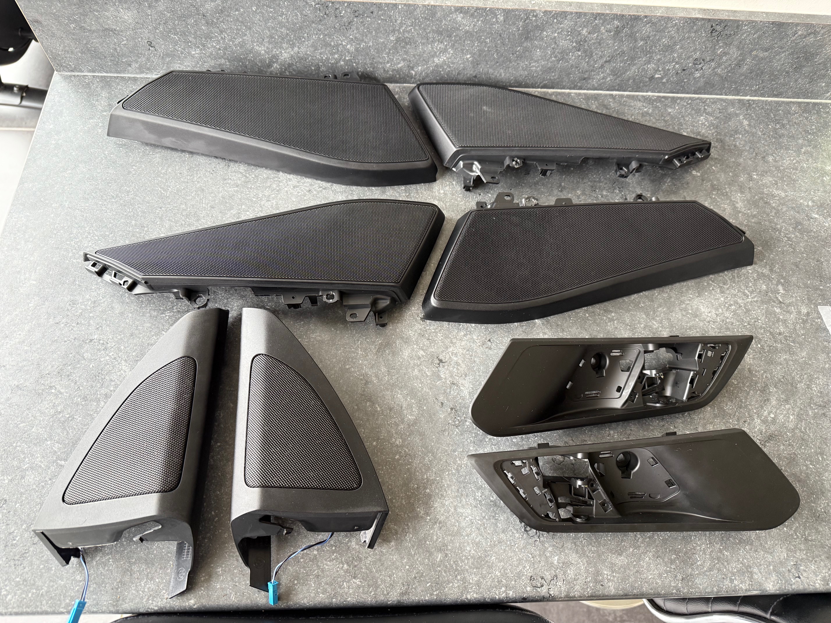

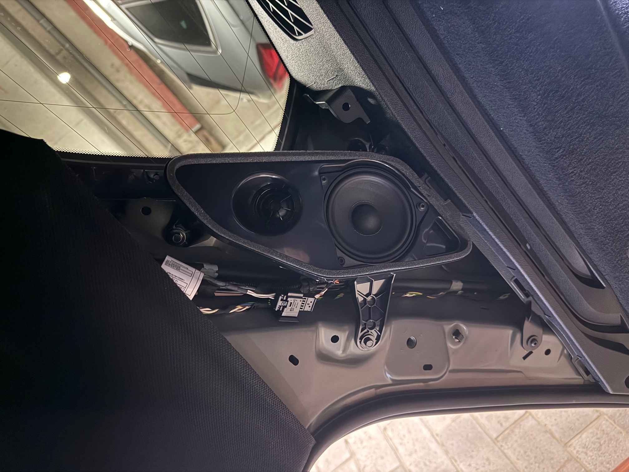

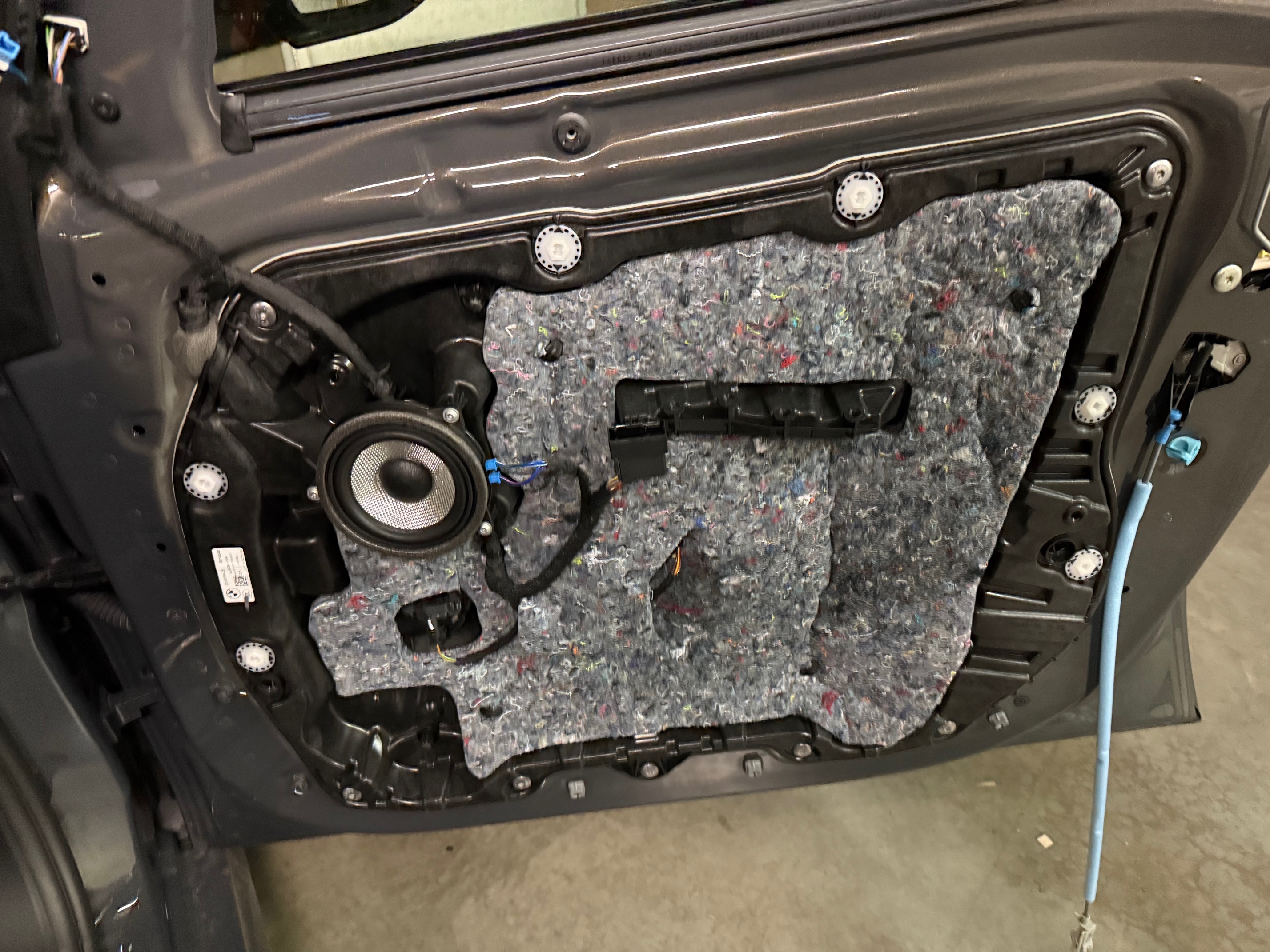

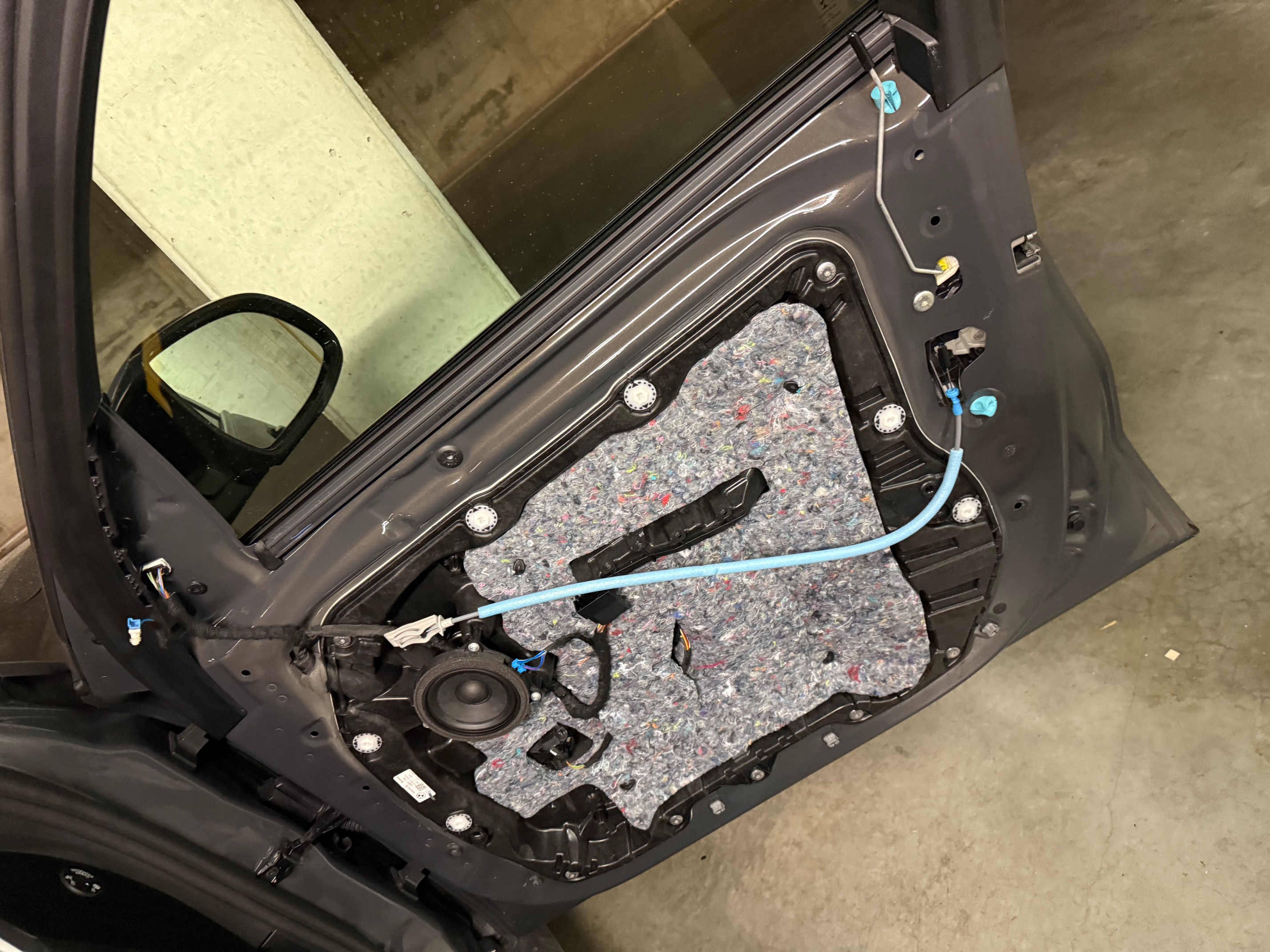

Next i removed the doorpanels and then the hifi speaker covers and replaced the speakers and covers with B&W. Was a lot of work but love the result.

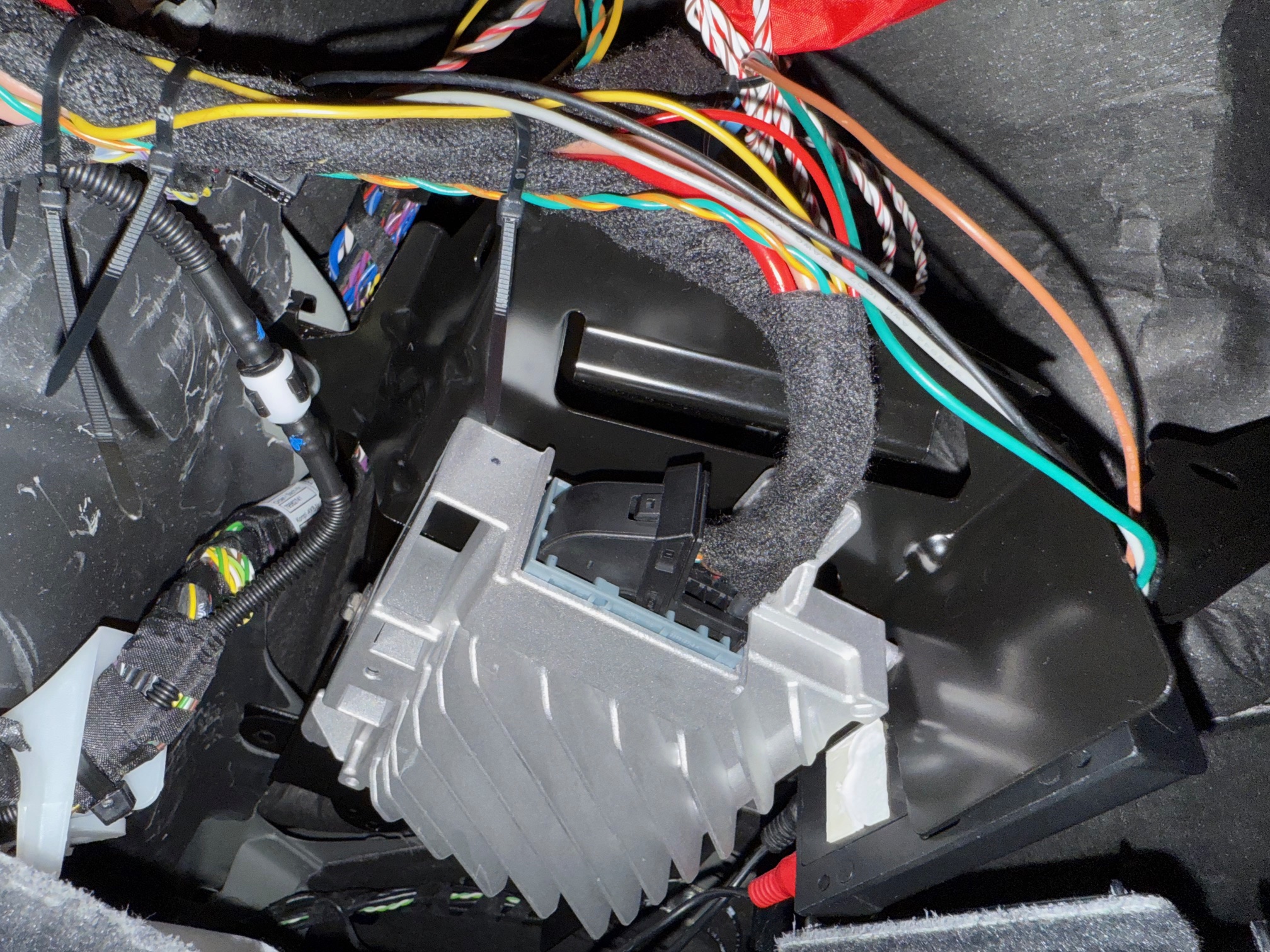

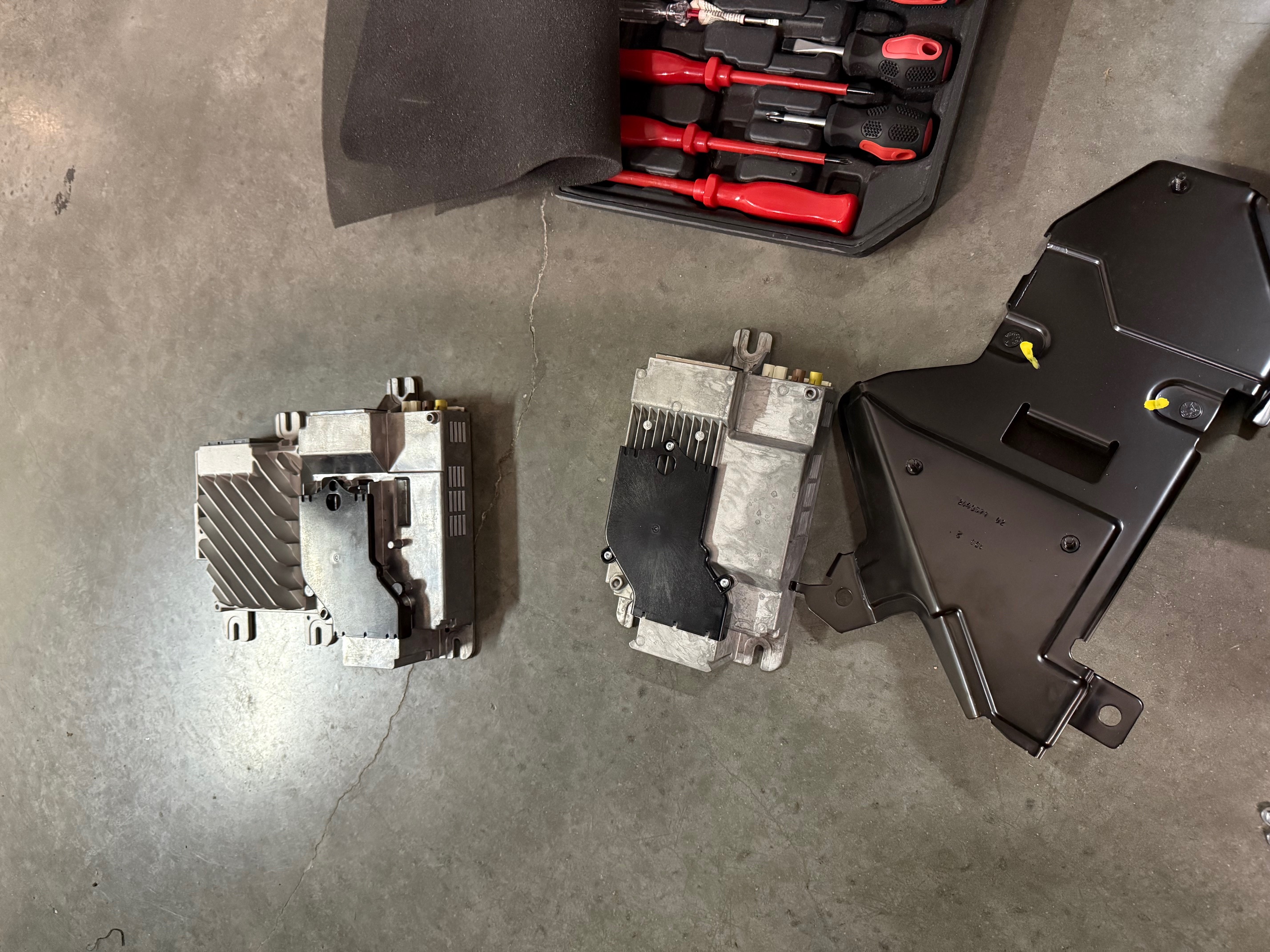

Next step since its hifi but to do a full B&W is beside the fact the car needs total rewiring super expensive. So descided to do a hifi to HK retrofit. Since you can fdl code B&W setup which gives a quality boost to HK (dont expect the same as B&W but still)
But have some problems there cant find the correct part numbers for my car for the reciever and booster. Asked the dealer for a partnumber list with the numbers that would fit my car but they say that this is impossible to do :lol::lol::lol:
So as long as i dont have the correct nr the reciever and booster is on hold

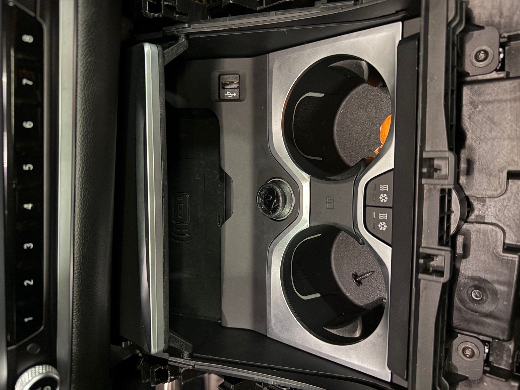

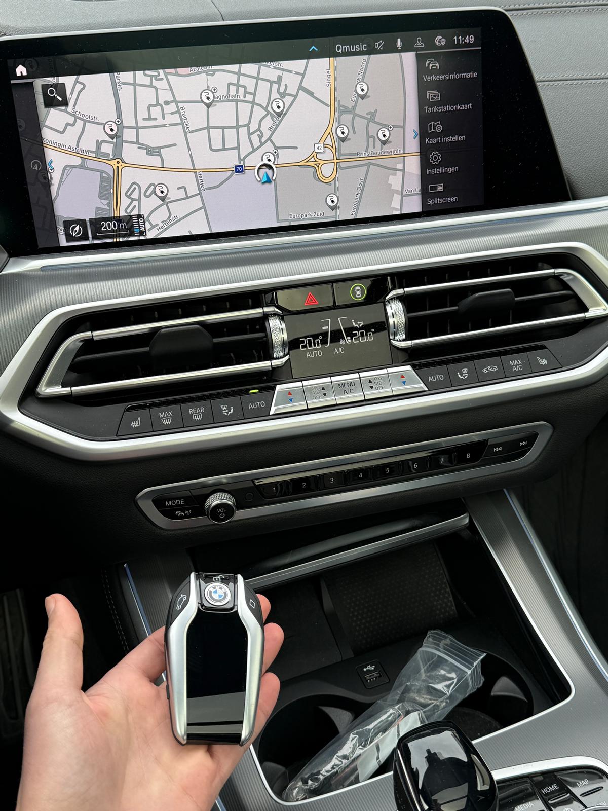

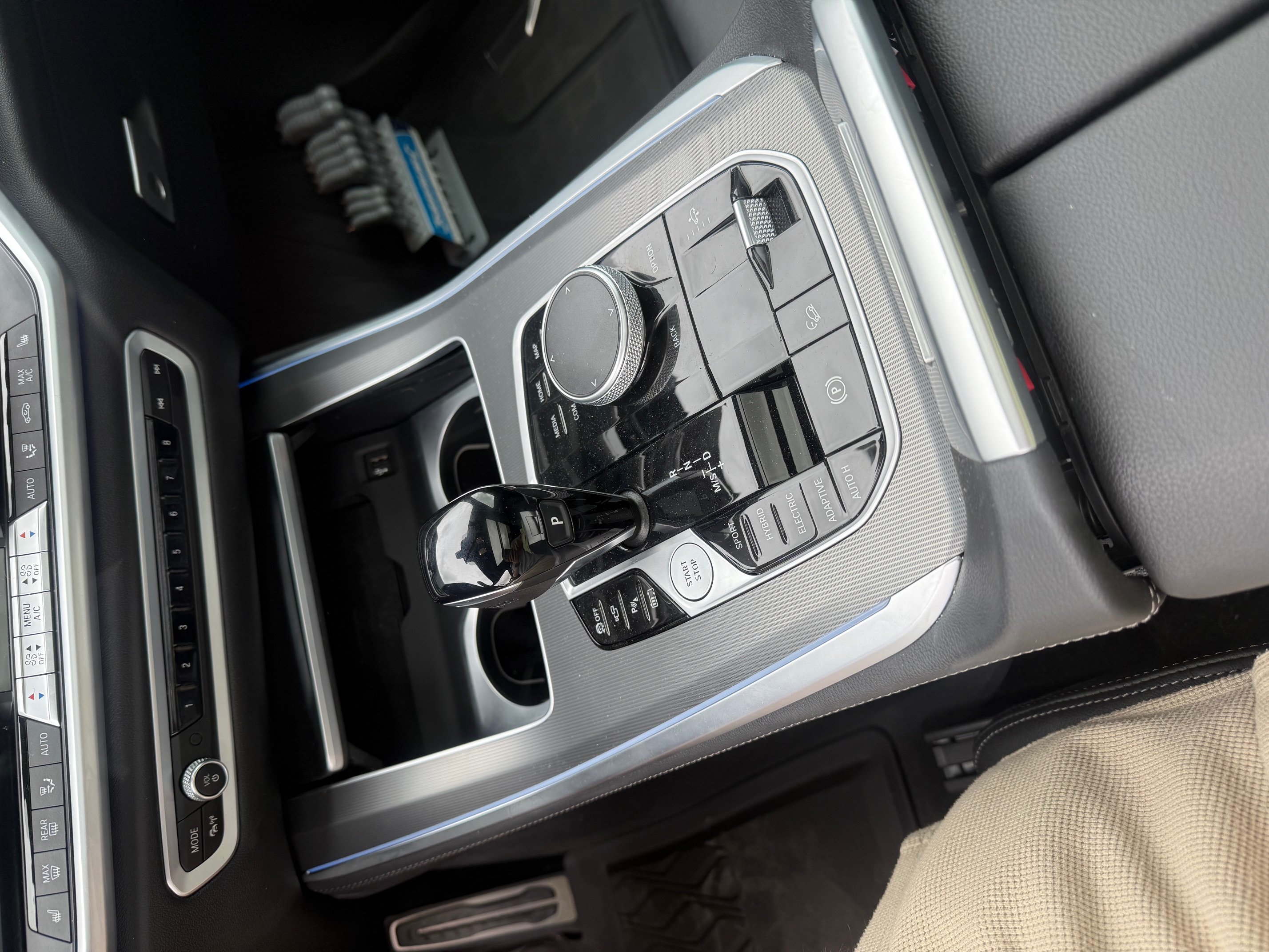

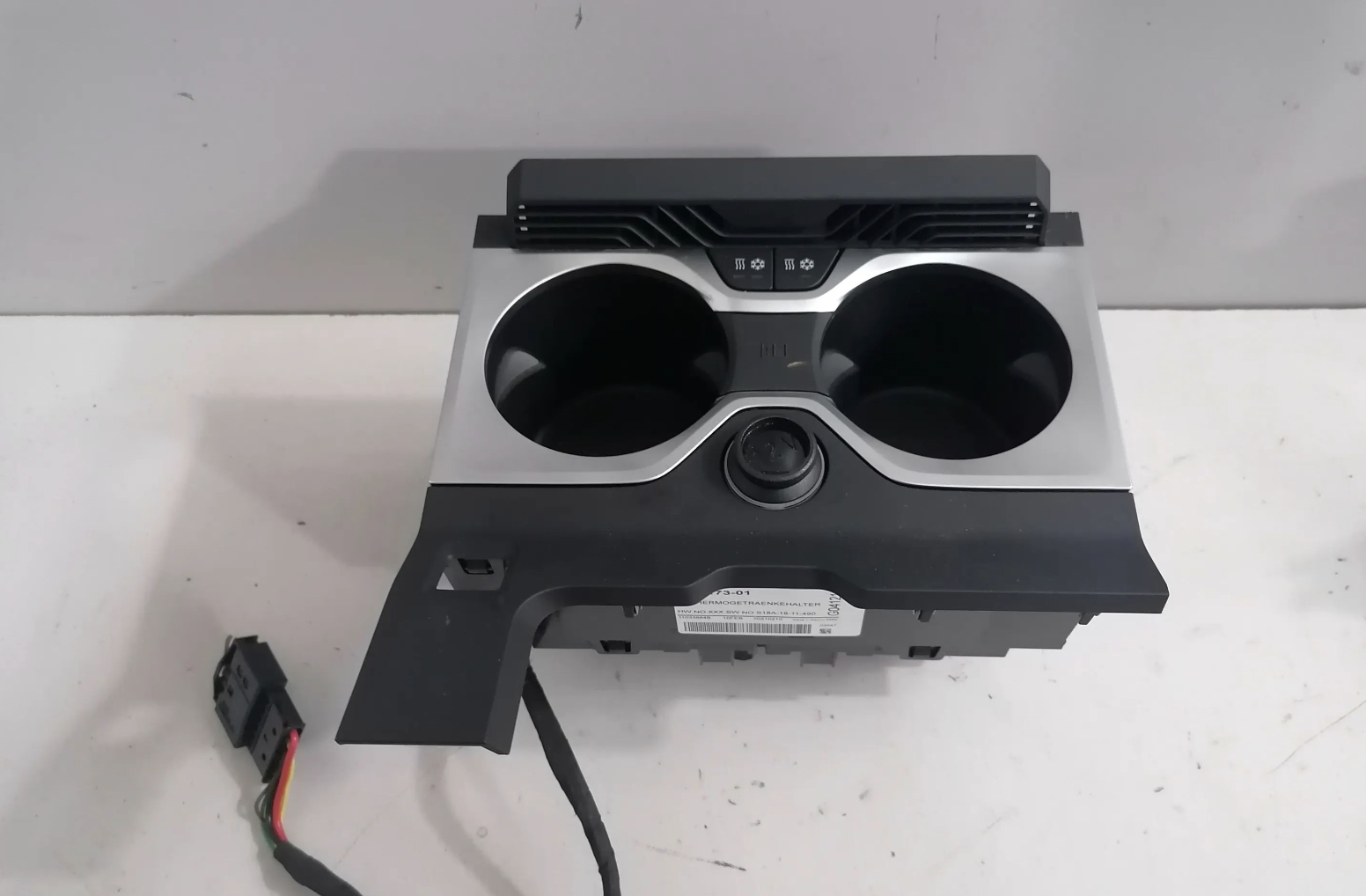

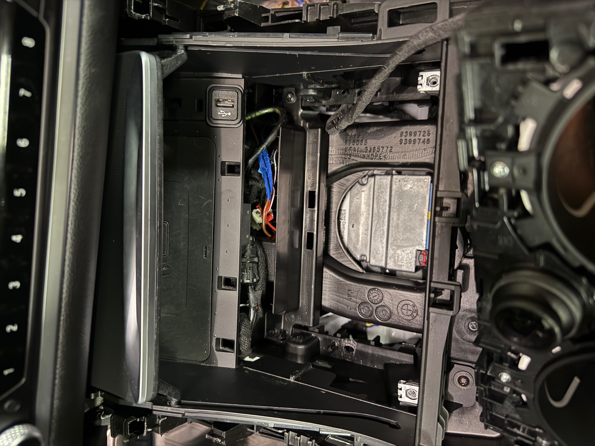

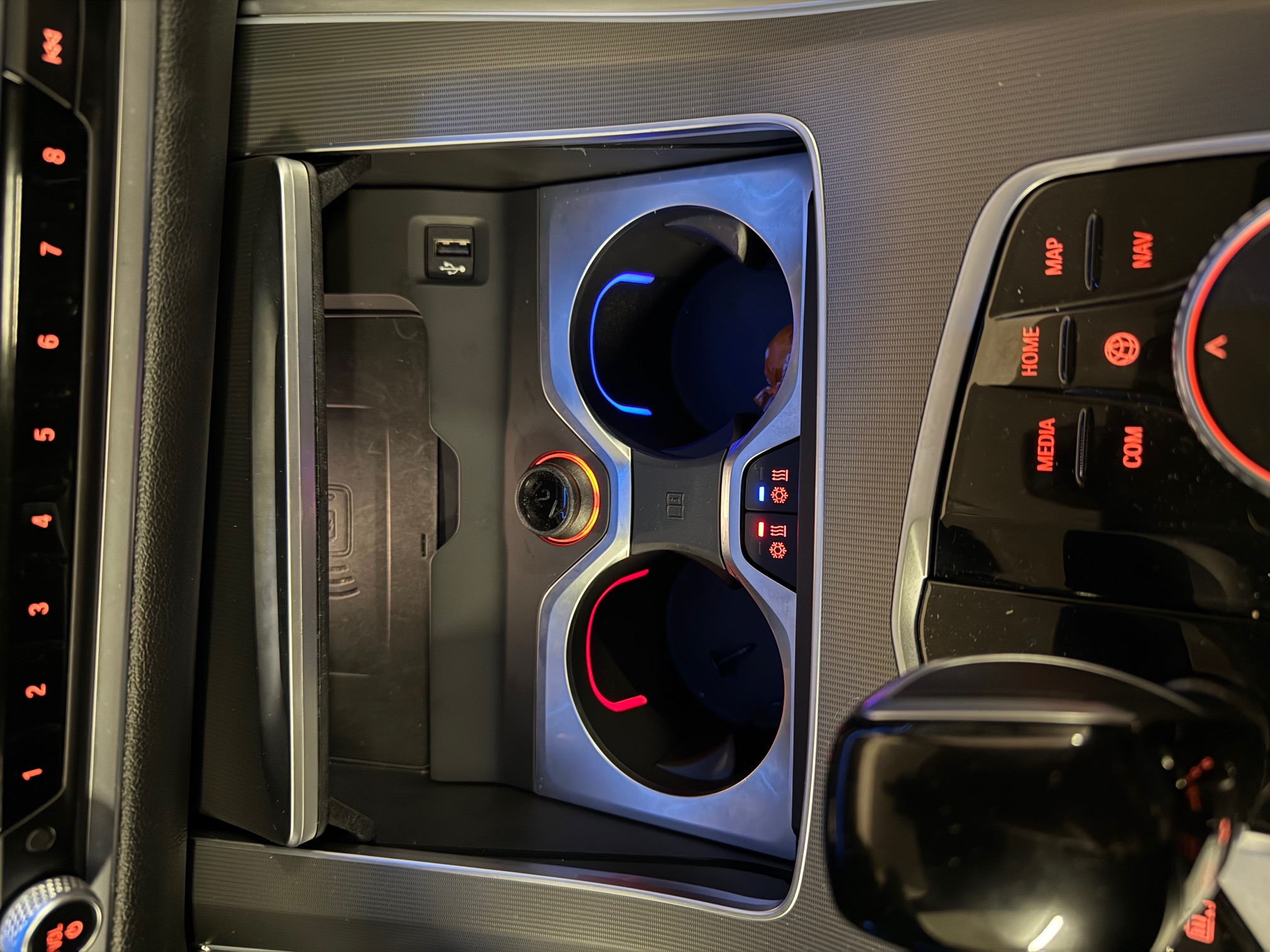

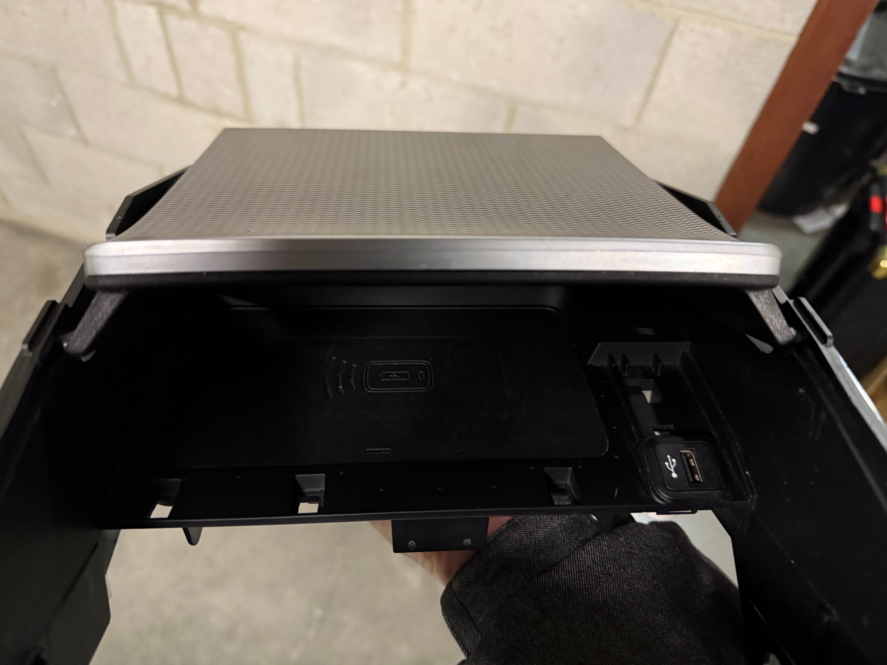

Next week i will start my next retrofit since HK is paused. wireless charging and the heatred/cooled cupholders.
Almost have all the parts, next week ill go get the 2 missing parts from dealer to start.
Reason is the the previous owner descided to take the display key as option also have the keycard, but then doesnt take the wirless charging option. :confused2:confused2
04-14-2025
The retrofit of both wireless charging (6NW) and thermoelectric cupholders (44A) is done. Everything installed, wired, coded and tested.
05-02-2025
Upgrade from hifi to harman kardon is also finnished. Added 2 speakers, 4 tweeters, booster and changed reciever to high version.
05-02-2025

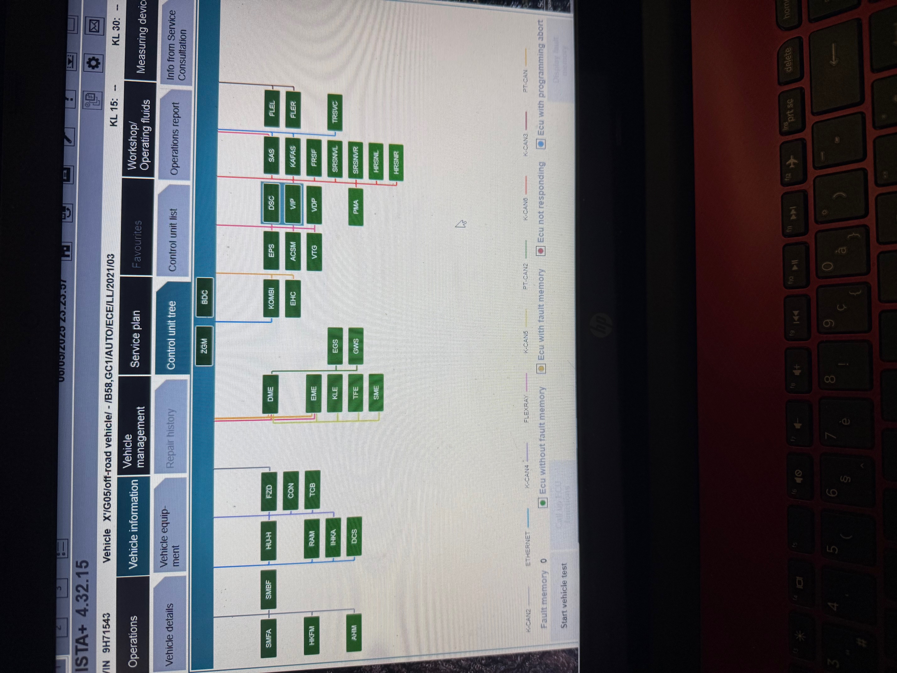

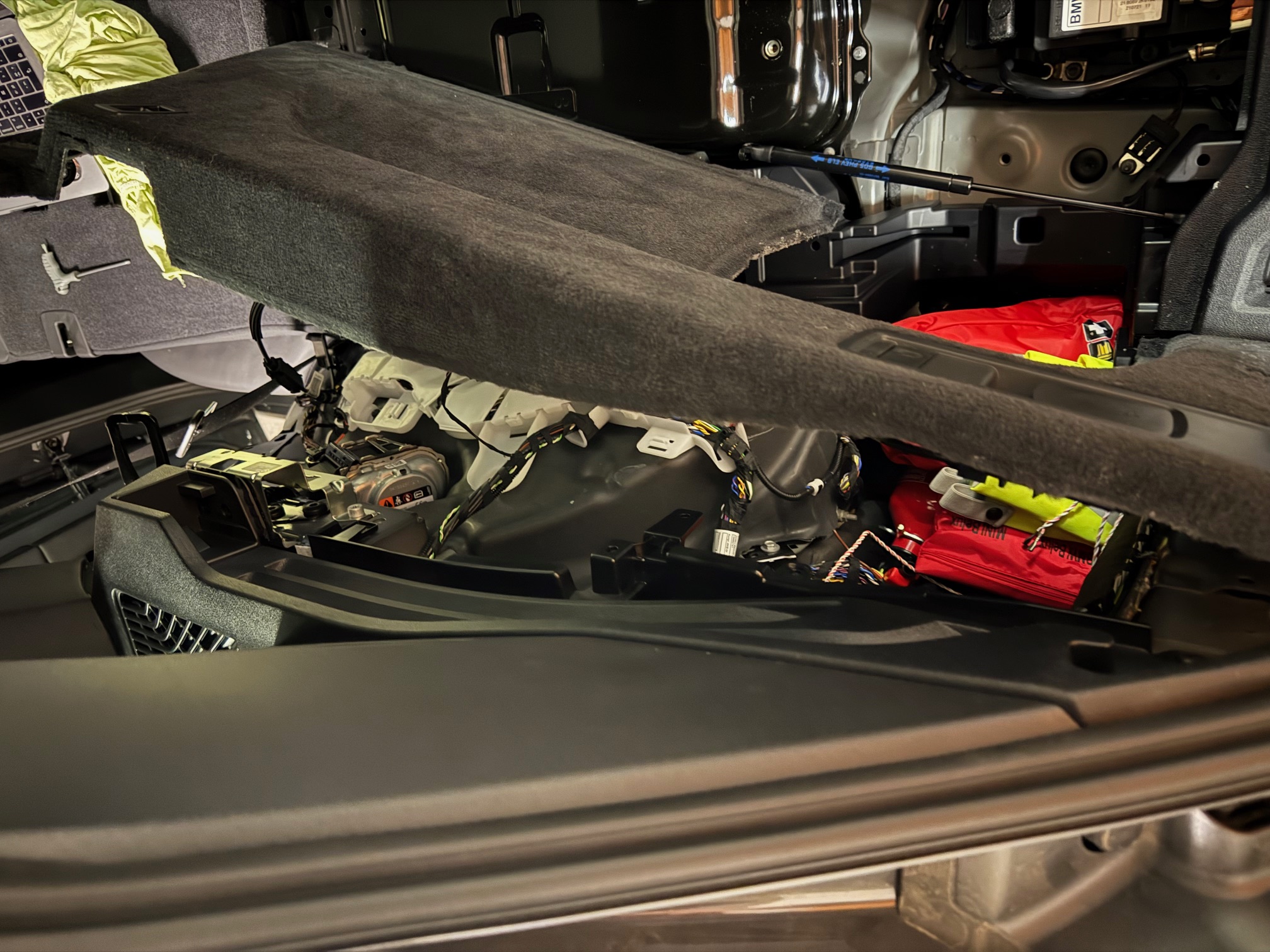

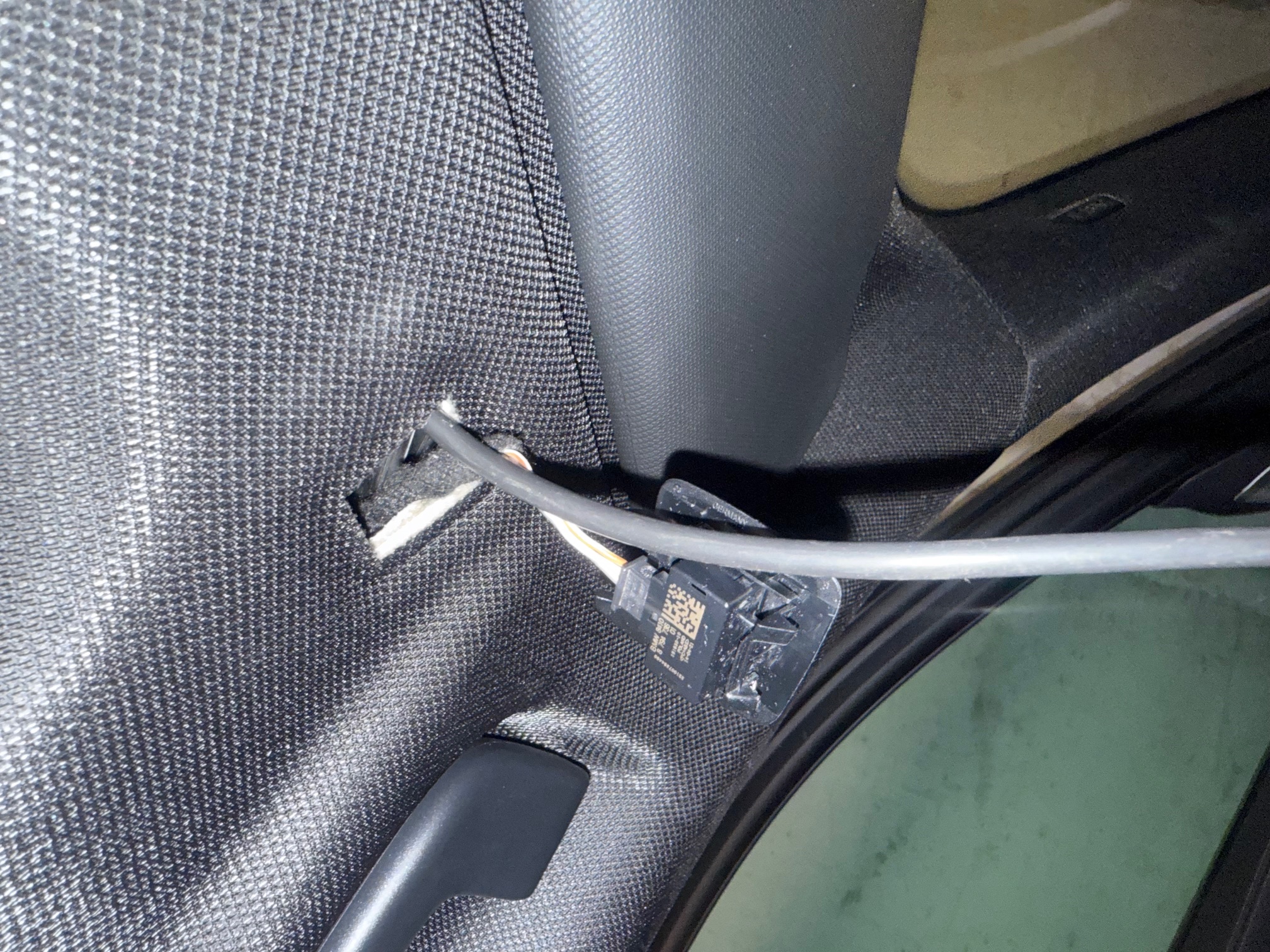

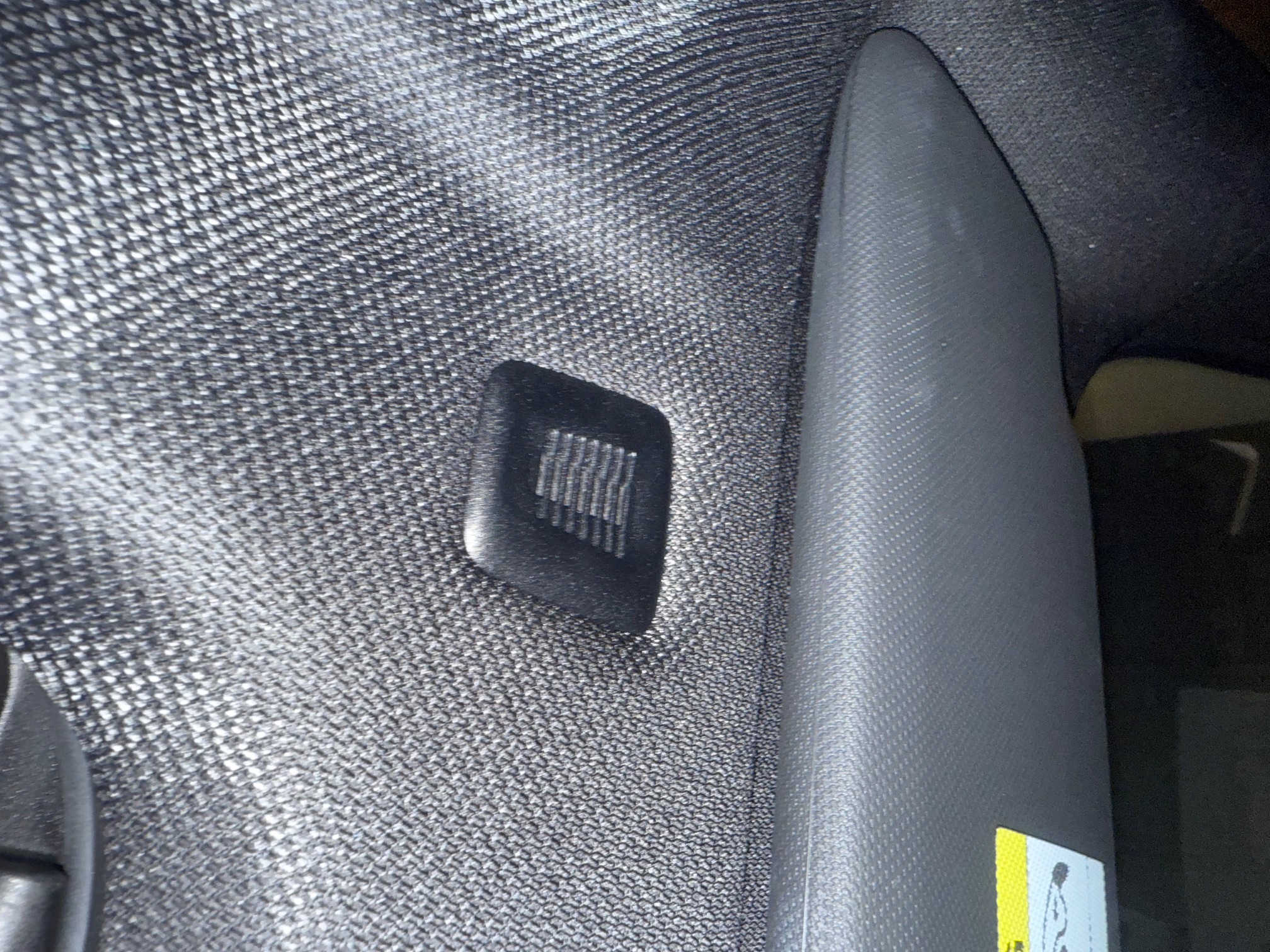

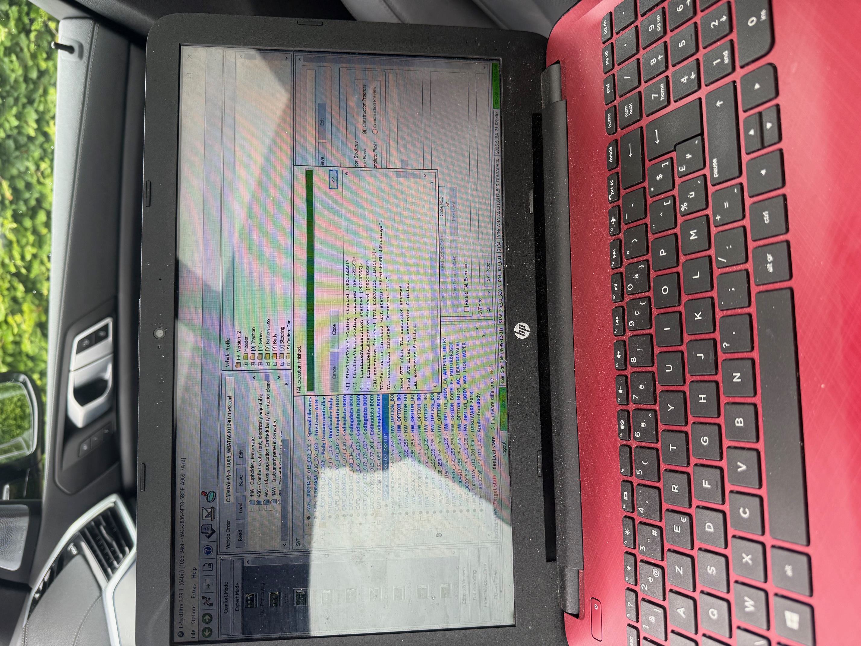

After the 6NW retrofit, i had a problem. The option has 2 microphones, 1 driver and 1 passenger side. My car had a cover on both sides but only one micro on driver side. This resulted in an error in the RAM. Took me a while to find the correct cable, cause there is no repaircable for this and this also needs to be a shielded cable that is long enough to go from the passenger side all the way to the trunk.
The funniest part was offcourse to get it from the passenger side to the trunk :mad0259::mad0259:
But i did it, connect 3 wires to the RAM, pluged the connector in the micro, used ista and error was gone
05-16-2025
2 more

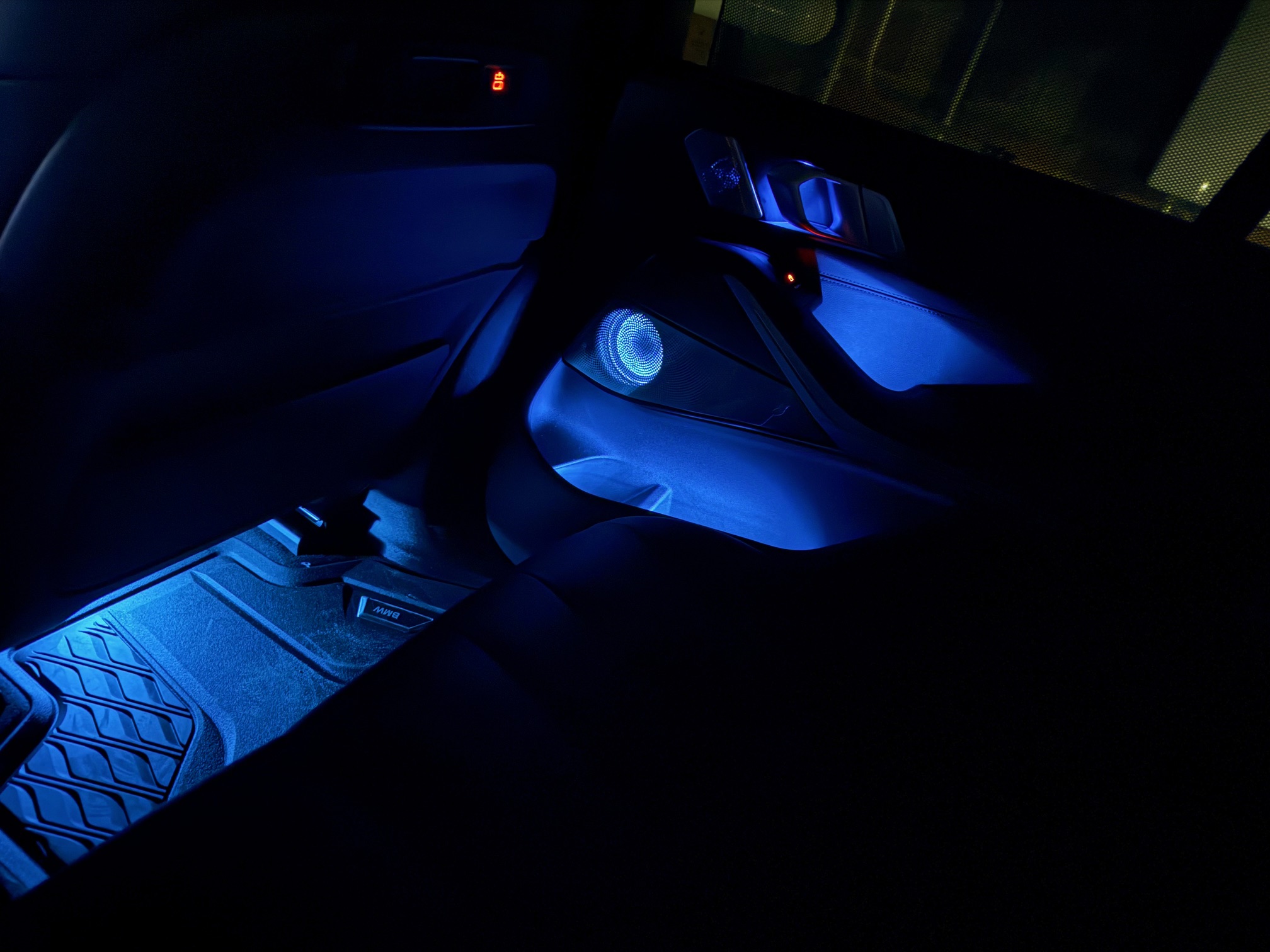

05-22-2025

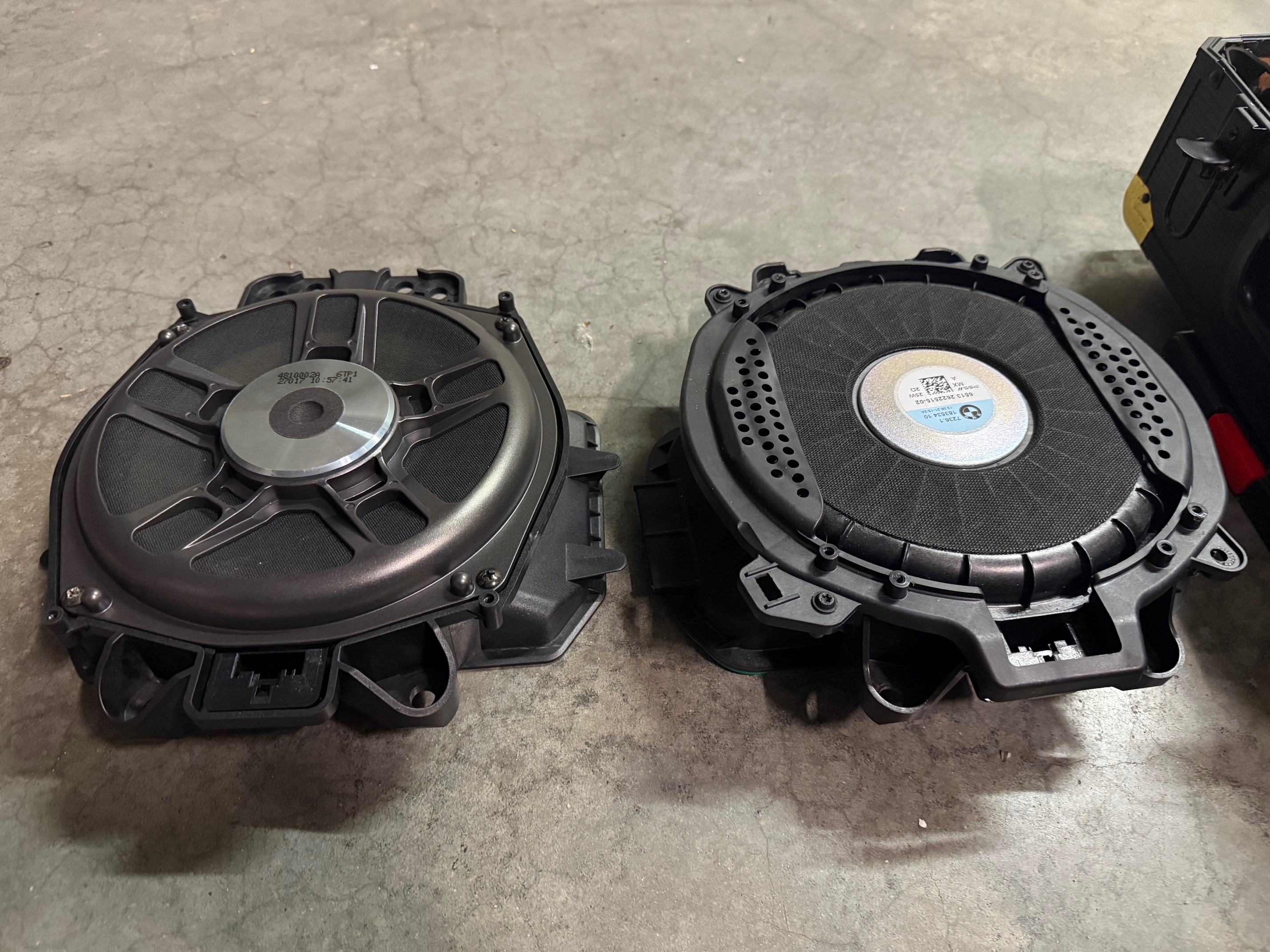

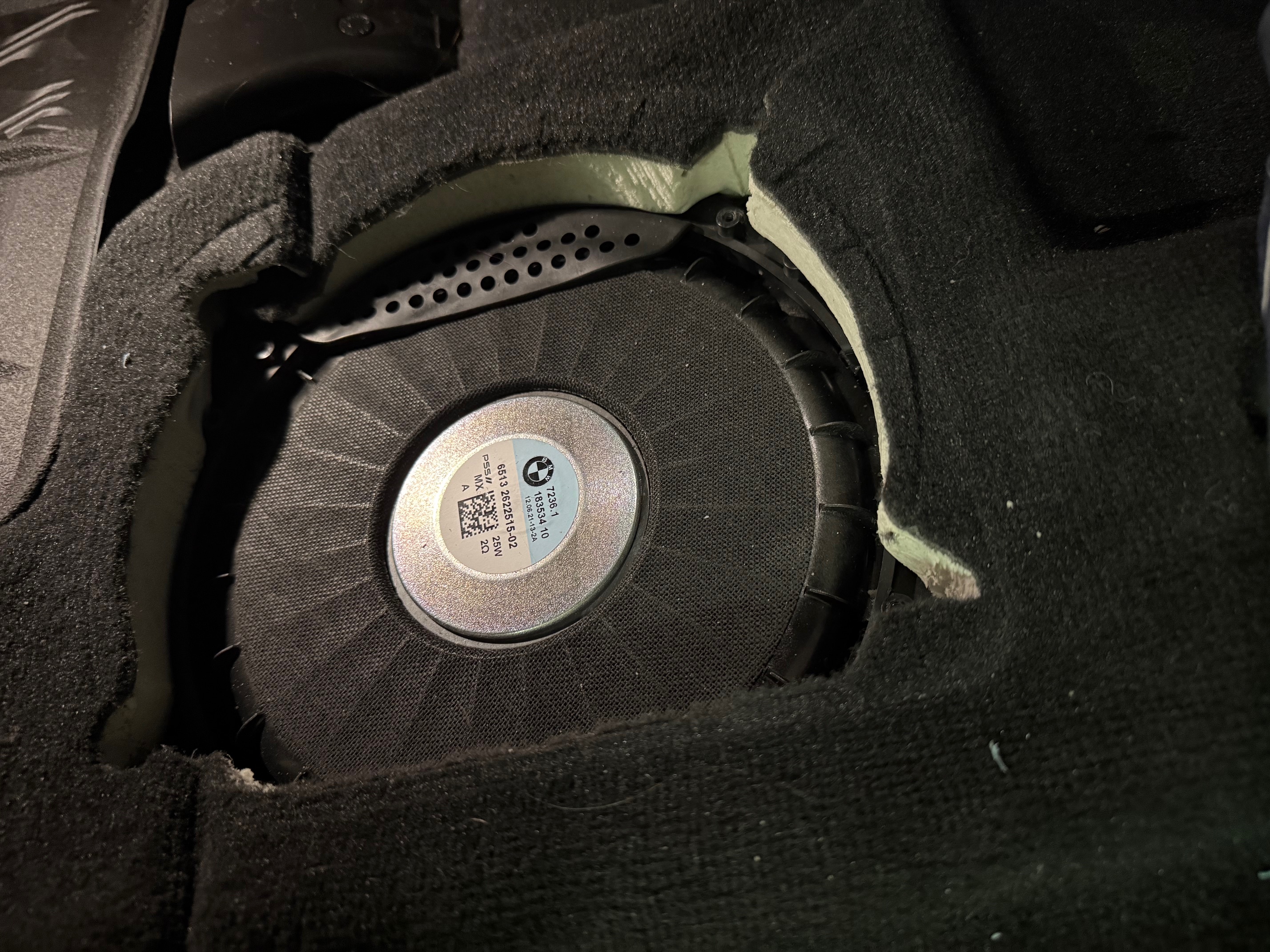

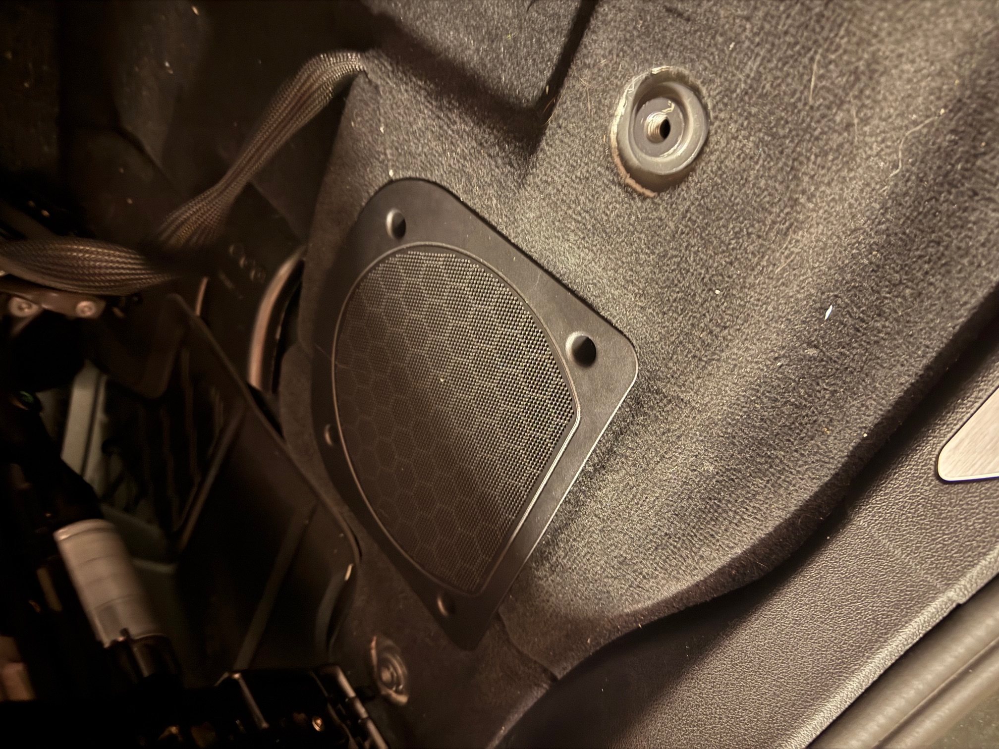

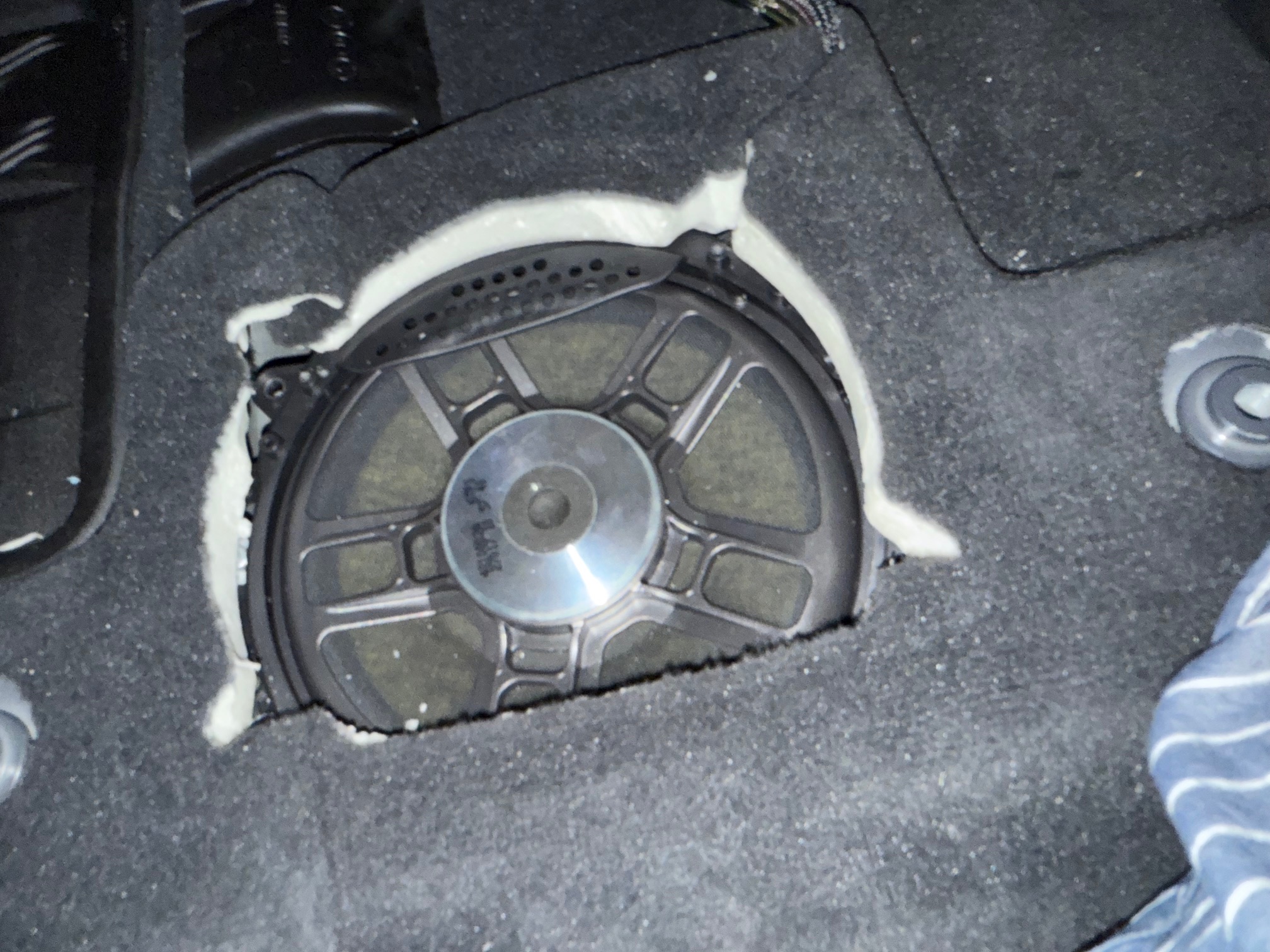

Orderd the crafted clarity, new grill and holders for the b&w underseat sub.
Today i did the instal of the crafted clarity

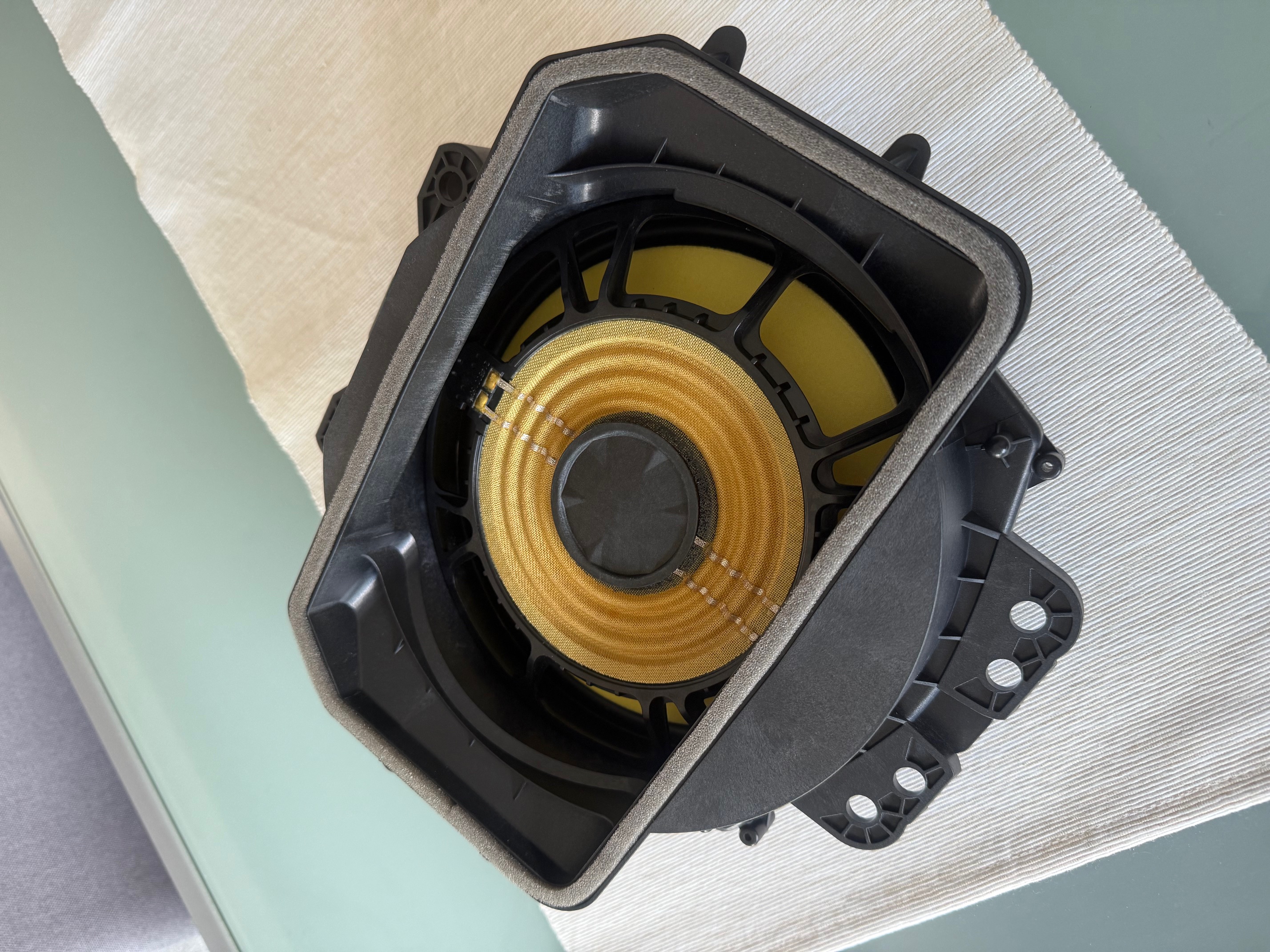

06-02-2025
Holders for sub arrived today, i allready had 1 sub so put it together. Didn't have time to install it in the car yet
Passenger sub is installed

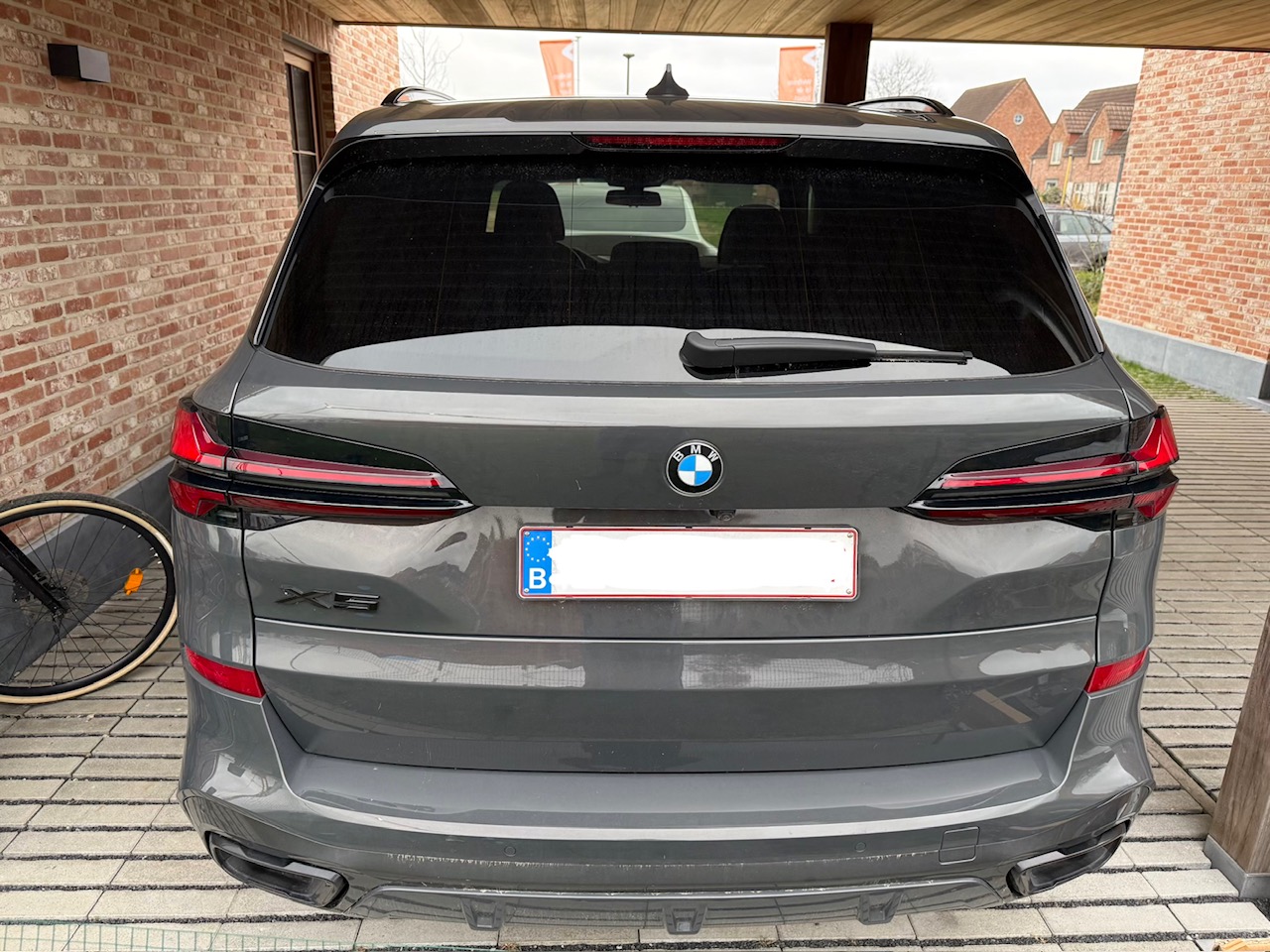

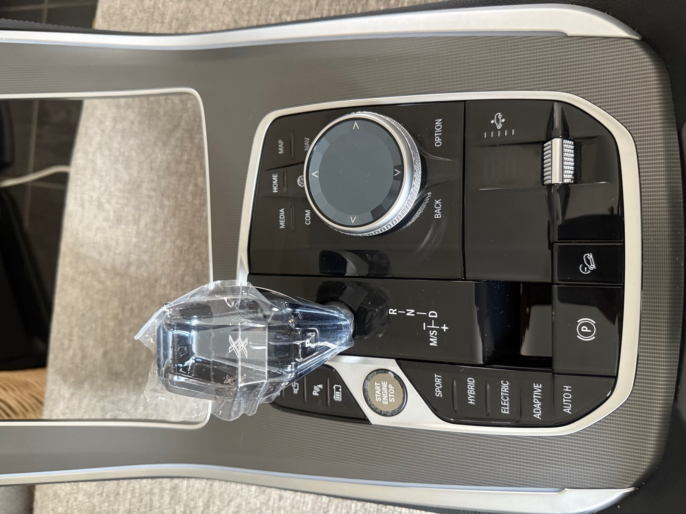

Descided on some new updates:
- lci tail lights
- full spoiler kit (front, side, rear, roof and trunk)
Lci tail lights look way better then the pfl, only downside bmw is not planning to make a retrofit like they did for the g30. So only posibility is aftermarket. Im curious about the quality and result
12-12-2025
- lci tail lights
Installation done

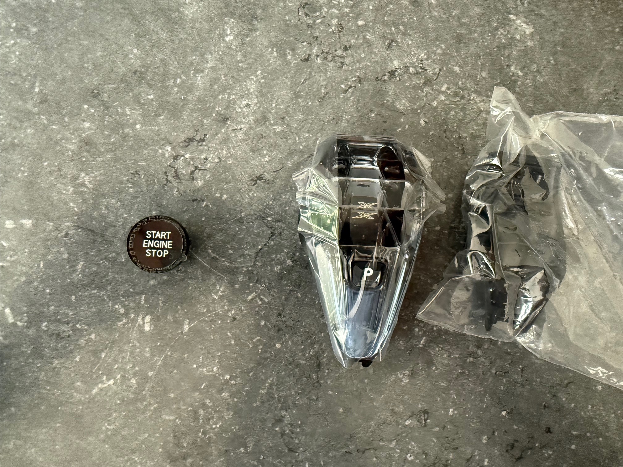

12-19-2025

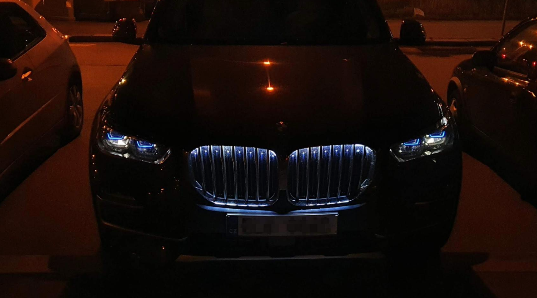

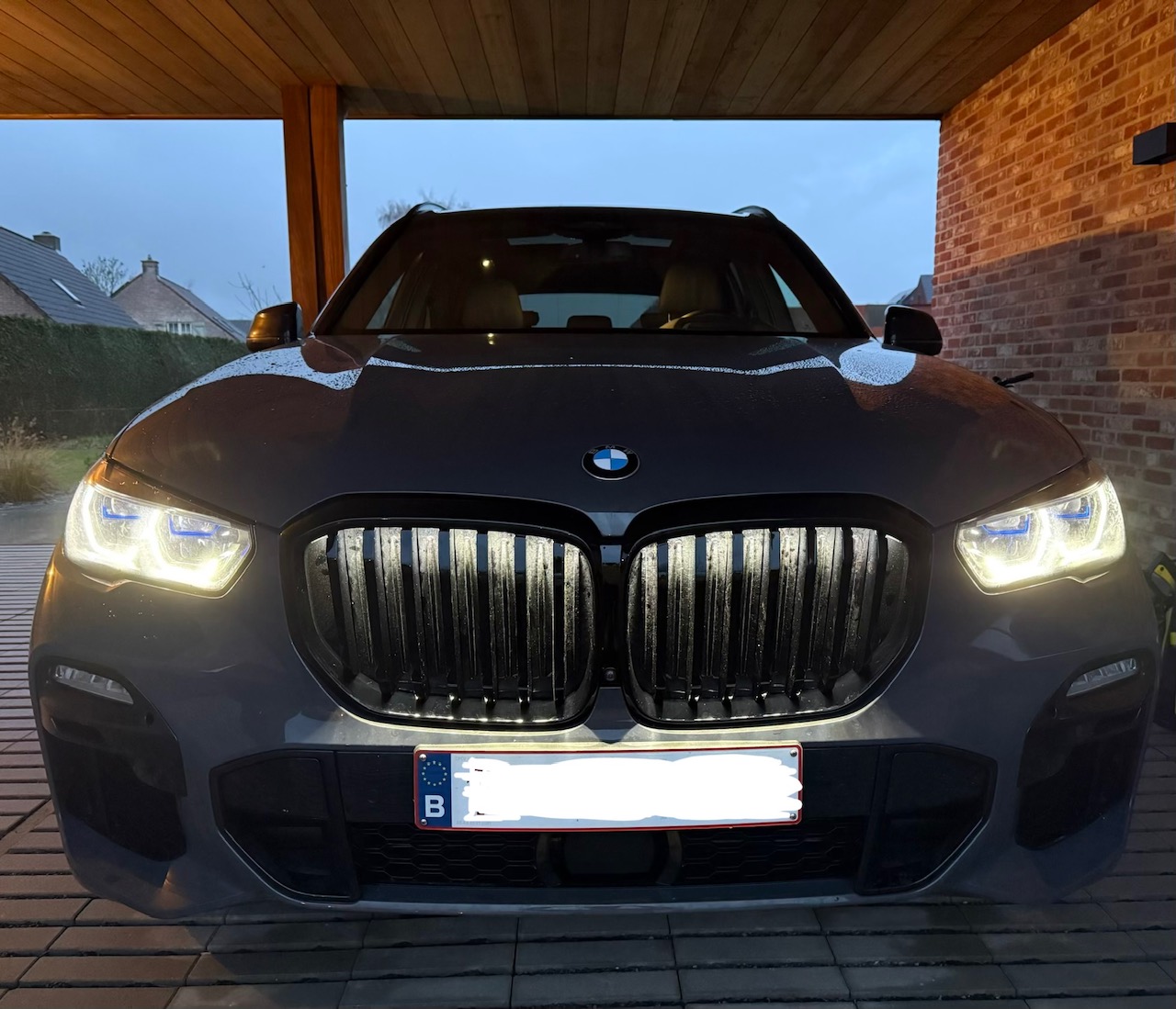

orderd new update, the iconic glow again available starting lci g05.
Shipped yesterday, so hope to get it before end of the year

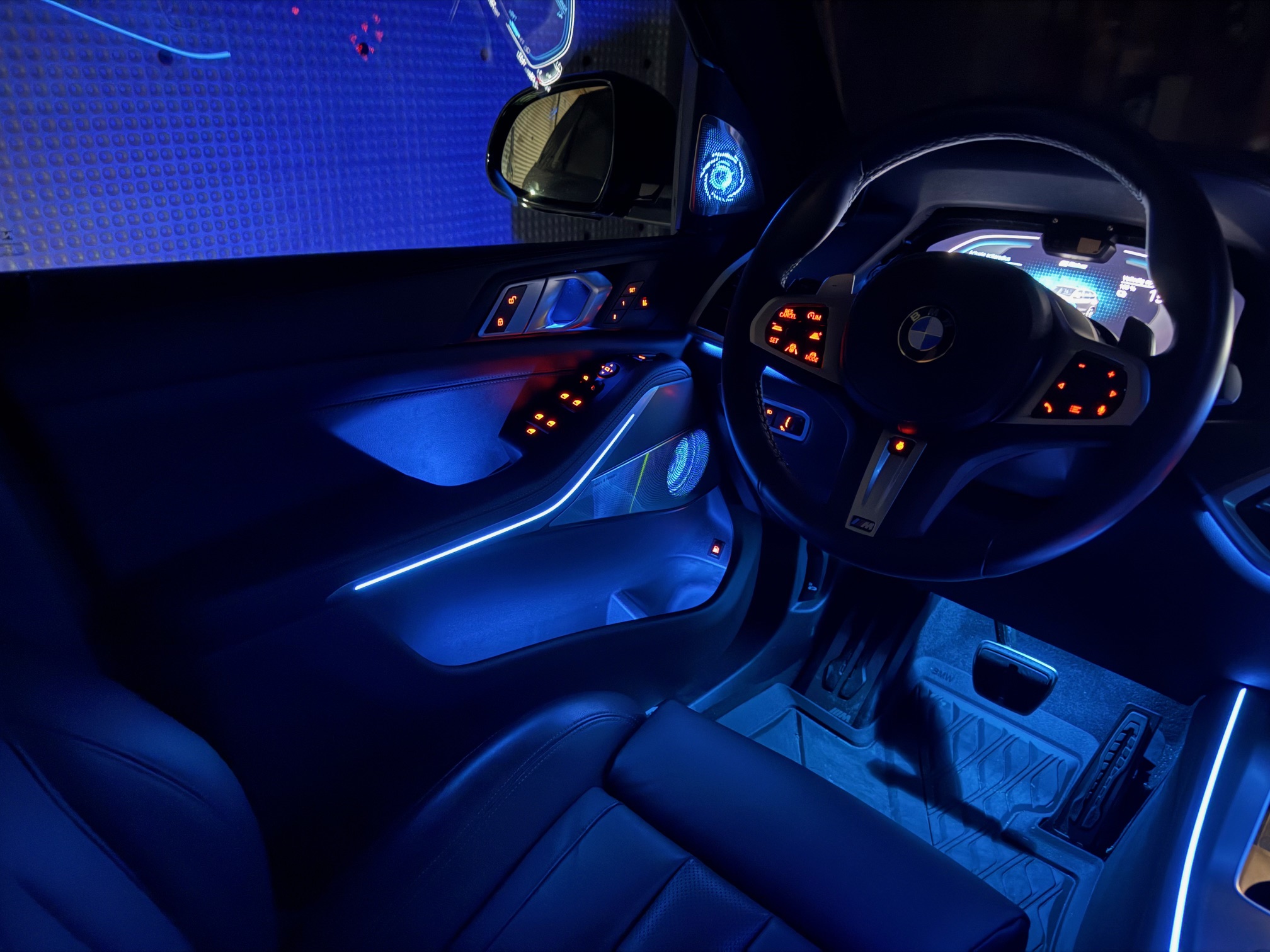

01-11-2026
Kidney finally arrived and installed iconic glow. Was a little more deifficult then expected but i like the result.
