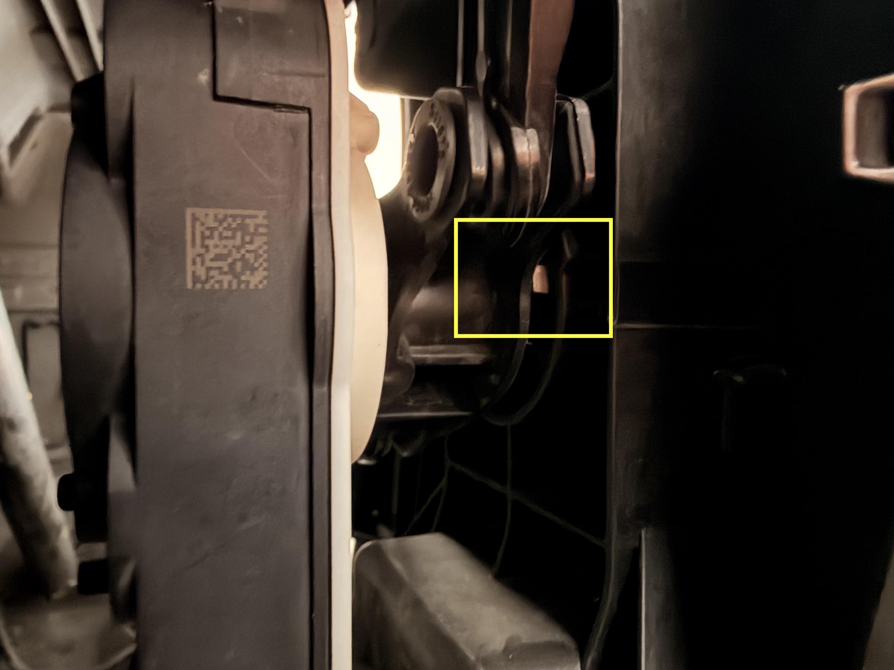

:coolpics:I left the first and last shutter on to allow the motor to recognize the open and lose limits.

Since the actuator seems OK, something on the shutter is likely binding or not closing at the right angle. Inspect the entire mechanism of the shutter and make sure it has a proper stop at the open and closed positions. DO NOT rotate the shutters manually with the electric actuator is installed inside the grill shutter assembly! This could damage the gears inside the actuator. I do not know if these aftermarket tools can cycle the actuator. Proprietary OEM tools can.

I figured out the open and close limits on the shutters and placed a riveted both sides to allow the motor to actuate properly to the open and close limits. The tab on the motor would hit the limits set by the rivets.

That should work. The actuator will measure the angle that it achieves on a calibration cycle between the full open and full close limits. As long as this calibration angle is within the expected range, it should continue to work.
Also make sure things are plugged in properly. You don't want any water getting into the electrical wiring or the actuator itself. Keep everything plugged in so it's sealed like it was from the factory.
