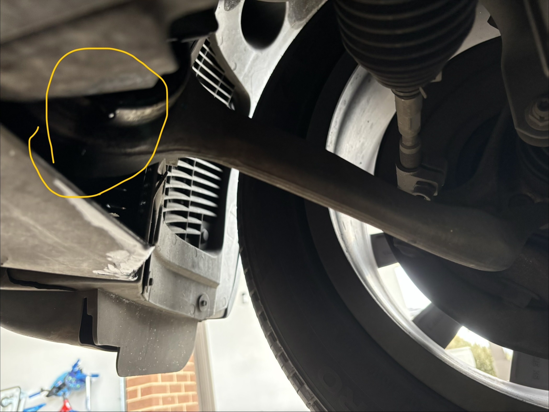

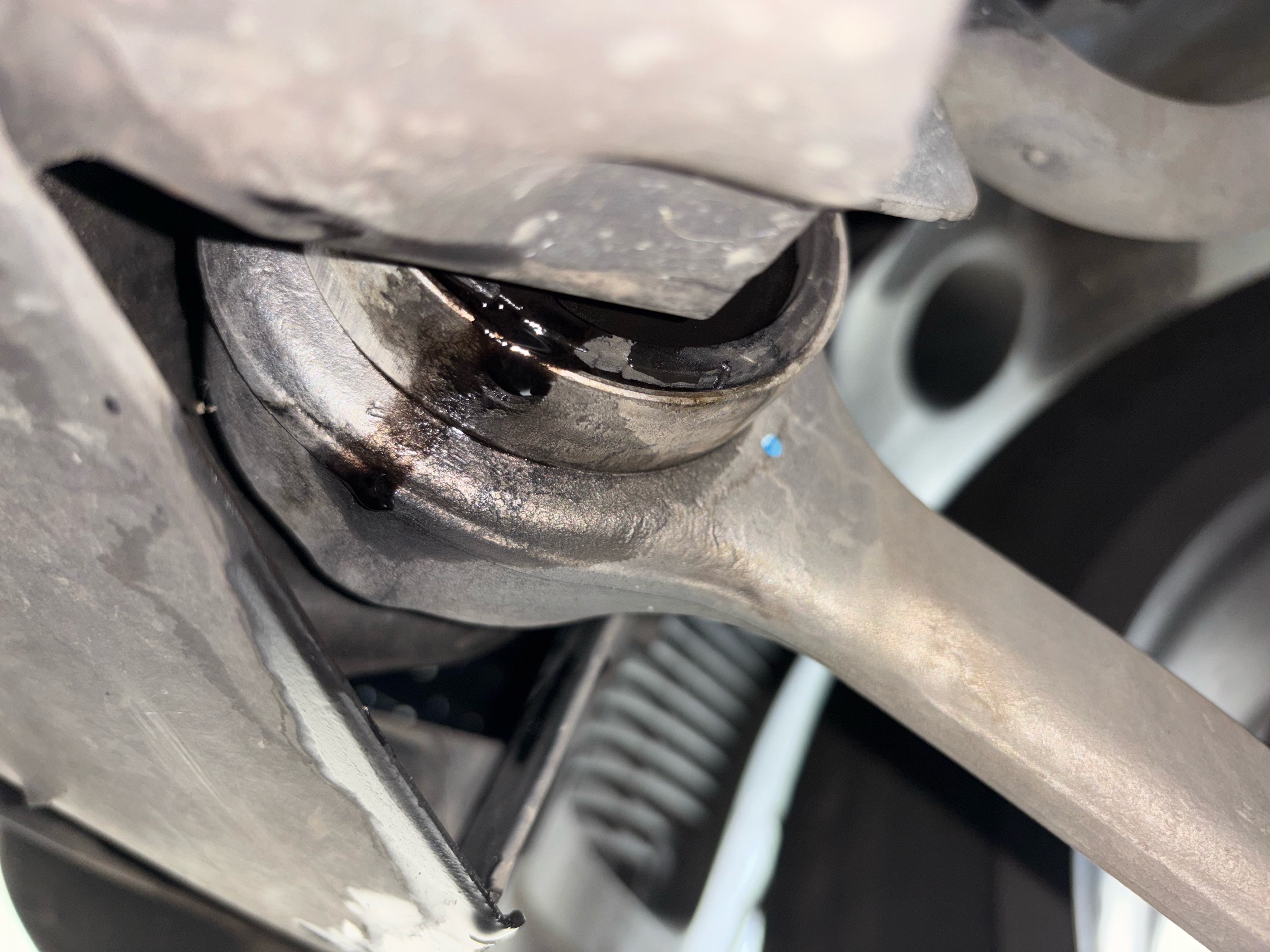

There's an oil leak in my front axel (not entirely if that's what it's called) picture is attached.
I’m going to take it to dealership this week. Can someone guide how much would this repair cost and what exactly is happening here?
This is my first post I have 2020 X5.
Thanks in advance guys.

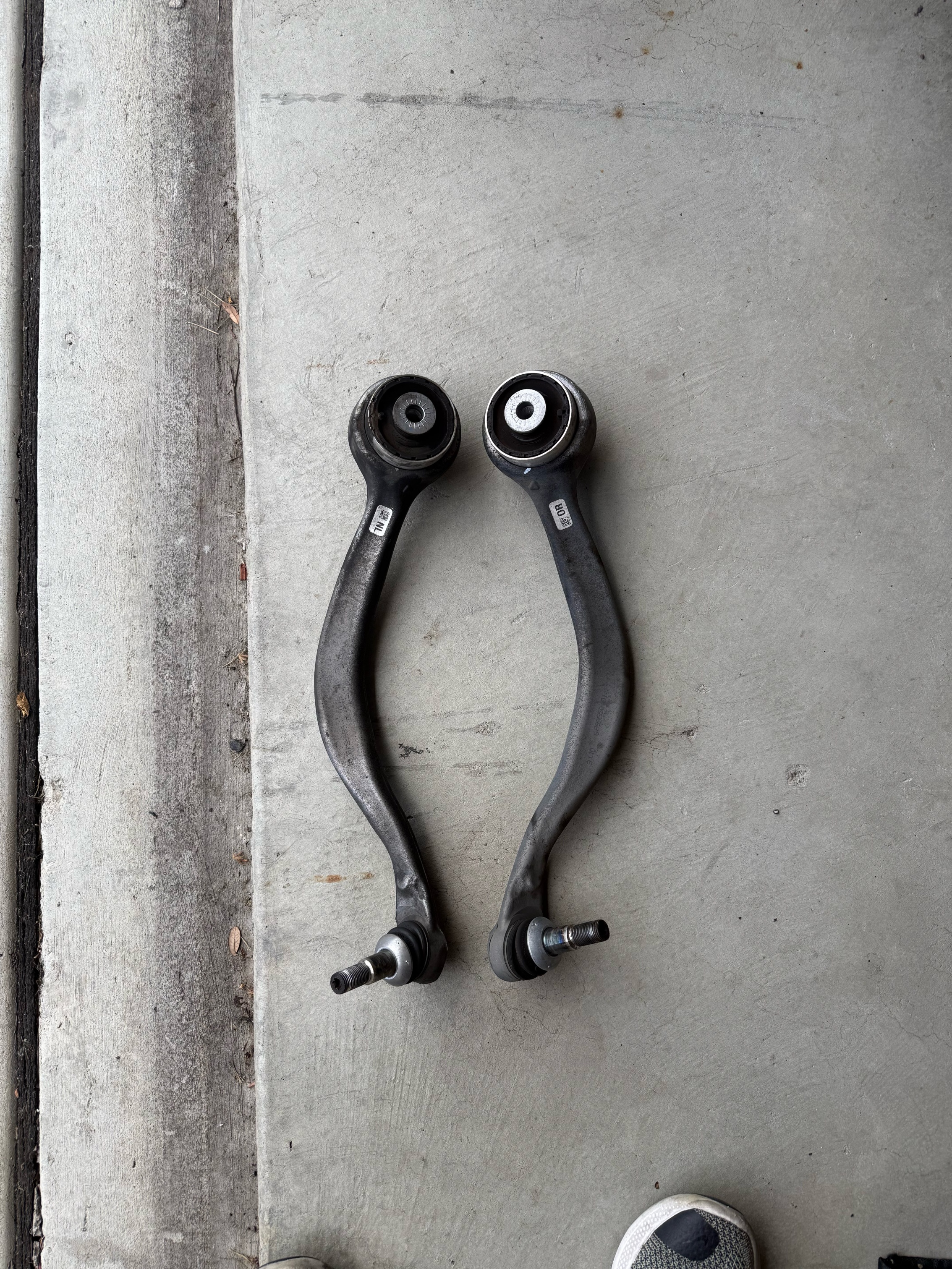

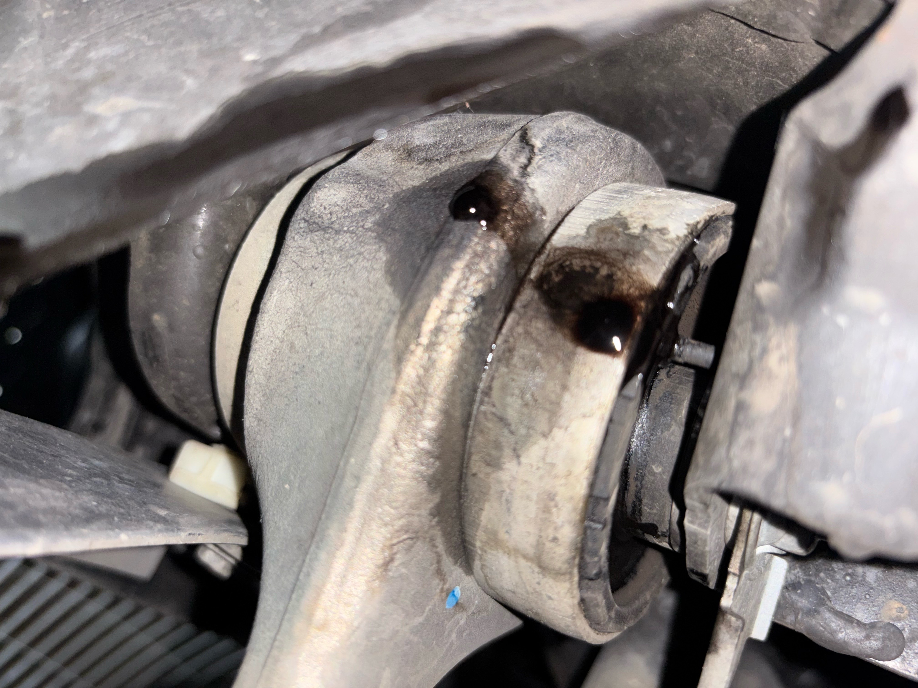

This is tension strut. The top issue of G05. Dealer cost is $3500+. BMW extended warranty does not cover it. BMW think this is wear and tear. FCP euro ha a video show you how to replace it. Just did mine during the weekend. Attached is what my leaking tension strut looks like.

Thanks very much mate. Is it hydraulic fluid that’s leaking? My dealership is saying to keep driving it until the problem becomes worse and then have both arms replaced. My concern with that is wouldn’t it just drain all the fluid or is it isolated cavity with fluid in it?
I wonder if it’s wiser to just get the dodgy one replaced now. I am not very handy with tools so I’ll have to get it done by a mechanic

It’s fluid leaking. Mine was leaking from one side but I found the other side is about to leak because it has a crack on it after I removed both. When replacing, you have to replace both side at the same time.

You dealer is honest and correct. Suspension bushing is a wear item. All will need to be replace at some point. Same for all brands of car. And I agree don’t bother unless you have issue, then replace both sides

That's fluid leaking from the thrust arm bushing. We had the same issue on my wife's 2023 X7. CPO didn't cover the replacement, and it was $1900 for the dealer to replace both + alignment.
