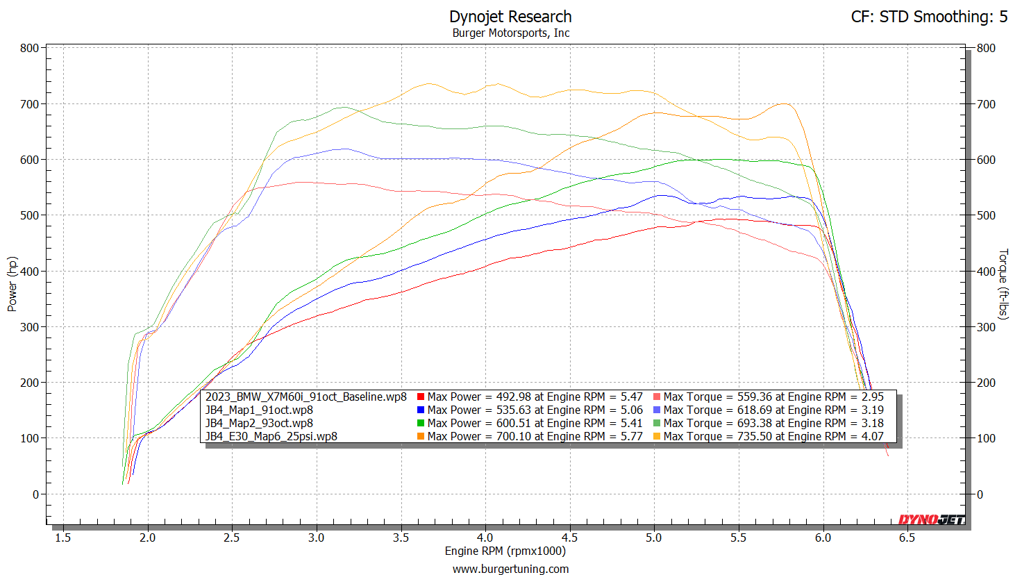

I am personally waiting for BM3 myself to be available. I have also thought about a race chip or jb4 in the meantime to satisfy the performance cravings, but I am trying to wait it out.
Jb4 will get you the numbers you are wanting, but not as seamless and dare I say "safe" as a flash tune. If you go catless downpipes you can at least clear the CEL every 40-50miles with the JB4.

Secondary Downpipes (Red Star or Evolution Raceworks) - No CEL issues
Remove the Resonator (middle of exhaust) - any exhaust shop can do it cheap
MAD Valve Controller (plug and play)
JB4 Map 2
Maybe about $1.5K all in, significant improvement in sound and performance.

I live in Southern California. I've done the Valvetronic exhaust and RedStar catless secondary downpipes. I also run the JB4 and I'm having the Eventuri intake installed next week. I also added the DäHLer ATTC which adjusts the way the throttle responds.
The Valvetronic exhaust alone won't cause your car to not pass smog. The catless secondary downpipes may or may not. No testing station is going to look that hard. The JB4 can simply be unplugged when you take it to get smogged.
In California you don't smog your new car for 8 years. So you could install the Eventuri now and just remove it in 8 years for the test. Or you can wait for the Dinan cold air intake to get CARB certification.
I've been really happy with this setup so far.

In California the highest octane at regular gas stations is 91 so if I don't mix in E85 then Map 1 is what I use. When I mix in the E85 to get E30 I run Map 3. Map 3 is a whole lot of fun. I've only run Map 4 once for a short time. It was scary fast and fun but I don't need that kind of power on a daily basis.

I use this online calculator. https://morepowertuning.com/pages/emix?srsltid=AfmBOorKBnj01uMenTf4kRB26g2z70h8NE6425KYlqK8m2i42d3g7DHE
There's a gas station that sells E85 separately. I normally add 13.93 of 91 and 5.07 of the E85. It may not completely top the tank off but I keep filling up that way and haven't had any issues.
You could always install the Burger Motorsports Bluetooth Flex Fuel Kit for S68 4.4L motors. Than you'd know for sure what your mix is.
