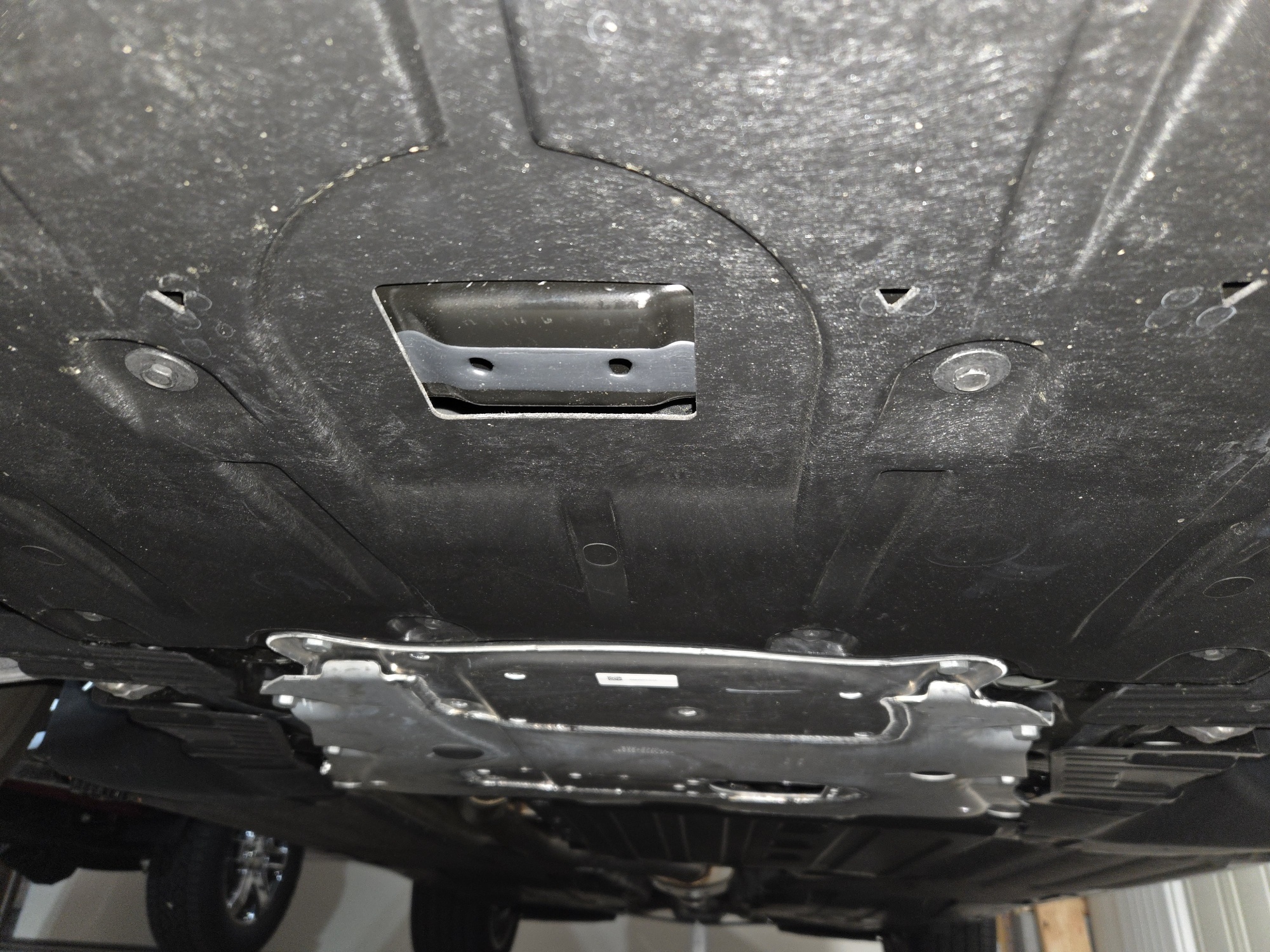

Im getting ready to do my 26 sdrive 40i soon. Did you jack it up with the center front jacking point?

Great thanks. Is this the center jacking point on my 2026? I didnt want to remove the plastic pan if I didnt need to.

That is my understanding based on my research.

So this is where you put your floor jack? The older cars had a similar spot but it looked a little different Dont worry I wont come after you if it crushes.
