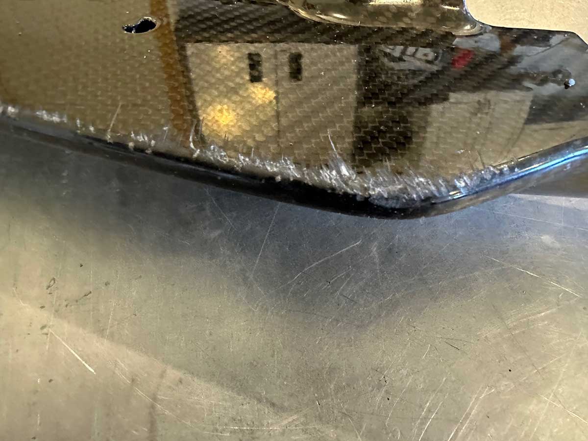

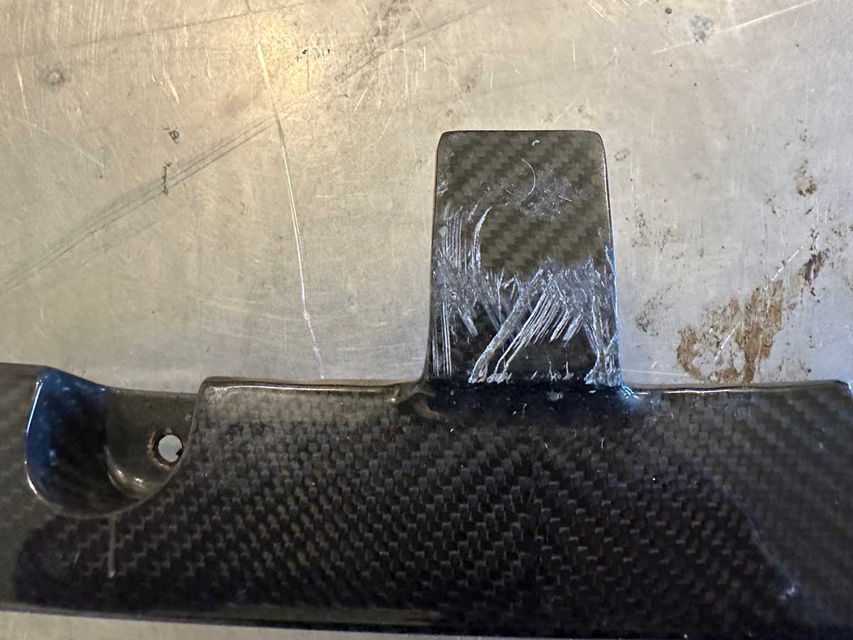

I rebuilt my CS spoiler due to damage. I did the carbon fiber repair but not the PPF but it cam out as good as knew so it's possable
Before
After
05-10-2026
Looks great. Did you strip off the clear coat with sand paper and then spray with clear coat?
How are you finding the Sliplo, is it effecting in protecting the lip?
05-10-2026
I only posted one before picture but the damage was extensive. I just roughed the surface and I did my repairs with sanding and resin. I recreated the Carbon Fiber look with paint and tooth picks on badly damaged sections.
Here is one trick I learned. A hex drill bit will remove the stone chip damage and leave good edges. Fill dimple with resin, sand.
I didn't finish with resin top coat as it's too complicated a shape. I used sandpaper from 400 working to 3000. I compounded and polished before taking it to the PPF installer
The Sliplo's are holding up great but they do remove a little of the already limited ground clearance.

I don't want to do it again. :sigh: I wanted to keep the car OEM or I would just have ordered a $1200.00 knock off. The culprit is trailering the car, it is hell on spoilers and I'm done with that.
I didn't figure out the drill and fill until I was under the gun to keep my appointment with the PPF installer. For stone chips, you can't beat it. The white that shows is damaged resin not the carbon fiber. Get rid of the white and fill and then do standard paint correction technique.
As for Sand paper, like paint correction anything you do you have to fix. :sigh: If you can get the surface repaired with 600 then that what I would start with.
My damage was 400 level damage :sigh:
I used standard over the counter resin and hardener.
