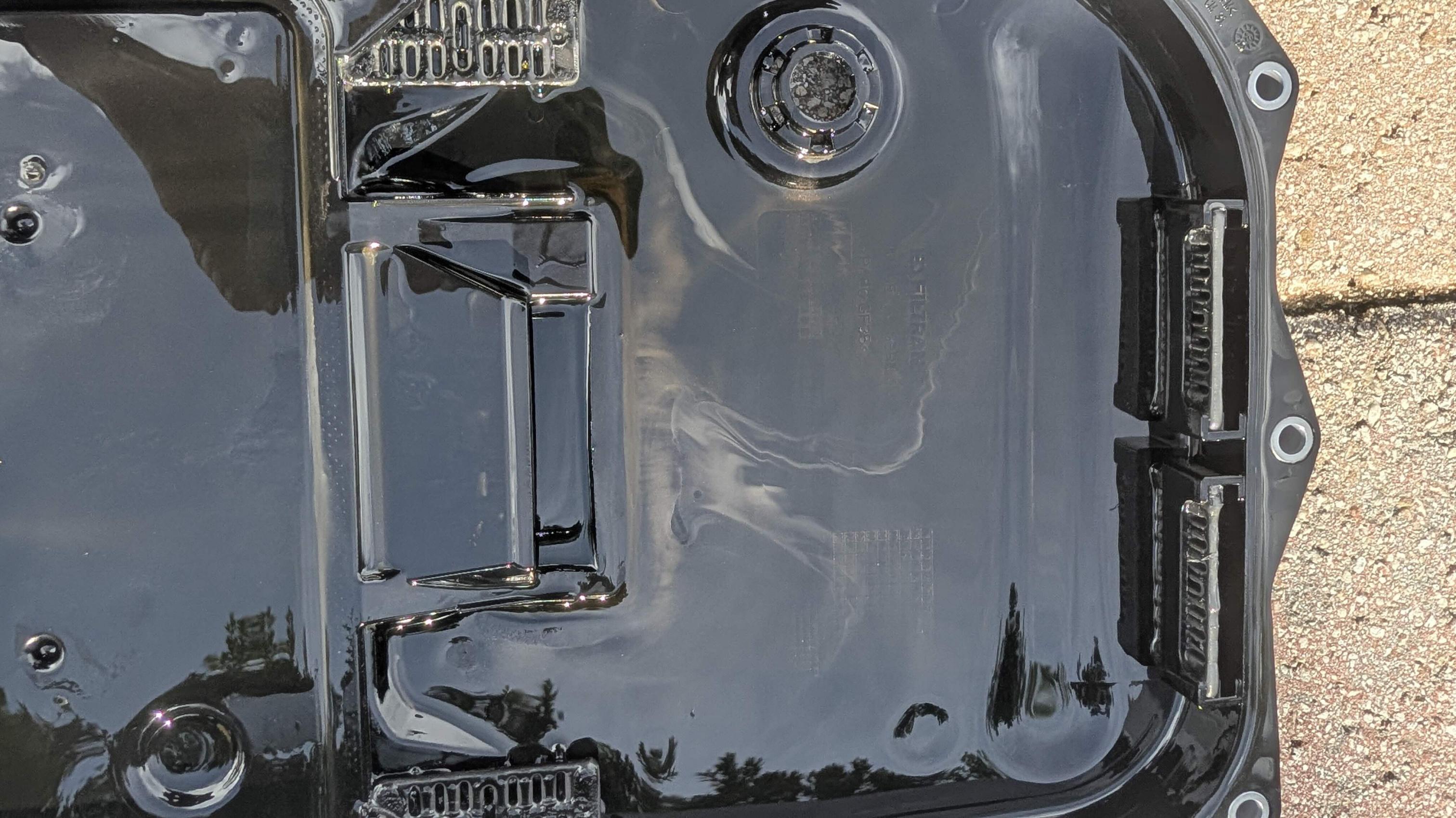

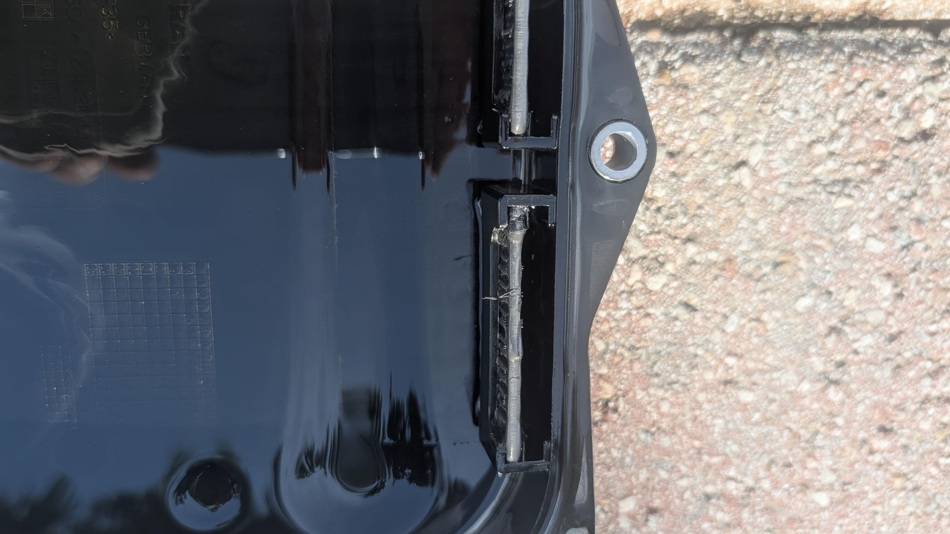

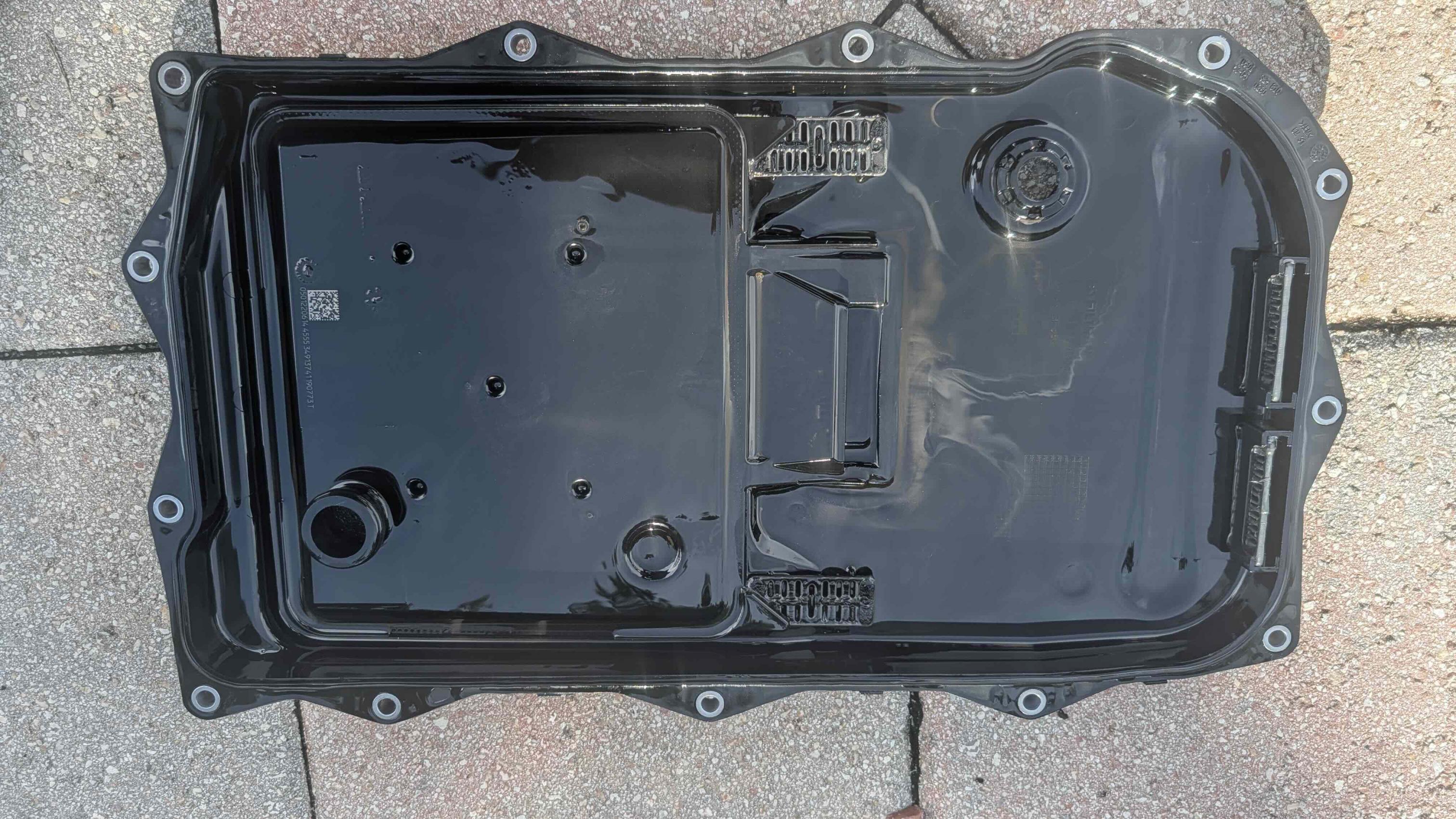

Removed the pan and that was when I got really concerned. The magnets had picked up a bunch of metal filaments (see photos) and there was some cloudiness to the oil in the filter bottom but not the extracted jug of oil. Would love your thoughts on what I found in the pan.

So what do metal filaments in the oil mean? Was the transmission going? Was it on its last legs and this fluid change will make it last?

I'm going to say that is mostly normal.
Gears and bushings wear out a bit. And your clutch plates will create some wear. That's why magnets and filters are installed in transmissions.

Thats encouraging to hear! I am still glad I did the fluid change when I did and at least it seemed to have gotten rid of a drivetrain vibration.

"So what do metal filaments in the oil mean?" That is swarf.

If by swarf you mean the fine metallic powder, I expect thats normal... However the thread like filaments were what got me worried.

Textbook Swarf
