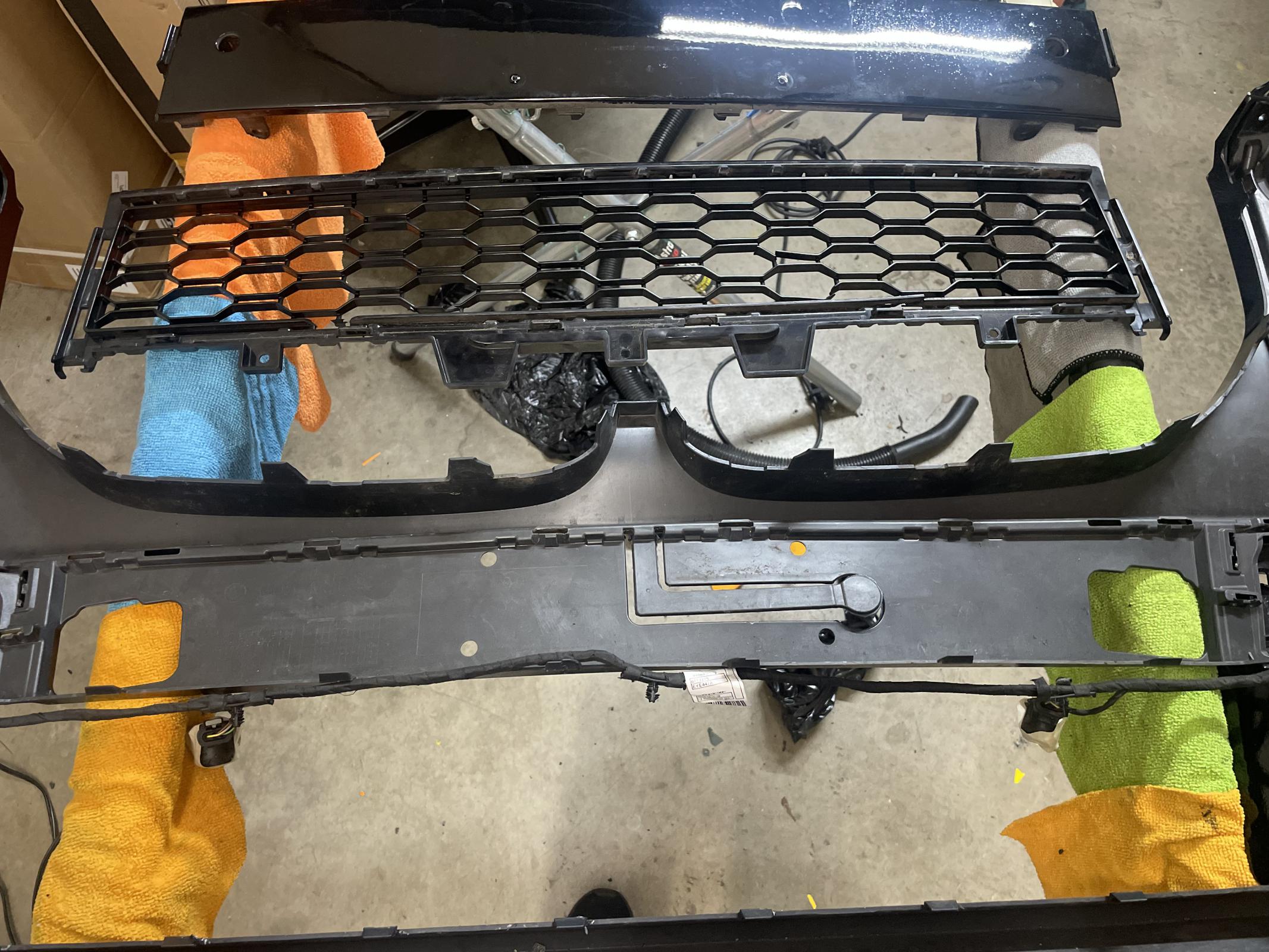

I tore this apart just so I can get detailed pictures for ya'll

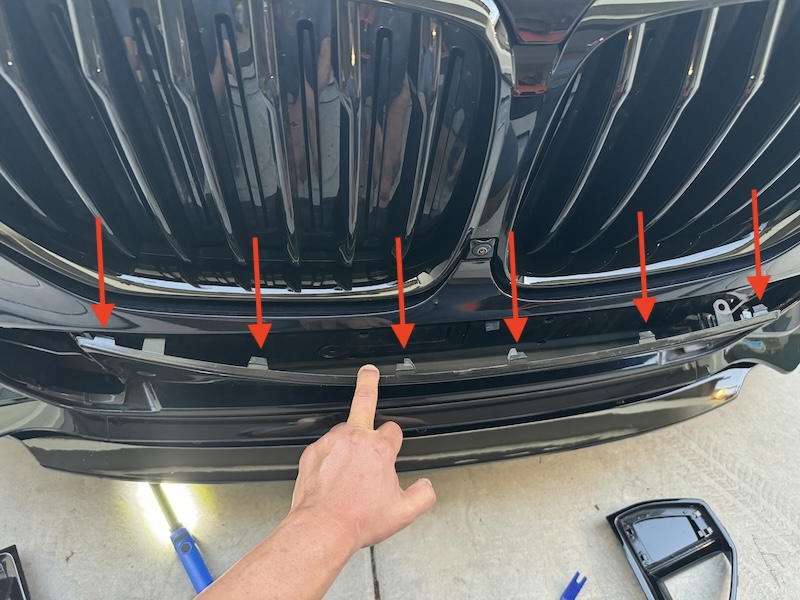

1. Start by using the pry tool to remove the corner pieces. You can start in the corners marked by the blue arrows and pull from the inner depicted by the red arrows. You will want to pull at an angle to release the tabs. The first time is probably the hardest.
The Driver side inner piece comes out completely (Orange box). The Passenger side is a bit trickier and I didn't remove (both not needed to remove tbh). The Passenger side has a piece of plastic that looks like an arrow that keeps it attached to the bumper assuming because that is where the tow hitch hole is. It comes out, just takes a little more work but you don't need to fully remove it.

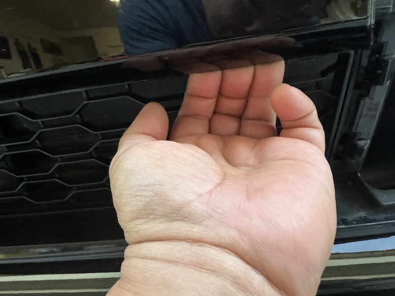

3. Pull from the bottom on black trim piece

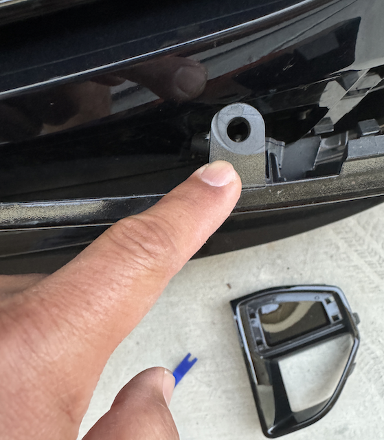

* You can see that the tab with round hole is just a locator. Nothing is fastened there
Here is a view with all of the clips

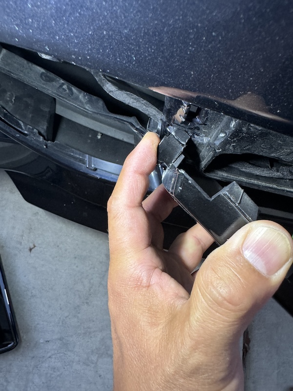

And the last (Passenger side) clip/retention tab is a bit tricky

4. So I didn't get pictures of the sensor removal...
With the black license plate trim removed, you will see both of your sensors. There are TWO retention clips on the black trim that you will spread out to release the sensors. If you lose the black rubber gasket, just put it back on. The flat side goes against the sensor base and the grooved piece faces you.
