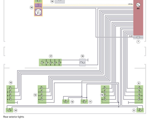

So i paid for BMW ISTA for the day and pulled the wiring diagram off for my pre lci and a LCI X5. Initial thoughts is that this might not work since BMW changed up the wiring and looks like there an additional module now. whats also weird is that the back up light on the LCI is on the outer light just like before but the wiring is showing its coming from the inner light which i assume the additional module is controlling? I'm not a wiring buff by any means so sharing this on the forum to see if this makes sense to anyone else.
Pre LCI Rear Lights (Outer and Inner)

      05-20-2023, 03:25 AM   #15
sebseb
74
102
Drives: 2023 X5 45e
Join Date: May 2020
Location: PNW
Thanks for sharing these.
TL;DR LCI tail lights are not compatible with pre LCI vehicles.
Wire Color Legend
SW (Black), BL (Blue), GN (Green), VI (Violet), WS (White), RT (Red), GE (Yellow), BR (Brown).
Wire gauge values are in units of mm2.
1.5 - 14 AWG, 0.75 - 18 AWG, 0.5 - 20 AWG, 0.35 22 AWG.
E62, E60, E58 and E57 are the designations of each housing and *1B refers to the connector on the housing.
In the Pre LCI drawing, A258*5B is referring to the 5B connector on the Body Domain Controller (BDC). By looking at the wiring diagram and the 18 gauge of the 5 wires that go to each housing, my guess is that the BDC is the unit powering those lights directly. For example if you supplied 12V Positive to light housing connector pin 2 and 12V- Return to pin 6, the reversing light will turn on.
BMW completely changed the headlight functionality and how they control the headlights with LCI. Instead of the BDC actually controlling each light bulb, it sends data to the light housing module using CAN Bus. CAN Bus uses 2 wires for communication - Low and High (CAN_L, CAN_H). CAN wire is usually a twisted 22AWG wire pair which is why you see 0.35 for those wires on the drawing. Each light housing gets 12V-Positive which is fed to the RLM** Module. The Module then controls the output intensity of each light based on the data it's receiving. It looks like the reverse lights have also been moved to the inner housing. The module is also responsible for creating the pulsing effect. So you no longer can supply 12V to a set of pins on the connector and have a light come on. You would have to supply 12V to the light housing and transmit the right CAN data frame for the lights to turn on.
You can see the difference between two in the BDC high-level drawing. Pre-LCI has a lot of wires going out of the BDC to each light bulb:
Name:  Screen Shot 2023-05-19 at 11.45.23 PM.png
LCI just has 2 wires going out of the BDC to the can bus (drawing is from a G12 LCI Technical Training Document):
Name:  Screen Shot 2023-05-19 at 11.45.35 PM.png
