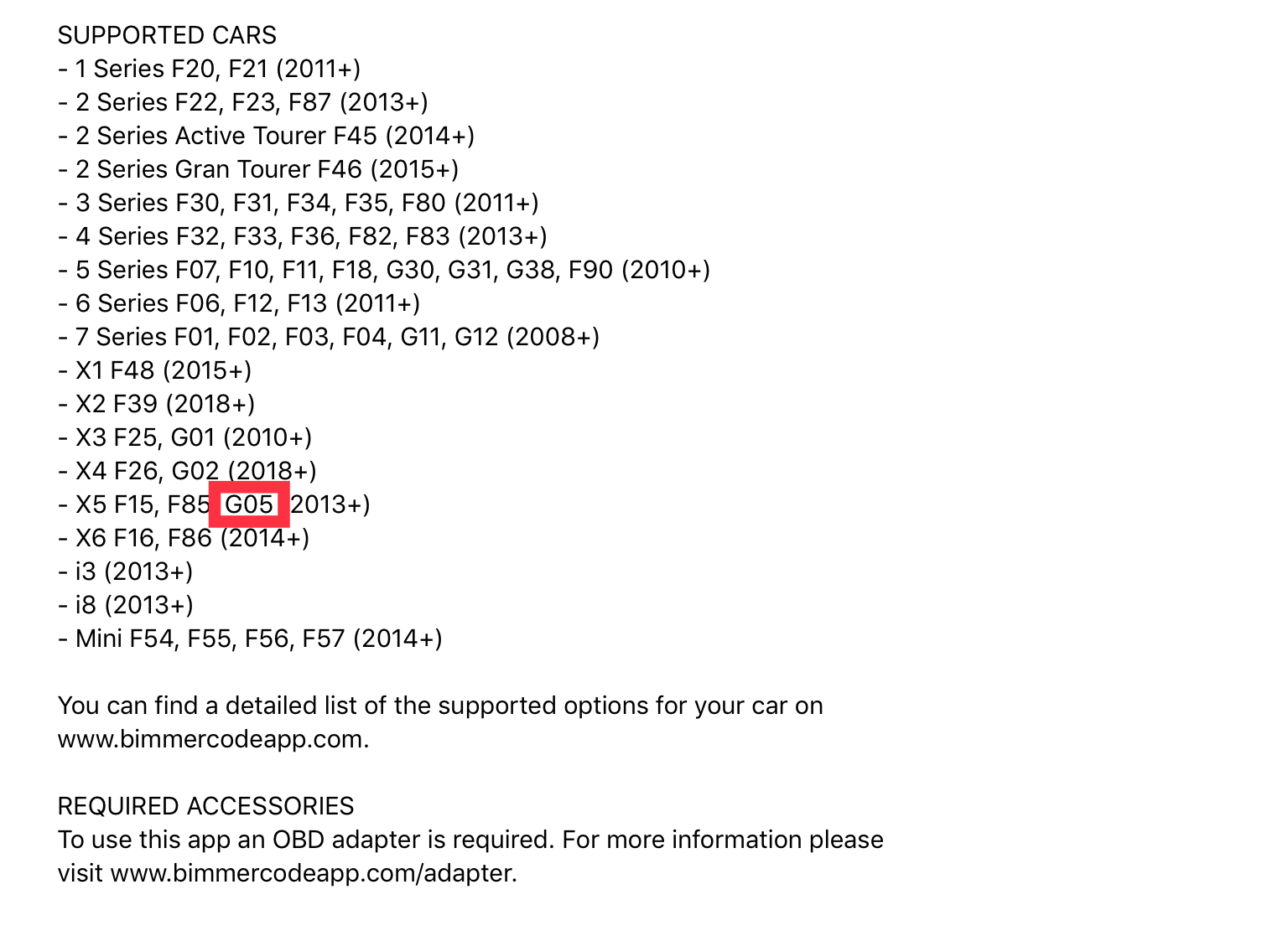

Originally Posted by SCA View Post
to disable Auto/Stop function on G-Series BMWs.
G05 has completely new ECU set. Bimmercode I doubt can code any functions.
Per the developer BimmerCode can.
Impressive considering they are not on the road. Wonder how developer tested.
Website also says software can code HUD turnsignals, which cannot be done on Digital clusters.
I contacted Bimmercode back in the end of July when I placed my order for the X5 and the reply was that the ECU is shared by other G series vehicles. So any G series vehicle will be supported right from the start and more features will become available as they start working with that specific model.
