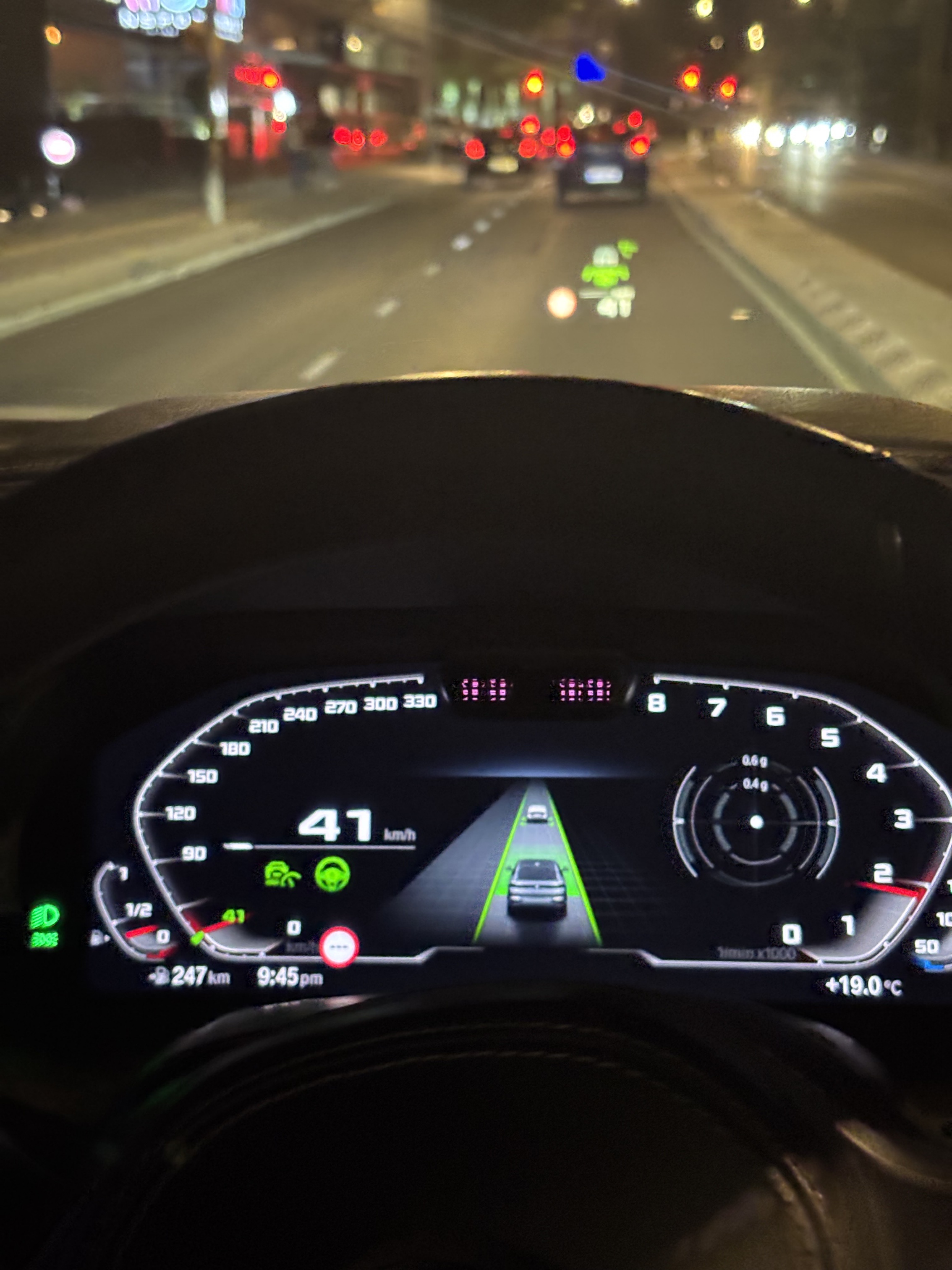

Worked perfectly James! Much appreciated man!
One question.
How do I enable the view below? When I press sport or sport+ mode the cluster doesn't change. I have set instrument cluster to M and it works fine as on the photo above but can't get this mode.
Is it a different module?

You cant get that view through coding, that's something available to only REAL M cars.

The M track view is an instrument panel theme available only on the original M.
If you are not an original M vehicle, you can purchase and install a third-party module to activate the M Track View instrument cluster.
I have purchased and used these modules.
The module I bought also has the ability to display gear stages from D1 to D8 in D mode.
