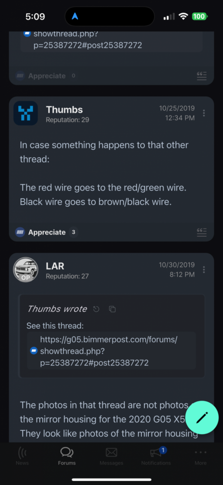

https://f90.bimmerpost.com/forums/sh....php?t=1556366
When in doubt, I always refer to the M5 forum. They always be up to something over there and it usually translates to our minivan body style because of the similarities of the CLAR platform.
Appreciate 3
      06-24-2025, 12:57 PM   #5
25_F95Competition
42
132
Drives: 2025 BMW X5M Comp
Join Date: Jun 2019
Location: New York
Thanks. Will give this another go this weekend.

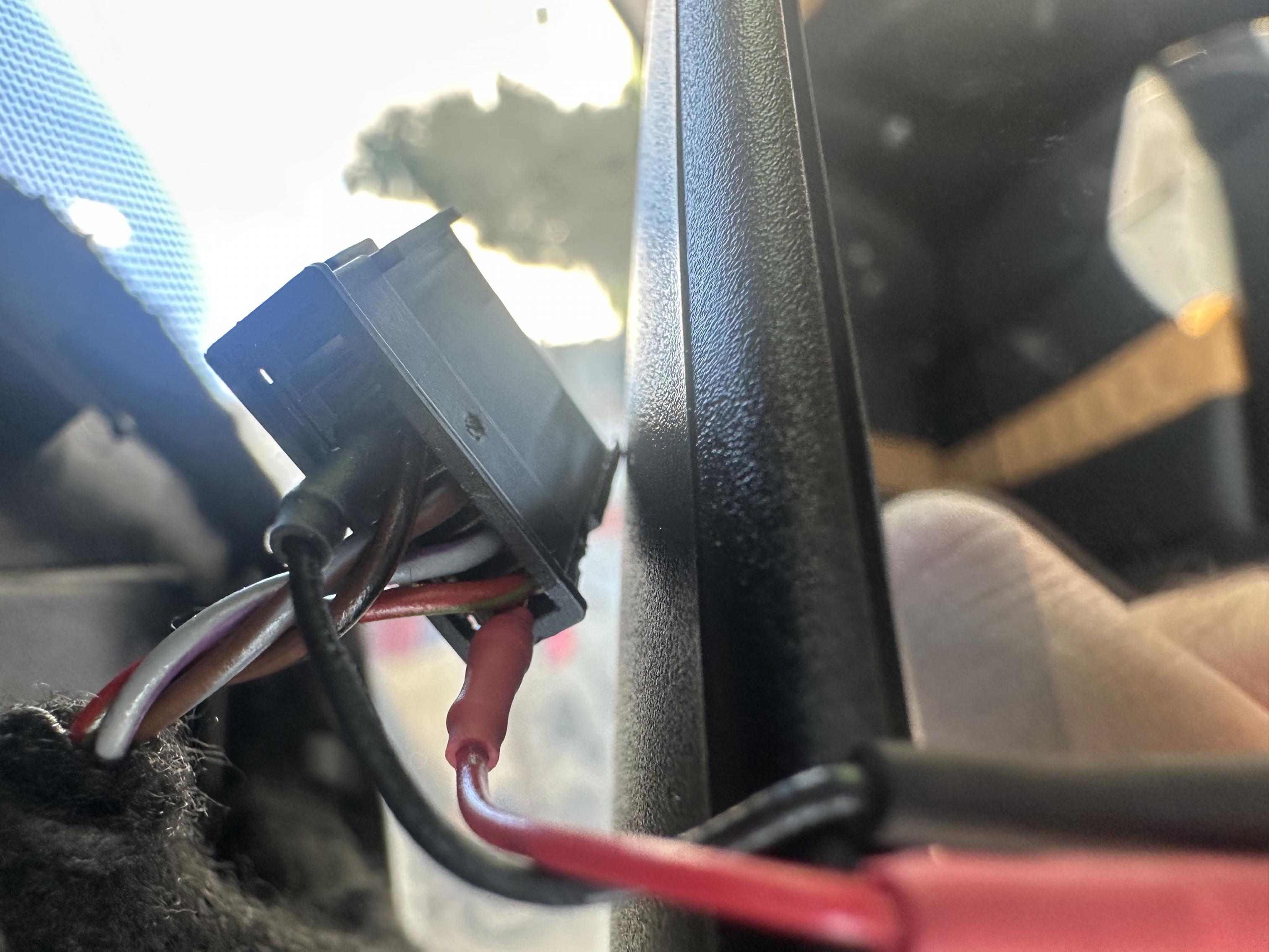

please see attached pics. i just placed the black to brown and red to red on the larger black wire harness. the video shows him using the maroon/purple harness. i tried that but the radar detector did not turn off after more than 5 minutes. maybe it would have taken longer i’m not sure. but, i can confirm that the radar detector will turn off if you hook up as described and pictured. this is for a 2026 X5M Comp.
thanks!
      10-12-2025, 01:57 AM   #22
nu2M
350
202
Drives: ‘26 X5M Comp
Join Date: Apr 2023
Location: SoCal
thanks!
I also have a ‘26 X5MC. I actually did just as the “KIES” video and it definitely takes way longer than 5 minutes for the radar detector to shut off. It’s a bit strange since only the ground is plugged into the maroon/purple harness, which shouldn’t matter, right? I’m too lazy to redo this but thanks for posting!
