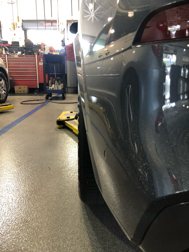

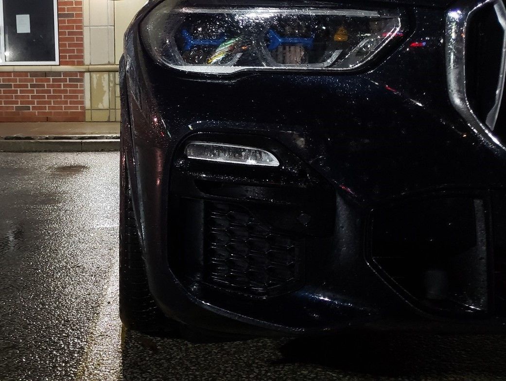

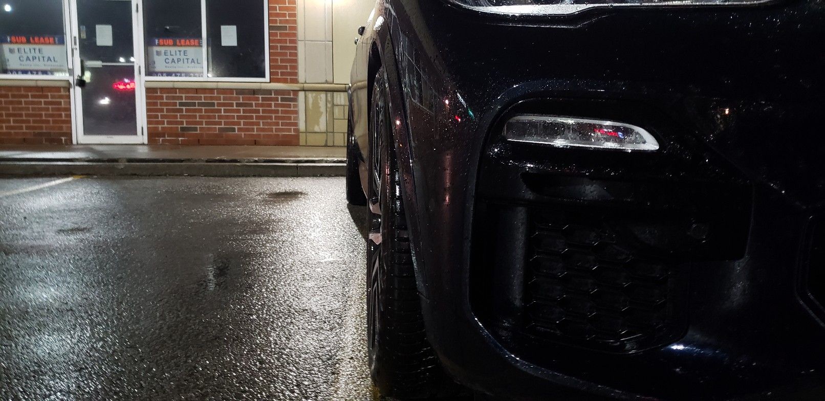

Guys,
As promised. I spent time today to test wheel spacers on G05 X5.
Here what I gathered today.
Conservative setup: 12mm front and 15mm rear
Aggressive setup: 15mm front and 20mm rear
So, here is the picture from front and rear for comparison.
More pictures you can find on the build thread that I will compile soon.
Feel free to ask any question or PM me for quotes.
Wheel Torque information:
- Factory recommendation 103ft-lbs, I normally put 105ft-lbs.
- Conventional wheel spacer (non wheel adapter design), I normally put 110ft-lbs.
12mm / 15mm setup
15mm / 20mm setup

Looks really good! This would be a good thread for us to post pics of the different spacer sizes. Now I'm curious to see the aggressive setup of 15 and 20mm.

It is not that total aggressive.
Just a tad where 1" lowering will make it perfect.

No rubbing at full lock.
We are not changing the tires rolling diameter.
I have more pictures, but these are the best angles.
Car have 4 corner air suspension. So it is lowered at Sport mode.

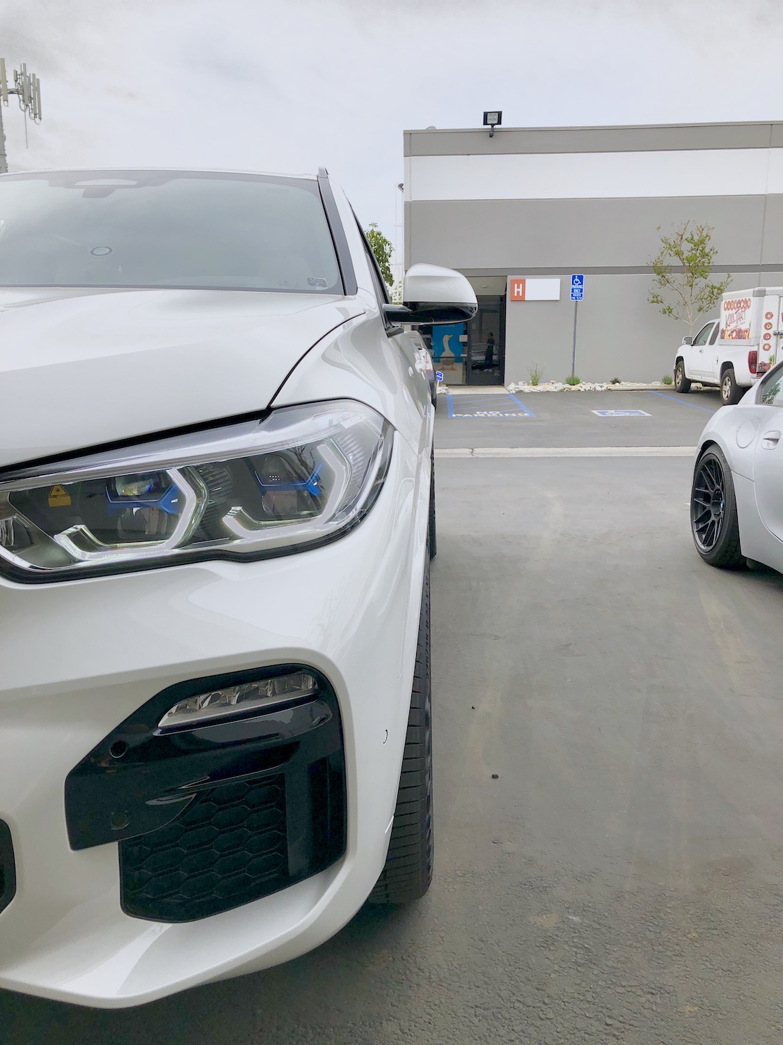

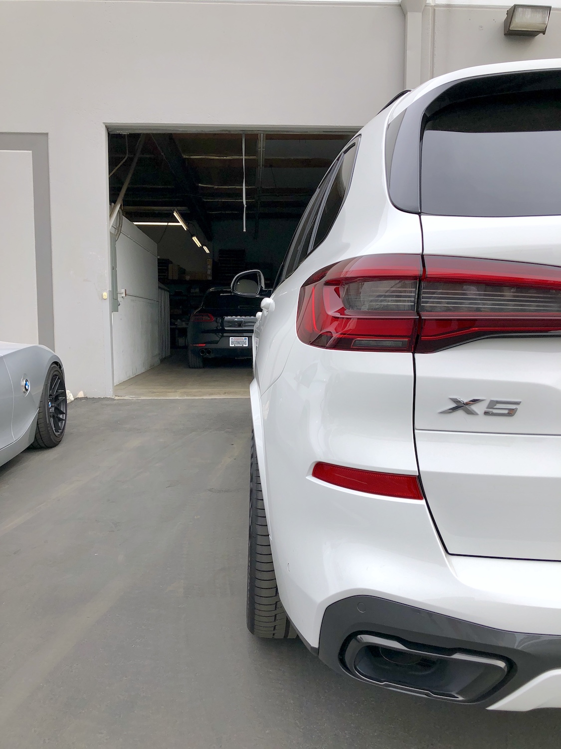

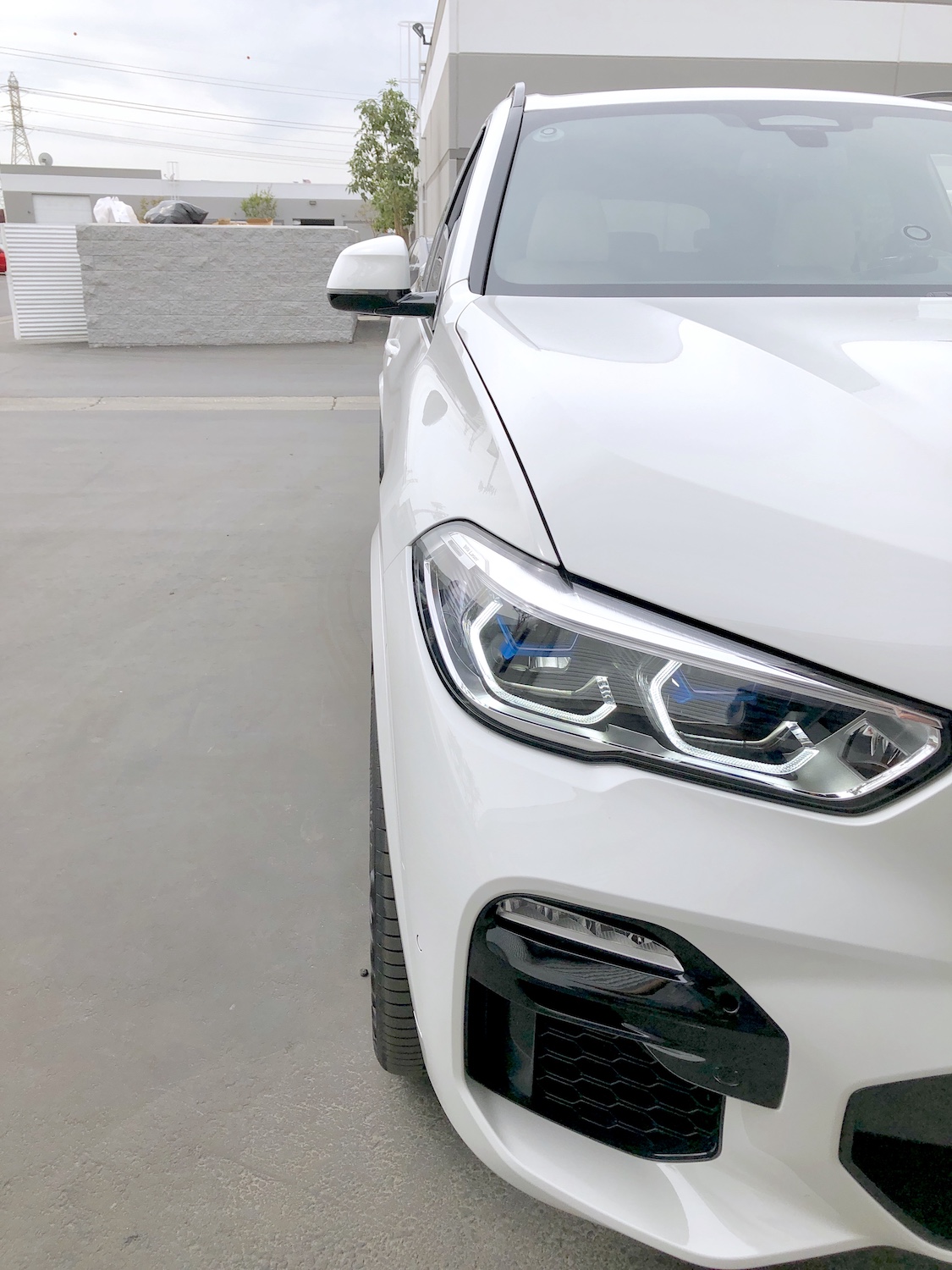

12mm front bolt length 37mm
15mm rear bolt length 42mm
Lowest air suspension height.
22" 742M
No rub when the steering wheel is tuned all the way.

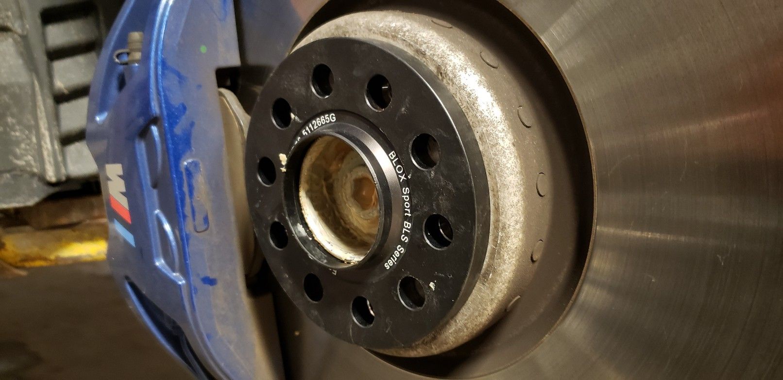

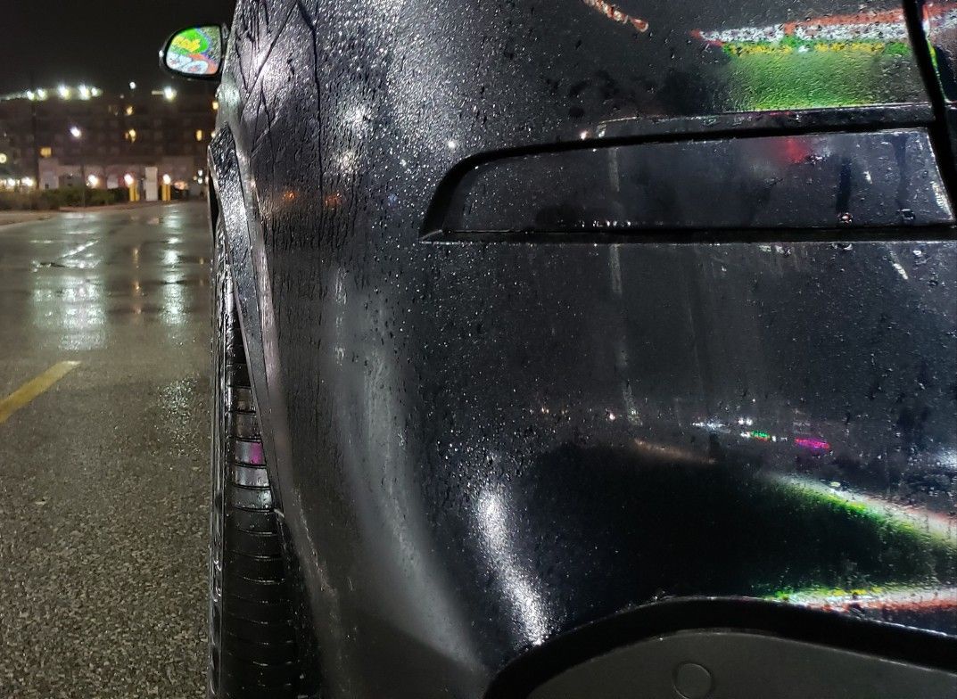

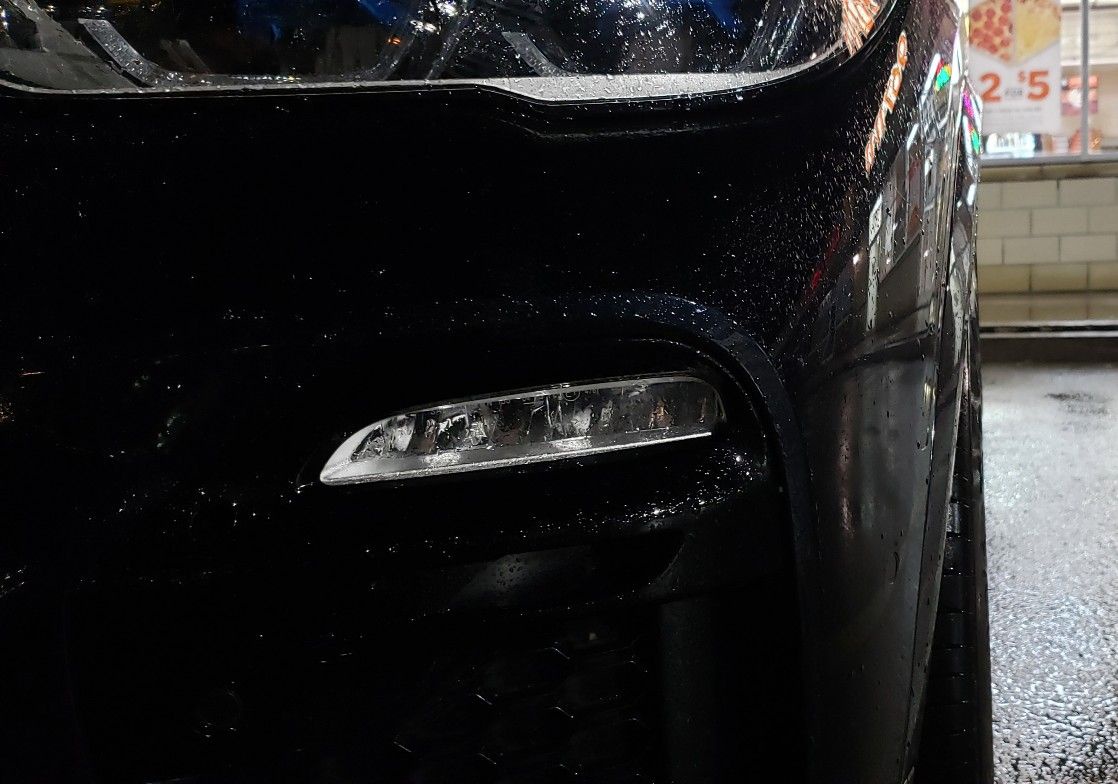

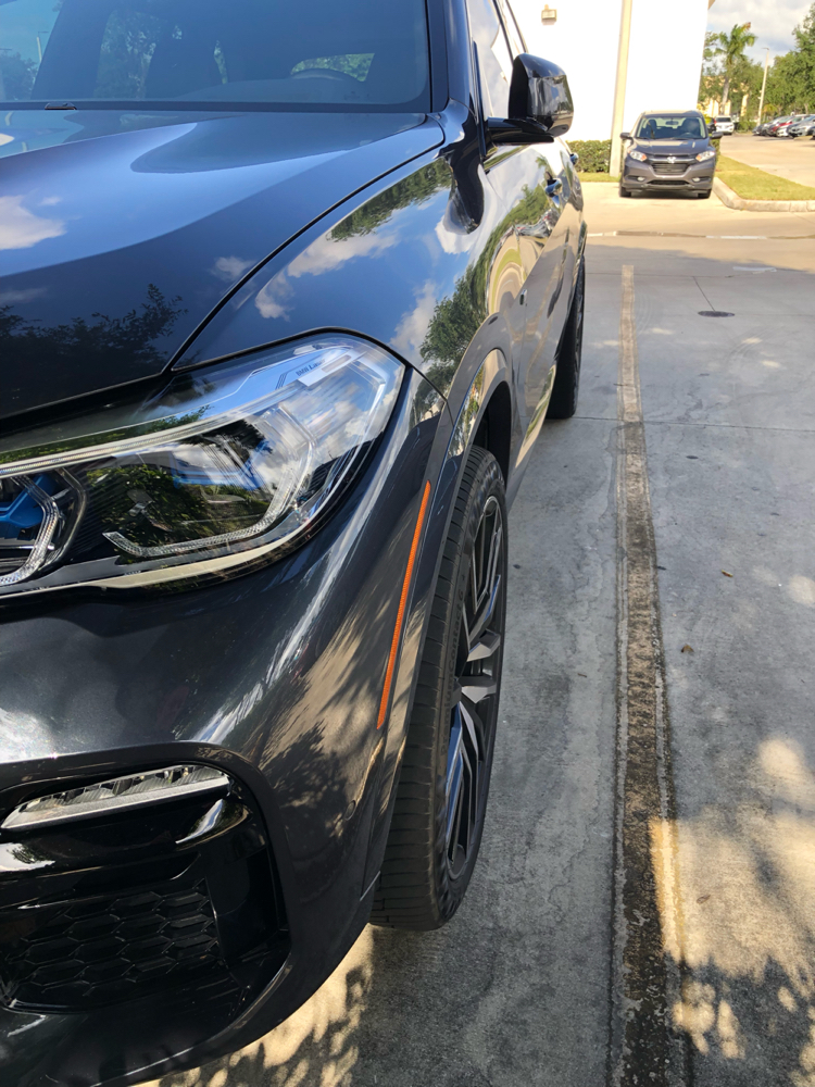

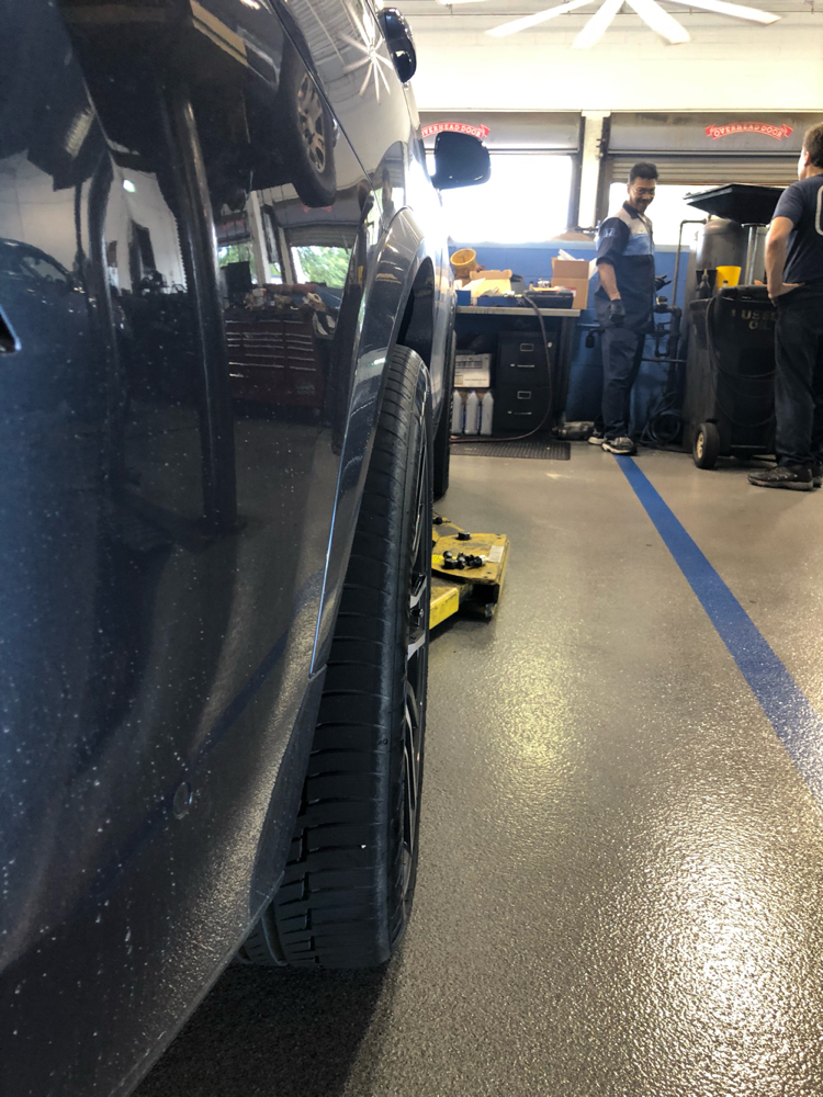

Just installed the 15mm fronts 20mm rear. Shout out to Ben at RG Sport. Took pics right side on left side stock.

Thank you for the shoutout. :)
Full on picture please. :D

Here you go.
04-30-2019
Looks good. Too aggressive for my taste. 12/15 would be my choice.
