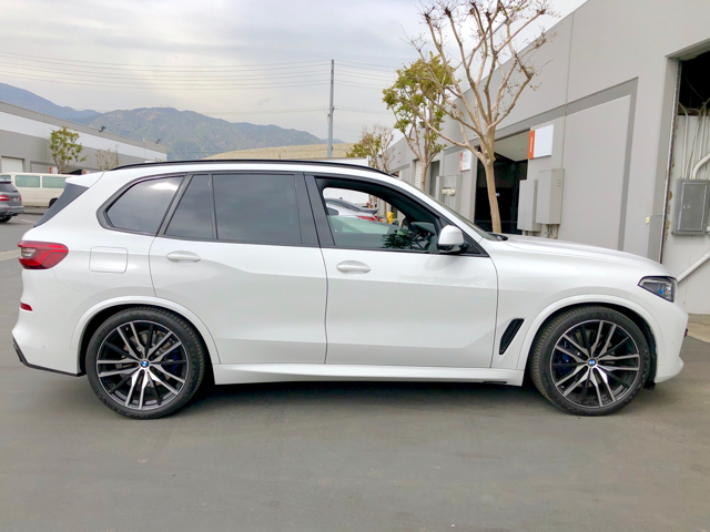

Side views with the 22”? No rubs?

Side view. No rubbing.

I am thinking in 15 front and 12.5 rear, what do y think? Y have these sizes? Mine came. With the 22".

The correct setup on this G05 X5 is thicker on the rear.
But, H&R doesn't make 12.5mm, they have 12mm and 13mm.

I got 15mm front and 20mm rear and while the rear is perfect (even a bit aggressive for me) but the front at 15mm is almost missing 2-3mm. I definitely suggest sticking to 15mm front.
I have the OEM 22s as well

As Ben said...you need the bigger one in the rear, not in the front.
However, as my post above says...15mm isn't aggressive at all for the front. if there was a 17-18mm I would do that, especially if you do a 20mm rear.

So, 13 F and 15 R?

My setup was 12 front and 15 rear.
It is 1mm difference and 13mm hasn't been popular. So, H&R rarely have it in stock.
