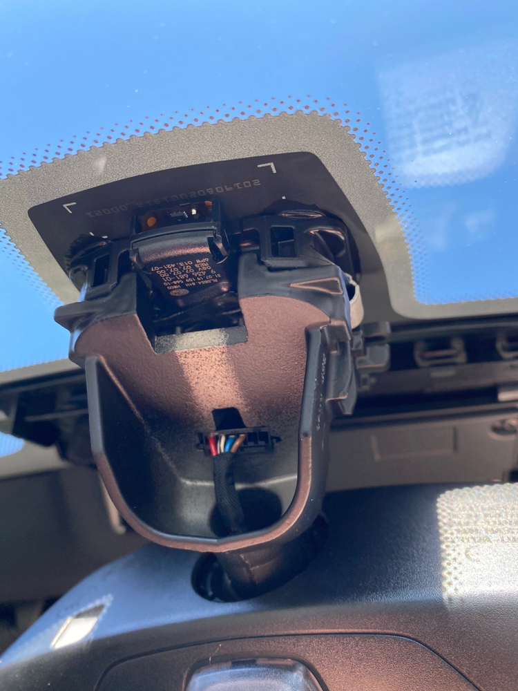

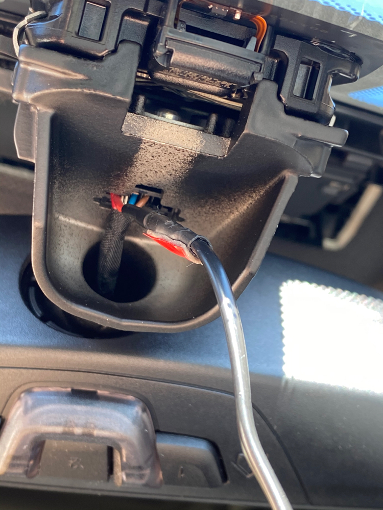

jmcmathortho wroteThanks for the photo depicting wire position/location for the ground and +12V. The image is a little washed out, and was wondering if by chance you recall the color(s) of each of the wires you tapped into? TIA for your help. Cheers.I just installed the wiretap to wires shown in picture to my 2020 X5 M50i. I can confirm it works and will shut off about 5 min after car is turned off. Just make sure you grab the wiretap flat connectors with some needle nose pliers (because they can be hard to push in) and push alongside the wire where it will make good contact to the metal shroud (I had to disconnect the molex plug and turn it backwards to get the best angle to insert the wires).
Cooltones wroteRed (car) to Red + (mirrortap)jmcmathortho wroteThanks for the photo depicting wire position/location for the ground and +12V. The image is a little washed out, and was wondering if by chance you recall the color(s) of each of the wires you tapped into? TIA for your help. Cheers.I just installed the wiretap to wires shown in picture to my 2020 X5 M50i. I can confirm it works and will shut off about 5 min after car is turned off. Just make sure you grab the wiretap flat connectors with some needle nose pliers (because they can be hard to push in) and push alongside the wire where it will make good contact to the metal shroud (I had to disconnect the molex plug and turn it backwards to get the best angle to insert the wires).
Brown (car) to Black - (mirrortap)
radmjk wroteGreat! Thank you!Red (car) to Red + (mirrortap)

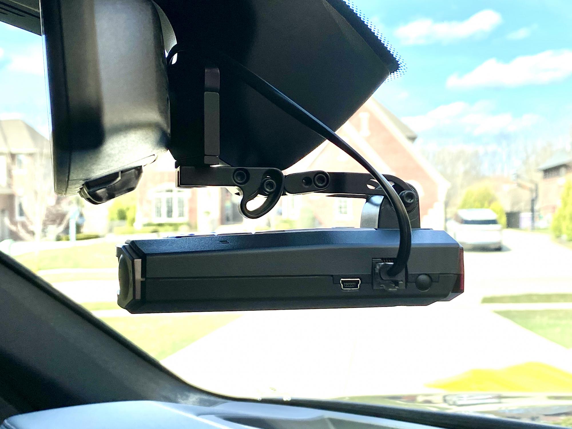

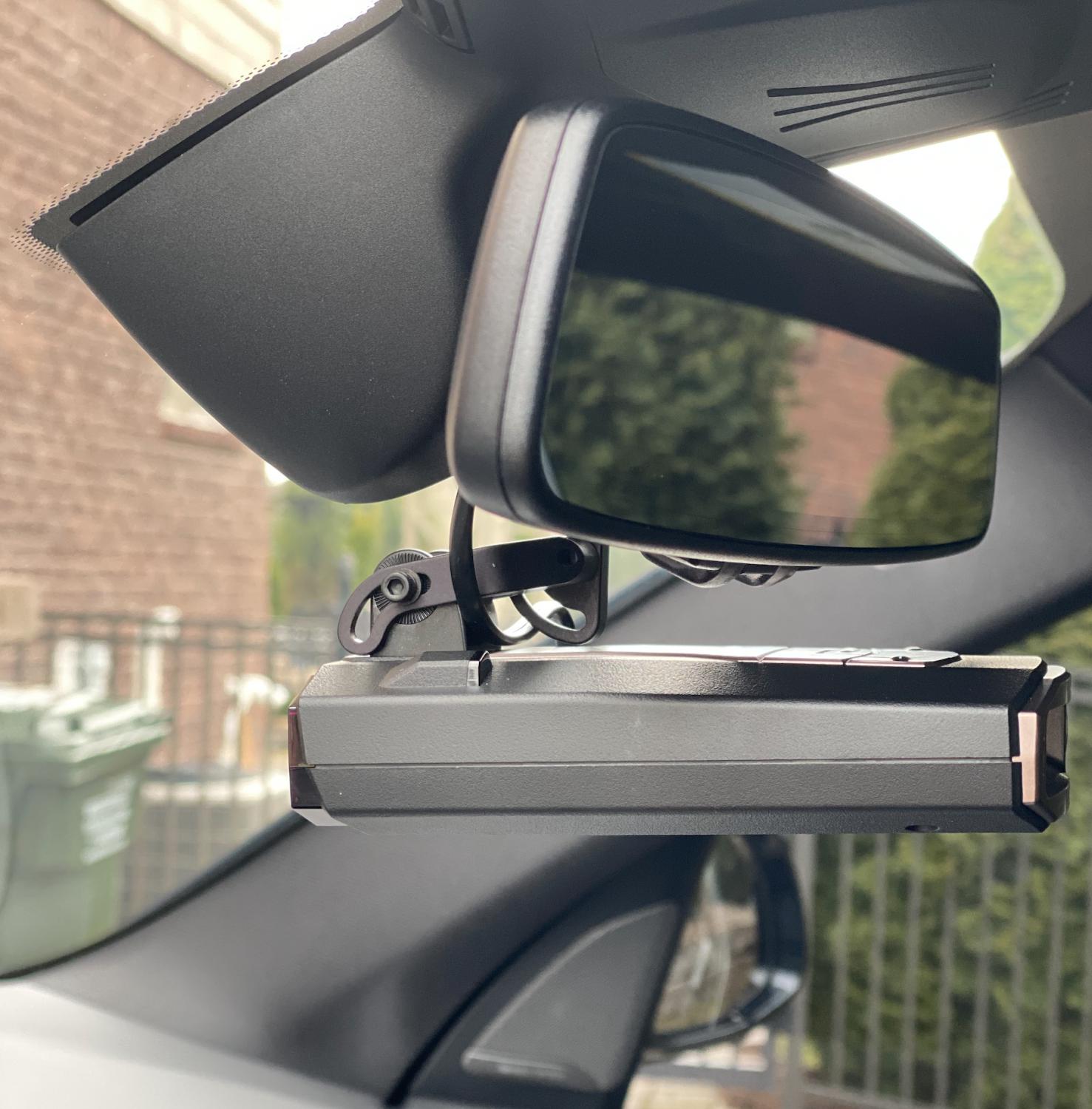

radmjk wrotewhat part number did you order to make your RD closer to windshield? Thanks.I received some new parts for the Blendmount. The company was very accommodating with the issue I had as far as wanting to bring the detector closer to the windshield. I really couldn't ask for any better service. Kudos to the Blendmount team!
2020G05 wroteHi, I honestly don't know the specific parts as they sent me "random" parts that they thought I could use and I had to send back the parts that I didn't use. You could use my photos that I posted in this thread and forward to Blendmount as they could probably identify the parts that I used. You could reference my name too, Matthew Kovie.radmjk wrotewhat part number did you order to make your RD closer to windshield? Thanks.I received some new parts for the Blendmount. The company was very accommodating with the issue I had as far as wanting to bring the detector closer to the windshield. I really couldn't ask for any better service. Kudos to the Blendmount team!

I just wanted to give a BIG THANK YOU to all who contributed to this DIY. It's because of the great photos and notes that I was able to get my Valentine 1 Gen2 RD installed (And YES, I did disable the Laser to avoid conflict with the Gesture Control...
)Anyway, just wanted to add a few notes of my own experience:
1) Your X5 is either going to have one of two different mirror covers. The bigger mirror cover is the BMW Connected Drive with the Driving Assistance Professional Package. Either mirror cover pretty much is removed the same way and YES - Attempting to remove the mirror covers on a warm/hot day does make removal easier.
2) Be sure to lay a towel on top of your dashboard before doing the work. Yes it was a hot day. And yes, as the sun was shining it got a bit hot in the car, especially when I was sticking my head up against the glass to view the molex connector and ensuring I was inserting the mirror tap blades in the right spot. I hear that sweat and leather don't mix...
3) Speaking of inserting the mirror tap blades: BMW RED+Green wire = 12 Volt (so that's where you'll insert the RED mirror tap blade). BMW BROWN wire = Ground (so that's where you'll insert the Black mirror tap blade). An important note about the blades. BE CAREFUL to NOT force the blades into the slots too hard or you'll bend them (which is what I accidentally did). The good news is that the blades are somewhat "bendable" but I advise avoiding bending them -- I saw somewhere that using needle nose pliers to grab each blade as you attempt to insert them might help prevent the blades from accidentally bending. ALSO, as someone else noted here on this thread, it's BEST to try and come into the connector from the side that is nearest the windshield.
4) Lastly, I placed a piece of gorilla tape over the area where I had inserted the mirror tap blades as I thought this would help prevent the mirror tap blades from working themselves out -- I don't think this would happen though, given the "snug fit" feeling as I inserted the blades.
5) If you have an RD that uses the standard RJ-11 ("telephone") plug, then you're want to order the Mirror Tap for BMW X5: MT-4015.
Alright. That's what I've got to contribute. Again, I'm so very GRATEFUL for all the guidance from the other folks on this thread. I just felt compelled to "give back" too.

Just did an install on F95 - I had to jump around to a few different comments, so just to summarize for future installers: I followed #19 to remove upper panel first (pull from the top after inserting a plastic wedge - very little force was required). To remove the twin panels on the sides I first disconnected the attachment at the top that is visible (push on the tab and pull the cover sideways), then I put a plastic wedge into the seam between the twin panels starting from the bottom (closest to windshield) and disconnected them from each other. After that medium force was required to pull each one out separately because there is another plastic pin on the inside.
The wires are as shown in #21, though my colors are different than what's in that photo - for me black went to black/brown on car, and red to red/green on car.
The wiretap blades fit snug but I could imagine them popping out due to movement so I ziptied the wiretap wire to the stock wires. I didn't have to drill any holes with the blendmount wiretap - it fits very easily through the stem opening and in fact there was enough space for me to adjust the wire a bit and push it in more after putting everything back together.

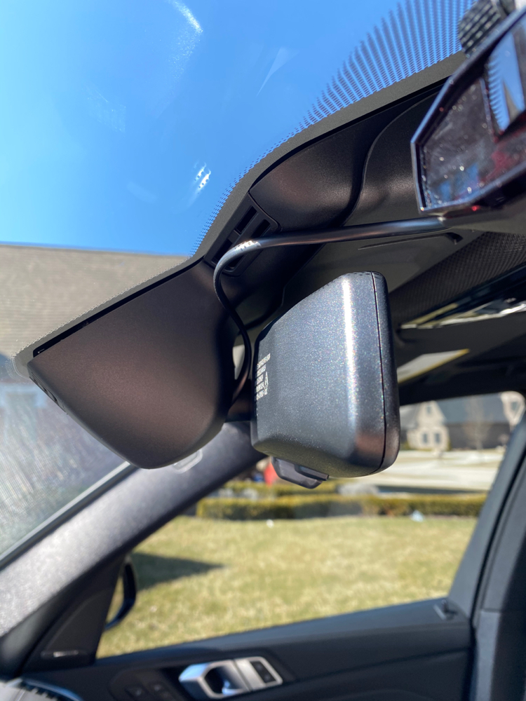

radmjk wroteGreat info. Anyway you can tell me how to remove the covers ? It would be create if you have photos. thank you !I finally hooked up my radar detector via the mirror tap. I "tapped" into the wiring harness on the backside (side closer to the windshield) as other(s) have reported. It was a really easy process. I would recommend performing with warmer temperatures as plastics are definitely more malleable. I took everything apart once before when it was colder out, even with the heat on and was more difficult to separate and remove plastic coverings. I will now order the blendmount for the detector. I attached a few photos below. Hopefully, someone will find them helpful.
rdavid011 wrotePlease check out the first page of this thread, has pretty detailed info and photos of the plastic covers.radmjk wroteGreat info. Anyway you can tell me how to remove the covers ? It would be create if you have photos. thank you !I finally hooked up my radar detector via the mirror tap. I "tapped" into the wiring harness on the backside (side closer to the windshield) as other(s) have reported. It was a really easy process. I would recommend performing with warmer temperatures as plastics are definitely more malleable. I took everything apart once before when it was colder out, even with the heat on and was more difficult to separate and remove plastic coverings. I will now order the blendmount for the detector. I attached a few photos below. Hopefully, someone will find them helpful.

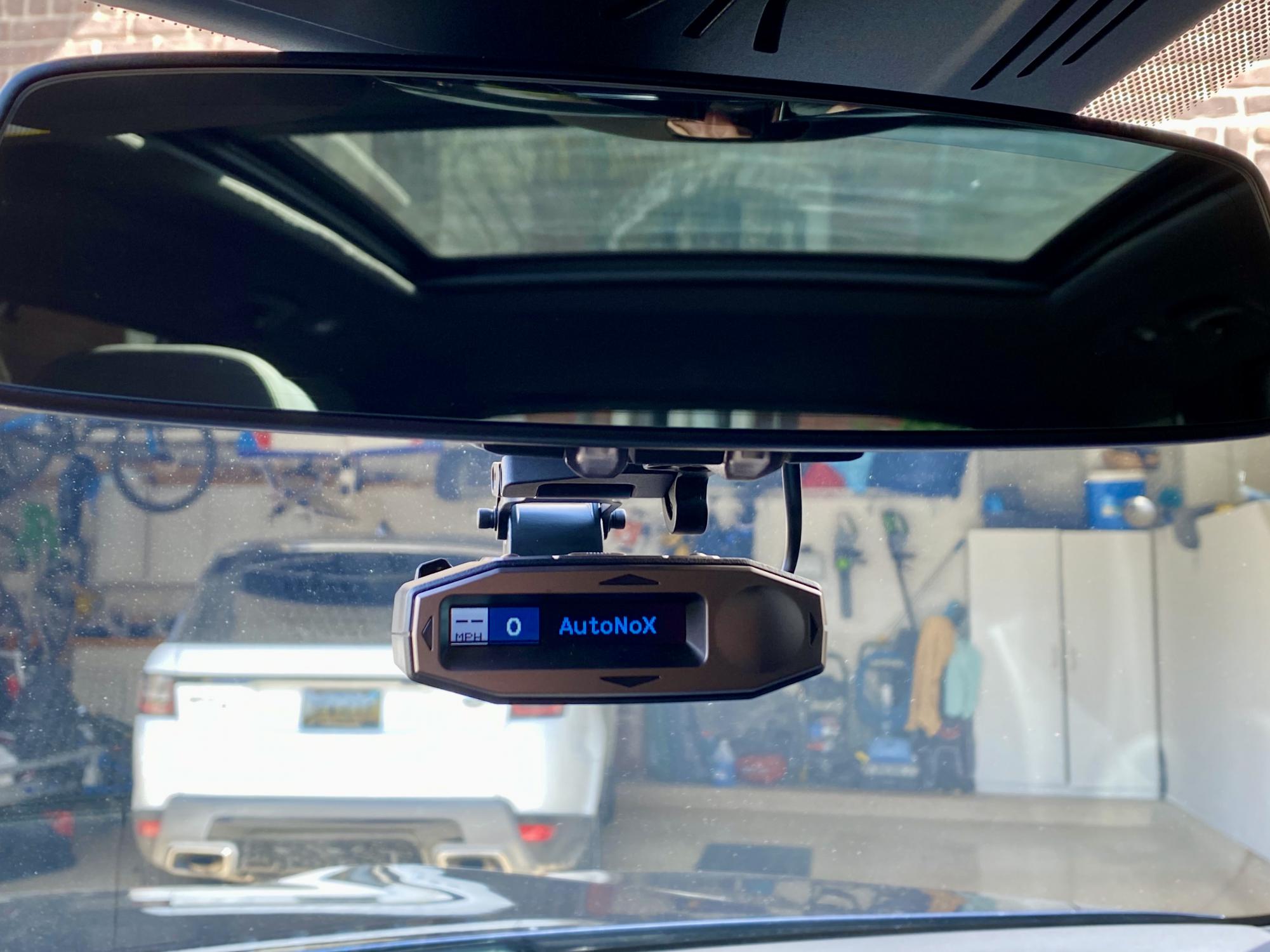

For those that have the Radar detectors installed, any interference with the laser distance cruise control sending false alerts?
Yes, I had Laser interface. I have a 2021 M50i with Executive, DAPP, and Park Assist packages. As soon as I pulled out of my garage, my laser warning went off. Thought it might be a fluke, so I drove around the neighborhood and Laser went off 3 more times. I don't do much daily highway driving, so I turned off Laser for now.
Radar detector is Escort Max360. I have it connected via mirrortap and mounted via blendmount.
