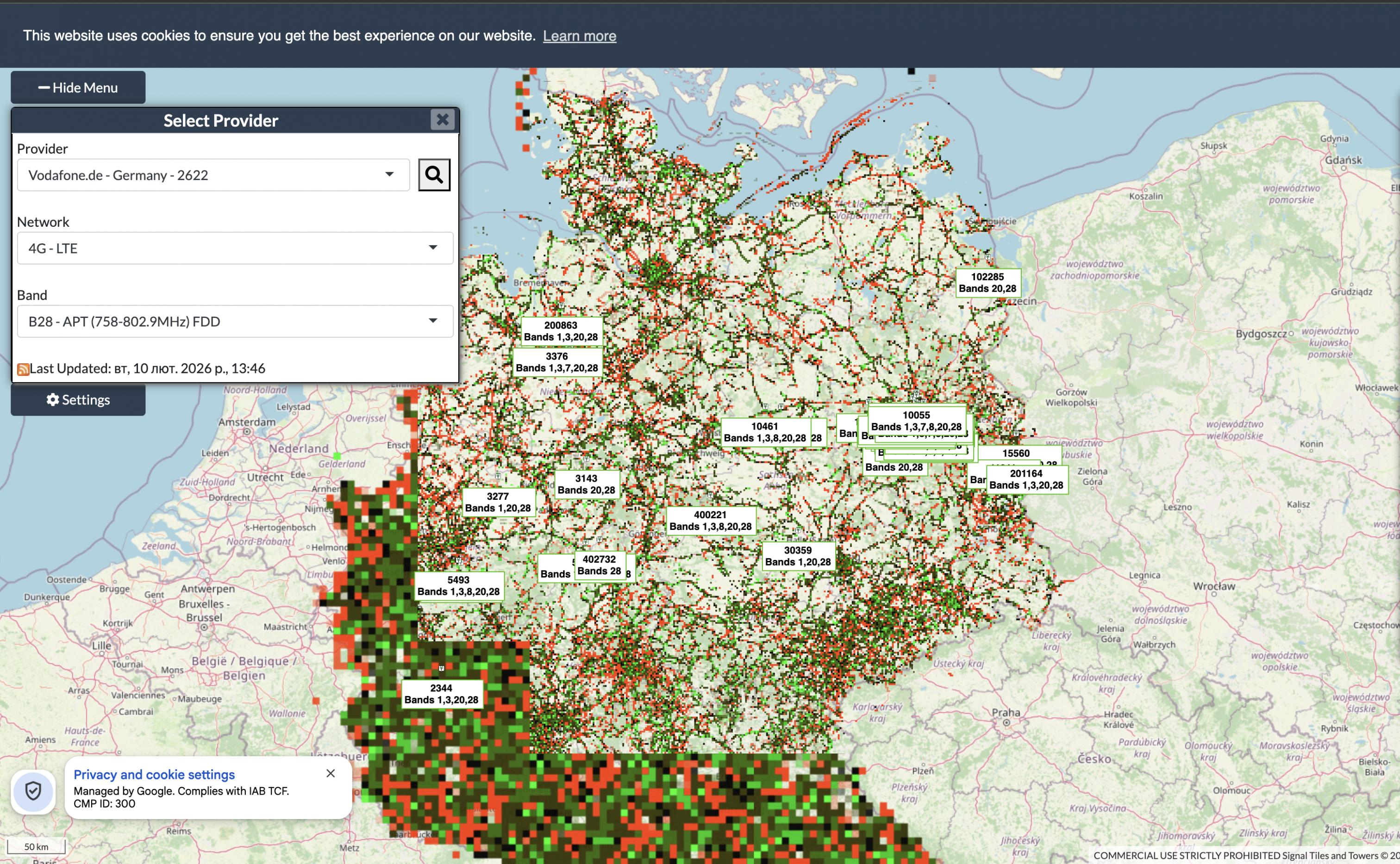

Hello everyone! I’m an owner of a BMW i5 from the USA and I’ve run into the same problem with getting internet working in the car. After reading this forum, I noticed that many people wrote they specifically drove to Poland to add their BMW ID profile. I live in Warsaw, but the internet in my car does not work. It shows: “No mobile data reception at current location.”:mad0260:
After studying this forum, I came to the conclusion that the issue is related to the mobile network frequencies and possibly roaming compatibility. The required frequency should be similar to the one used in the USA: LTE Band 28 (APT 700 MHz).
I found a service where you can check exactly where Band 28 signal is available in a specific area.
Here is the link to the service:
https://cellmapper.freshdesk.com/support/home
It can be used without logging in.:thumsup:
Since it’s quite far for me to drive from Warsaw just to reach the nearest network location (in the Czech Republic or Germany), maybe someone could test this and report back here for all of us? Thank you.
P.S. There is one nuance: I’ve heard that Band 28 can sometimes also be used for television broadcasting, so even if B28 appears on the map, it doesn’t necessarily guarantee that mobile internet in the car will start working.

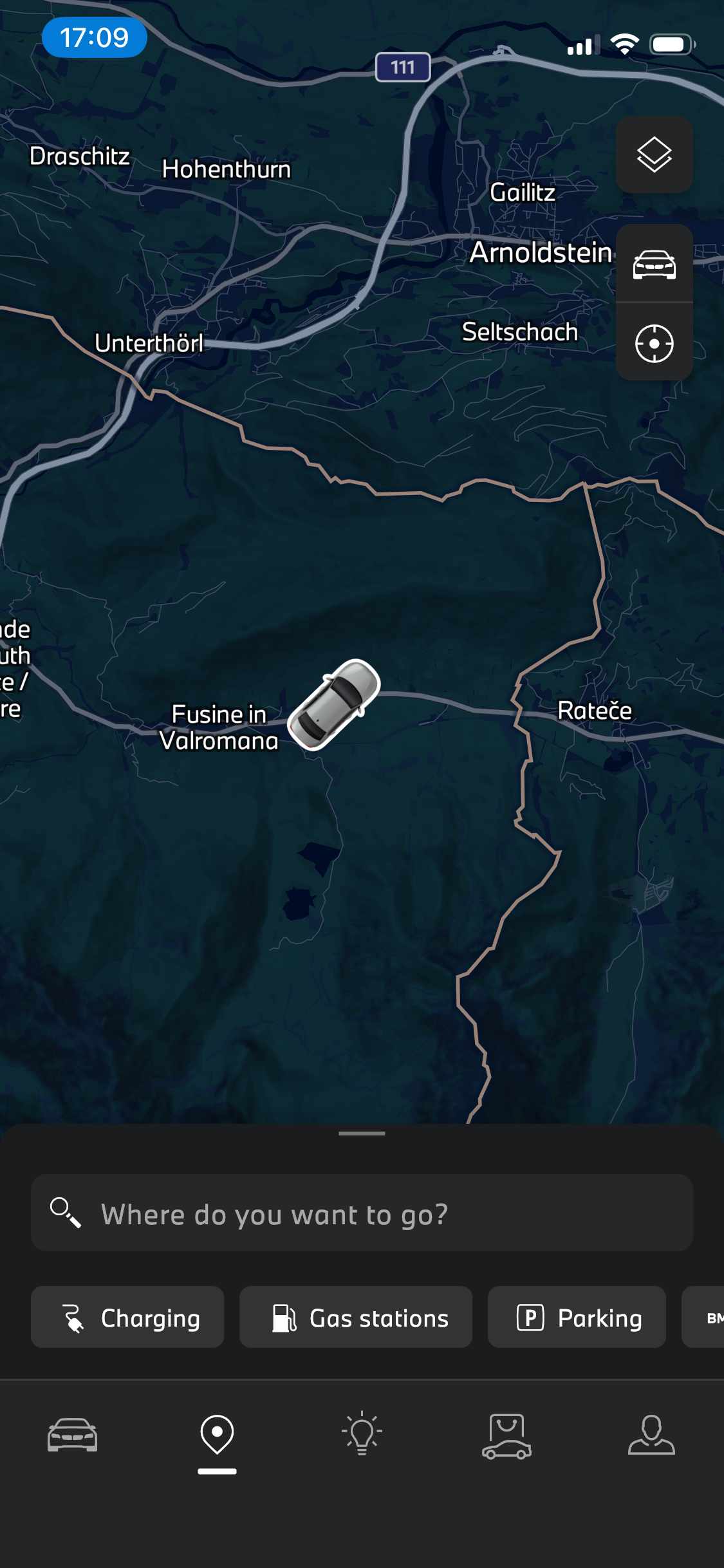

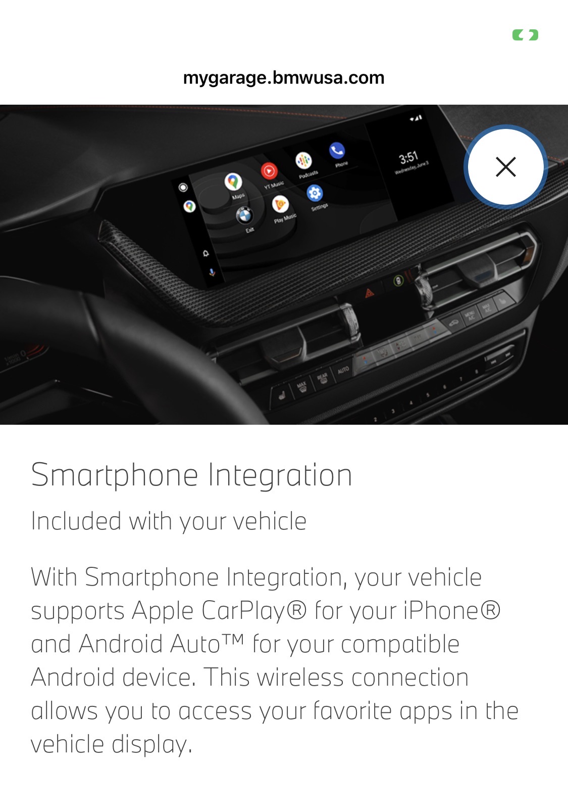

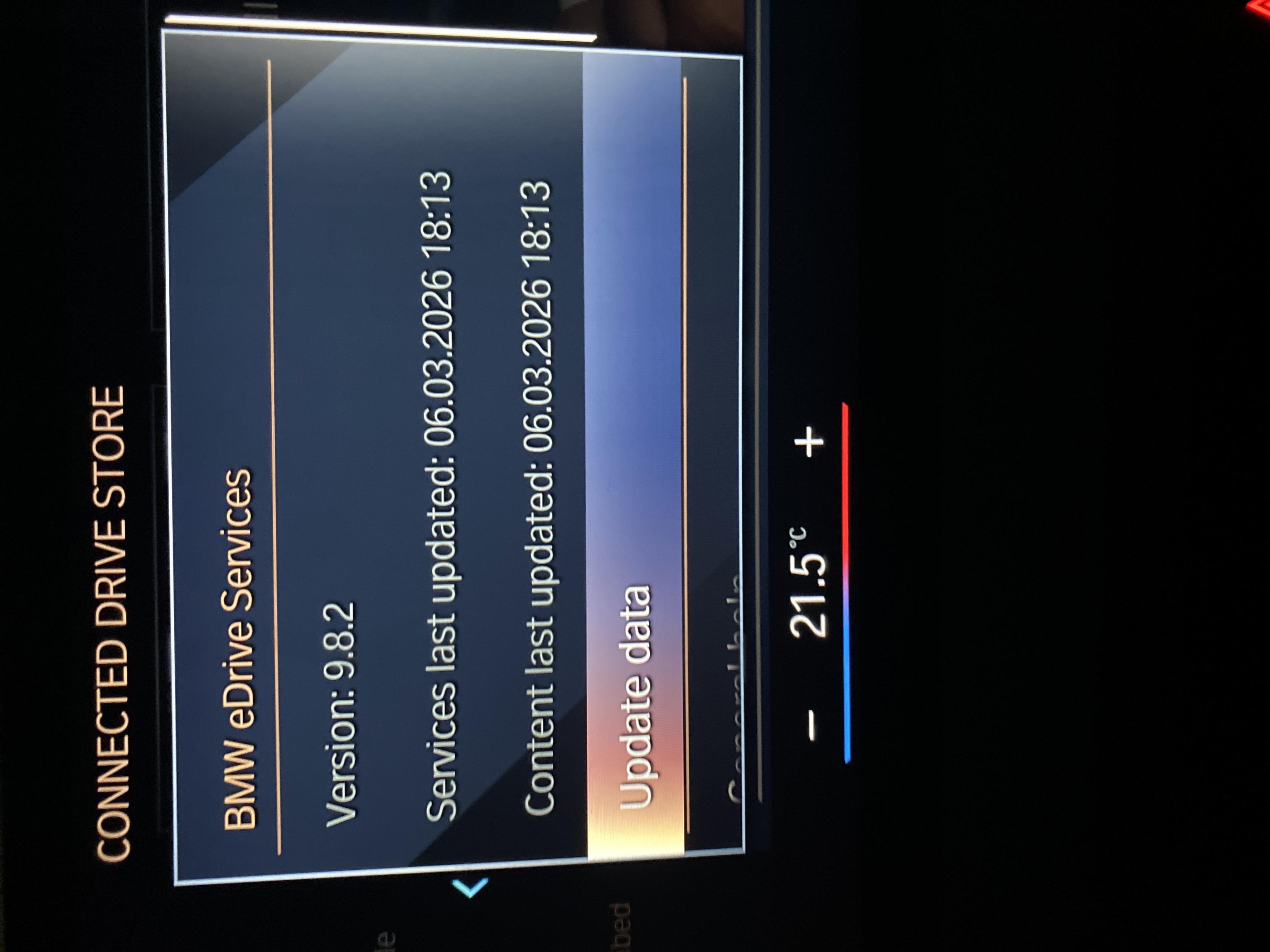

Once you have your BMW profile loaded to the car (in a region with connection), then all CD features work with no internet connectivity. I think wireless CarPlay is also one of the CD apps aka “Smartphone Integration”, video recorder, Digital Key plus etc are also pard of the CD apps list. So they do work while offline but until you logout. I accidentally removed digital Key from my phone and couldn’t re-add it for months until I went to Italy. This summer I am planning to check what’s the deal with Greece as it’s quite nearby, but I kind of doubt. I think it was A1 the only IOT roaming provider BMW had a roaming contract with on the Balkans, and once they “fixed it” eSIM profile just can’t connect to another one. Eventually if there is another they can push a new sim profile, but they wouldn’t bother. I doubt it will work in Turkey, and a guy from Azerbaijan also had his car disconnected at the same date- 2025.07.23 So I tend to believe BMW just decided to cut their roaming costs the “screw your customers” way in just some countries or for some service providers. Probably they could have blocked it only for some high traffic apps like Spotify, or enabled external SIM dongle, but why bother when they can own the software of the hardware we bought from them.
Attaching pics that showed where and when I was able to get connection and that CarPlay shows as part of the CD apps
