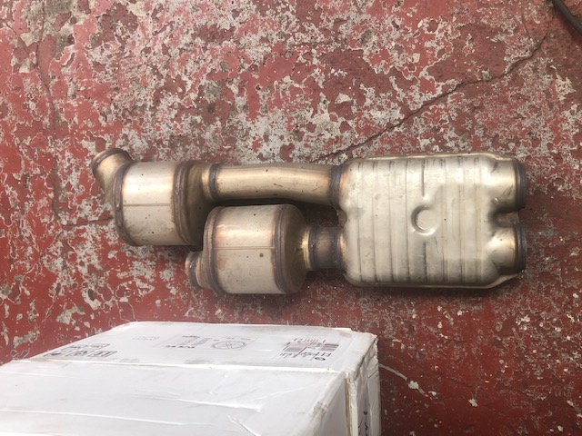

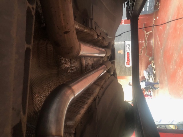

So the secondary cats and resonator have been removed. The beast has awoken, so pleased i didn't go the downpipe replacement route first because the sound is just right and ive got pops and bangs to go with it.
Three hour job in total to drop the exhaust to weld the tops of straights.
As you can see, in the EU we have secondary cats just in front of the resonator. I stall have the OPF's and cats on the downpipe so i hope it wont fail emissions or locate a friendly tester :)

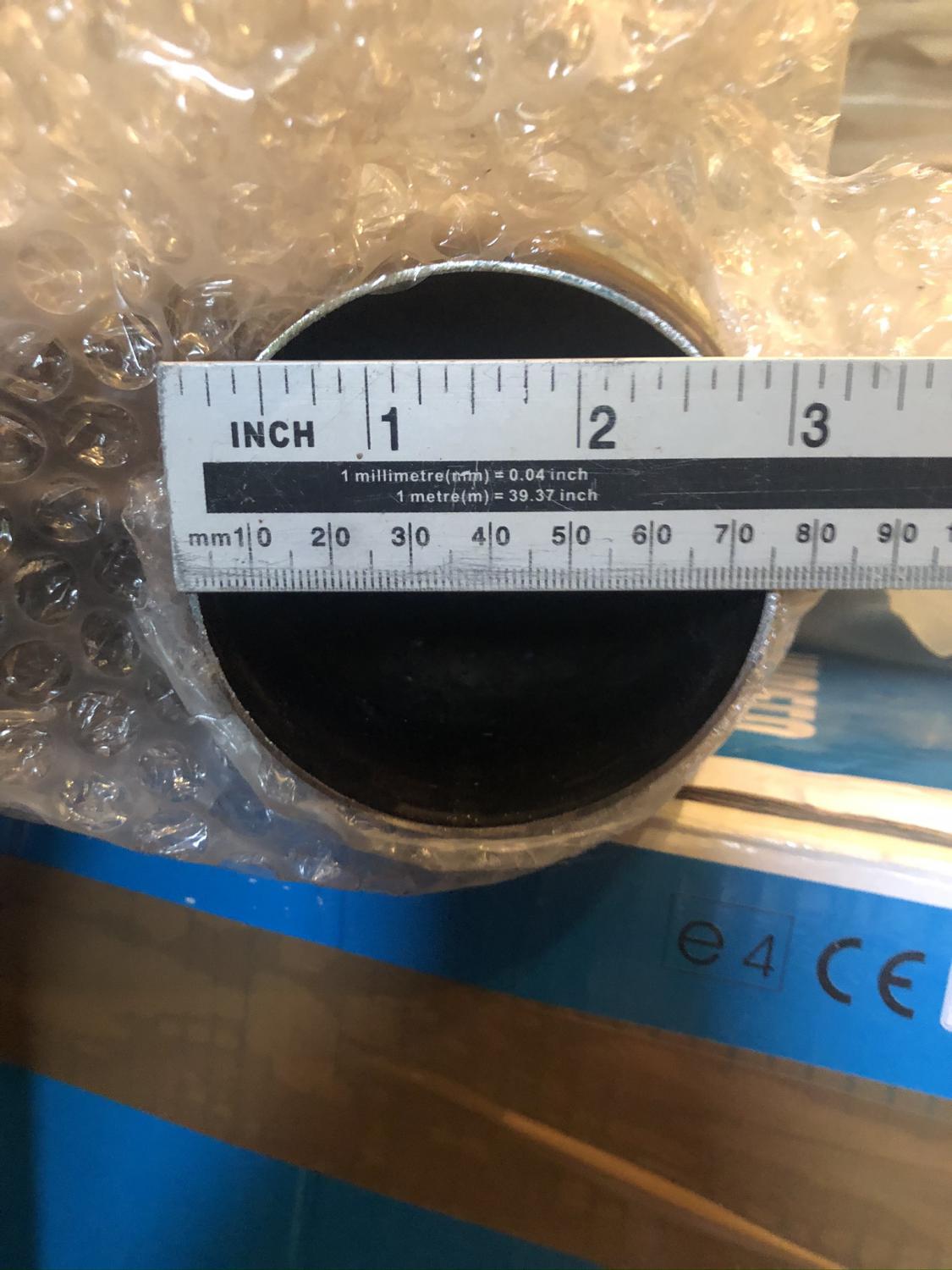

Careful the UK tube isn’t a different OD like the exhaust tips are

Took Torquflow 3 hrs start to finish, they did 90% of the work with the system in place and dropped the exhaust down just enough for the weld around the top of the pipes
