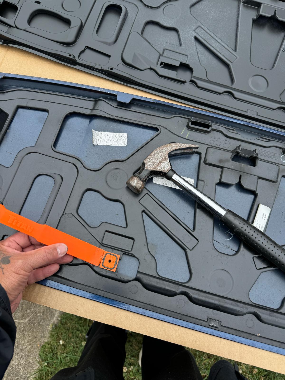

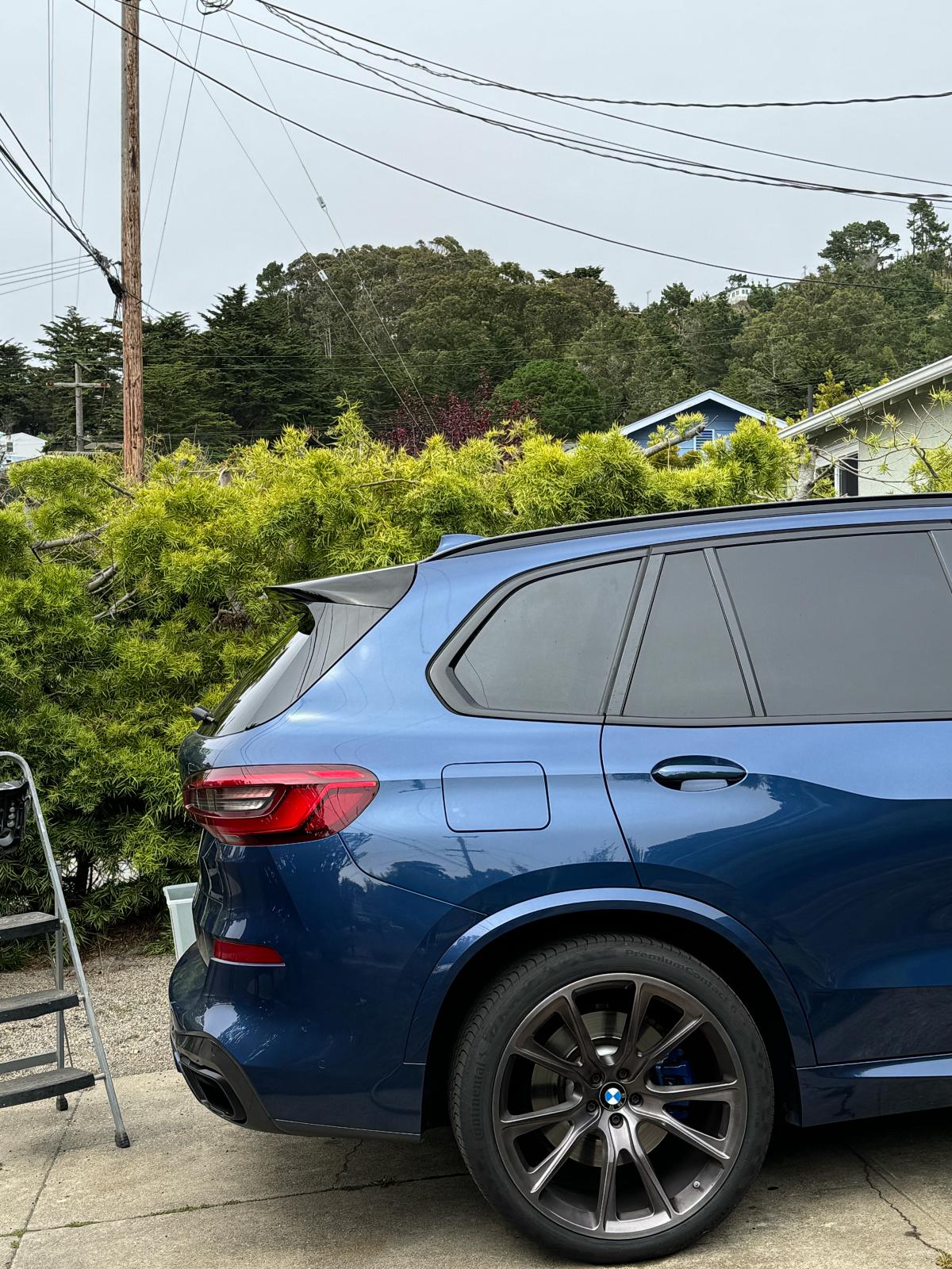

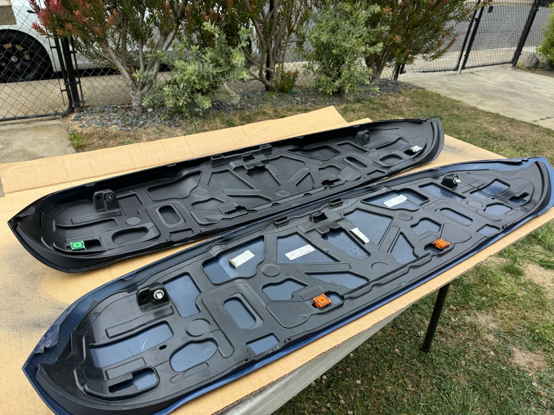

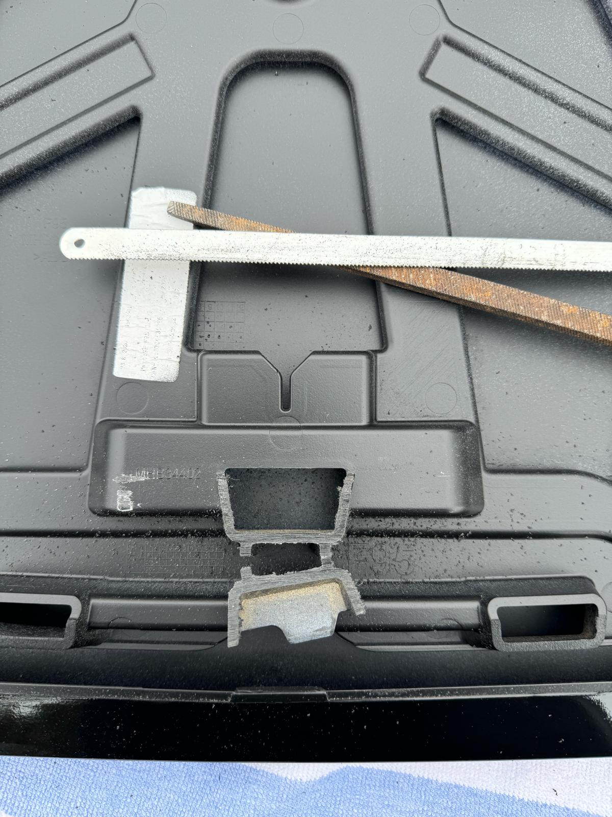

Just finished mine. Def the hint of cutting off clip made it easier. Approx about 30 min. to do.

Looks great! I see you went with black. Can you post a few more pics?

Thanks for all of your help with the post. I can see how you’d pull of and on if the middle clip was still on.
Yes I went the black route. I felt a bit douche with the color match pythonic blue.
Splitter will also be black. I will update the post when I clean it. It’s been so dirty.

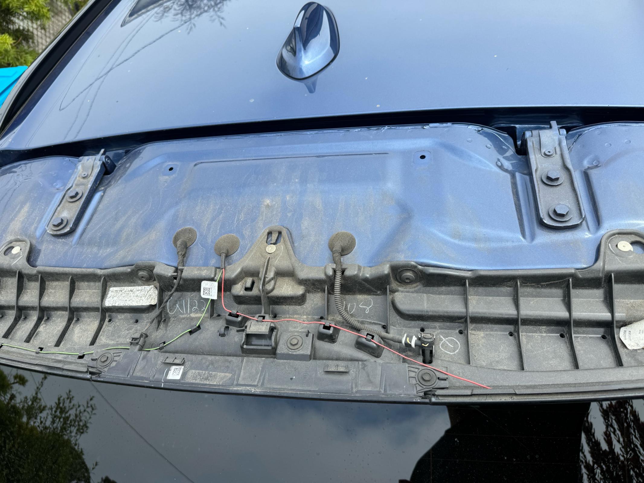

So the video posted is the correct process? I thought we don’t remove some panels from inside? Anyone have updated steps for this?
01-11-2025
Just did mine. It’s simple. Open the hatch > remove the 4 rubber gaskets > remove the the 4 screws > slide off.

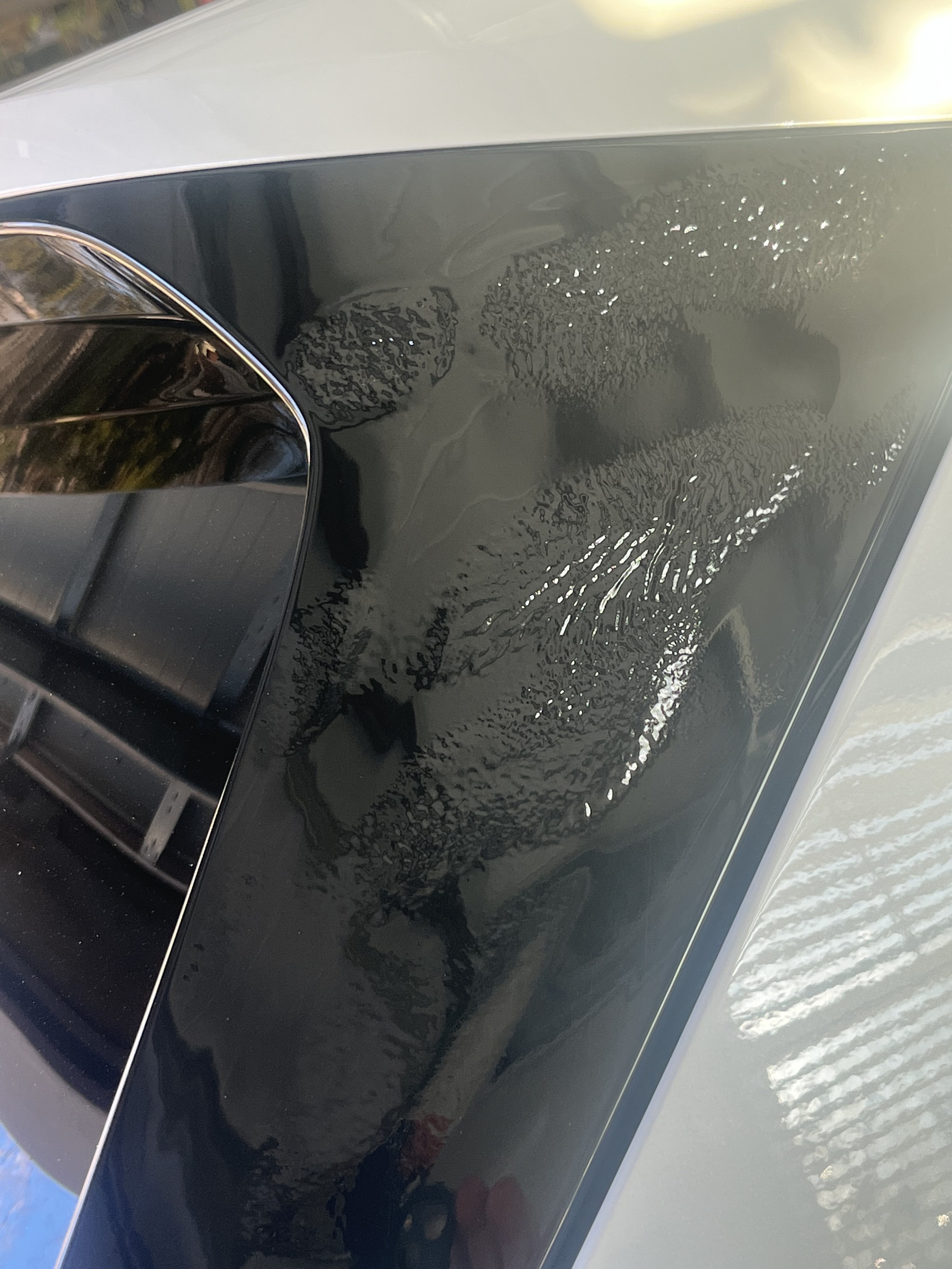

What is the black peice under the spoiler called. I have some bubbling in mine
Hmm, not sure.
Roof spoiler side trim?
01-29-2025
This one
01-29-2025
Still trying to figure out what the hell happened, I bought it a week ago and that was definitely not there. Noticed it today while washing it
01-29-2025
Looks like it has been repainted.
I would try to get the selling dealer to fix or replace it.
01-29-2025
Yeah I’m pushing them now. I’m curious what that part is called so I can see what replacing it would look like if needed
