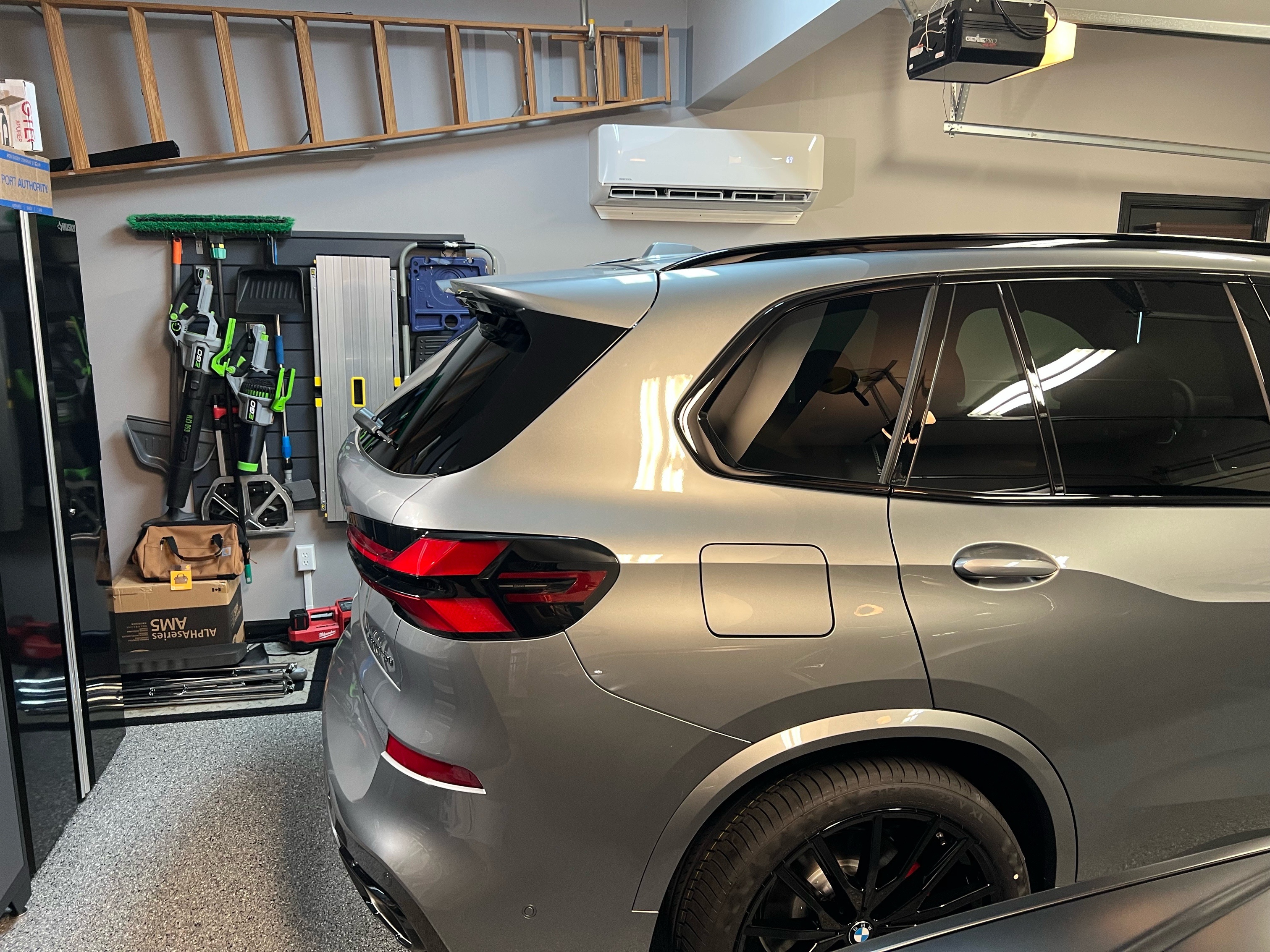

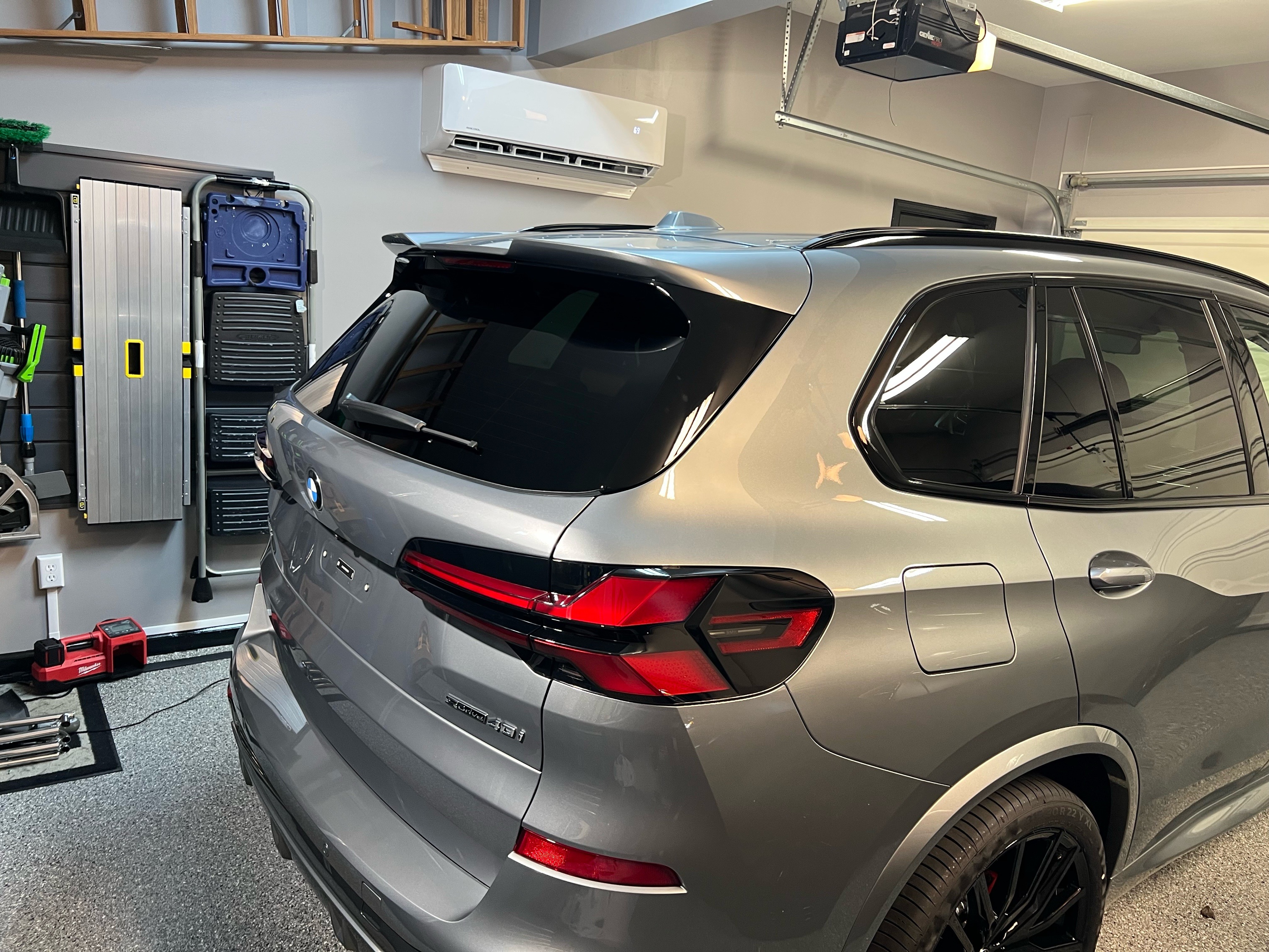

Wasn't too bad to install. I did cut off that little fastening point. I did not test fit it before I cut it I just went ahead and did it based on all the input. The gap betweeen the 3rd light looks to be about the same as on the X5MC.
Looks amazing. I have the same color, where did you purchase the spoiler and get it painted?
06-25-2025
I got the spoiler directly from a dealer and then had a body shop paint it.

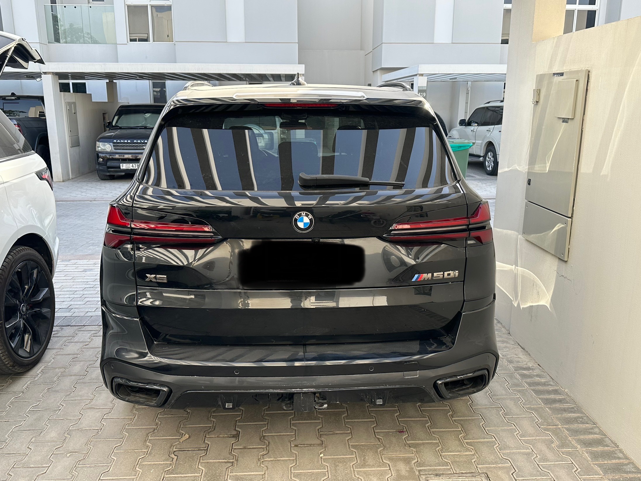

Royal1262 wrote
Thanks for the help! Wasn't a perfect fit as others have stated but I can live with it. Love the look of my X5 45e now with it installed. I think it compliments the aggressive sporty look I was after well.
