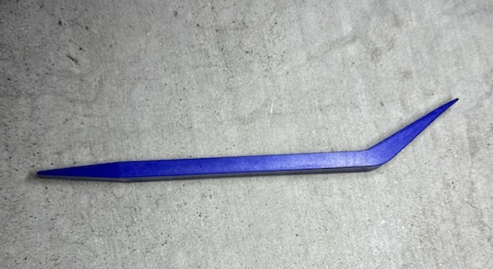

Tools used:
Flashlight (because it was getting dark)

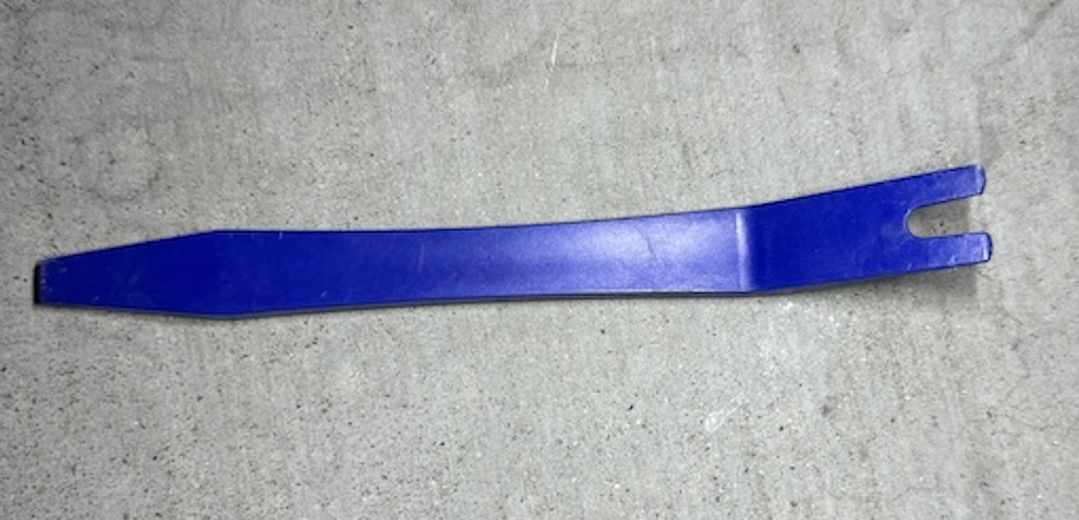

Pry tool (pictured)

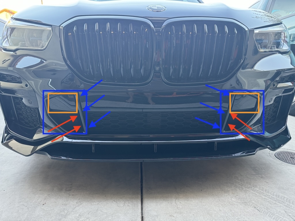

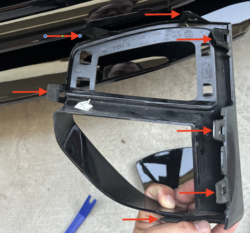

1. Start by using the pry tool to remove the corner pieces. You can start in the corners marked by the blue arrows and pull from the inner depicted by the red arrows. You will want to pull at an angle to release the tabs. The first time is probably the hardest.
The Driver side inner piece comes out completely (Orange box). The Passenger side is a bit trickier and I didn't remove (both not needed to remove tbh). The Passenger side has a piece of plastic that looks like an arrow that keeps it attached to the bumper assuming because that is where the tow hitch hole is. It comes out, just takes a little more work but you don't need to fully remove it.
2. Here is the inside view of the corner trim piece. The three tabs on the right side of the picture are the three tabs you see on the prior picture that you should pry off first.
*edit. Another user said it’s easier starting at the bottom opposite corners that I had marked, moving counter-clockwise

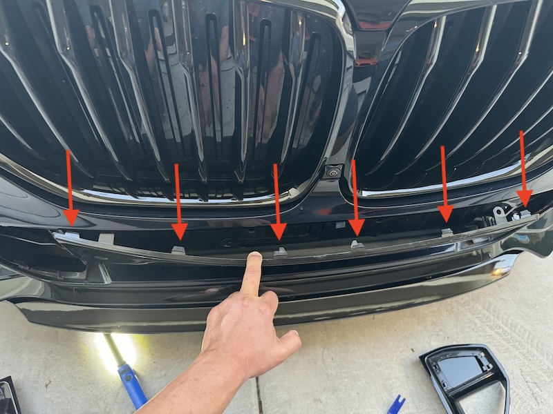

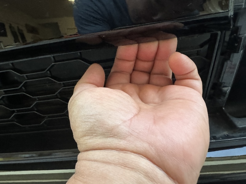

3. Pull from the bottom on black trim piece

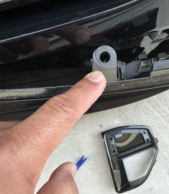

* You can see that the tab with round hole is just a locator. Nothing is fastened there

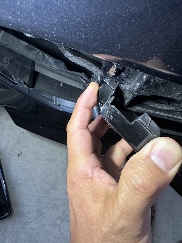

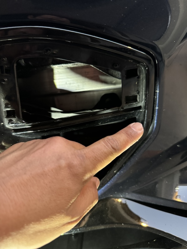

And the last (Passenger side) clip/retention tab is a bit tricky

With the black license plate trim removed, you will see both of your sensors. There are TWO retention clips on the black trim that you will spread out to release the sensors. If you lose the black rubber gasket, just put it back on. The flat side goes against the sensor base and the grooved piece faces you.

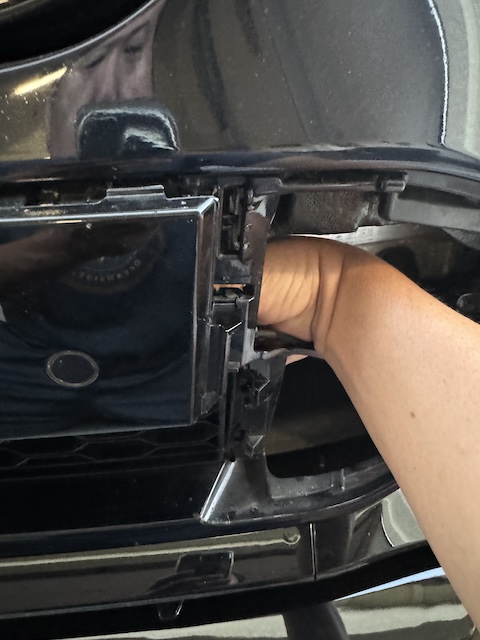

7. Using your hand, reach behind the black trim piece and snap the sensors back into place.

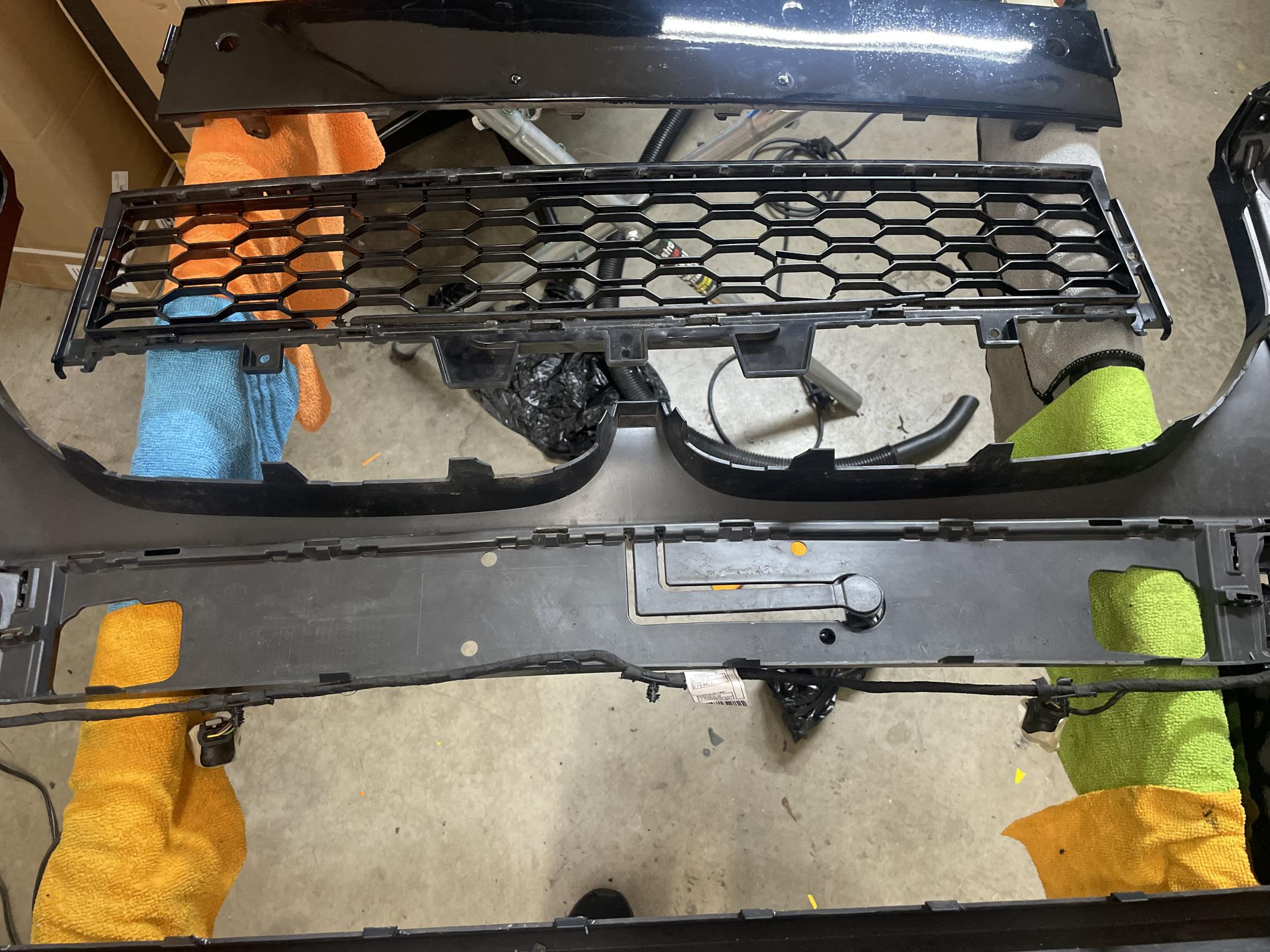

You should hear or feel two clicks but I just press in on the sensor and if it is loose or pops out a bit, I know it wasn't captured on both clips.

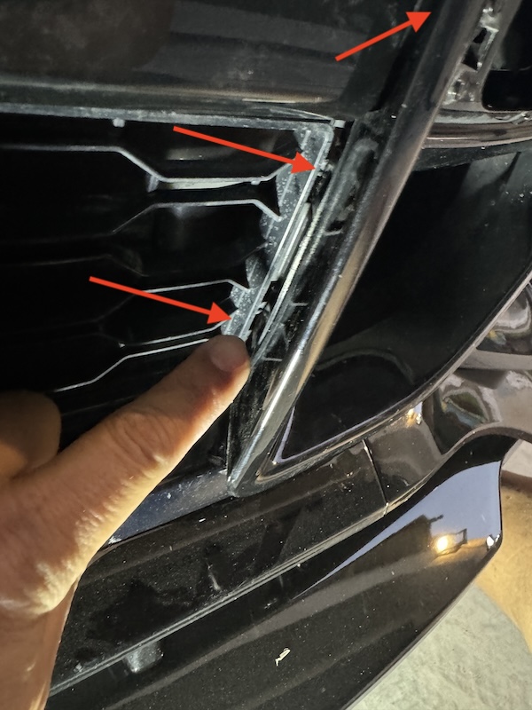

8. Install the side trim pieces. Start with the furthest side outwards, first. The inner tabs may need to be bent outwards to be engaged into the slots or the trim piece will jut outwards. If that happens, just yank and start over.
And that should be it!
