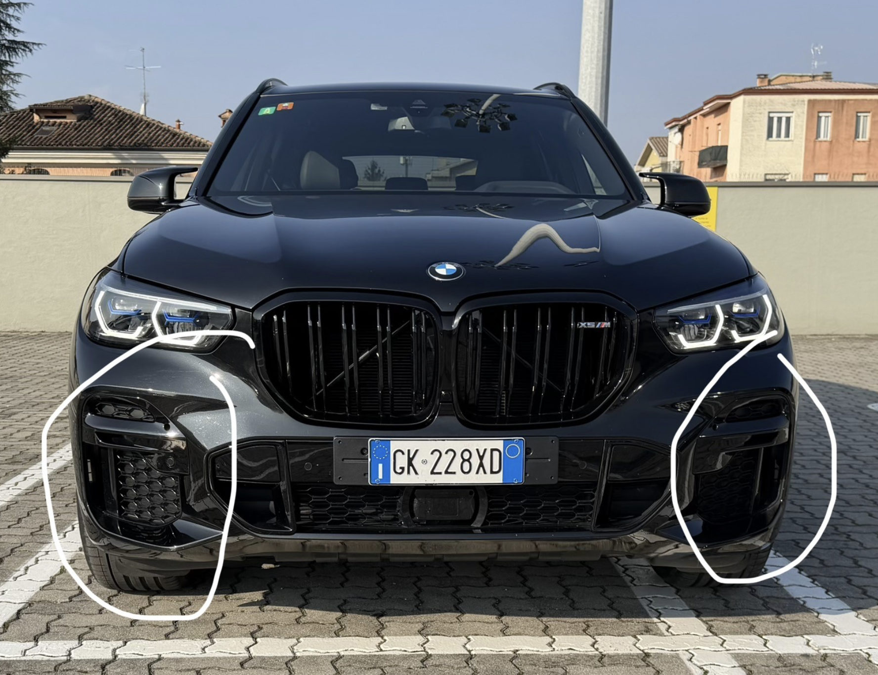

Good morning,
Have any of you tried removing these two side panels to remove the plastic piece holding them in place? I'd be interested to know if it's necessary to remove the bumper entirely or if you can simply unhook the clips and slide them off.An image attached to this post, provided by the poster

I removed my bumper to swap those out but I think if you yank hard enough they do come out because the clips are facing that direction. I could be wrong so don’t pull off your front bumper by yanking lol.
Maybe someone else can chime in. I need to pull my bumper off to swap my DRL but that won’t be for a while

Id also like to know how to remove this trim. I have two fresh gloss black trims to install sitting in the box.
