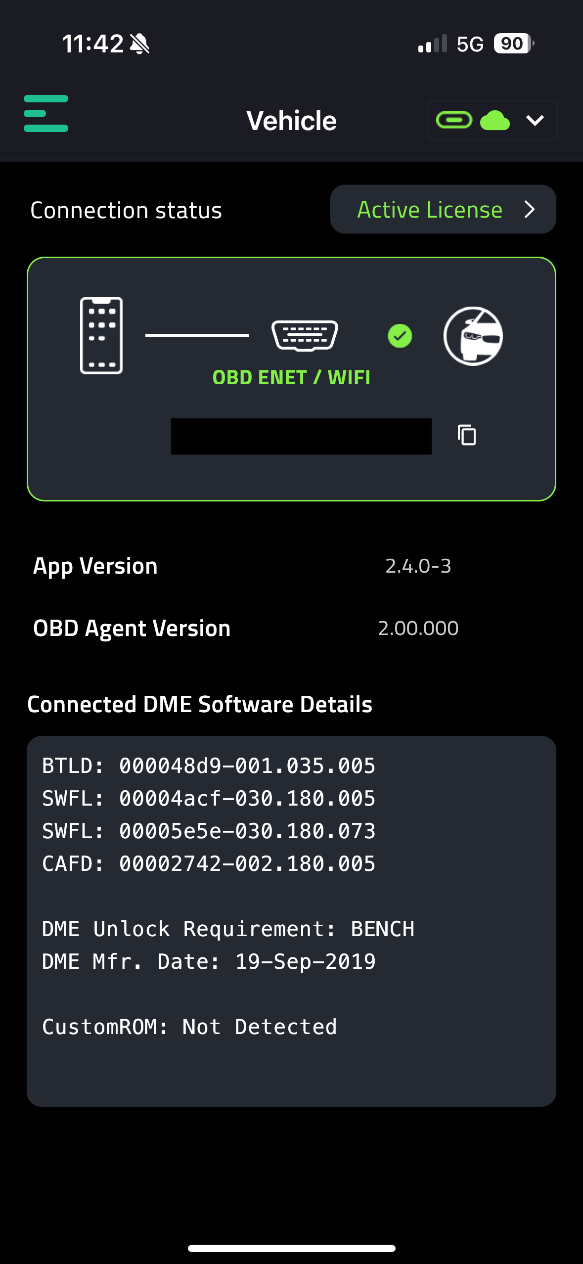

Technically all DME's are locked. The ones before 06/2020 production can be bench unlocked. If you have a 2021 model year, your DME is 100% going to need a Femto unlock for tuning. There were features added to the 2021 model year that required the new DME such as phone as a key.

ISTA is certainly one way to determine the exact date. You can also find out if you download the Bootmod3 app and connect to your car. You don't need a license to read the current versions.

Thank you. I had downloaded MHD on my iPhone intending to check using the check unlock status feature, but then realized I’d need an adapter that I didn’t have (my bluetooth adapters aren’t supported and I don’t have a lightning to Ethernet adapter). I decided to give up knowing mine would definitely require femto unlock. After seeing your post and looking at the BM3 instructions it’s nice to know I can do the same unlock check and use my laptop and ENET cable. Thanks again for the wealth of knowledge here.
