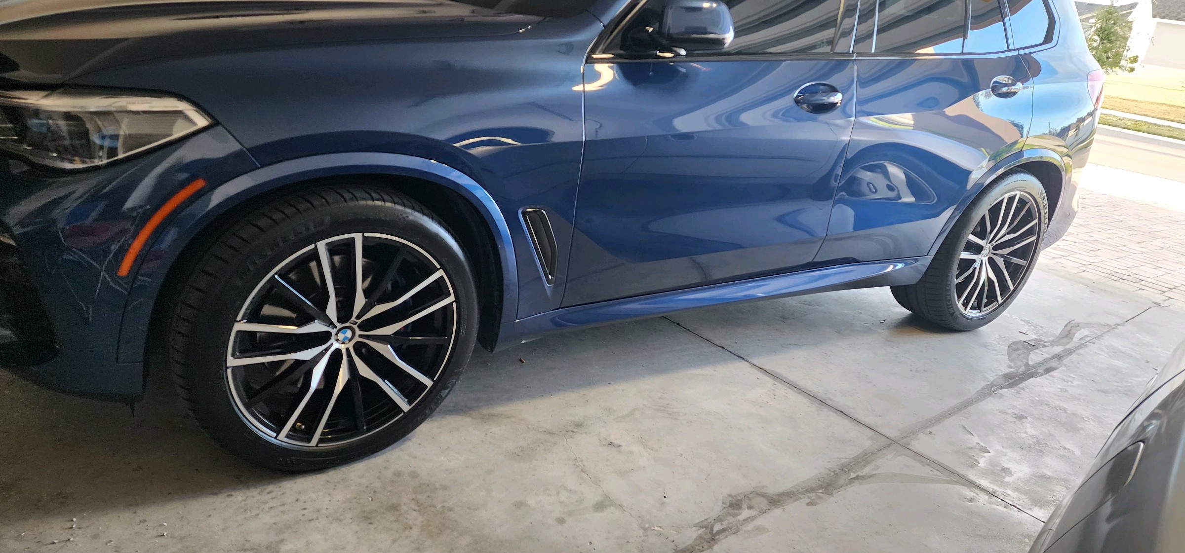

I swapped to taller tires (275/40R22 & 315/35R22) on stock OEM 742's a week ago. There is no issue fitting at all, no need for spacers.
06-20-2024
Conti's?
06-20-2024
Gladiator1972 wrote
Conti's?
Yes! DWS 06 Plus
Happy to post pics mounted if anyone is interested.
EDIT: Uploaded pics, look to page 2 of this thread.
