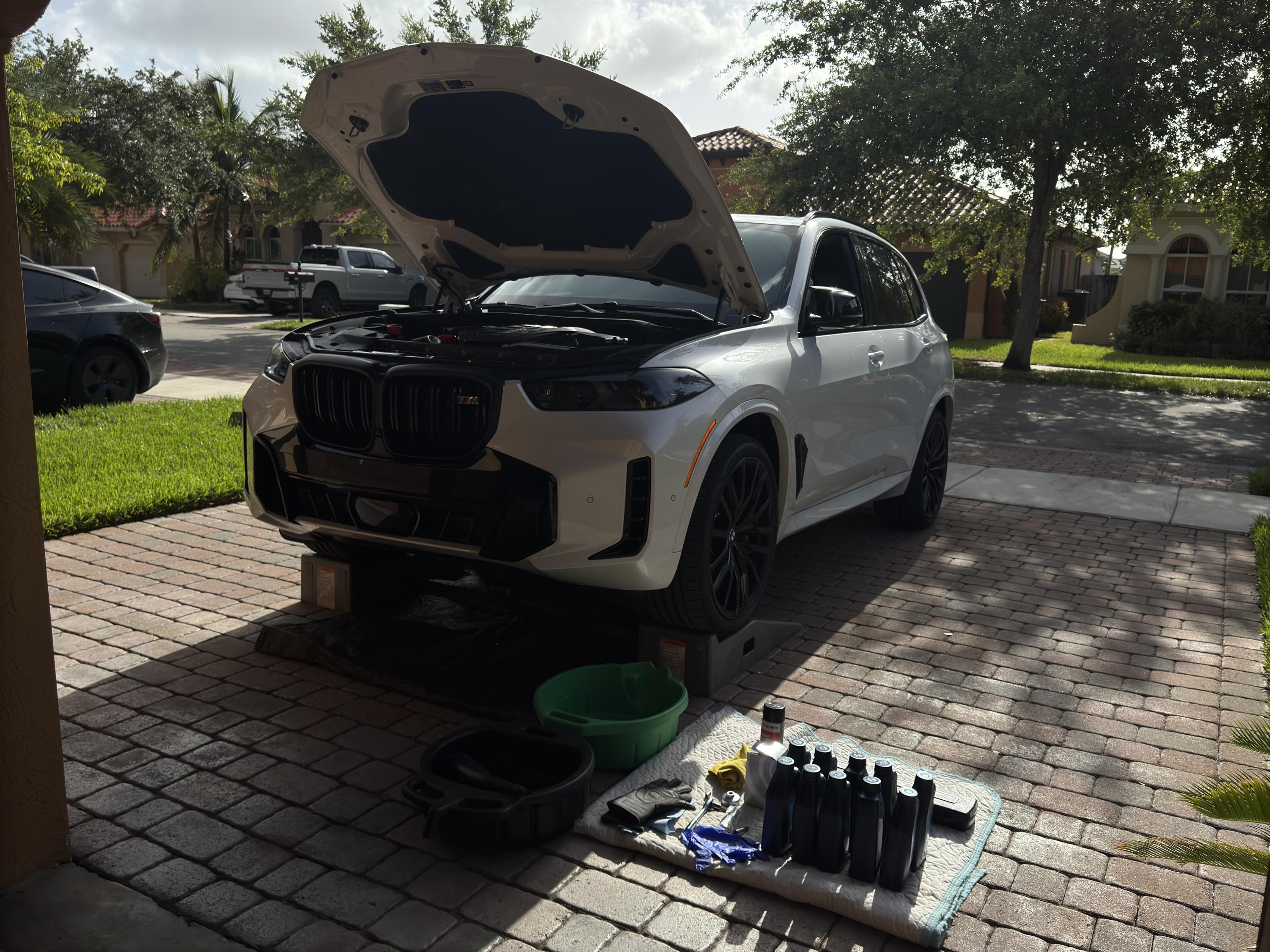

03-10-2026
Ramps will make your life easier
