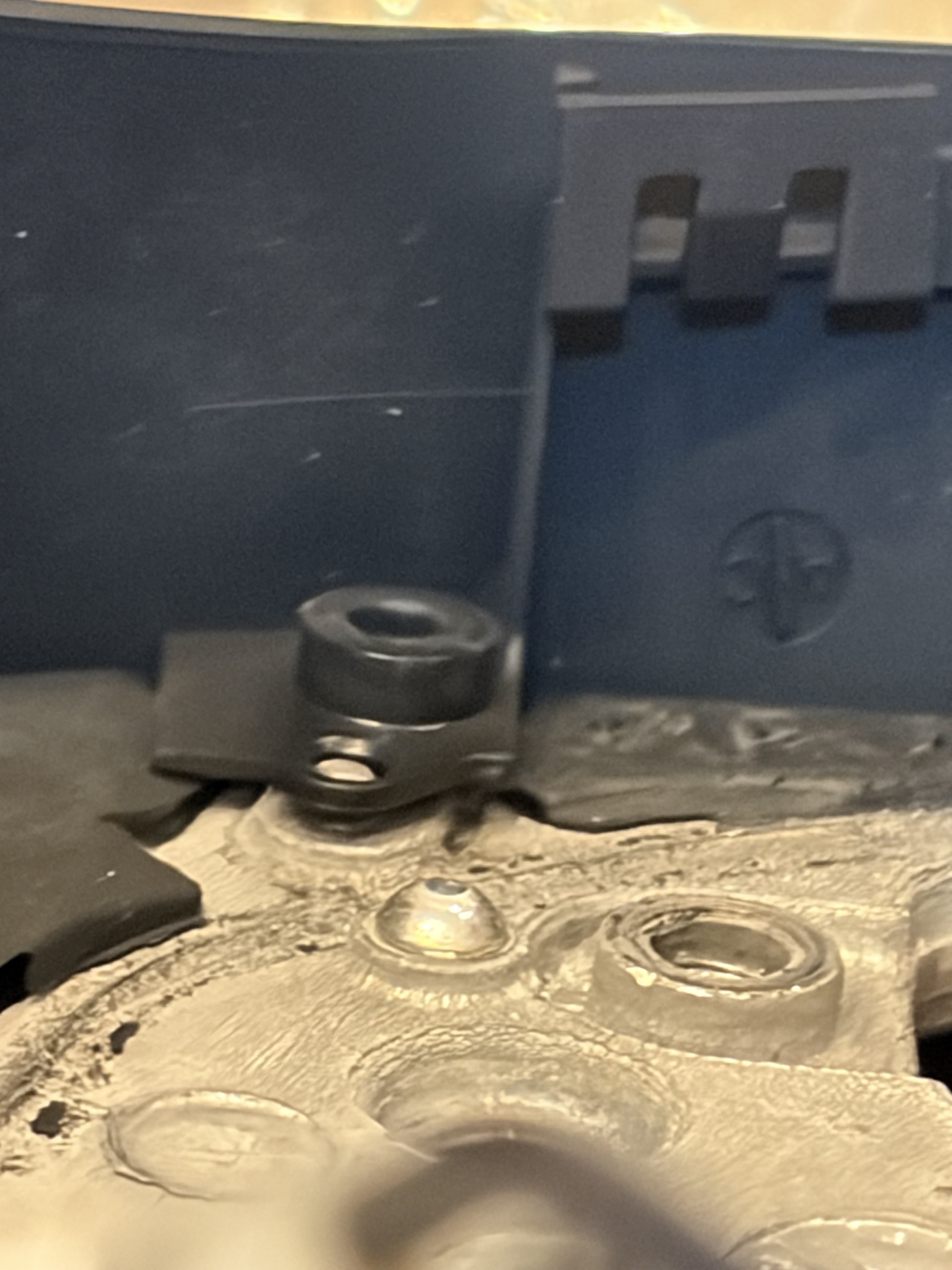

Reaching out hopefully for some help. I bought a flat bottom wheel from Alibaba and am having issues. Everything is complete and reinstalled. The airbag will not rock, therefore the horn will not work. Dug into this deeper and the horn plate will not rock. Any recommendations if the product is wrong or what I could have done wrong with the horn plate install?

I was able to confirm my horn plate will not work with what they shipped me. Possibly a different shoulder bolt with a deeper shoulder or a different horn plate would resolve my issue. I think the wheel they sent me does not have a notable offset between the thread face and the clicker face.
02-15-2026
Attached is photos showing the clicker height is much taller on the Ali wheel.

It seems some wheels and horn plates are not compatible to allow the horn plate to function Understood it’s an aftermarket wheel, however this design works for some customers. I think it’s possible the 3 series horn plate would function with the wheel I bought. I’m trying to return anyway to China.

The one you bought probably isn't right one for the suv. There's a ridiculous range in their description. I know for a fact people have bought this one and it takes all parts from OEM wheel into it plus the airbag. You can message them and alter whatever you want. The listing below is incorrect and it's actually a 14.5" wheel fyi.
