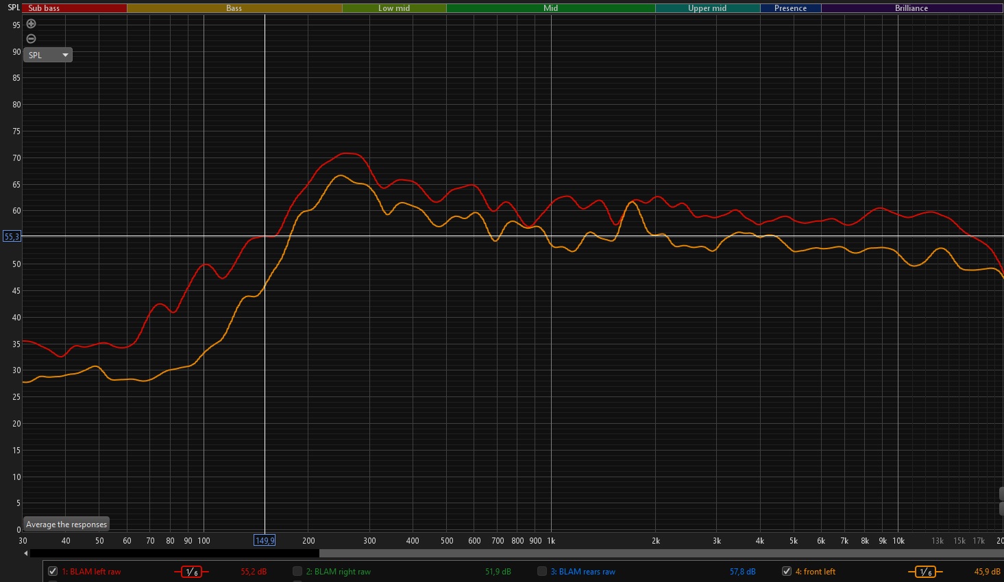

I got to idea to try different door speakers. Was looking at Helix Ci3 and BLAM Relax. Due to various reasons ended up with BLAM Relax BM100. I was surprised that even raw (with no EQs at all) their sound was pleasing. These play louder (+5..+8dB) compared to HiFi stock ones. In the region of 150Hz these are +10dB. Attached is raw frequency response of the driver side mid + tweeter compared to stock ones.

I was experimented with XO's and shelf filters a lot. Always ended up with my initial feeling for my ears: less EQ -> better, more natural sound. Mids and highs seems to be more forgiving in this contexts. Thus, I ended up with some gap at around 150-160Hz.
Were you still on the stock hifi previously? I'd imagine it's probably worth looking for mids that extend as far as possible given the constraints. The Focals are pretty good on that end as well. I don't have a raw measurement for you but the tech sheet shows them pretty flat down to 100hz.
https://media.focal-naim.com/dam/is-bmw-100l/ft_isbmw100l.pdf
03-04-2025
X5 with HK here.
Fronts and Rears were replaced with Focal IS 100Ls.
Here is the raw response for Focal IS 100Ls on my car, without any EQs.
Red is Front Left, blue line is the Rear Left response.
Look at the blue line (Front speaker).
The levels starts rising at 2k, which makes the Focals sound a bit bright.
But this is easy to fix in a DSP is easy. And then they will sound great.
