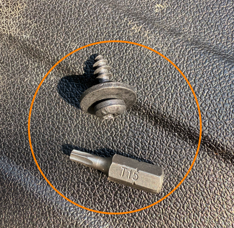

Tools needed:
- Flat head screwdriver
- TORX T15 screwdriver

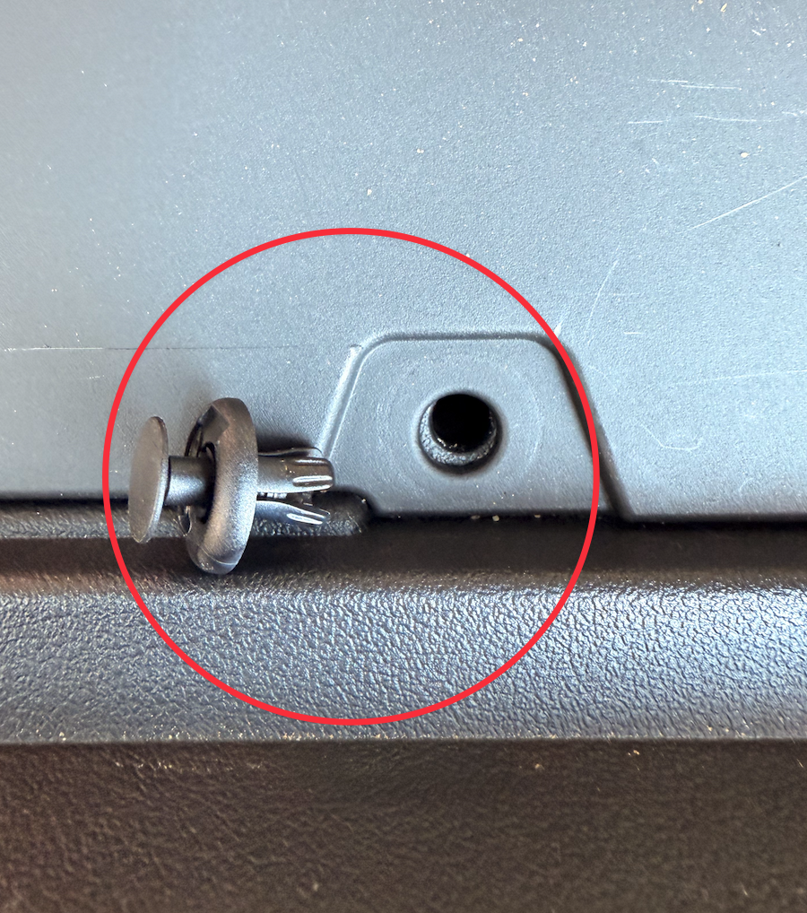

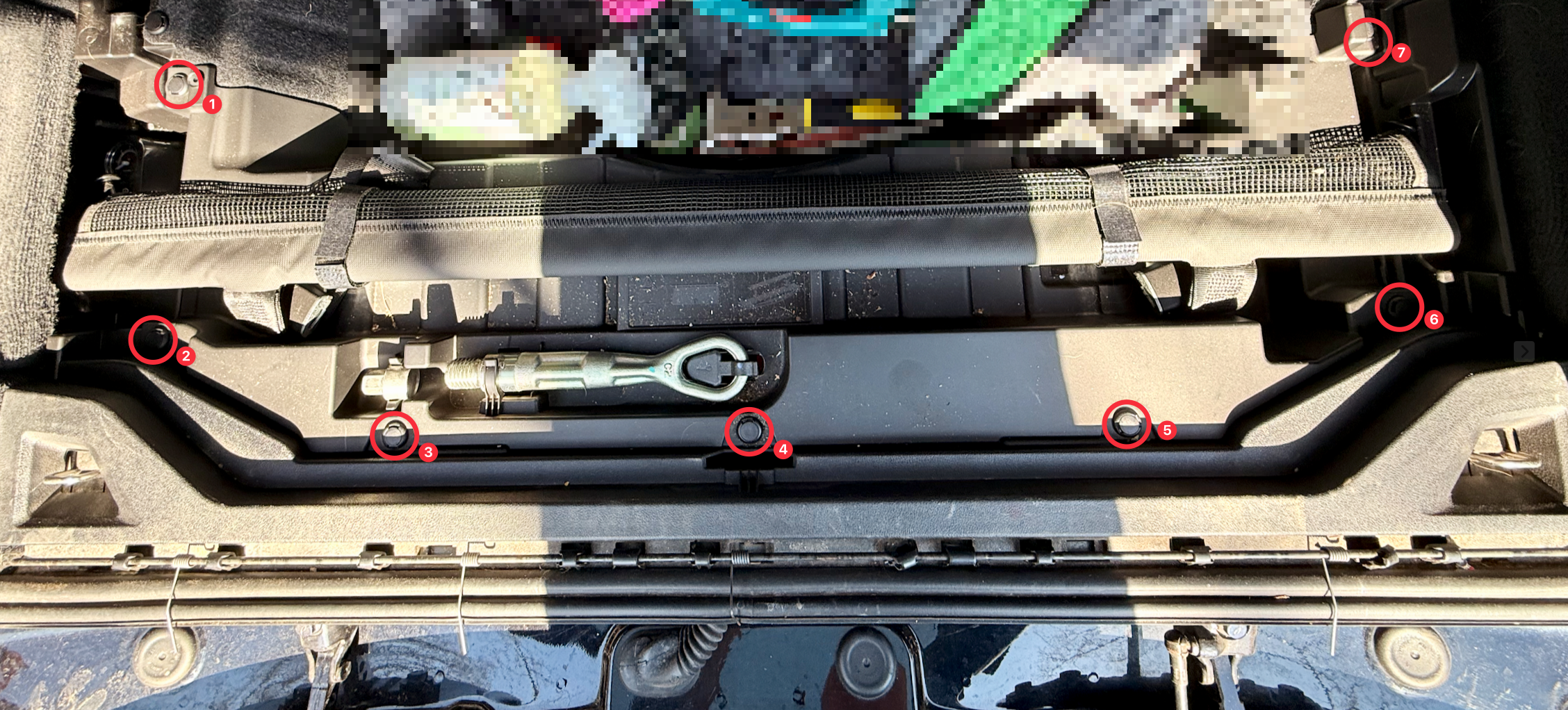

1. Pop out the Seven (7) plastic clips keeping the netting holder in place using a flat head screwdriver:

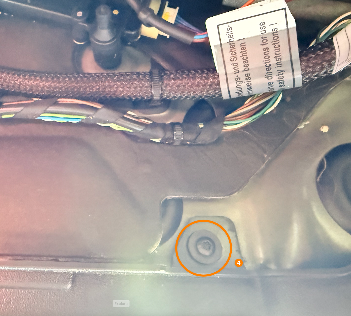

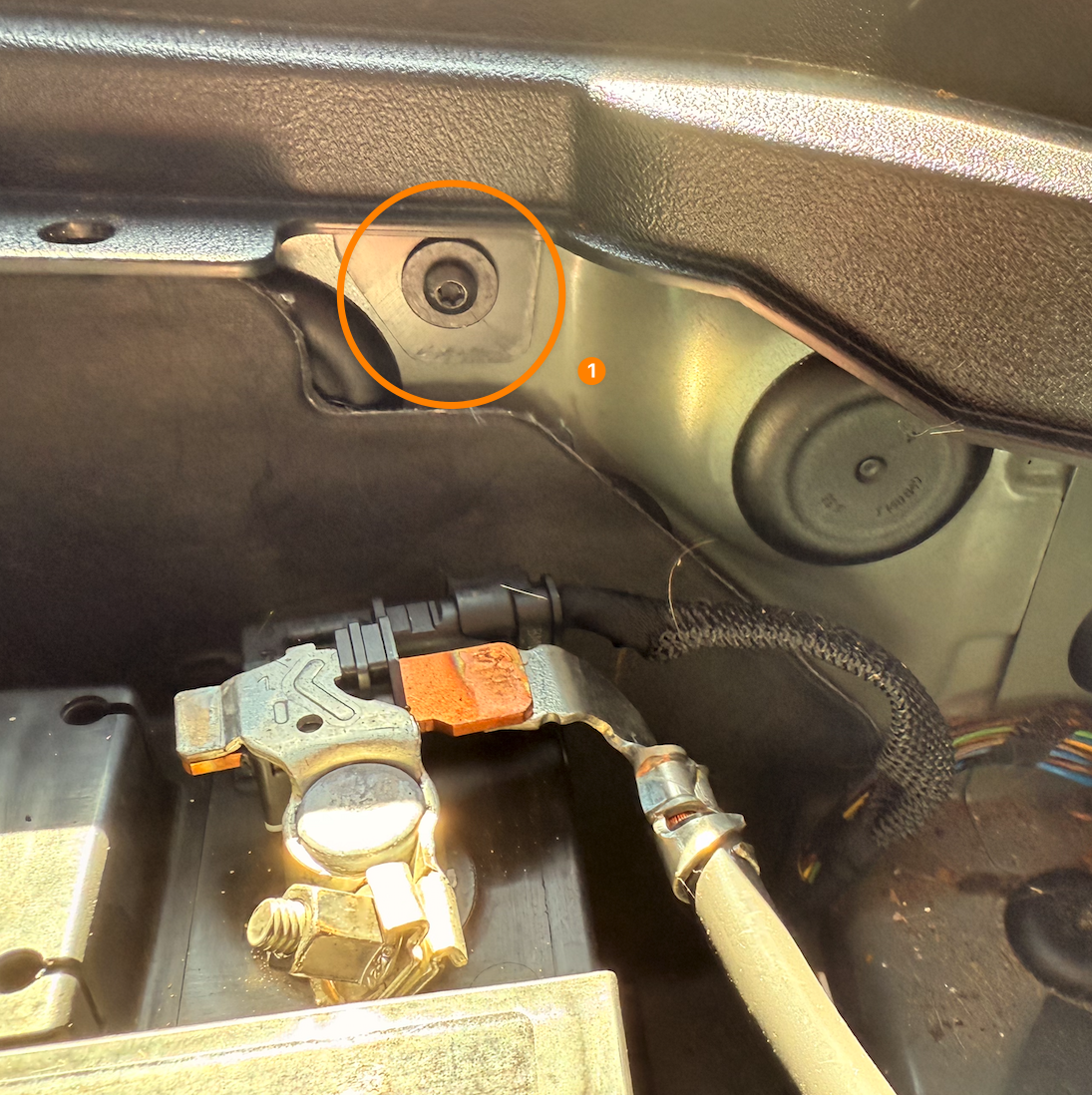

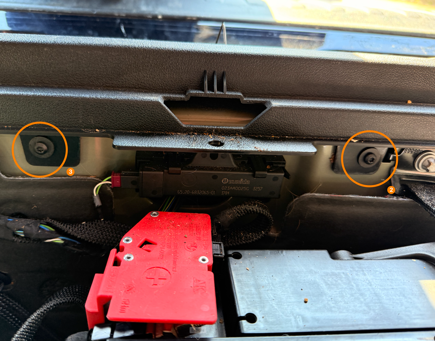

2. Remove the Four (4) T15 screws from the back side of the part

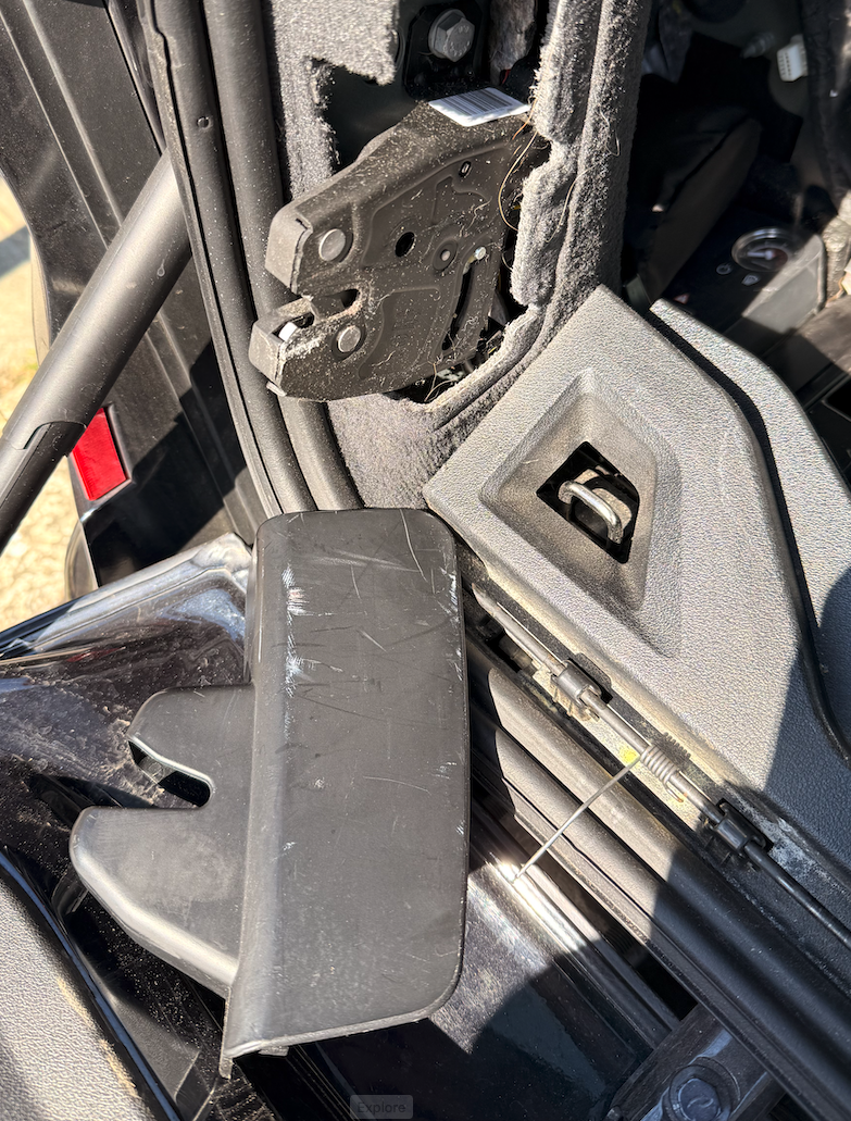

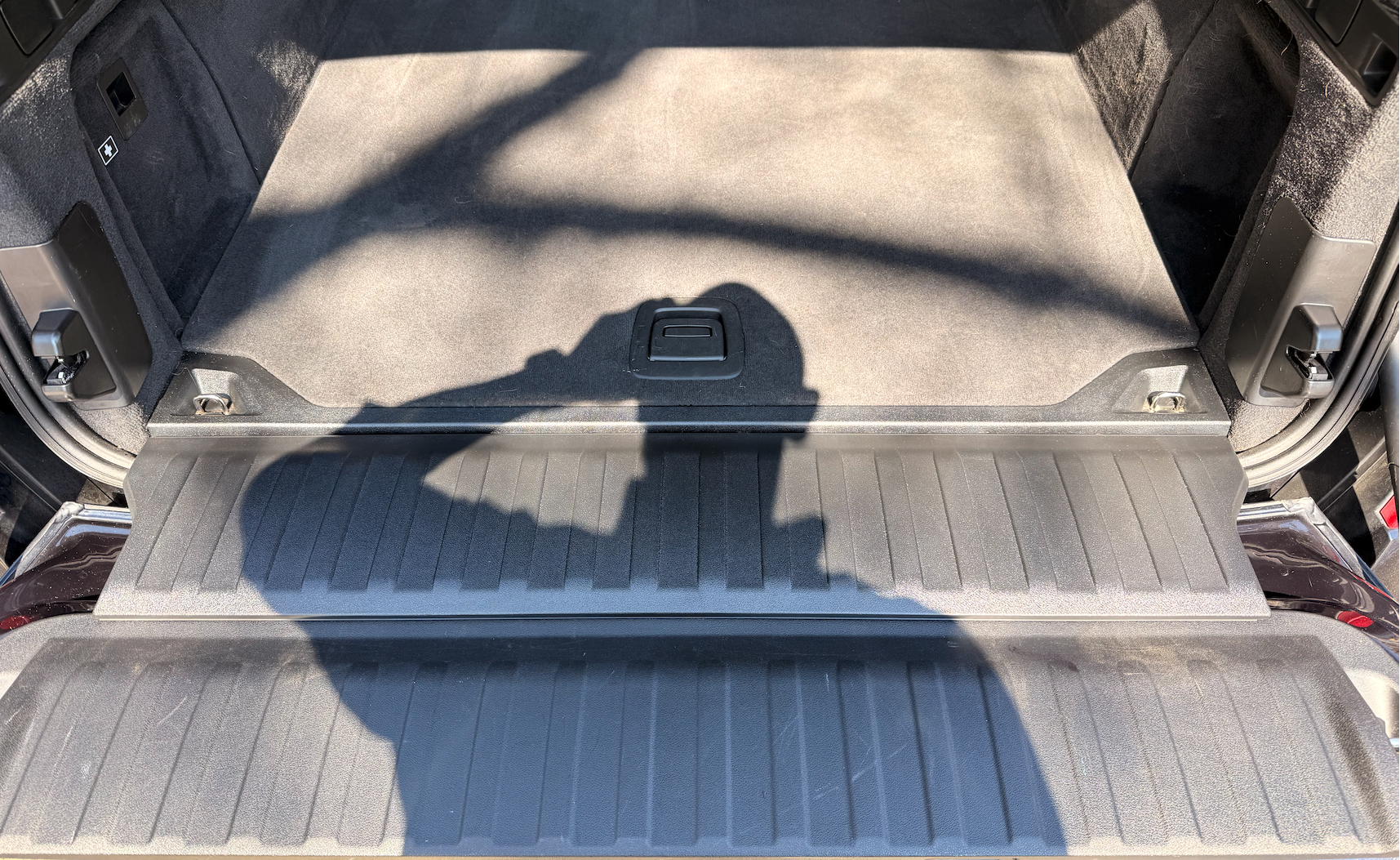

3. [Optional] I pulled off the covers to the bottom sill hooks to make it easier to remove the sill cover.

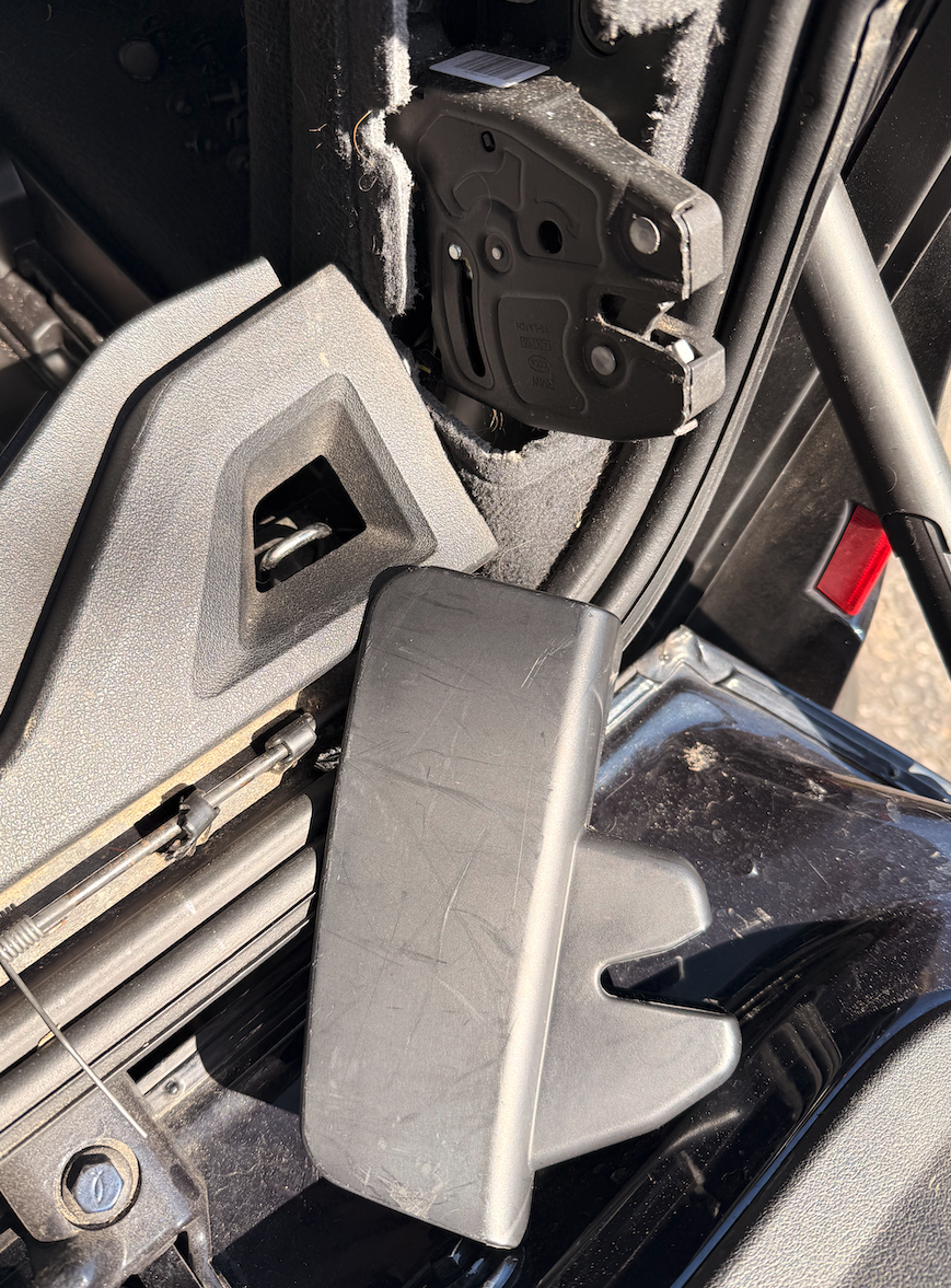

4. Thats basically it, the old one slides out (pull it towards the front of the car) and then put the new one back in and re attached all the fasteners. Only gotcha for me was that I failed to hook in the metal springs into their holders on the new part the first time, but luckily I had tested the boot opening/closing before I screwed everything back in.
Voila, like new!:
