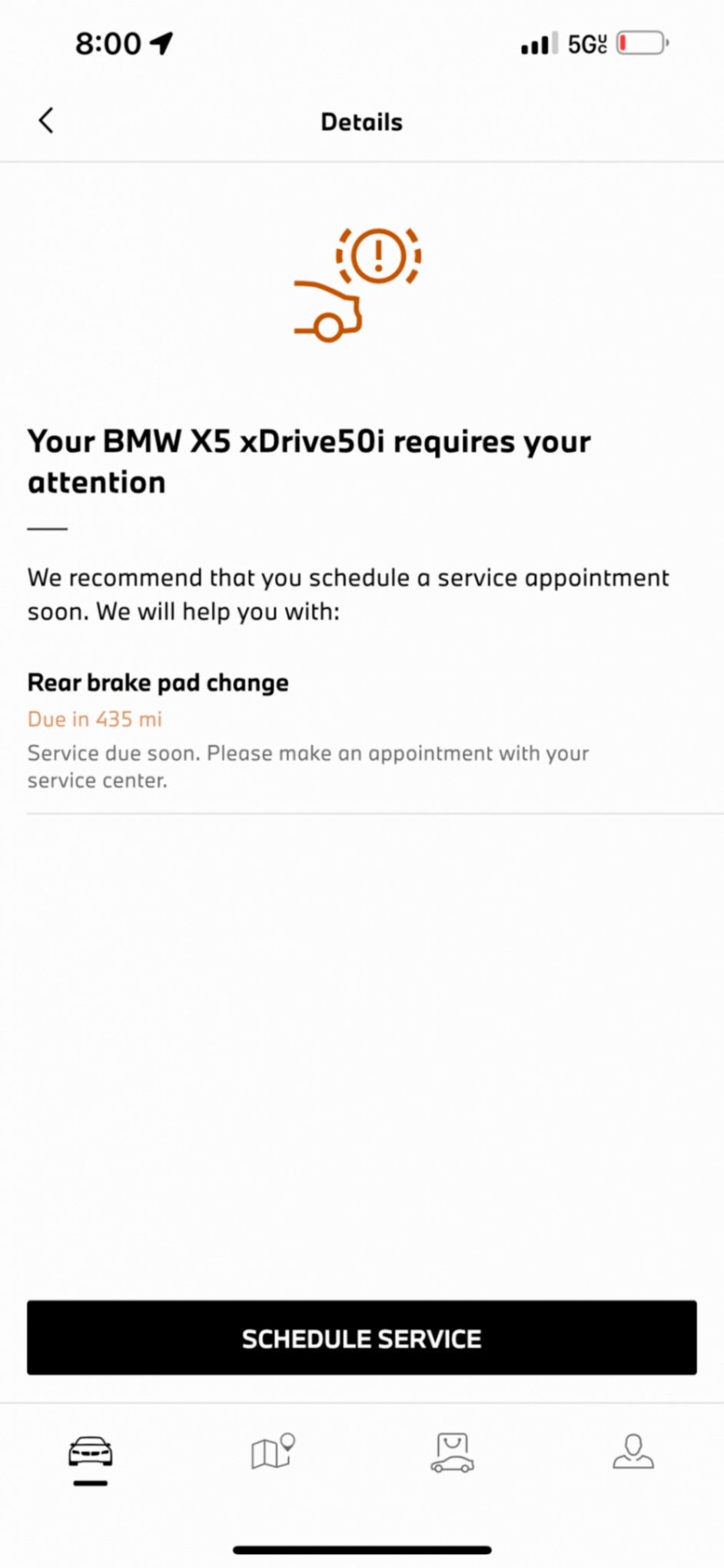

A neighbor took a look, He showed me the rotor and explained A few few things I didn’t know.. but I did have a notification go on that. I have 900 miles left on the rear break. He looked at all four and said I need to change the brakes on the rotors

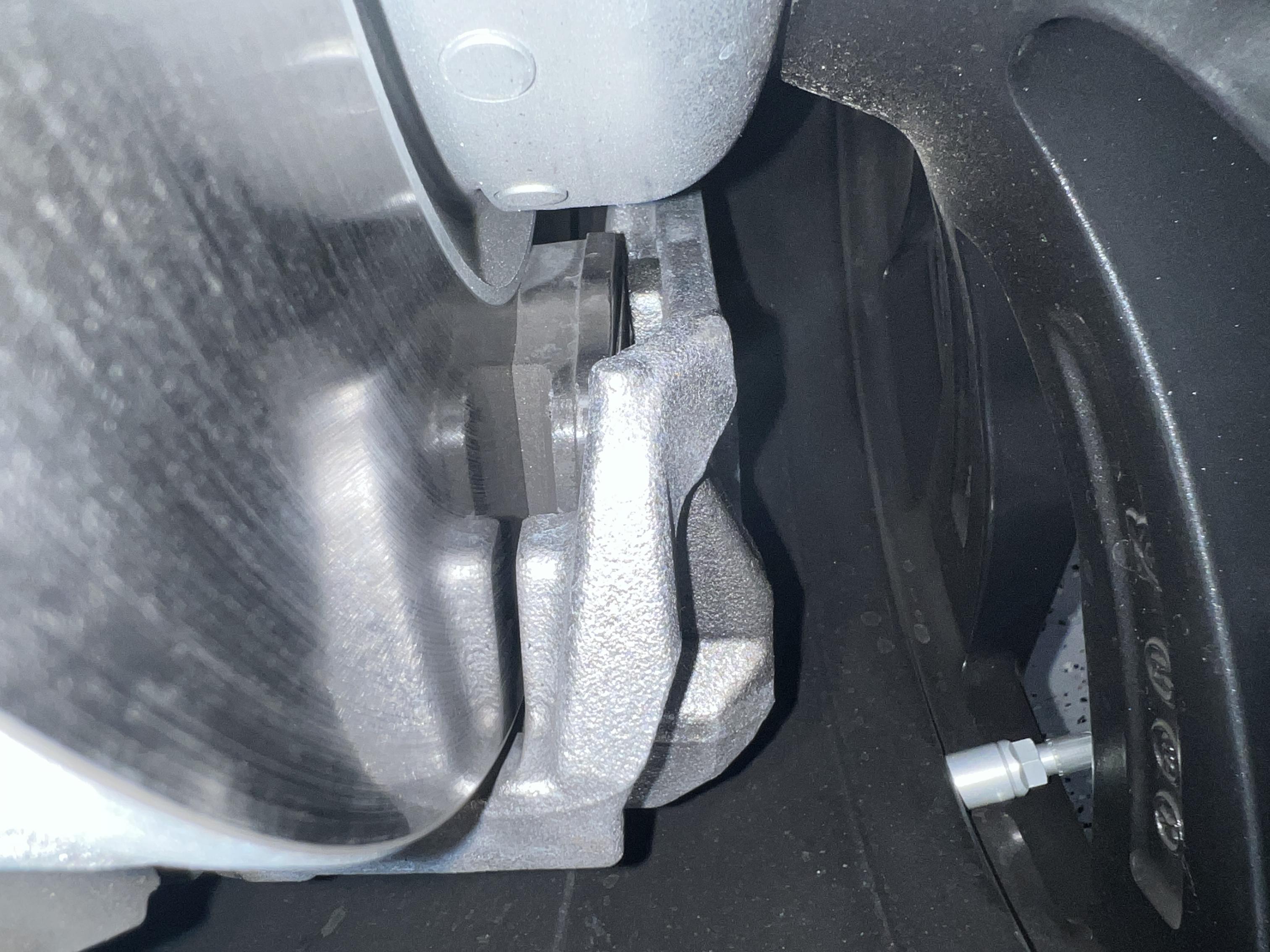

mikegot5 wrote
I mean, he told me that I need to change all four brakes and rotors
From this picture we cannot tell pad wear. Can you post a picture like this, where we can see the pad thickness?

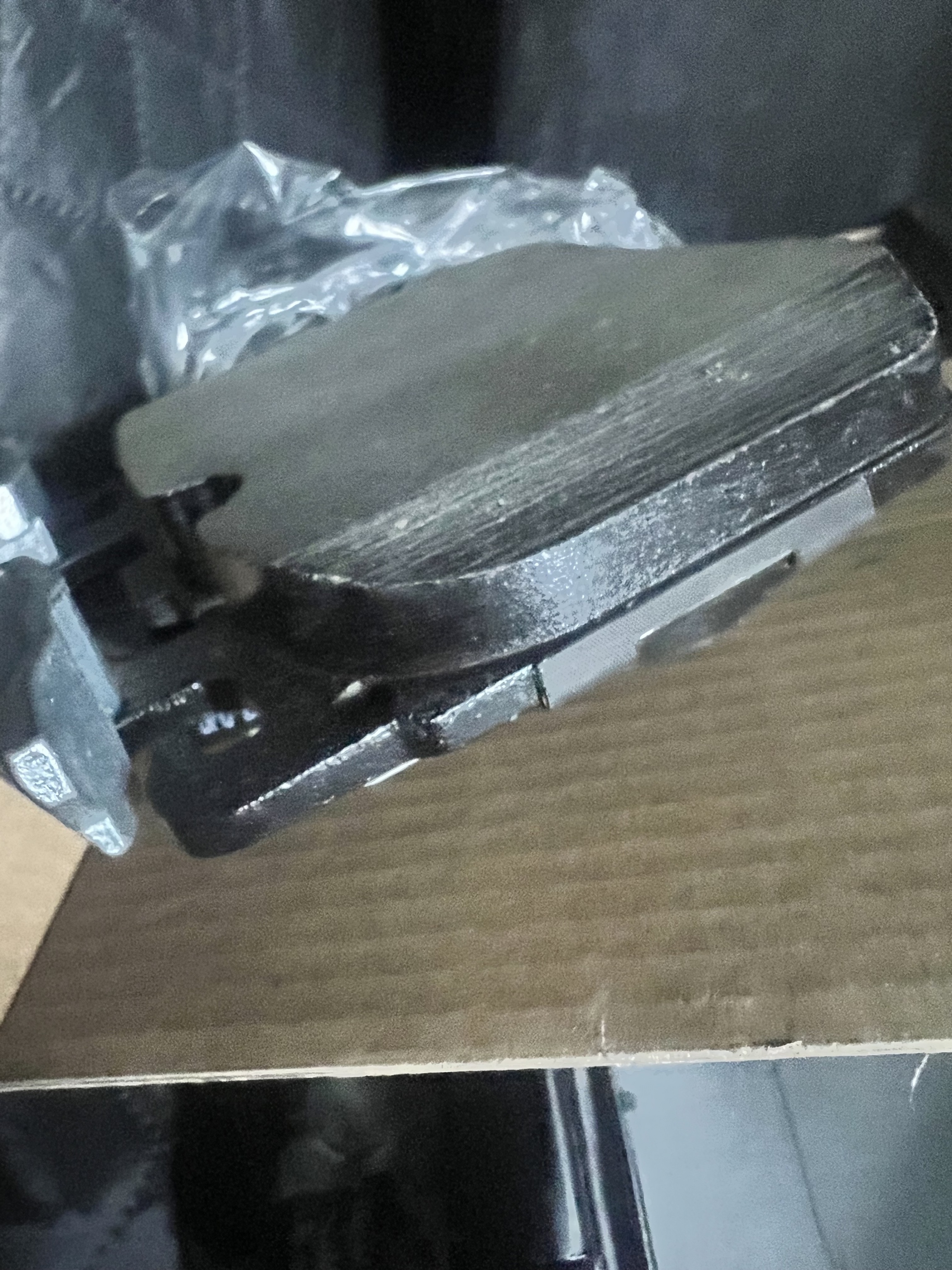

Back brake pad,, It’s raining like crazy so I couldn’t get a chance to take a better pic
09-06-2025
The backplate is about 5mm thick. my guess is your brake pad is about 4mm now. Brake sensor will be trip at about 2mm. So your is close but not there yet. It is good to start looking for options early tho. For reference, my picture above is when brake pad is brand new.
900 is just an estimate. It can quickly go to 0. You probably have a week or two.
My son’s car said 1800 and within a week was at 300. When I replaced them they were uneven worn. First time I’ve ever seen that.

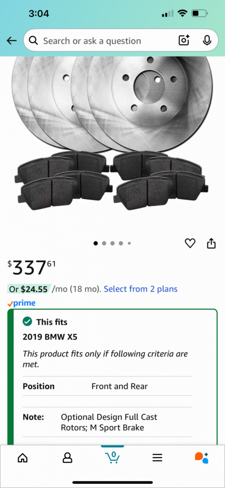

Not trying to be cheap, but if these rotors and brakes end up being great ….. I probably saved over 2k …. Or took a 337 dollar loss lol
09-17-2025
Wow. Keep us updated. At least the rotor looks quite decent from picture. The amazon description is kind of vague. efore taking your apart, maybe do a sanity check to make sure at least they look the same.
Most people, including DIYer (myself included), I go with OE/OEM parts only because I want to do it once and not need to revisit. It is my time and down time for the car at this stage of my life. I used to do exactly what you do, try different hardware (brake pad, caliber, damper, tires ...). Most of time, things worked out just fine. It was fun too.

I may be wrong but those Amazon's rotors don't look like they are coated (e.g. zinc) so the the hat's will likely rust. Normally, coated rotors say that in the ad to highlight they are coated.
