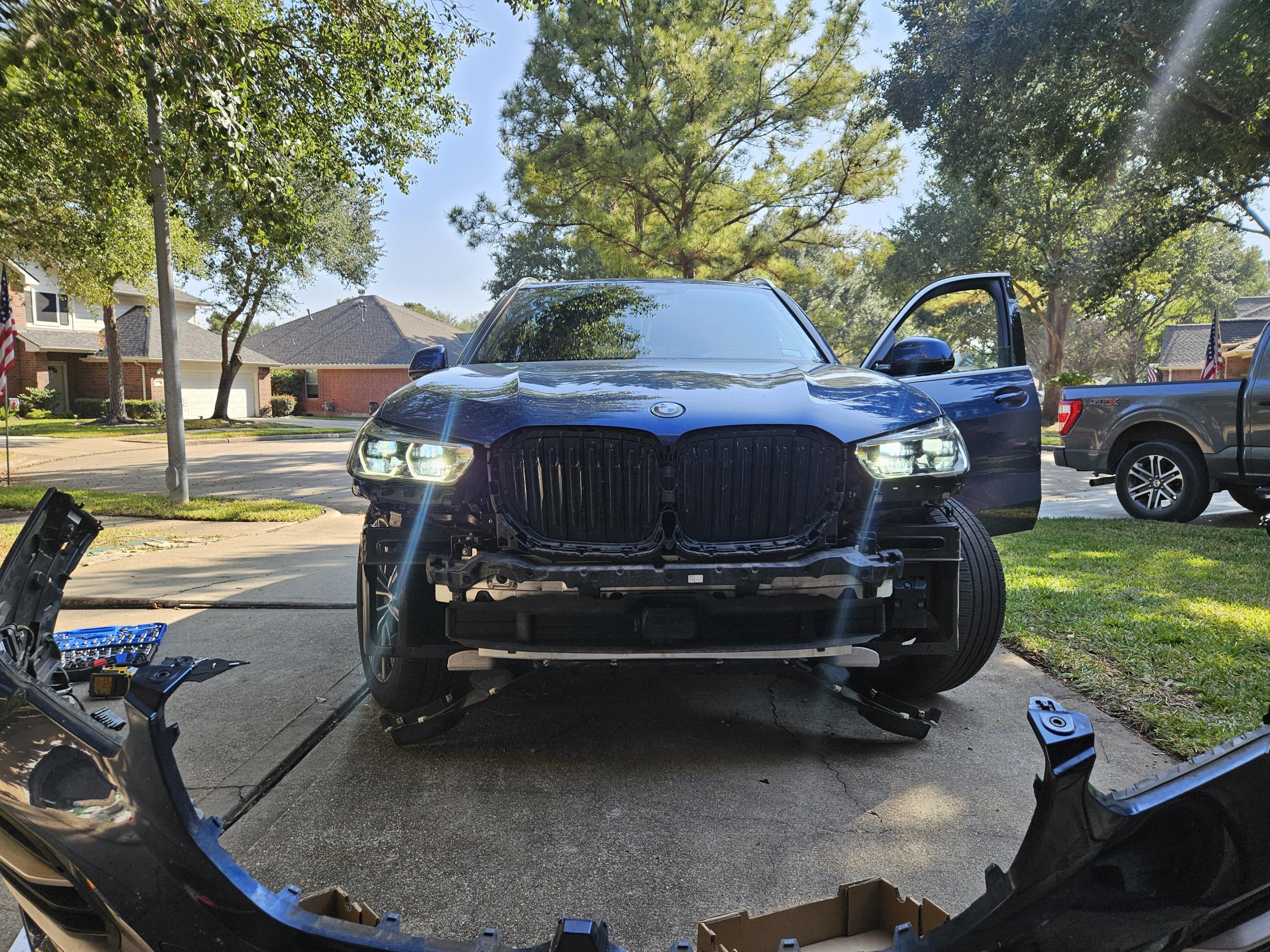

There are few old posts about (semi) successful laser retrofit. I've completed mine and coded anti-dazzle, all is working as intended. Not going to describe all steps in details, as it's too much information.
In short, you need to do the following:

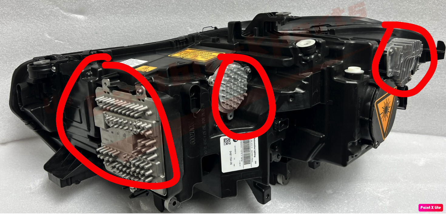

  • buy new/used laser headlights with modules. No other hardware required
    Each headlight has 3 modules (highlighted). Often many sellers don't include them, and you'll have to buy a set separately. So try to find a complete unit.
    Make sure you buy OEM BMW headlights, not a version made in China (ebay has a bunch of them now).

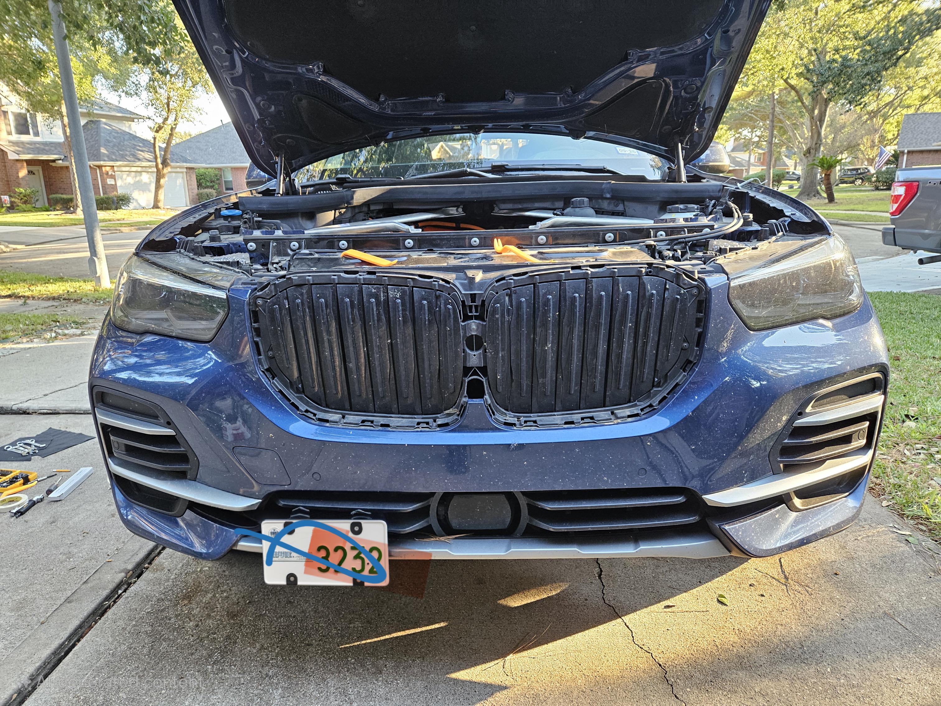

  • install new headlights by removing wheel arches, front bumper and LED headlights (post with a link to official instructions: https://g05.bimmerpost.com/forums/showpost.php?p=32021504&postcount=11)
  • Connect laser headlights, connect battery terminal, check that headlights work (may not be correct, but some sections of the headlights will light up). That means hardware is working and you can go to the coding step
