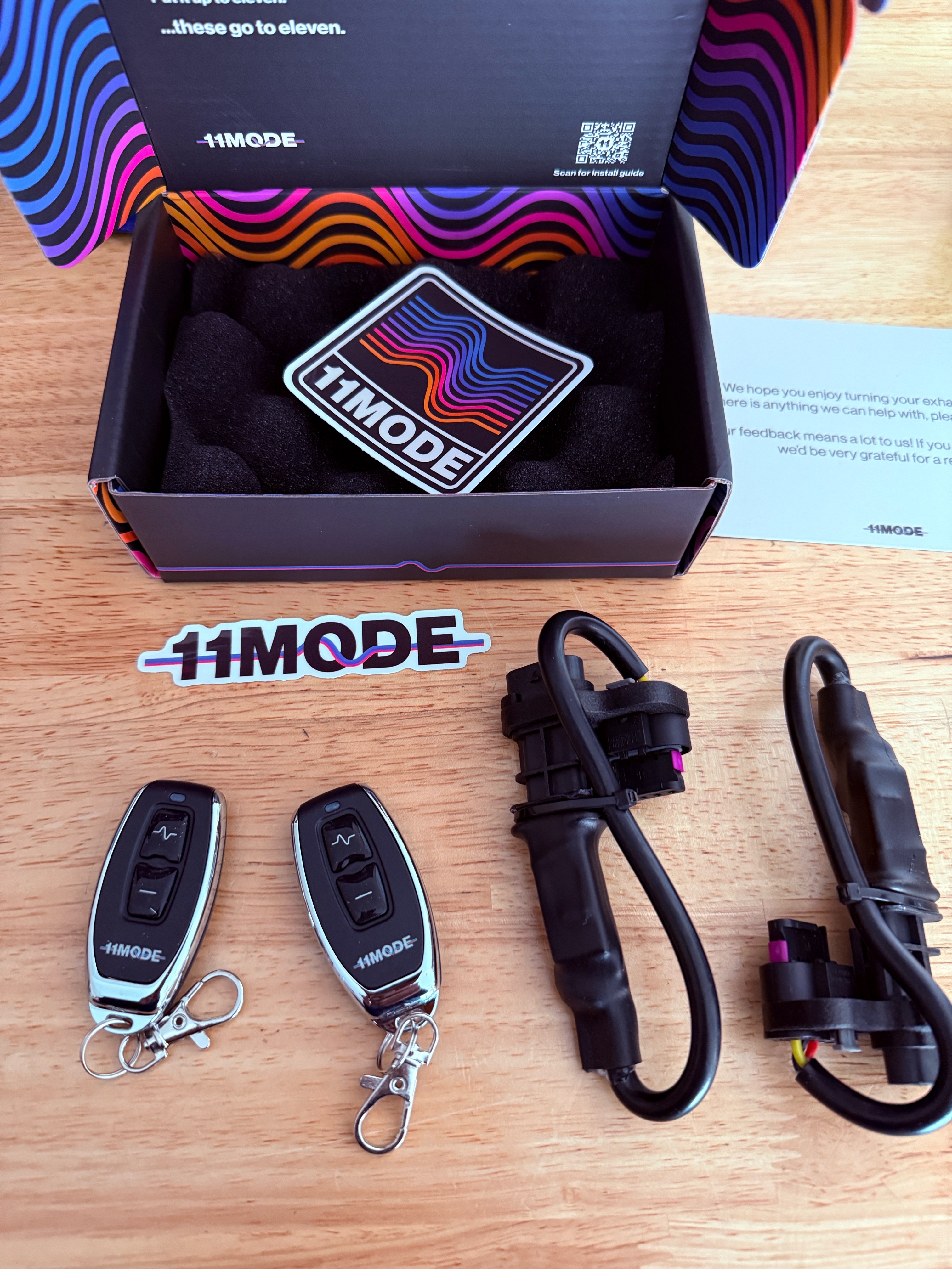

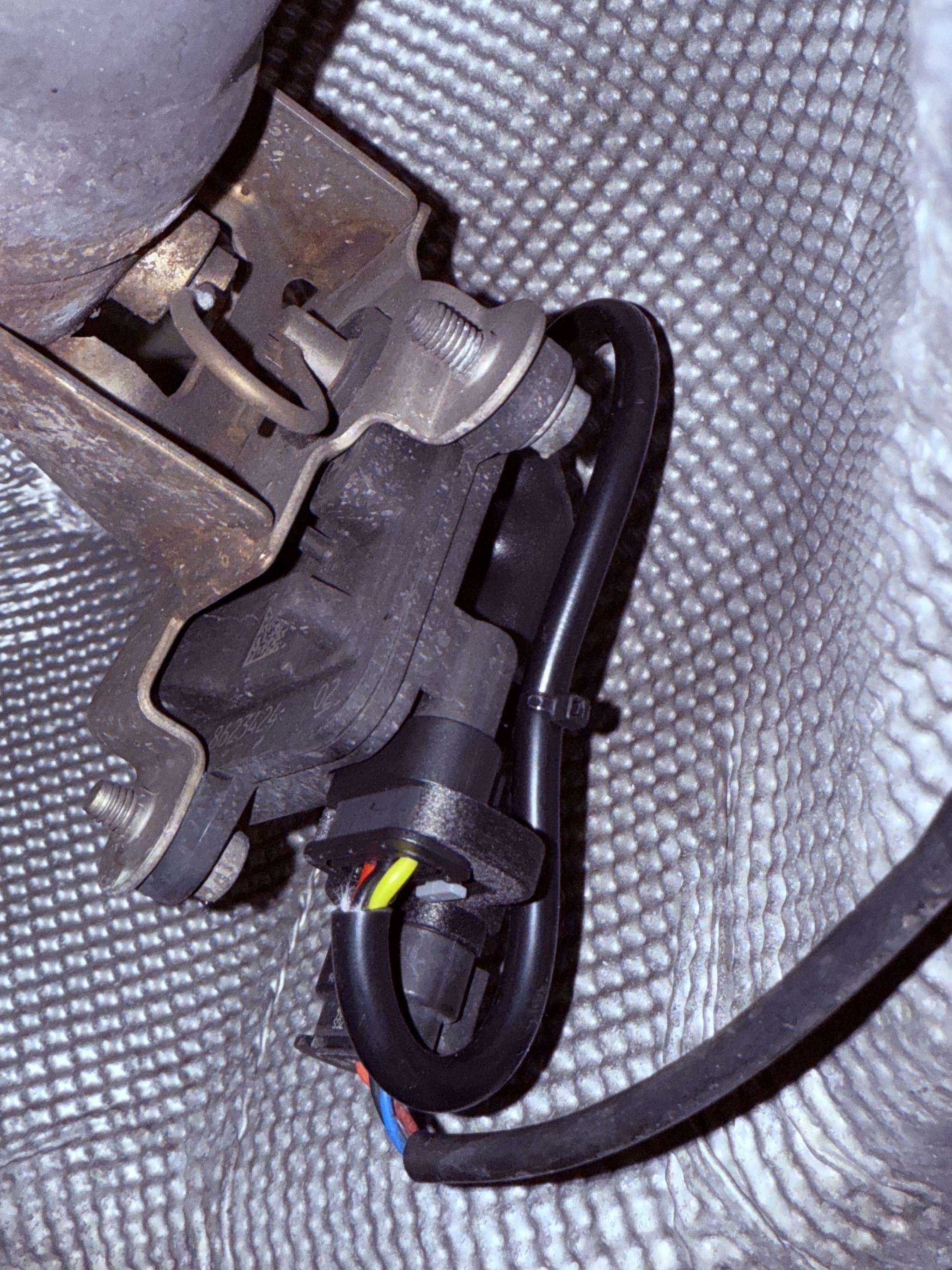

X5Mnwi wroteThat sounds really good, do you have a link you can post on where to obtain one? thanksAfter the 3 weeks I waited for the 11 mode controller to show up, I installed it. Took around 5 minutes as the ass end of the 2026 X5 M60i is closer to the ground than expected so had to do a little squeezing.

Motorin Mark wroteHere's the link to buy your 11 Mode.That sounds really good, do you have a link you can post on where to obtain one? thanks
Wackjam wroteIt's super easy, you don't need to remove anything to get at your valves. Slide under and you'll see them.I'm waiting for my controller to ship. Any tips on installation?
X5Mnwi wroteDo the valves stay open or do you have to open them each time you start the car?After the 3 weeks I waited for the 11 mode controller to show up, I installed it. Took around 5 minutes as the ass end of the 2026 X5 M60i is closer to the ground than expected so had to do a little squeezing.

IL X5 M60i wroteYou have to open them each time you start the car. Once I start the car, I let it run for a few seconds to make sure any start-up sequence takes place, then I'll click the open button and put the key-fob away.Do the valves stay open or do you have to open them each time you start the car?
I like the sound so I run them open when I'm driving. My wife doesn't so she leaves it alone.
When you turn off the car, the valves reset to original position and you have to do the process again.
