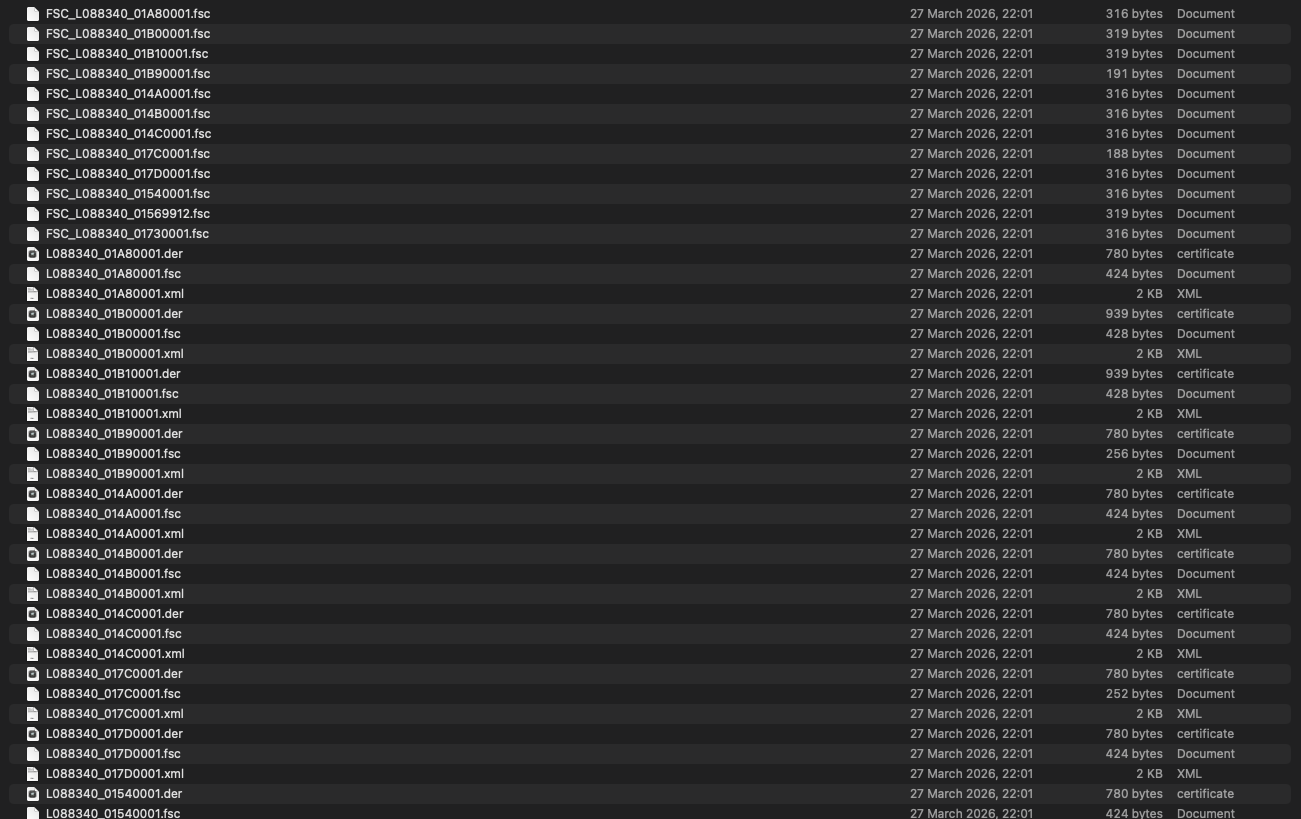

Which .fsc file, there are 10+ and why is the folder called repair pack?
03-29-2026
Post a list of files, screenshot
03-29-2026
First of all, thank you for helping me. Means alot.
I’m uploading a screenshot of almost all the files, as you can see every FSC_L........fsc file has the exact name corresponding L......der/.fsc/.xml
After I change the region via bimmercode expert mode, which files should I upload in the FSC folder? All of them seems weird?
I’m asking about the name repair pack because I’ve seen it here and there and I’m unfamiliar with that it’s supposed to repair?
03-29-2026
Oh, what a mess.
I really don't know, maybe you should try FSC_L088340_01540001.fsc
Or try one by one
When you bought maps and fsc code, the seller should send you one .fsc file and that's it. I don't know what complicated it.

I found it, you should use this file FSC_L088340_01569912.fsc
