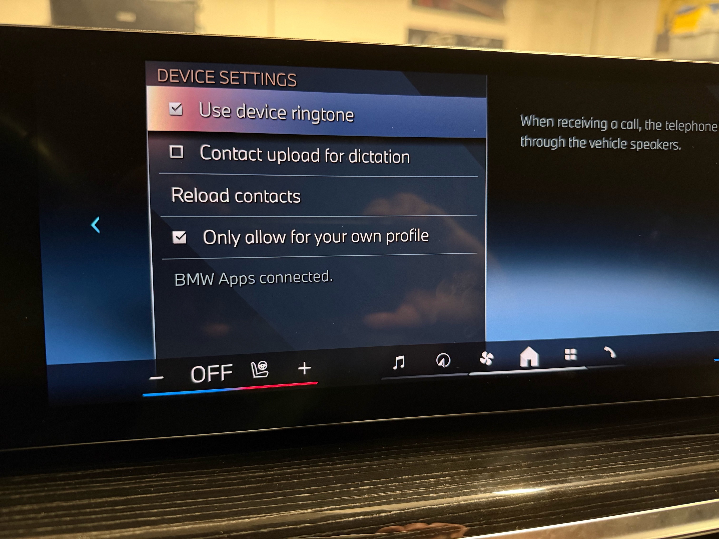

nawktrebor wrote
set each of our profiles to only allow our phone when our profiles are being used.
I don't recall seeing this setting on our 2026 X5. Would you happen to have a photo of it that you can share?
05-08-2026
Hi @martian_soldier - The setting is under Mobile Devices > Your Mobile Device > Device Settings.
