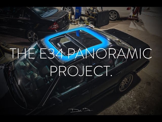

I saw a video on YouTube and we want to do the same to my E34 Sedan. The guy in the video used a panoramic roof from a Cadillac CTS, but those are very rare over here
I'm looking for a panoramic glass roof (with glass in both the front and the rear). I took the measurements from the inside and got 115 cm in length and 95 cm in width.
Which panoramic roof could I use for this retrofit? My roof already has a hole in it because a Webasto Hollandia roof was previously installed, but that one is rusted out, so I need new options.
We do have a BMW E61 Partscar with a Panoramic sunroof but that one is 106,5 cm and 98,5 cm from the inside (glass)
