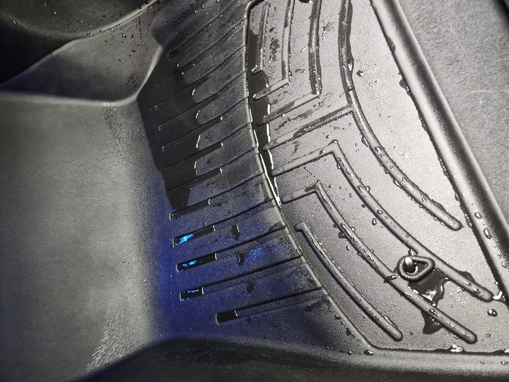

Must pulled the mat up. Half inch of standing water all under the mat probably from it sloshing over the mat as I drove. It must be coming from up top but the Inside of the glove box is dry

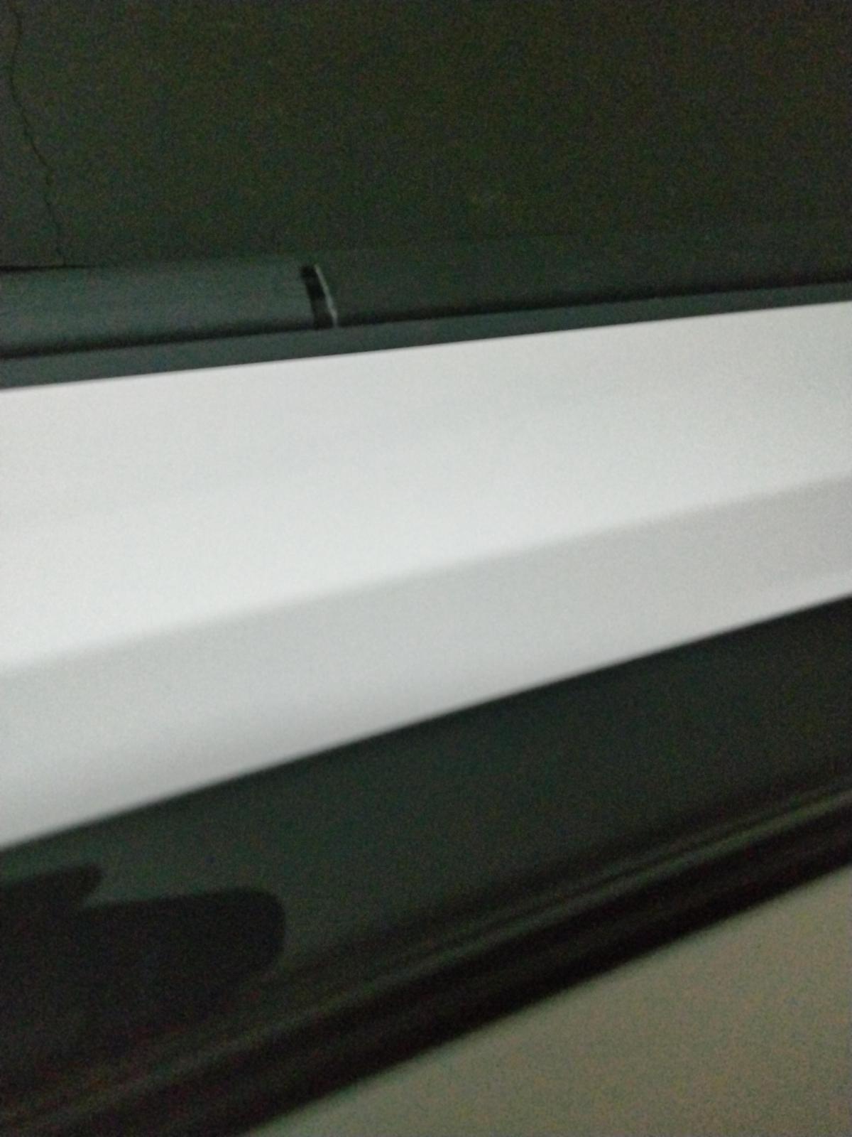

But the mat is waterproof....per the 1st pic, water ain't going to wick up from below and sit on the waterproof mat ontop..

Nope I was wrong. Spot number one found. Not the only one though.

Looks to be more cassette than line per the recent pic

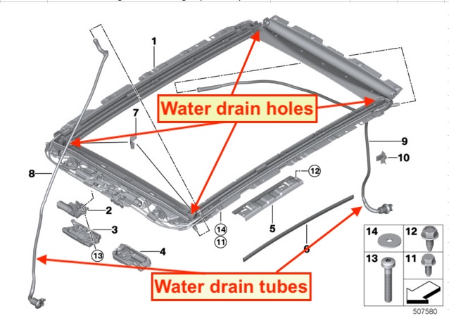

Take a look at this video, starting at 1:38 on the time bar. This is not an X5 but still applies. You can open your sunroof, get up on a stool and look for any standing water. You can also slowly pour water in the sunroof channel and see if it drains quickly, slowly or not at all. I think there are either three or four drain holes/tubes but it looks like you are looking for the one on the passenger front but check both front ones while you are at it.

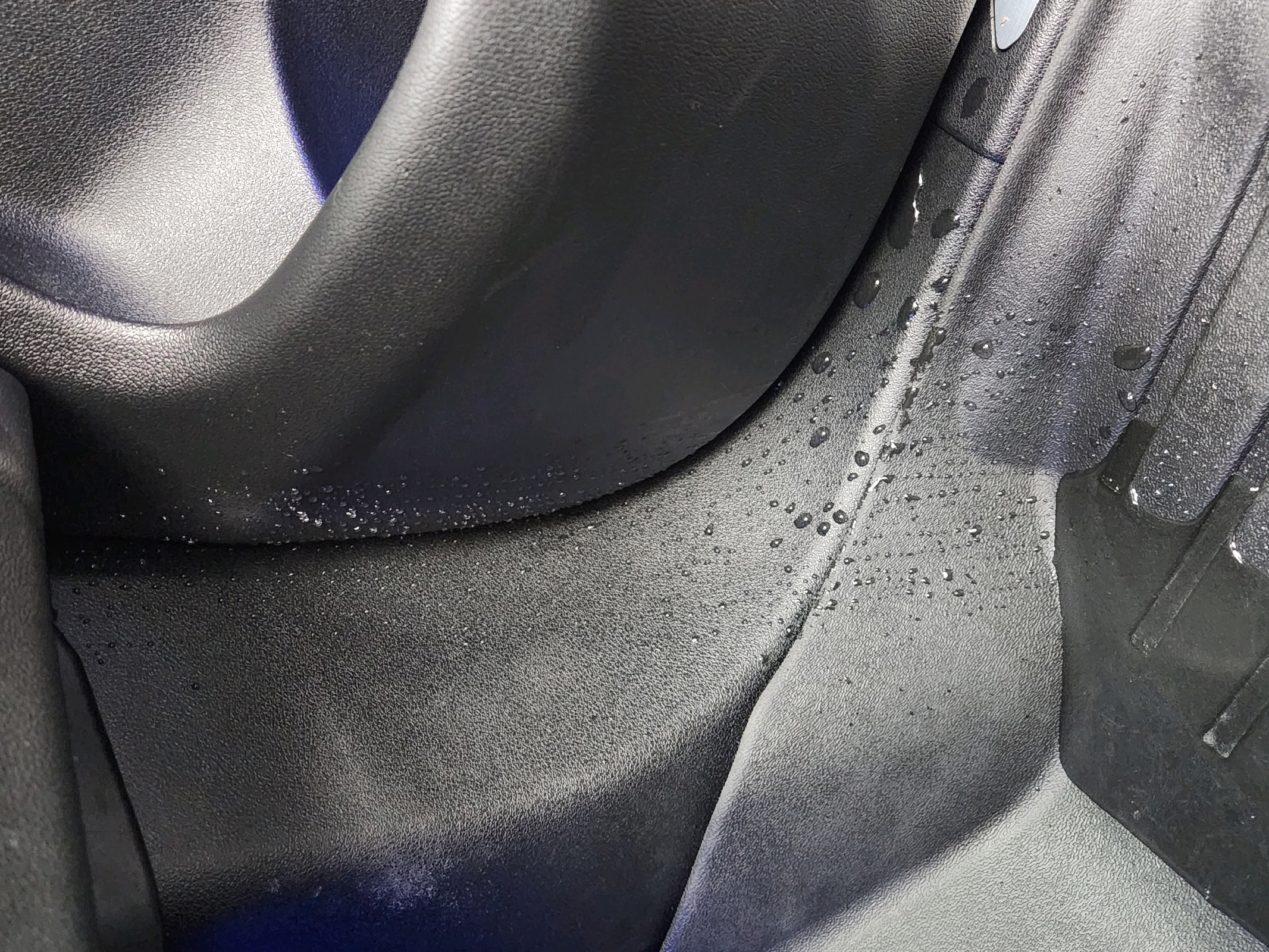

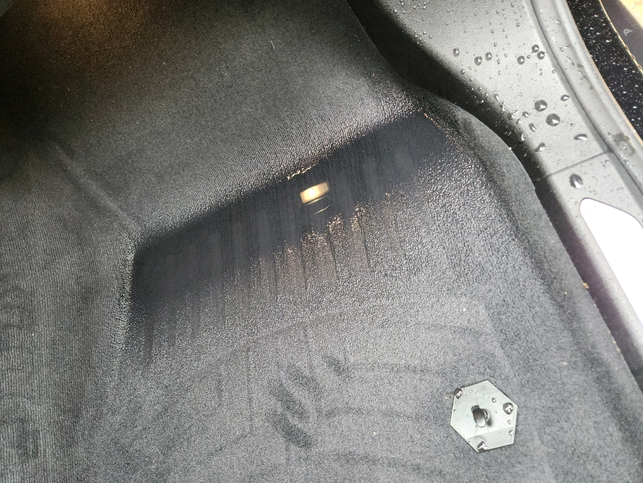

The main leak is here, by the door. Is that still sun roof related? This car is leaking like a God damned civ!

That looked like clogged drain to me. Good luck, at least it's obvious for the service guys to look at. No 'Unable to replicate' BS!
Even down here by the door?
Yes.. If your look at the diagram above. The drain tubes run down the A-pillars to the bottom of the floor.
I think there is a joint in that area. So, the joint may have loosen and the water just shot out of the tubes in the the interior panels and into the car.
