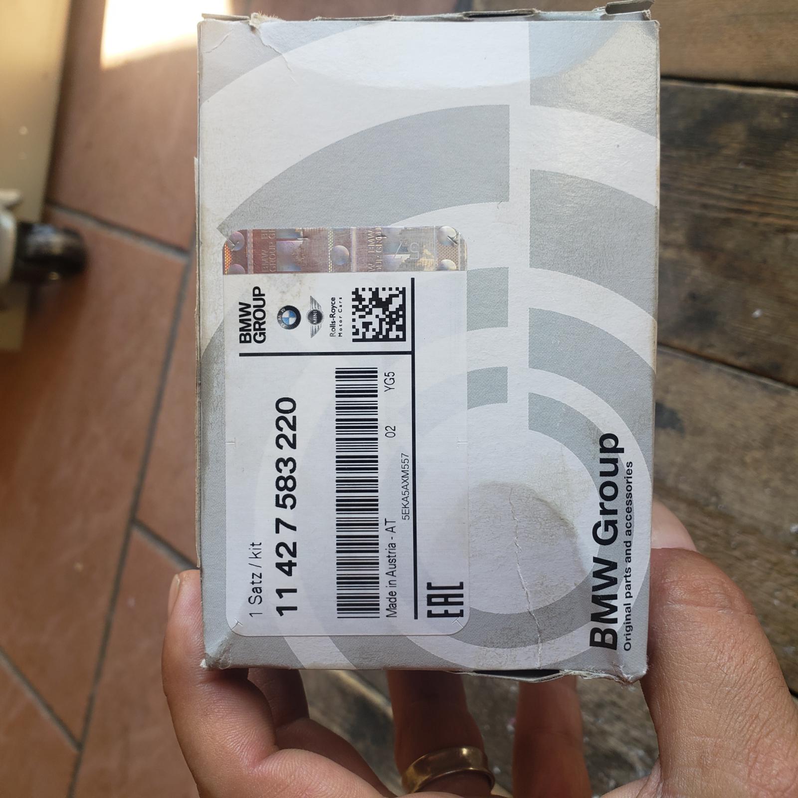

1. BMW filter kit (part # 11 42 7 583 220)

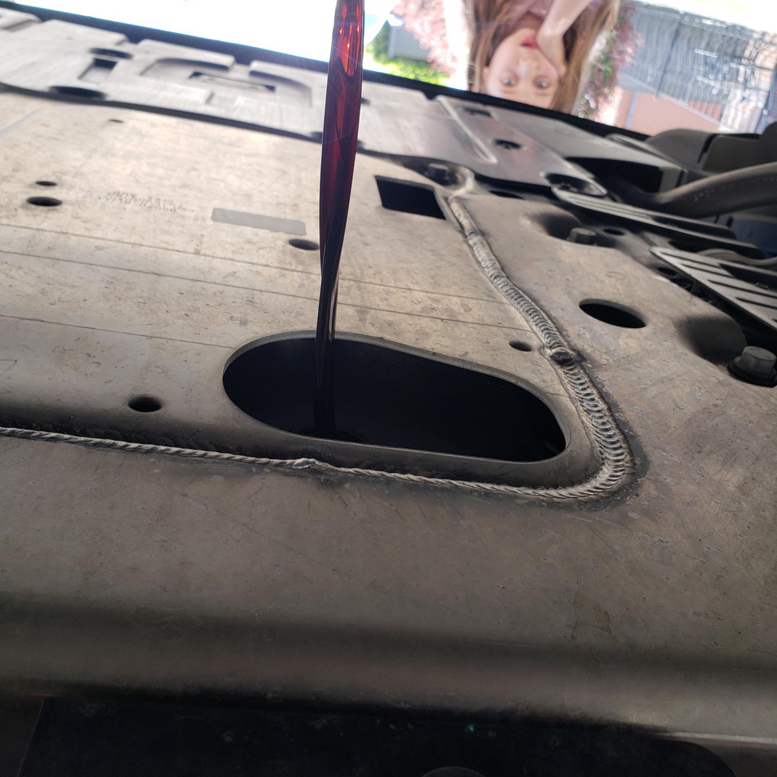

Step 3: (with your oil pan under the car.... duhhhh).... remove the oil drain plug using a 50mm torx bit (a similar sized allen head socket would work just as well)
Step 4; Let all the oil drain out.
Step 5; replace the copper crush washer (my car actually didnt have one from the factory.... so don't freak out). It has one now though

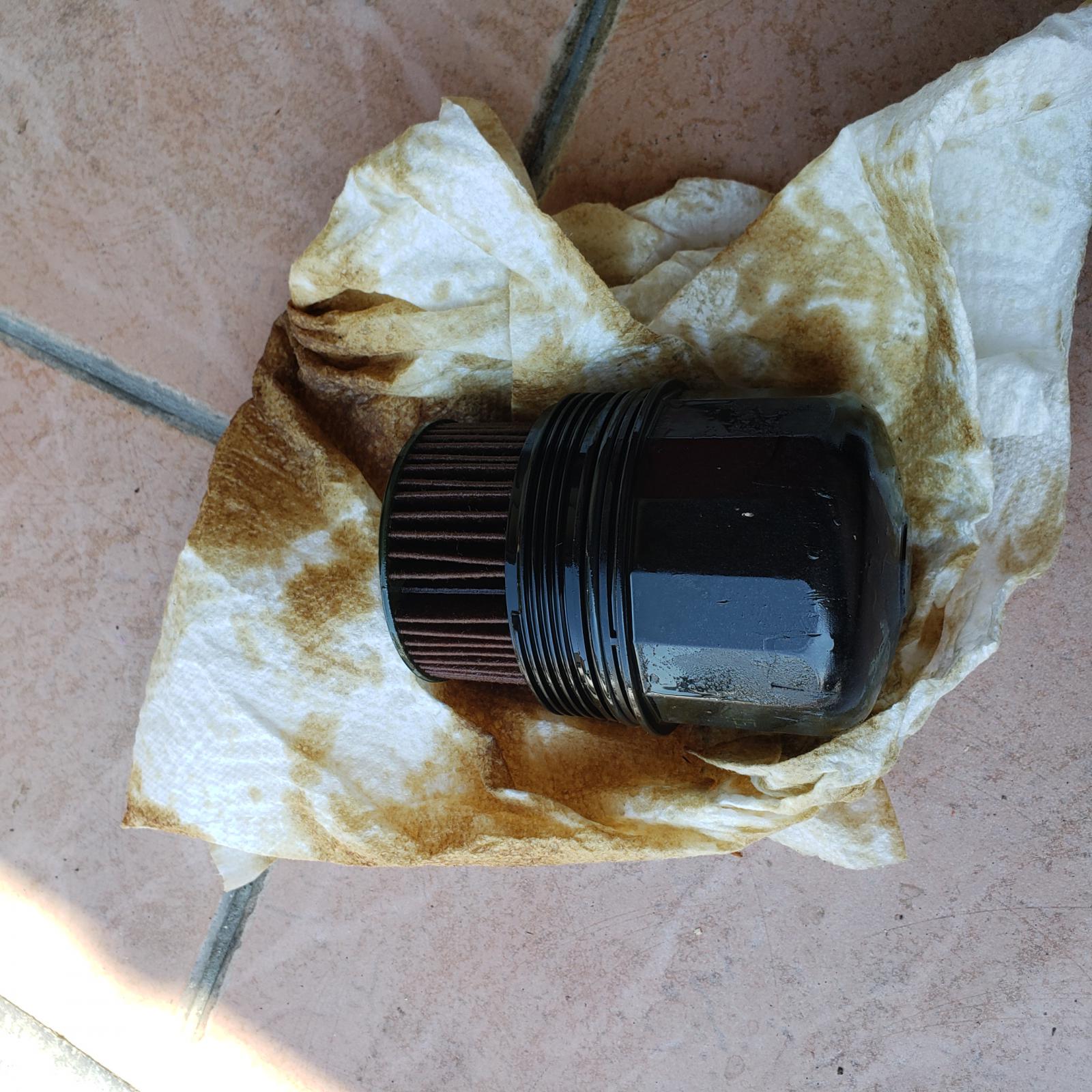

Step 6: Using a filter housing tool you've had since the early 90s..... or a BMW approved one ..... remove the filter housing and filter assembly.
Note: whatever you use, it needs to be a "top mount" style oil filter wrench. There is no access to turn from the side.
All vehicles are different. This one will have a bit of "splash out" when you remove the filter housing. It's unavoidable. No big deal, Just be prepared for it.

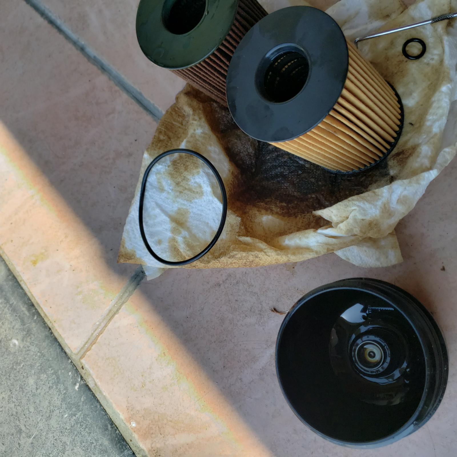

Step 7: pop the old filter out (just pull up with a little force).
Step 8; replace filter in the exact same orientation (filter label down inside the housing).... push firmly until it snaps in.
Note; small rubber O-ring is not used.
Step 9; replace large rubber o-ring around the outside of the filter housing
Step 10; Replace filter housing and filter assembly in the exact same orientation as removed

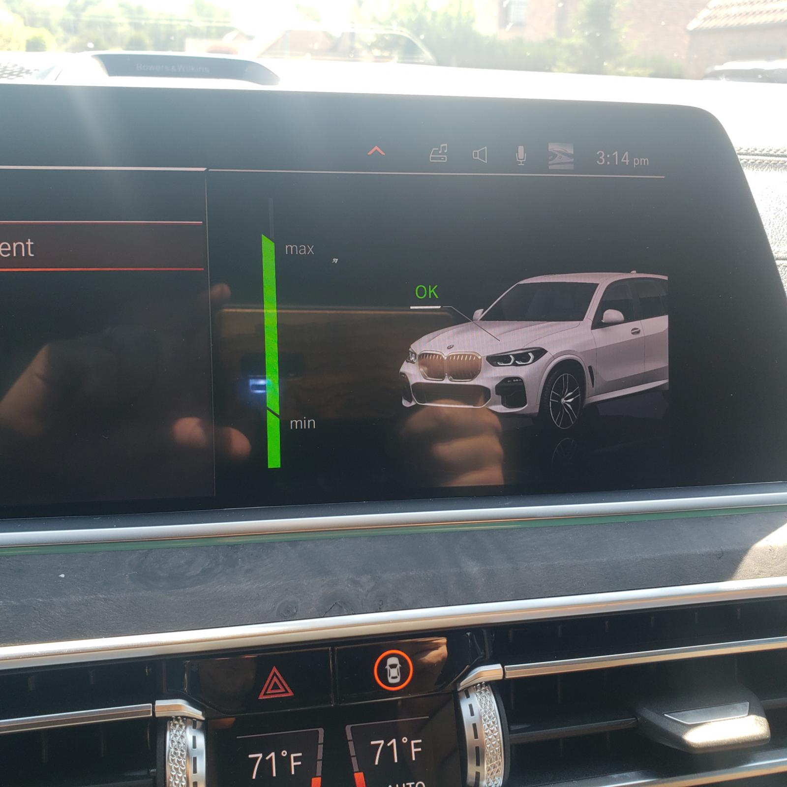

Step 14; Start your car normally, allow it to warm up (it will only measure after the car is at full operating temp) and check the oil level in the following steps on Idrive;

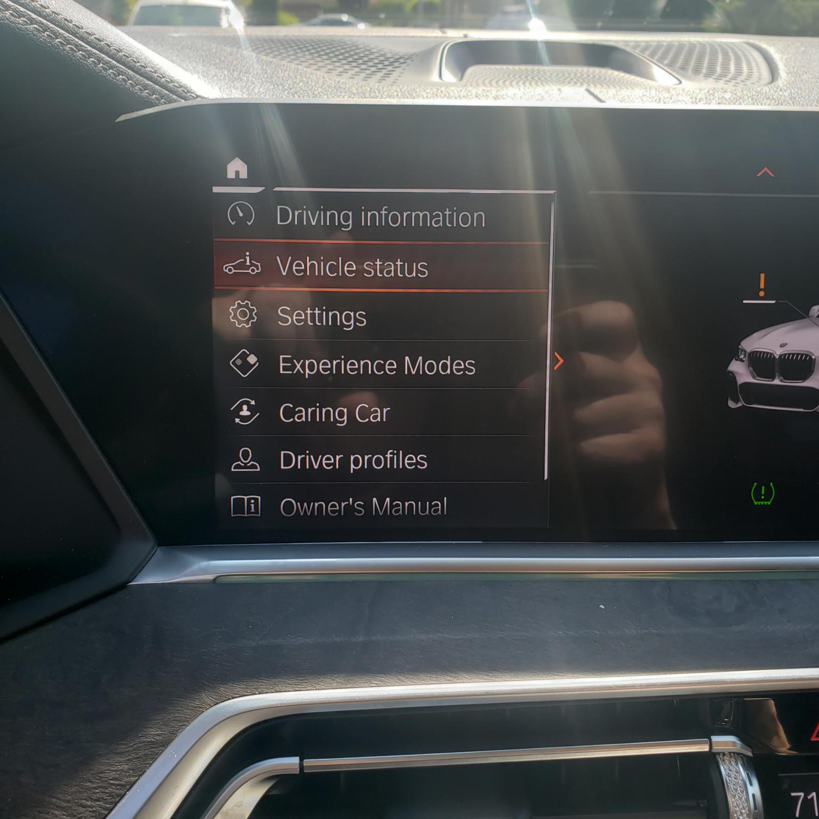

Step 15; Follow the oil reset procedures in this video (I didn't see the sense in remaking one, because it's already been done well).
Good luck! Ask questions if you have any!

I wonder how you guys fill up the right amount of oil without the dip stick?
do you put 9Q then run the idrive oil meas and then add 1/2 by 1/2 and check the system?
overfilling will be a disaster for sure, how you guys avoid that?
Our cars have dipsticks.
