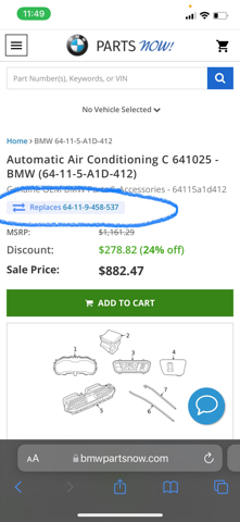

Has anyone received a "new" part that doesn't sing by itself?
Unfortunately no. My dealer ended up swapping out my unit but the noise was/is still there. I was hoping that this issue would be addressed in the MY22 but that looks to not be the case. I would still call BMW NA and make a complaint.
11-15-2021
Called BMW NA but they had no information on the new part. I'm going to call my dealership to see if they have any info on it but in short, looks like the part number changed. Figured I'd throw this out there to see if anyone else had any good resources to see if anything changed with this new part.

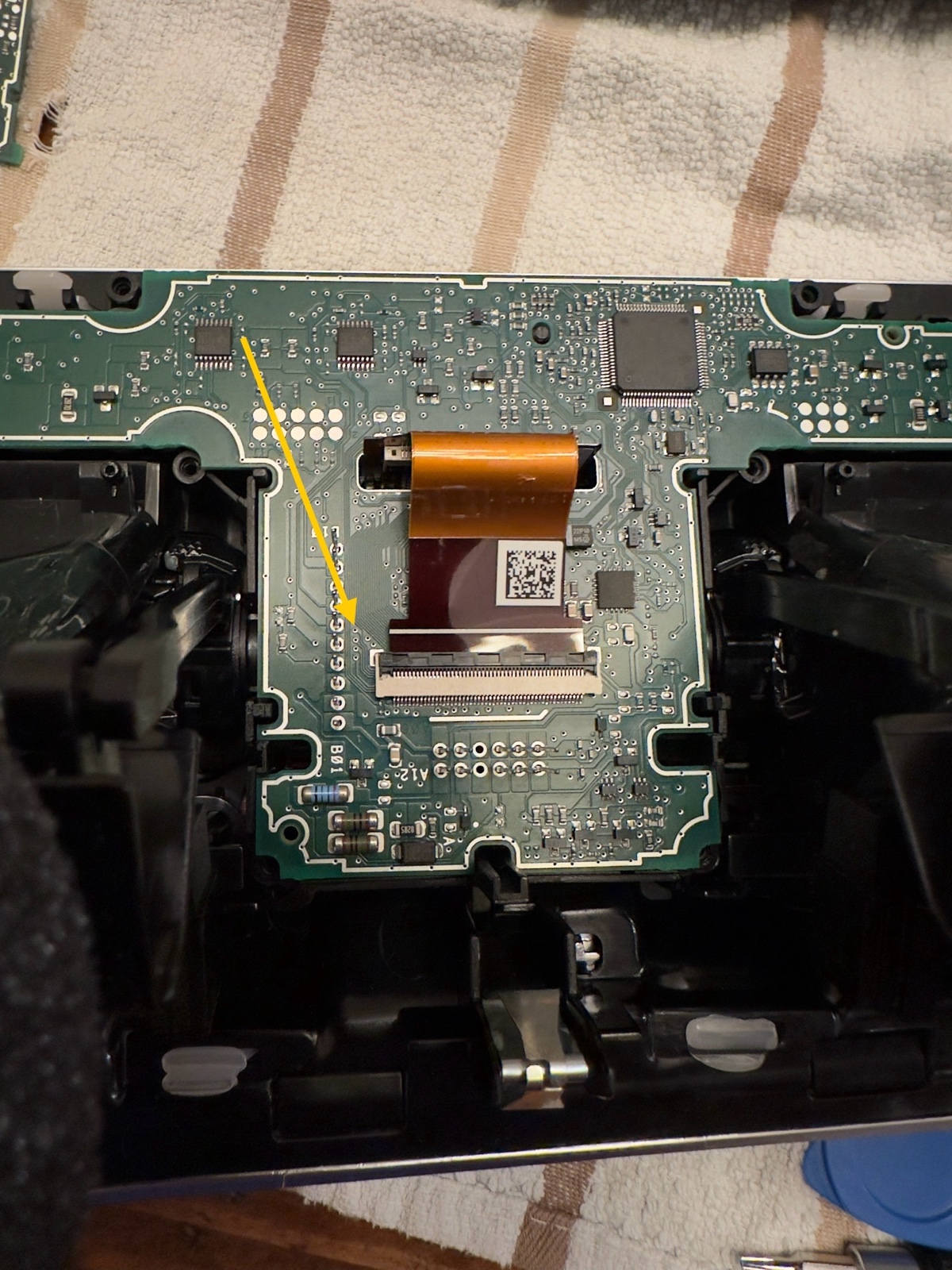

Found the source of the noise. Working to see if I can replace it with a higher quality component, if not will try some hot glue. Silicone didn’t do the trick. This is the board from the HVAC control unit
11-27-2023
Nice find! Is that right behind where the HVAC LCD screen is?
11-27-2023
It sure is. I’ve tried some insulation foam and a few other things but the noise still permeates through. If I apply pressure to the side of that component, it stops.
I’m working with a guy that repairs circuit boards and is trying to source a new part to solder in there. I tried hot glue yesterday but didn’t work unfortunately.
The number on there is D08021 for reference.
11-27-2023
Interesting. The solder joint looks good though?
11-27-2023
Yeah they look fine, as far as I can see….I tried putting some hot glue on the back side as well but didn’t help. It needs quite a bit force on the side to stop it from making the noise. You can hear the frequency changing a bit depending on how much force it used
11-27-2023
Here’s the back of the “main” board with the smaller one removed. The arrow is pointing to the back part of where that chip is.
