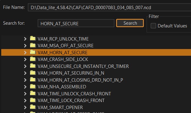

6ixSpd wroteMaybe outdated data, mine is in BDC 7083Anyone have the parameter needed to turn off the 2x horn when the car is running and you lock it from outside?
The HORN_AT_SECURE option isn’t in my CAFD for BDC, nor is VIAMASTER_4_4
