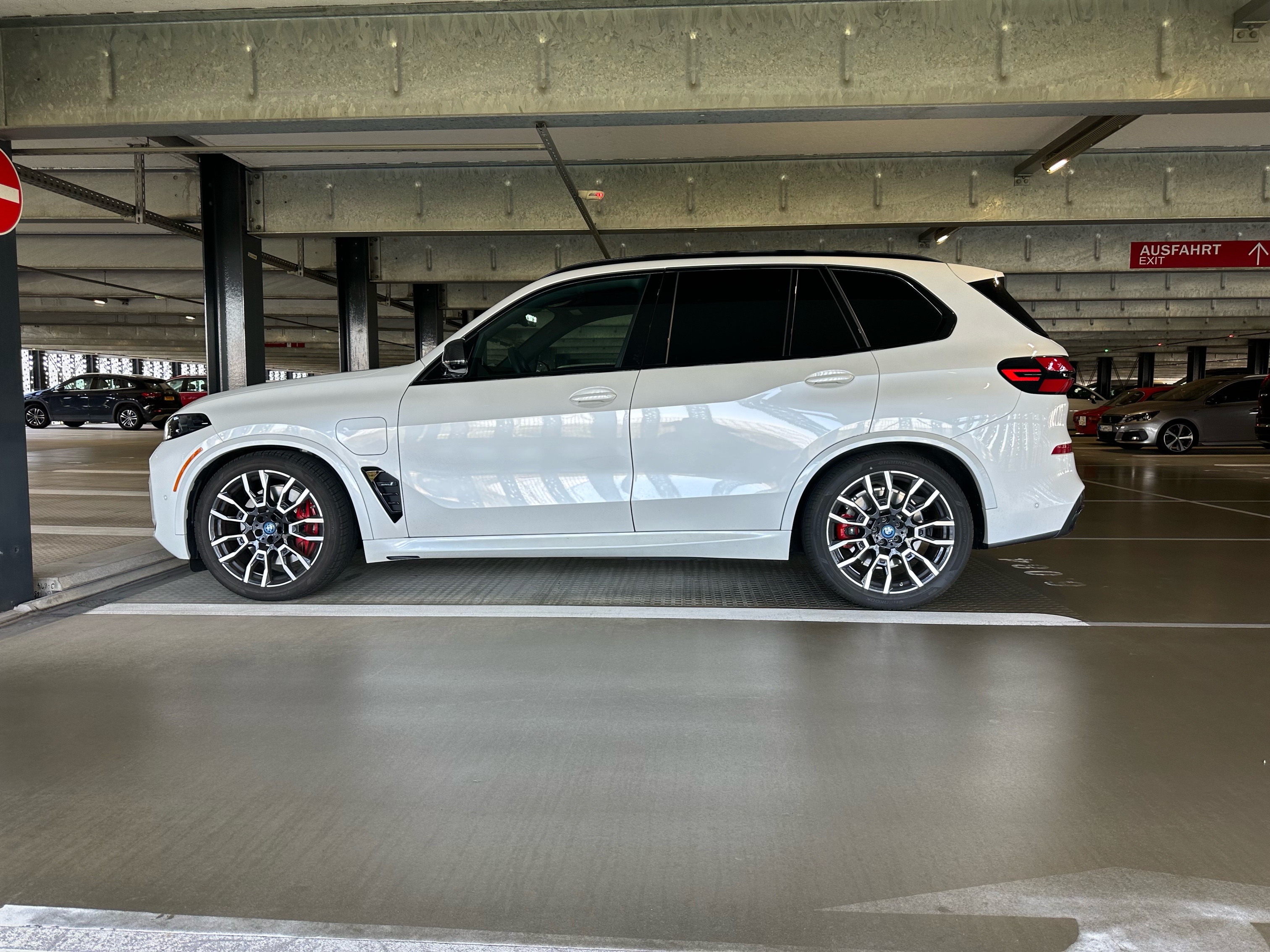

Gtz1wickedest wrote
Another note to add if you go super low it rides like a Honda on cut springs and you get a chasis malifuntion message when entering loading mode just putting it out there for future installers. Went with recommended adjustments and rides perfect.
First pic was super low and getting errors.
Second pic looks level and rides perfect.
Is the second picture your ride height or load height?

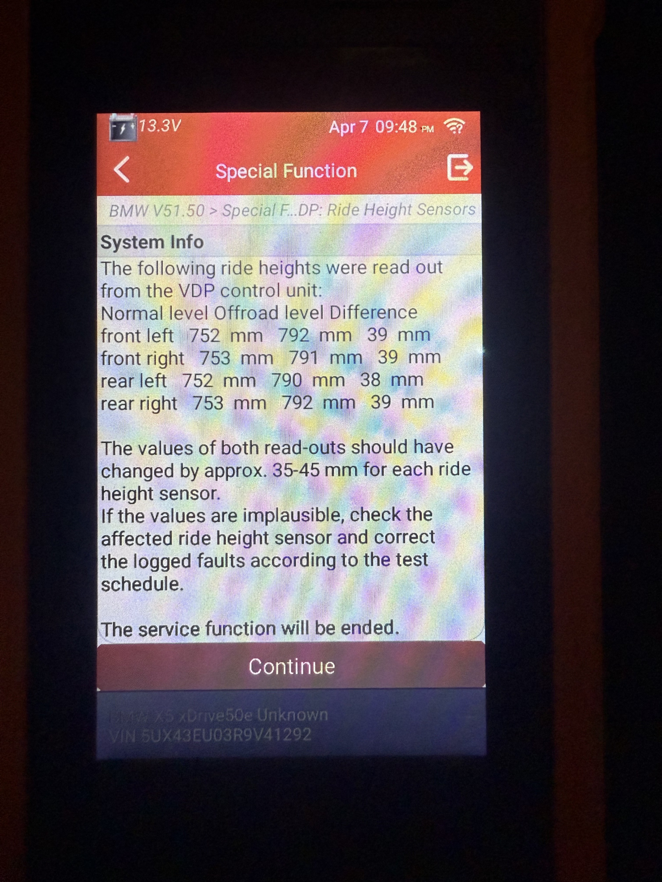

I was finally able to fine tune the 1/4” gap I’ve been having on the front right. I’ve piece my own because the one I bought, I had to take them off and make adjustments. It’s hard to accomplish this if you don’t have a garage. This one, I just turn the rod, much like on a steering or any tie rod. If you play an 1/10 or 1/8 scale RC buggies or truggies you’ll know what I’m talking about. I haven’t installed the rear yet but the gap is also noticeable if you have an OCD 😂.
